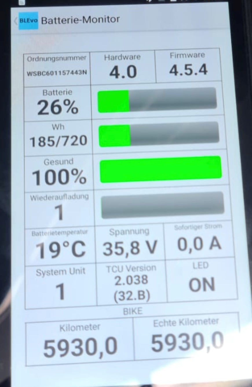

Hallo, ich habe einen neuen 700Wh Akku erstanden.
Wieso zeigt er 720Wh im Batteriemonitor an ???
Ist das Normal? 20Watt extra wäre ja nicht schlecht...
I saw that in some batteries the value given is greater than 700wh... I should check if I can understand where is the configuration..

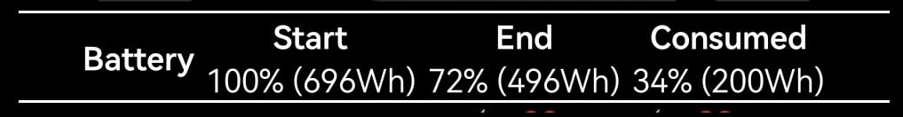

just out of curiosity: Every single day I wonder why my ride statistics always report these kind of strange looking (at least for me) % values for remaining battery capacity and consumption. Maybe someone can explain the displayed values to me ...
As an example the values BLEvo showed today:
- Start: 100 % (696 Wh) (remark: played around with the light a bit on yesterday evening)
- End: 72 % (496 Wh)
- Consumed: 34 % (200 Wh)
First of all: If we take the nominal 700 Wh as a basis, 496 Wh would not correspond to 72 % but 67.0 %.
First thought, BLEvo may take the starting 696 Wh value as 100 % - which would of course still not be 72 % but 71 % , but it would at least be close. Nevertheless, I seem to be wrong, as yesterday's example shows (follows below),
However, I found no way to end up at 34 % for the consumed 200 Wh.
For me, 200 Wh equals a consumption of either 28.57 % (based on the total of 700 Wh) or 28.74 (based on 696 Wh) ...
OTOH: If we take 200 Wh as 34 %, this would mean 100 % ≘ 588 Wh ... does this appear strange to only me ...?

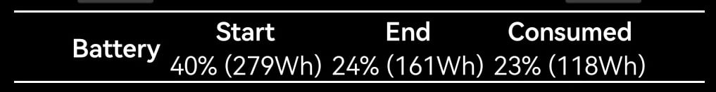

Things get even stranger if I start my ride with less than 100 % battery. Yesterday's values:
- Start: 40 % (279 Wh)
- End: 24 % (161 Wh)
- Consumed: 23 % (118 Wh)
My thoughts:
- 40 % ≘ 279 Wh => 100 % ≘ 697,5 Wh - looks pretty fine, but falsifies today's assumption,
BLEvo may use the start battery level as basis
- 24 % ≘ 161 Wh => 100 % ≘ 670.83 Wh ... ahem, already missing 27 Wh, am I? 23 % would at least be closer to 696 Wh
- 23 % ≘ 118 Wh => 100 % ≘ 513 Wh ...?!? I have absolutely no clue, where these 23 % may come from ...
Am I missing s/th or is BLEvo just guessing the percentages ...? ;)
View attachment 116454 View attachment 116455
The very strange thing is that the consumed battery is not the "Start" - "End" battery.
BLEvo reads the values from the battery and report it..
Maybe I have to check the CSV file to understand better..

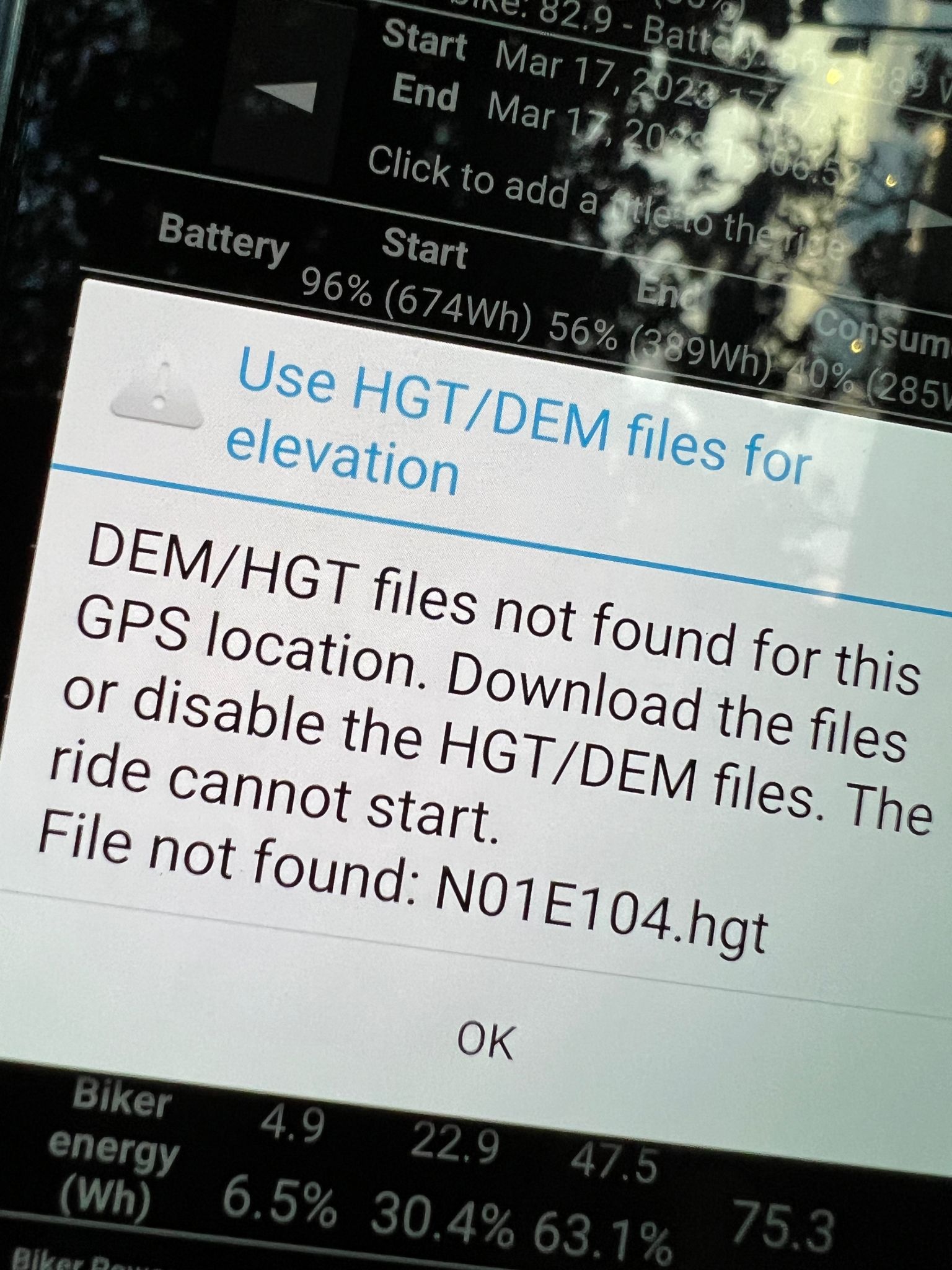

I get the same error message like xiaochew sent in his post on about every second start of BLEvo (no Levociraptor, hence no barometer settings).
Unfortunately, it is not deterministic: Sometimes I even try to force it by pressing [Bike Monitor] very quick after getting outside, but even then it "just" happens half of the times - and on other days there are even minutes between BLEvo app start and press of [Bike Monitor], and the message appears anyhow ... strange. And the demanded files are most definitely there. As the fact that on the other half of days the message does not appear ... don't get why ...
Any suggestion?

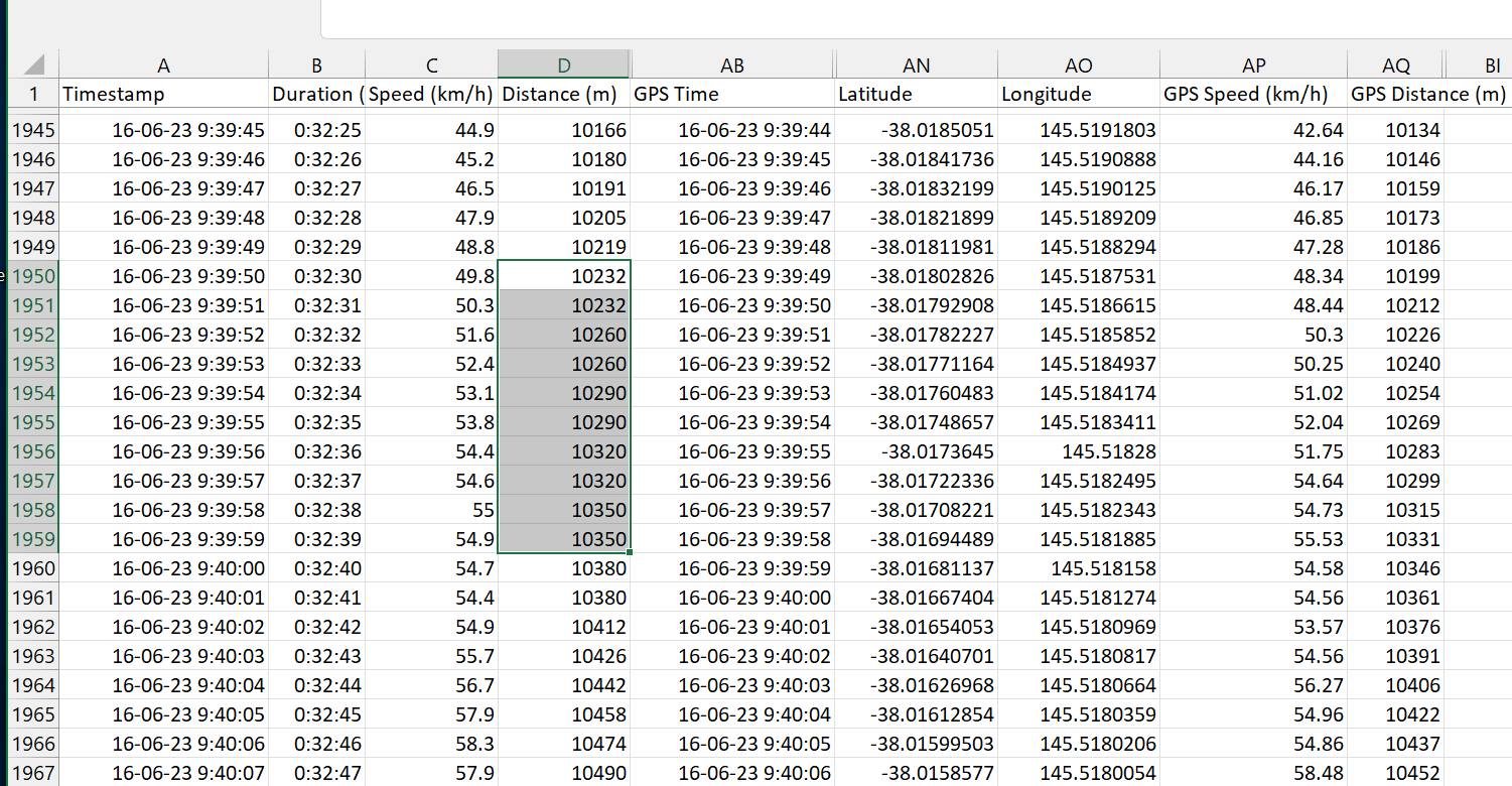

Hi Paolo,
I've detected a really weird problem with the way BLEVo is recording elapsed distances in the FIT and CSV files. It is an intermittent and random problem occuring in only a few records of each file. See screen shot of CSV below:
Notice how some records have duplicated the previous elapsed distance even though I was travelling at significant speed. The timestamps, speeds, GPS co-ordinates (and other data) are all correct, but not the distances. For example, at 50km/hr the distance from 10232m should have incremented about 14m to 10246m, not remained the same. It tnen corrects itself on the next record, but stops again for 1 more record, and so on.
My equipment is:
Bike: 2019 Turbo Levo standard TCU (all latest Battery, TCU and Motor firmware)
BLEVo: version 3.12.4.596
Phone: Samsung Galaxy S9+
I've gone back through all my ride files and found this started at BLEVo ver 3.11.0 Version 3.10.0 and prior are all o.k. using the same bike and phone.
I found this problem accidentally when viewing the Speed profile after importing the FIT file into RideWithGPS...it produces wild spikes in speed where these errors occur.
I also ride with a Garmin Edge 1030 paired with the ANT+ sensors in the bike and none of these errors are present in those FIT files.
This is probably a tough problem to resolve, and not a huge problem, but I wished to make you aware of it.

Please remove any calibration of the DEM. In the pictures posted, there is the calibration with DEM activated..
Hi Paolo,
My equipment is:
The distance is get from the bike. If the data is not updated means that the bike doesn't send the distance. To avoid the issue you can use the GPS data in the configuration menu..

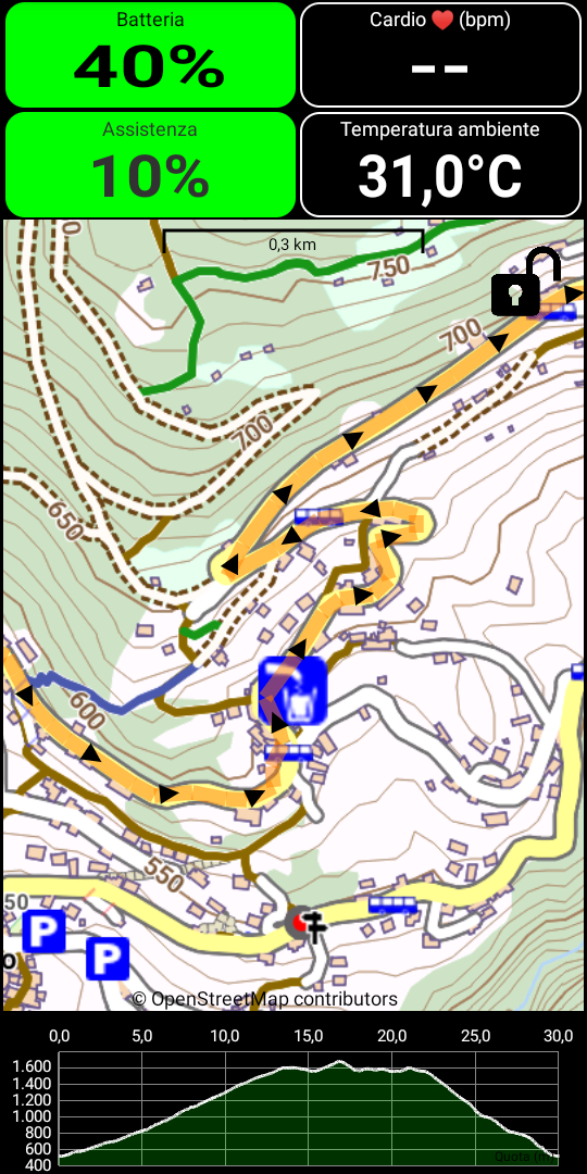

A few days ago I released version 3.12.5 of BLEvo for Android.
Here the changes introduced
- Added audio message for enabling/disabling Crash detection (very useful for understanding when to put the bike down without activating the crash detection)
- Added audio prompt for high power (>900 watts). Very useful to understand when you have problems with the second battery
- Updated Ant+ library to 3.9.0 for compatibility with Android 13
- Bugfix: Corrected altimetry graphic display with GPX details
- Various bugfixes.
Attached is the altimetry graph to follow during the tour

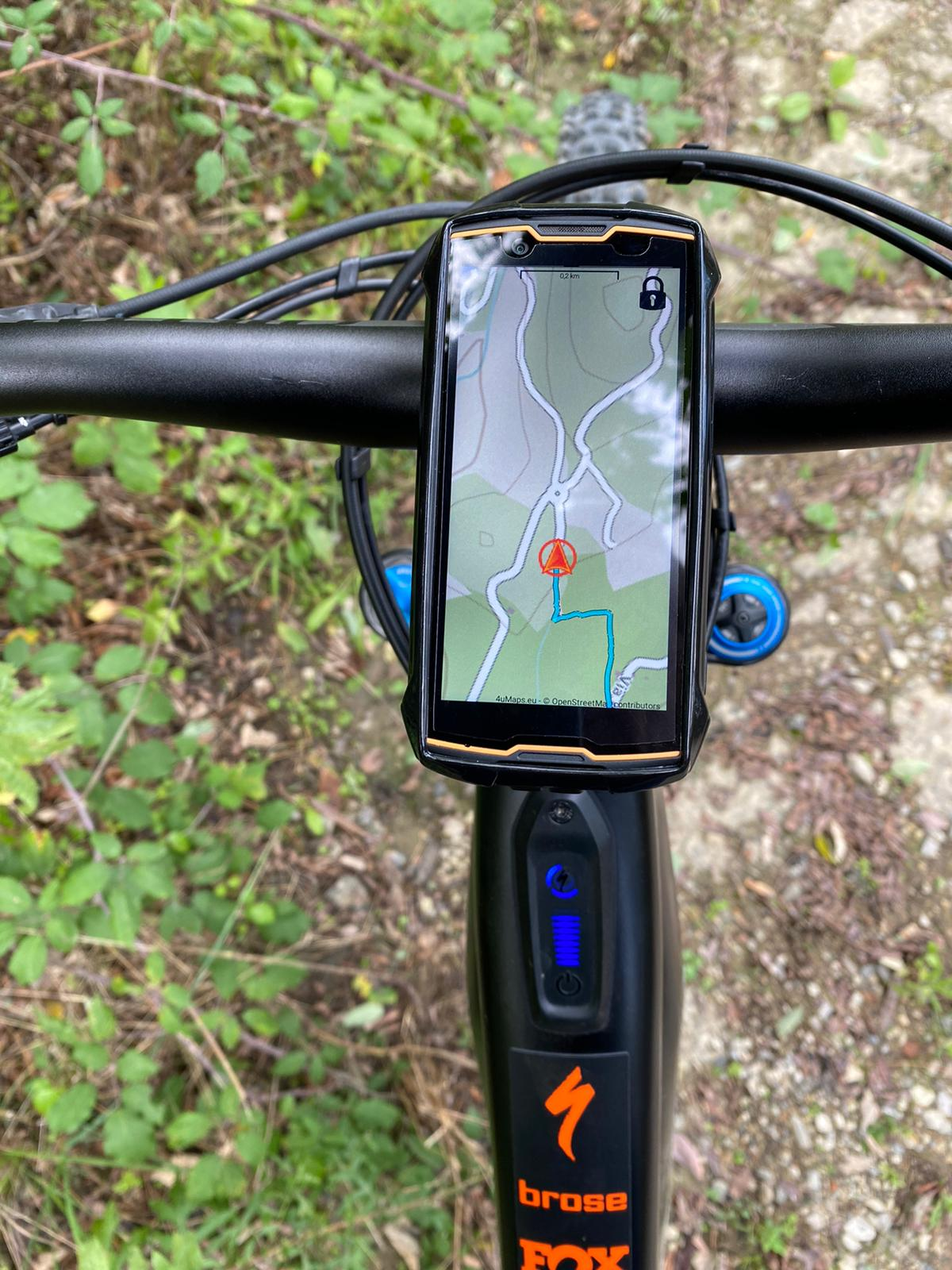

I found the link where explain how to use another App on Karoo device. I think it is not so difficult to do..
I use the King Kong 2 mini in Portrait mode and it is not so bad, so maybe also Karoo device can be good.. Maybe the screen is too small (3.2" vs 4")..

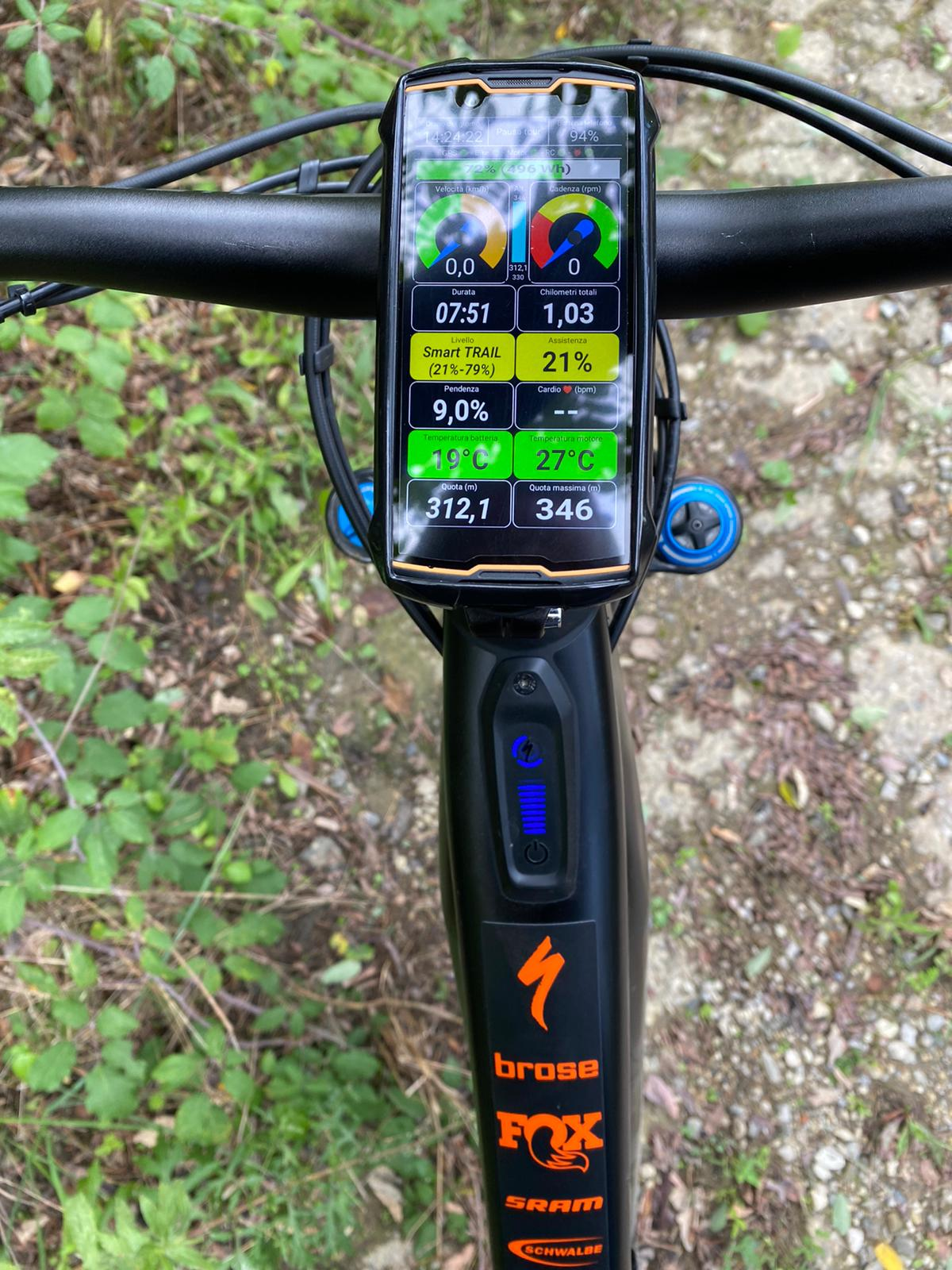

Hey, i'm a brand new specialized owner (just bought a kenevo expert), and was getting my setup all dialed in. Really love the blevo app (thank you for this!), and wanted to do something exactly like you have your pics. Could I just ask you a 2 quick questions (went through so many pages of these threads and couldnt find).
I bought the king king pro mini 2 pro yesterday (most recent one, screen pixels better than king kong mini 3). I plan on running the BLEvo on it, using the gen3 levociraptor as a barometer and my epix 2 garmin watch as the HRM.
I was wondering -
What mount do you have? Assuming it is Quad Lock but wanted to confirm
Is there anything you'd do differently?
For my android phone I use a stick on garmin adapter. Mainly because I already have a bunch of garmin mounts. Quad Lock is certainly a good option too.
I was wondering -

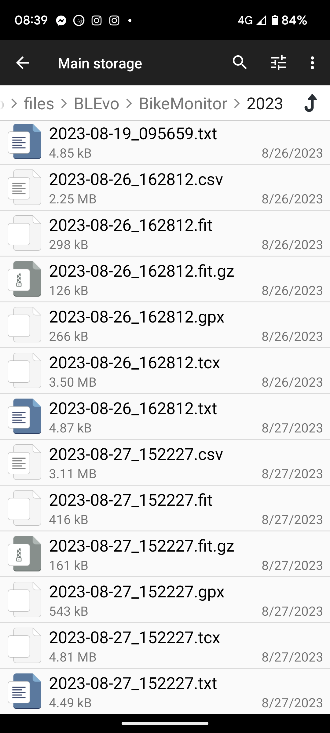

Hello
I changed my phone from Google Pixel 3 to Pixel 6. Old phone has damaged screen, I can not unlock it, therefore transfer of applications to new phone was done at service. They transferred Blevo application to new phone, and I got Blevo datafiles on USB drive. I transfered these data to the directory BLevo, but when I start BLevo application it does not see the old data. I also tried to copy files to Android/data/com.dopa.android.blevo/files, but no success. It seems that new rides are stored in this directory. I see them in application, but i can not see the old rides.
Any idea what to do to see also the old data.?

In the old phone maybe the data was stored under /BLEvo/..
You can try to copy all the files inside this folder on the new phone..
Paolo thanks for reply. Yes in the old phone data were stored in /BLEvo/ directory Copying data there worked when I changed my phone from Samsung to Pixel 3 a couple of years ago. Transition was smooth without any problems.... But now no success. I bought phone from the same producer to have less problems with transition :(
If the new phone is running Android 12 or later, the folder is not the same... you can see the new folder under "GPX Import" menu...

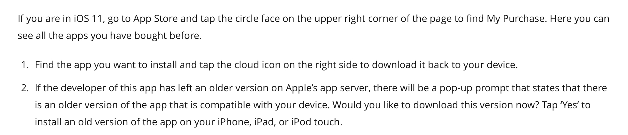

Using BLEvo for years 🙏🏼 on my 2019 Kenevo Gen 1 with an iPhone 6 Plus. It’s no longer updated by Apple and can’t get my rides to upload to Strava anymore. The authorize screen bounces back and forth from BLEvo to Strava and back. Any work around?
I’ll answer my own question. I was able to load an older version of Strava and now BLEvo will upload rides again to Strava.
