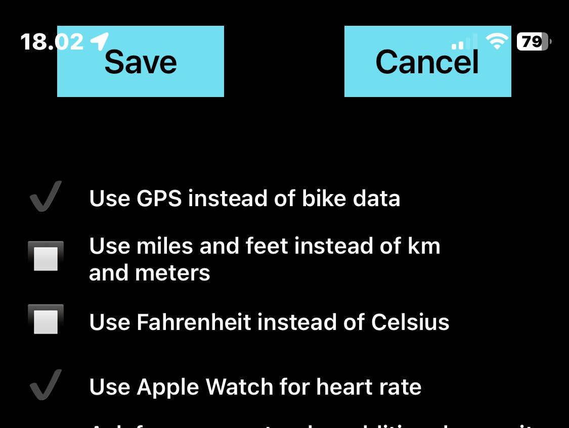

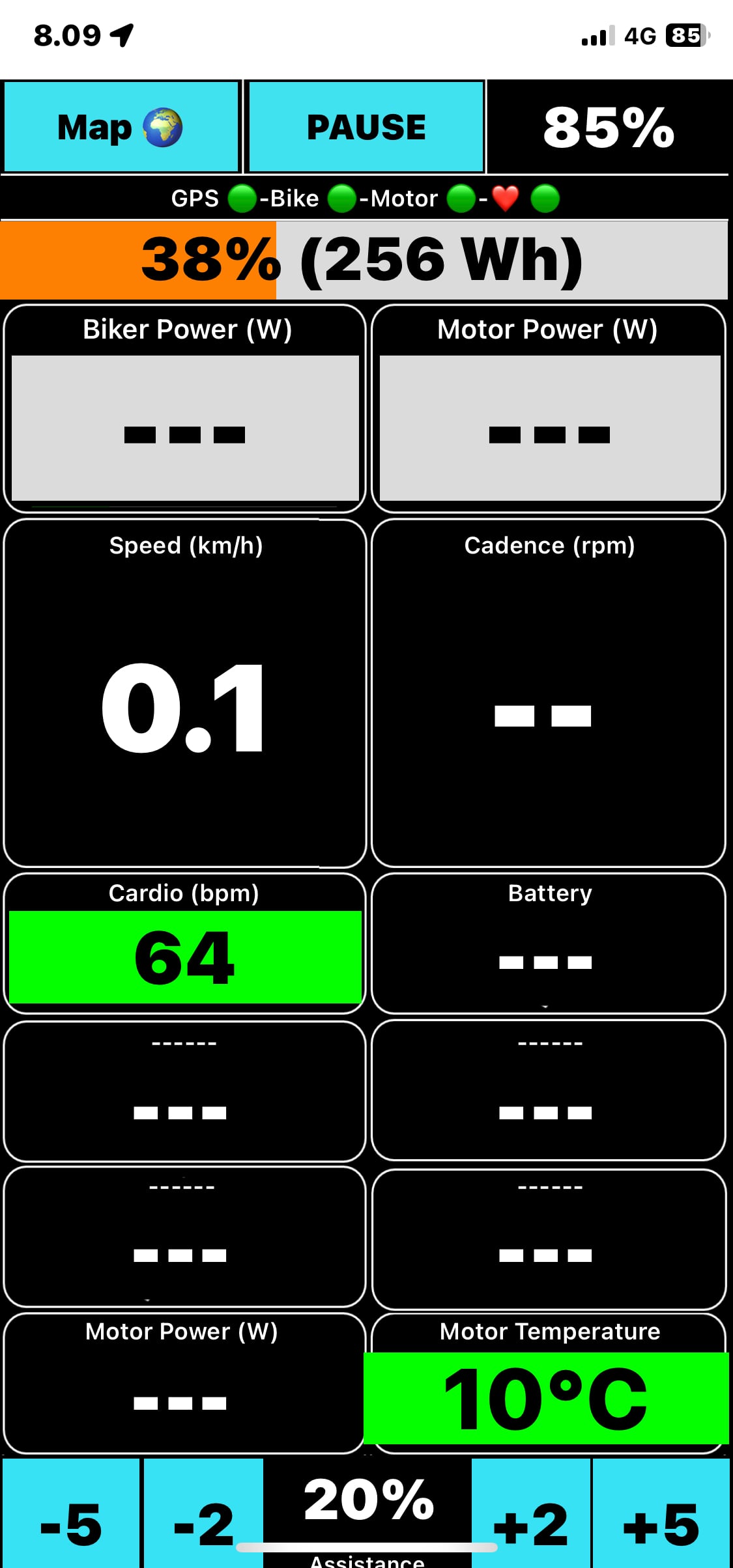

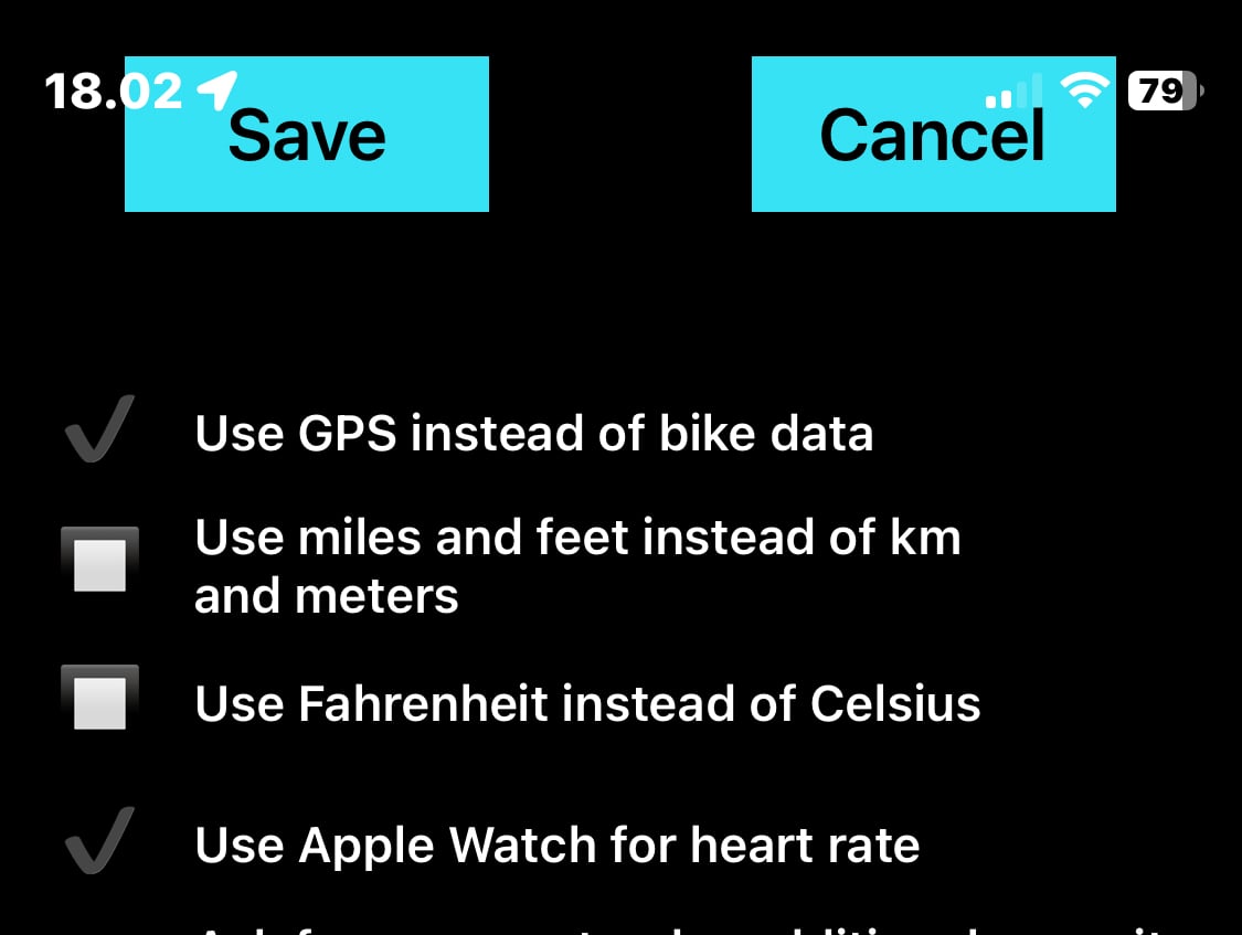

Has anyone succesfully paired Apple Watch Ultra with BLevo?
This is what i got when i first powered Levo and and opened BLevo. When riding at first heart rate stayed that same 64(not measuring anything?), then it became totally blank. So i finally put Strava on on my Ultra, seems to a better option. :D
What else i have to do than this?

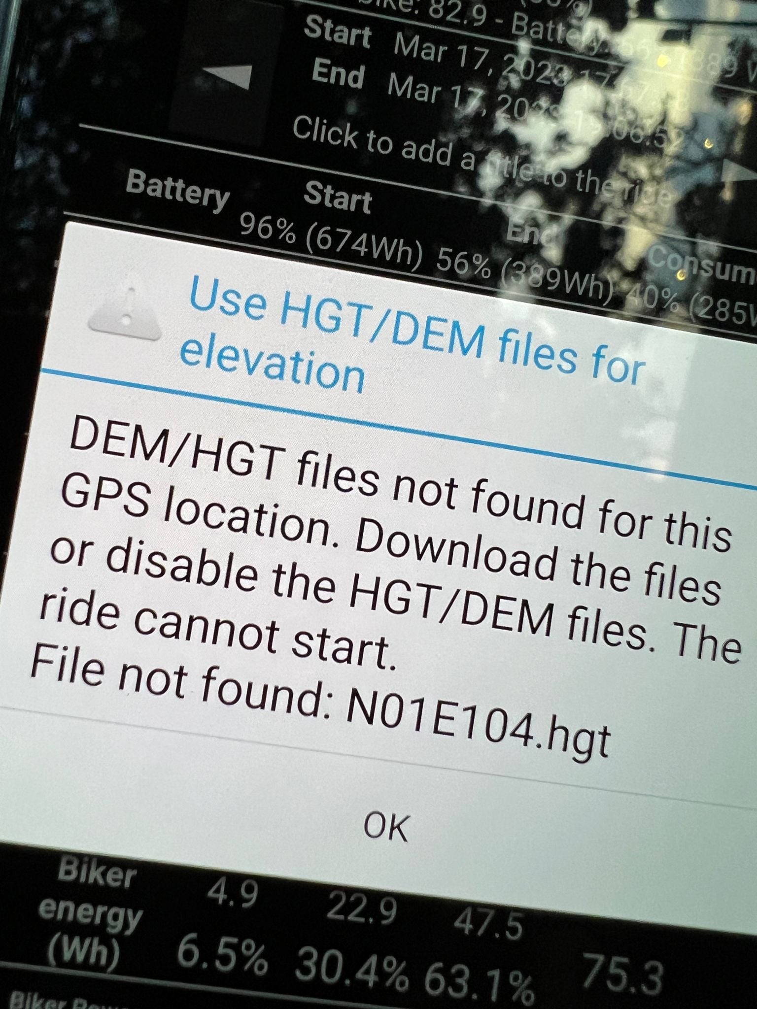

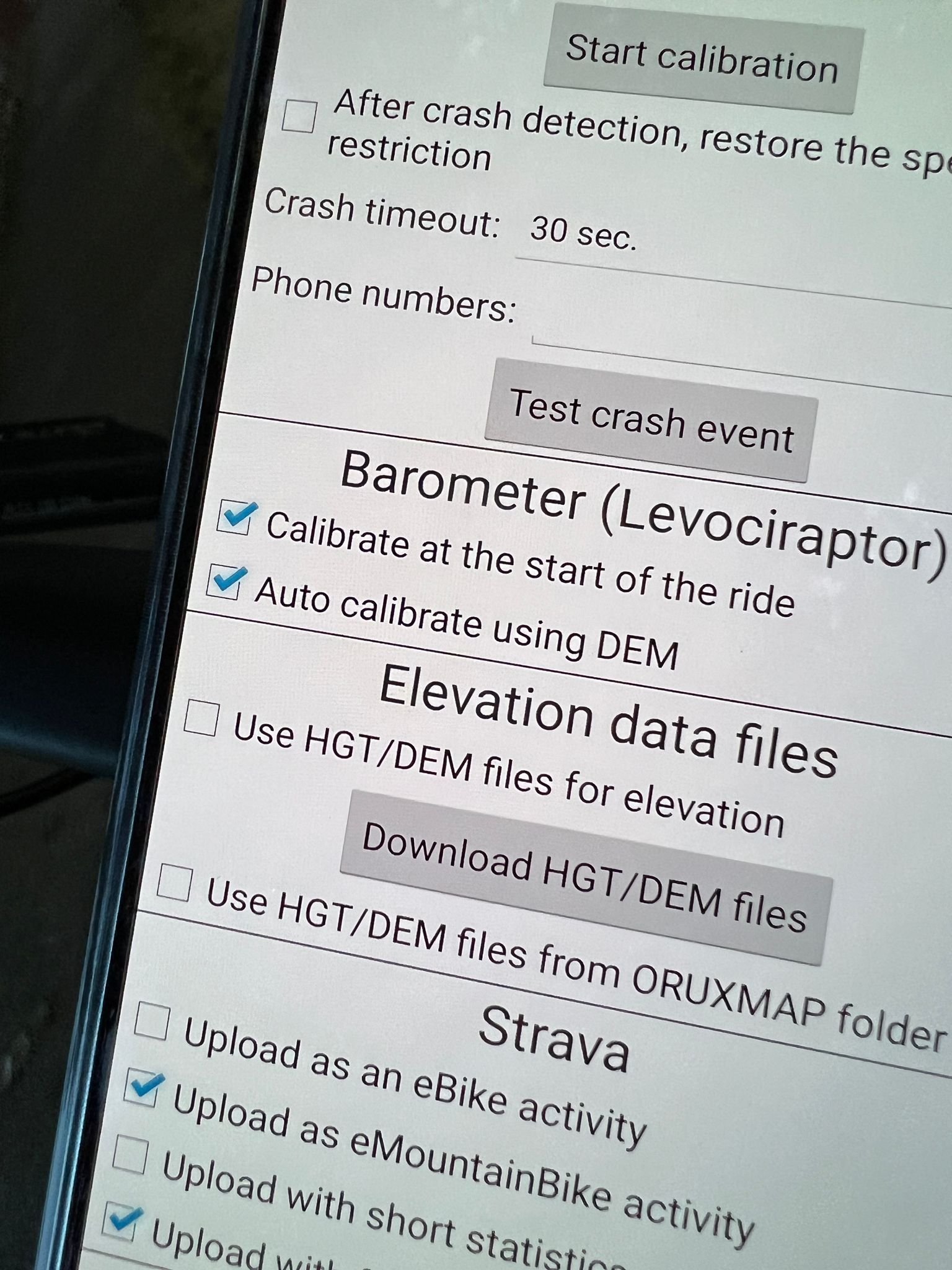

hi need advise , each time thew apps when to sleep and when i want to resume the ride its kept showing this . in the end i have to start a new ride. i have already un check the hgt/dem amd did not able to restart too. pls help
WhatsApp Image 2023-03-20 at 16.43.50 (1).jpeg WhatsApp Image 2023-03-20 at 16.43.50.jpeg

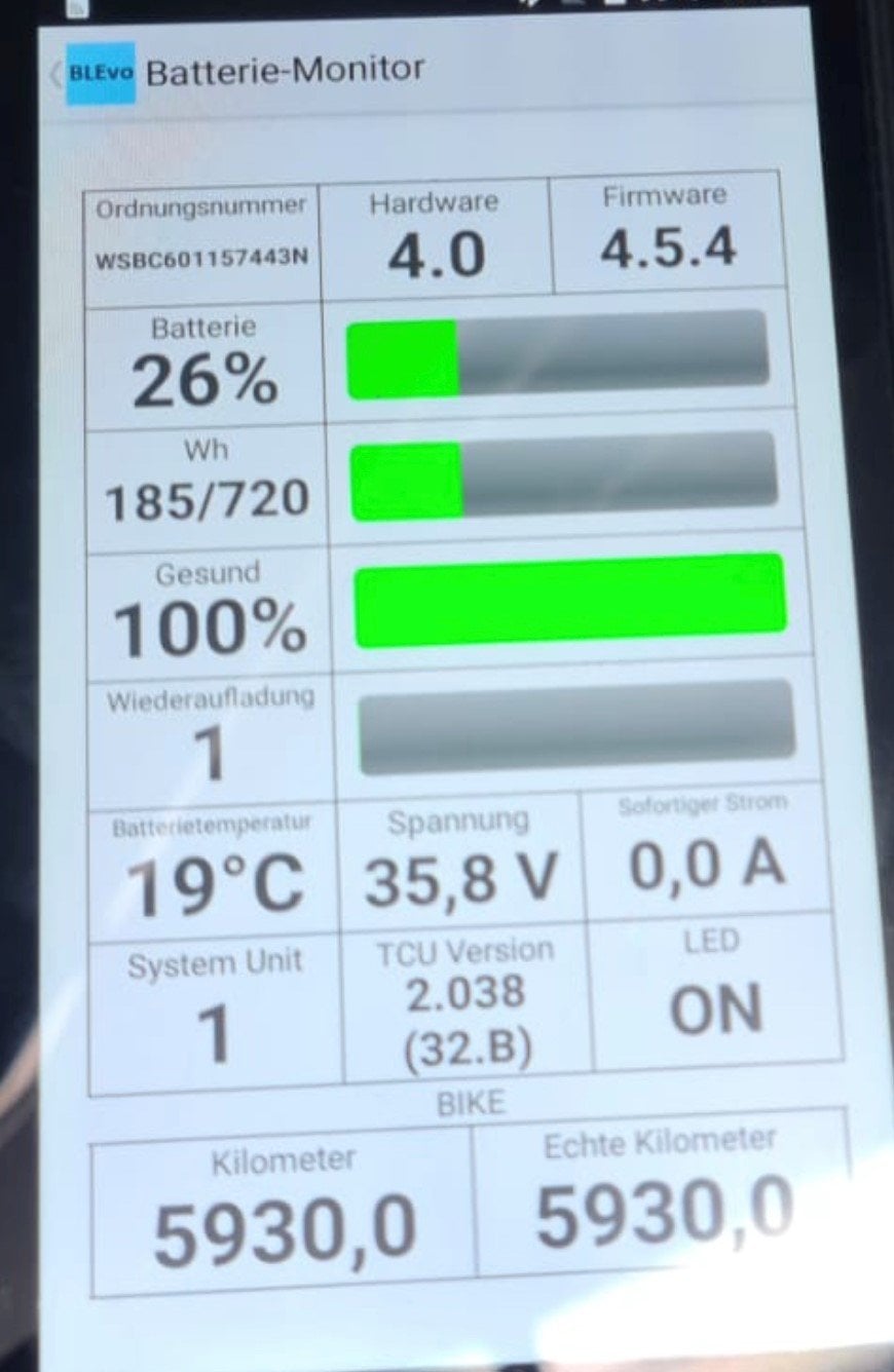

Hallo, ich habe einen neuen 700Wh Akku erstanden.
Wieso zeigt er 720Wh im Batteriemonitor an ???
Ist das Normal? 20Watt extra wäre ja nicht schlecht...

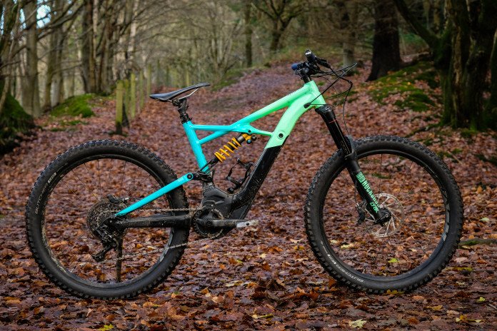

Hi, can I destrict my speed limits using Blevo? My bike is Kenevo 2018 gen1 with 7.1.1 firmware аnd battery firm A.21.B ?
Pretty sure you need a Levociraptor or other hardware type device to enable derestriction. Once you have the Levociraptor then Blevo will set the level above 1:1 that you choose.
At least with older firmware versions, you could get a changed tire size from Blevo, which then affected the speed. I don't remember in that 7.xx version, but you'll find out if you try
