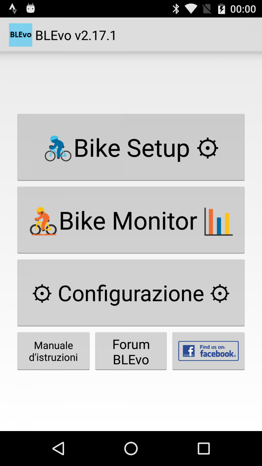

With many members now using BLEvo I thought that we could use this thread for all discussion, FAQ etc on it.
Great that we have the developer of BLEvo @PaoloBLEvo now registered to answer any questions or to give feedback to. Welcome Paolo and thanks for joining.

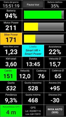

Hi Paolo,
I have just purchased your App and I am following your suggested guidelines so I don’t void my warranty.
Your App really is far superior to the Mission Control App ?????. Why they do not have a heart rate monitor function in Mission Control in my opinion is crazy especially when they have a built in Power meter.... ?
In the statistics for a completed ride that your App displays I see Average heart and Maximum heart rate which is perfect for me.
I also see,
Average cadence on ECO, TRAIL and TURBO
Average Biker Power on ECO, TRAIL and TURBO
Average Motor Power on ECO, TRAIL and TURBO
I have a question for you.
As I am not a developer I do not know how difficult it would be for you to add the following:
Maximum cadence on ECO, TRAIL and TURBO
Maximum Biker Power on ECO, TRAIL and TURBO
Maximum Motor Power on ECO, TRAIL and TURBO
Is adding the above 3 items possible in a future update?
