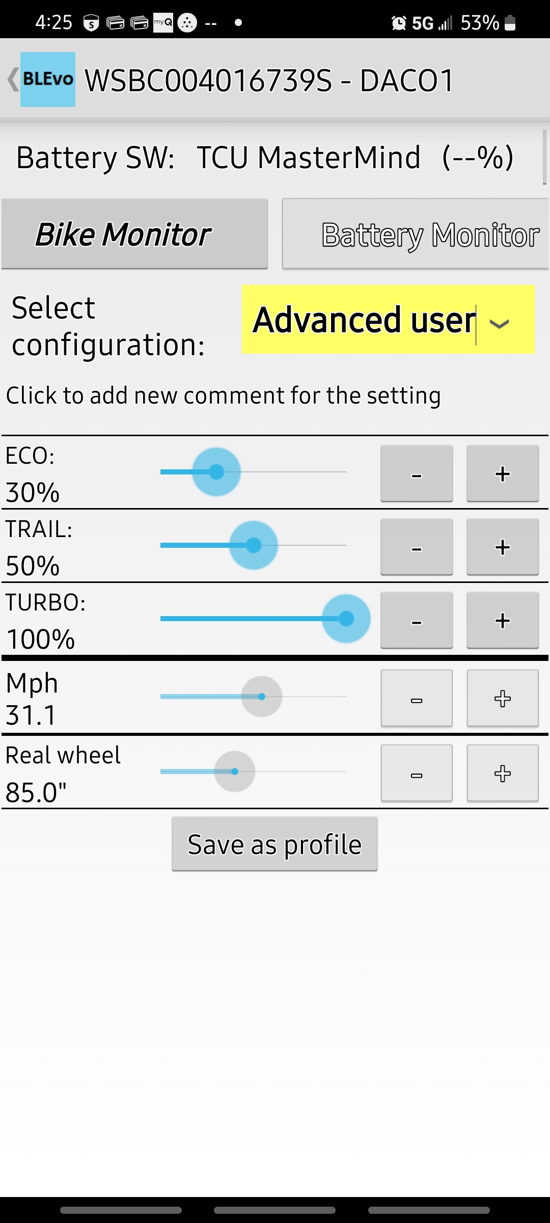

Is there a way to change the yellow background with white writing? This is near impossible to see in direct sunlight.

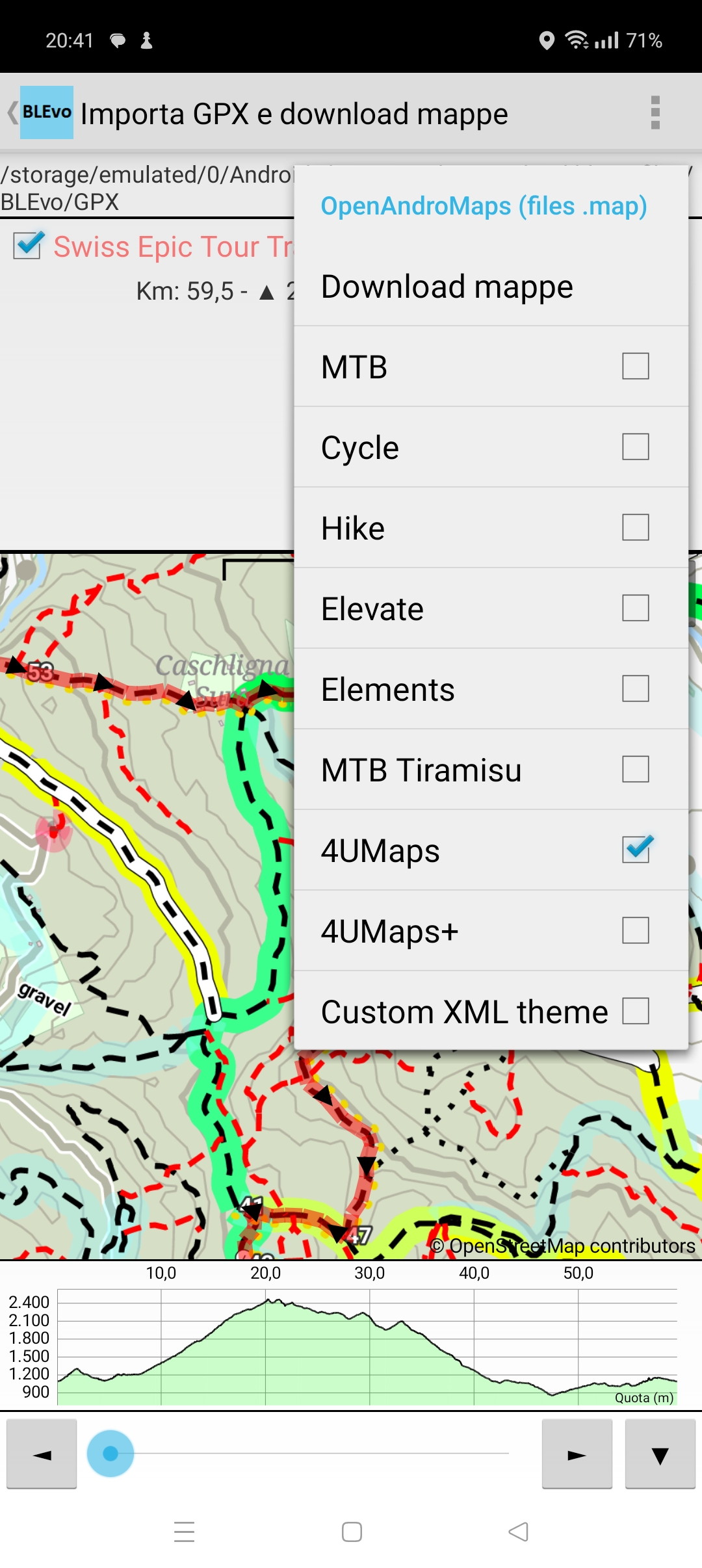

After a really long time, I release a new version of BLEvo for Android (version 3.13.0).
Most likely the previous BLEvo version did not work properly with Android 14. Now the problem should be solved.
This is the list of changes made:

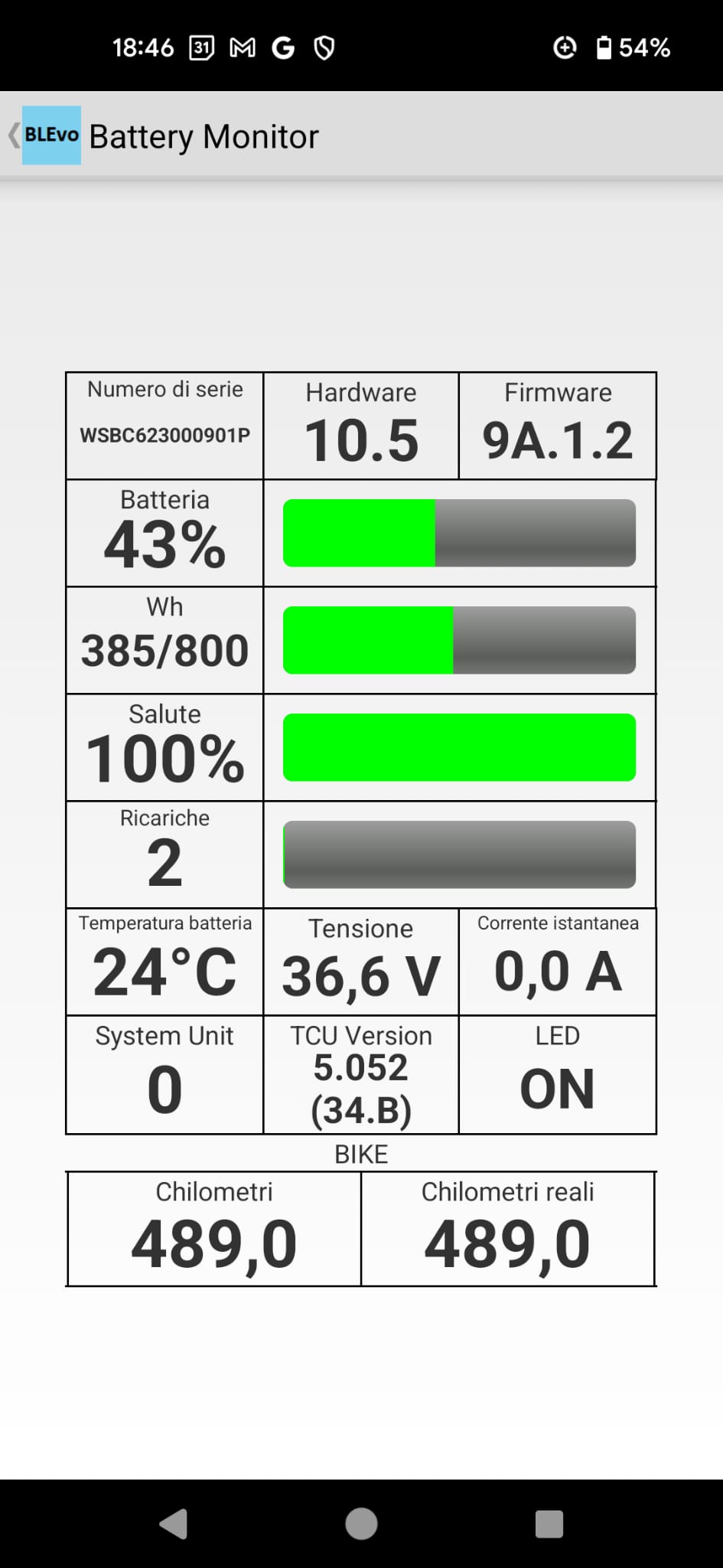

- Added battery management by Riccardo Michelin. Contact him on Facebook to have battery up to 900wh
- Added average consumption statistics for ascent (thanks to Mato Ba)
- Added AndroMaps map with 4UMaps theme (thanks to Lluis Nogueras)
- Added POST_NOTIFICATIONS permission request for Android 13
- Fix compatibility with Android 14
I attach the screenshots of the news
