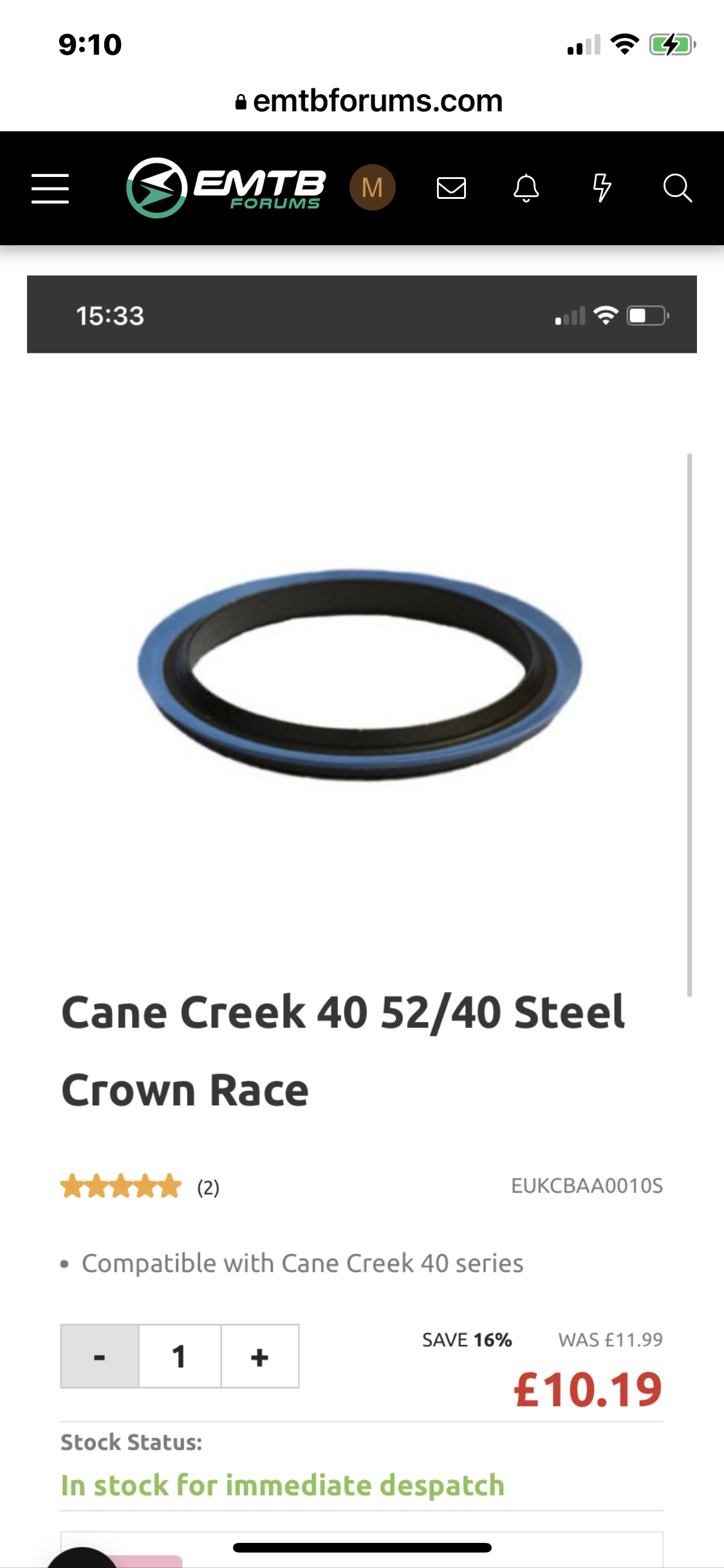

Does anyone know if I need to change the headset on a 2022 Kenevo Expert to install a Fox 38 from the standard Boxer?
I got this one…. Seems to work

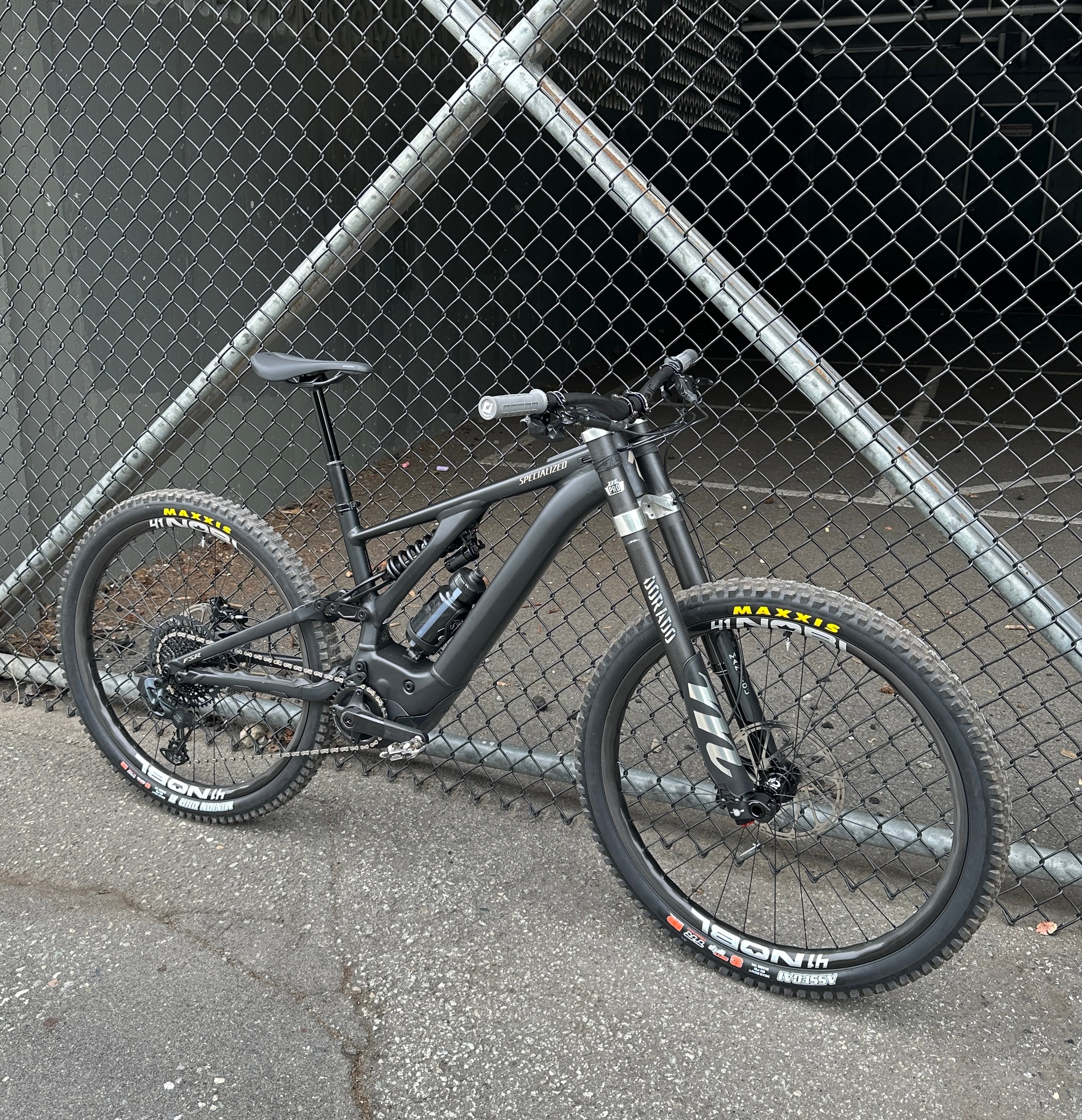

Kenevo Comp 2021 and RaceFace NW 36T.
It's still holding up, but maybe next time I'm going to look for one made out of steel.
IIRC I had to switch the chain guide to point back and then down instead of down and then back for it to fit.
Thanks. I’ve got a Hope spiderless chainring in a 36T coming.
