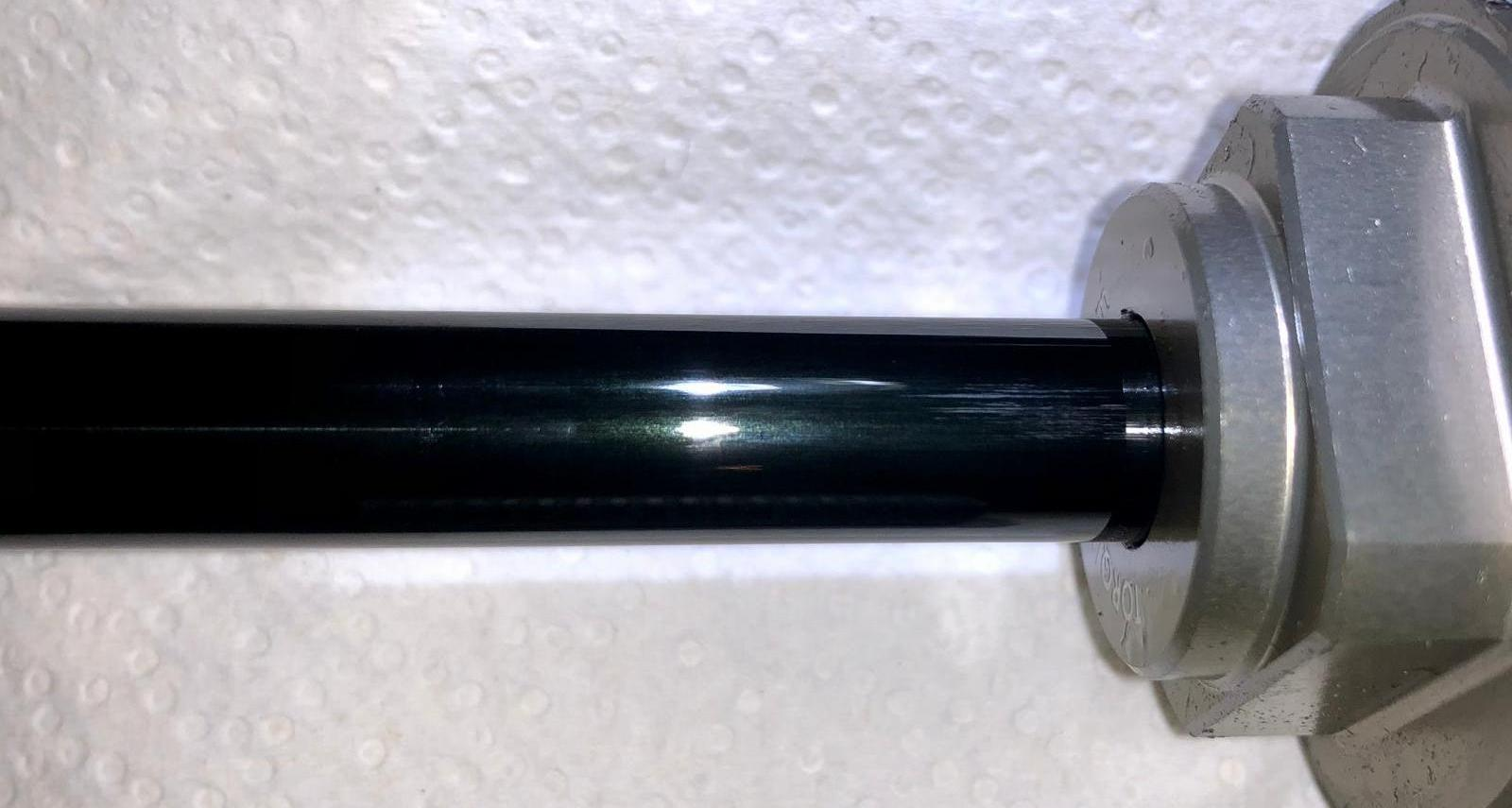

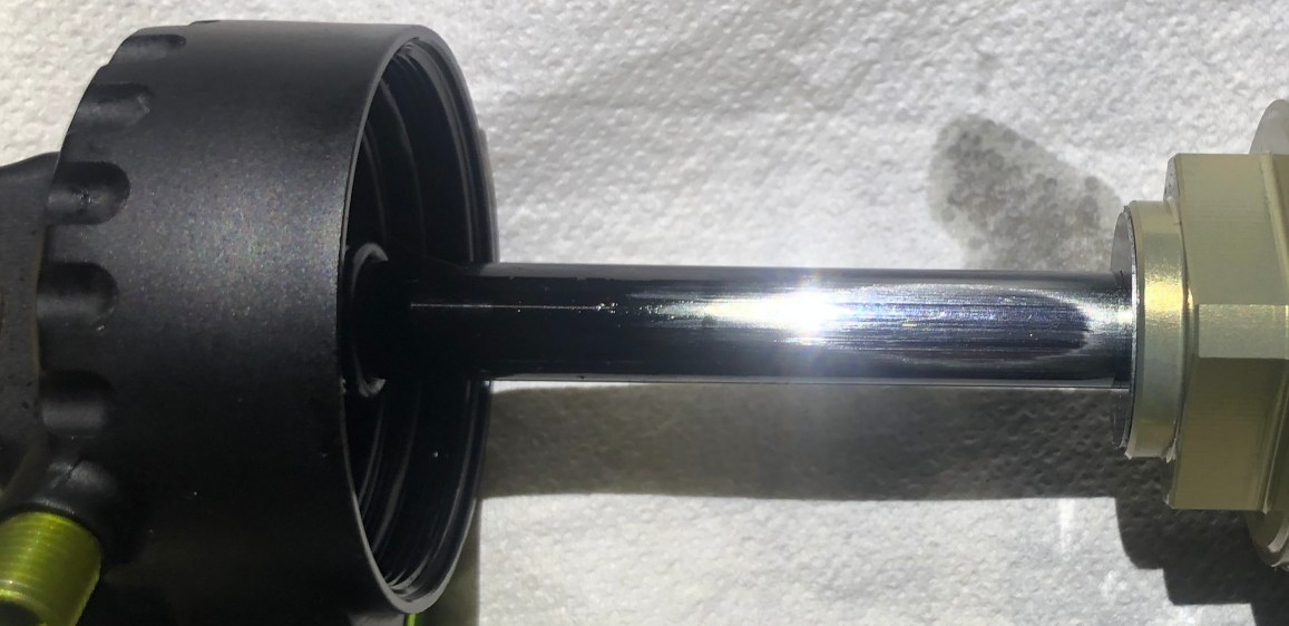

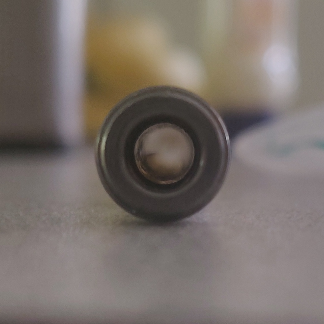

I've been looking for a new affordable shock since my current DVO Topaz T3 Air gen2 has broken multiple times now, it seems to last for 6-12 months before the damper shaft begins to wear down and lose air during riding.
This is the first defect, with very obvious wear:
And the second one just now. Not as noticeable, but enough to lose ~15 PSI during a ride:

I have the DPX2 as well from the 2021 Comp model, which I then swapped for the DVO Topaz. The Topaz is far better performance-wise, but the DPX2 has a 12.7mm steel shaft, so that's probably why they used it.
(Also, the DPX2 has pretty quickly sucked air into the oil, which seems to be a common issue for this shock and an additional reason why I don't just want to revert to it)

It needed a new steel shaft due to scoring. The scores were so fine I wouldn't have even noticed them myself. Certainly nothing like the picture posted above. It's a cheap part though.

I was surprised how big the hole is in the centre of the steel shaft.

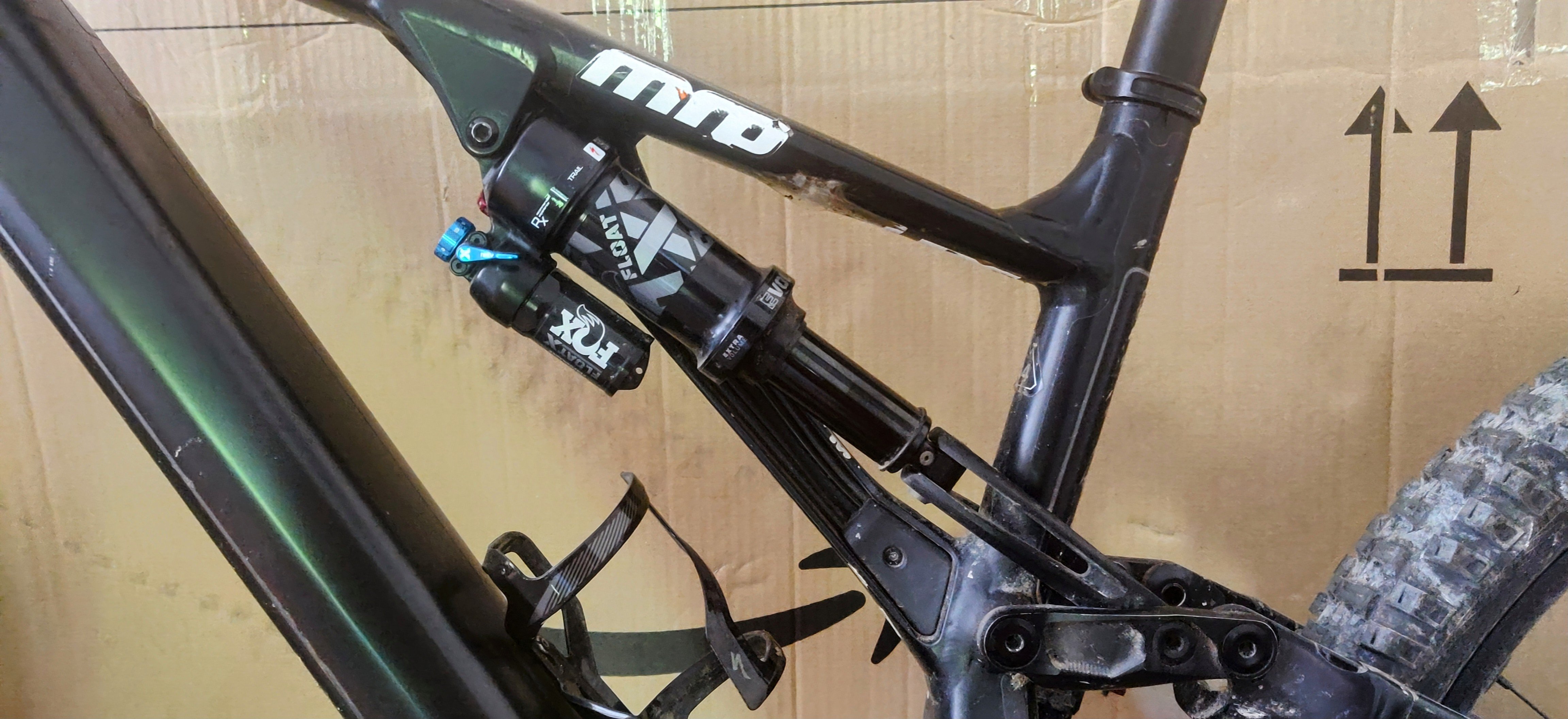

Ive just tested the fairly basic fox float x that came with my kenevo sl comp on my full power.
Mainly as i was pretty impressed with the sl's suspension performance.
Yes i know the sl has a more sophisticated linkage and that's probably the difference i can feel.
It felt pretty damn good. I doubt in a blind test i would even notice the difference between this and my ohlins coil.
Ive had issues with previous x2 and dpx but im certainly in no rush to refit the coil.
Now if the sl came with the full power motor and swappable batteries, that would be the dream bike.
Now the sl with the full power motor and swappable batteries, that would be the dream bike.

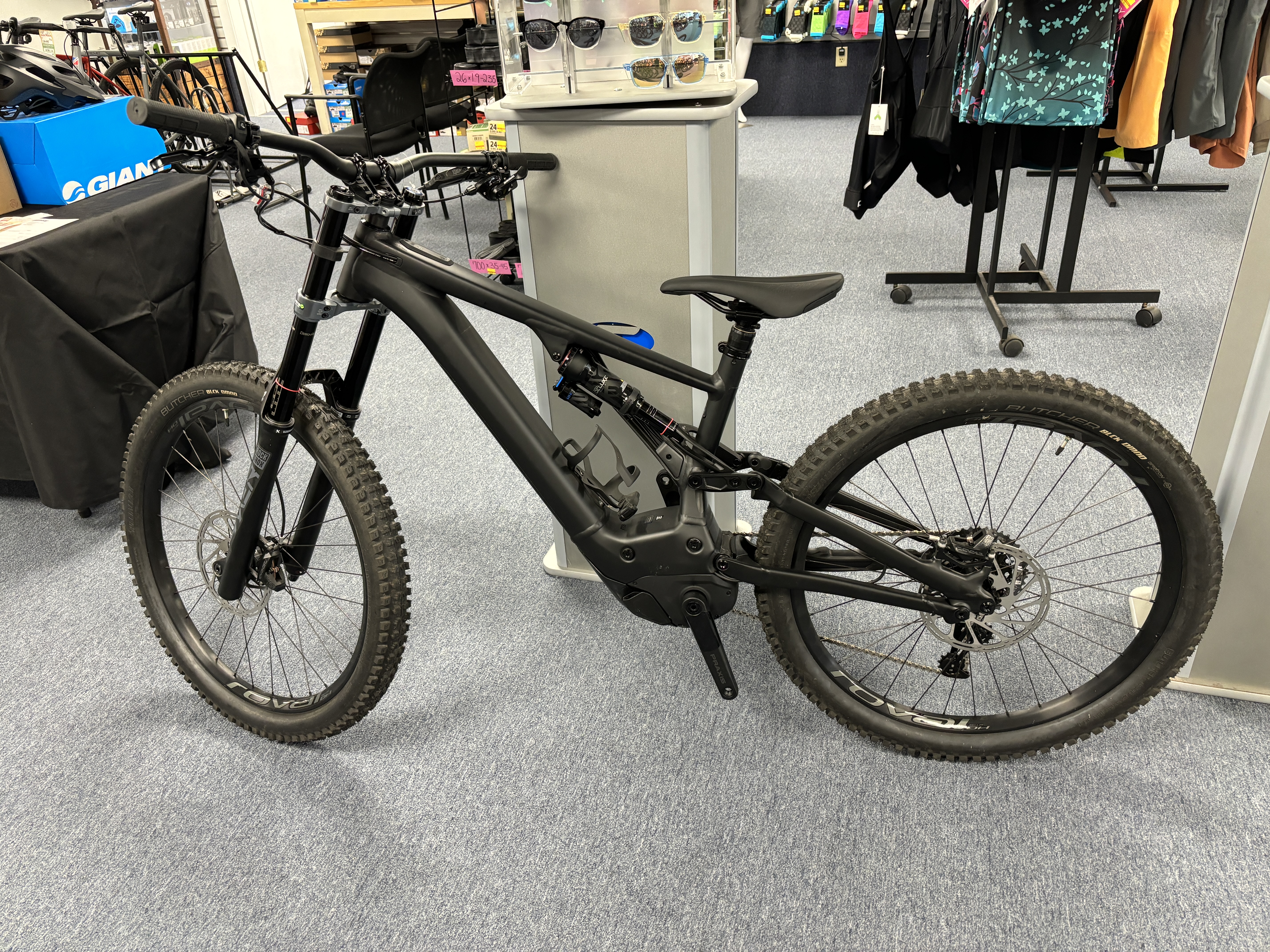

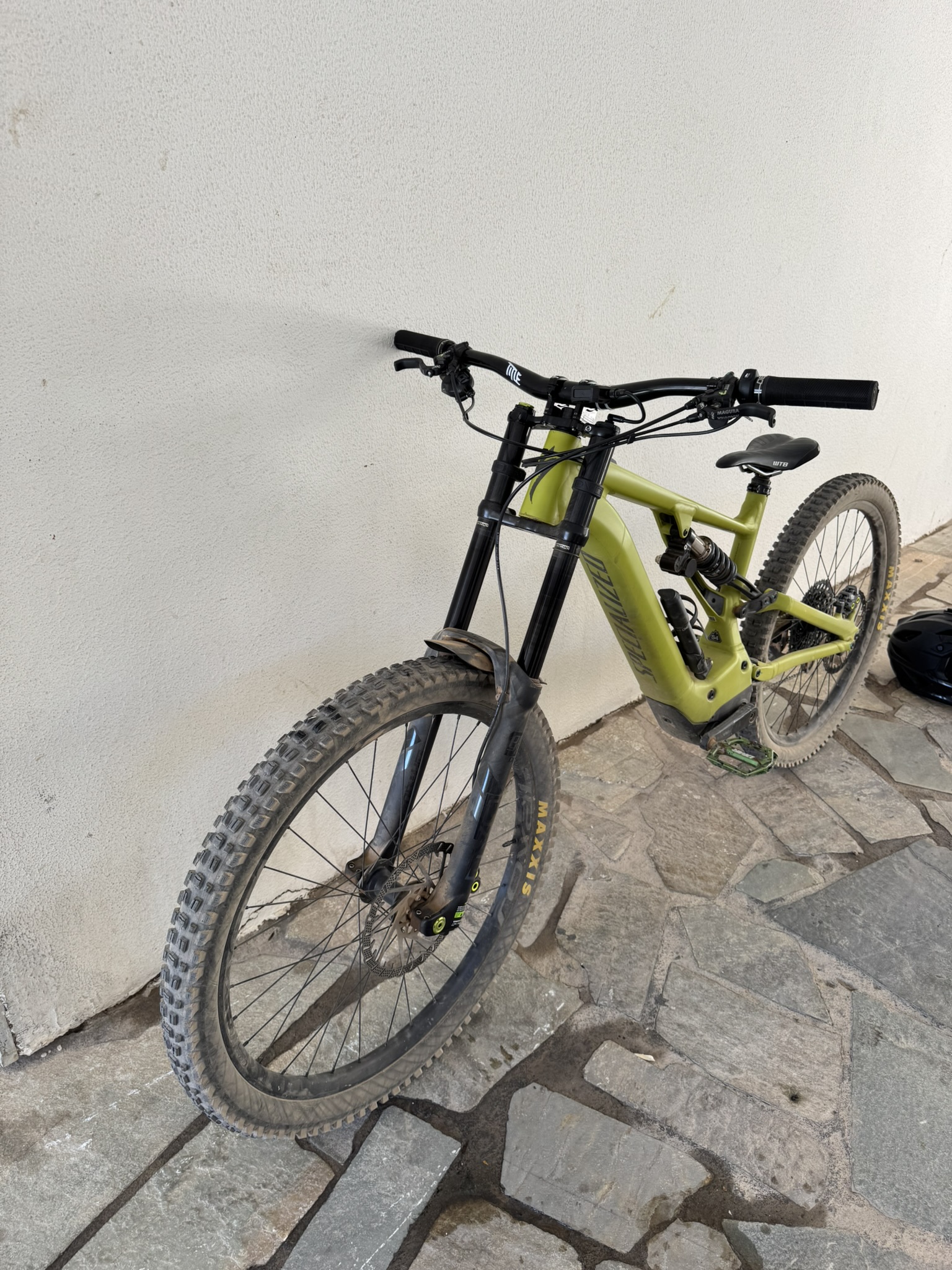

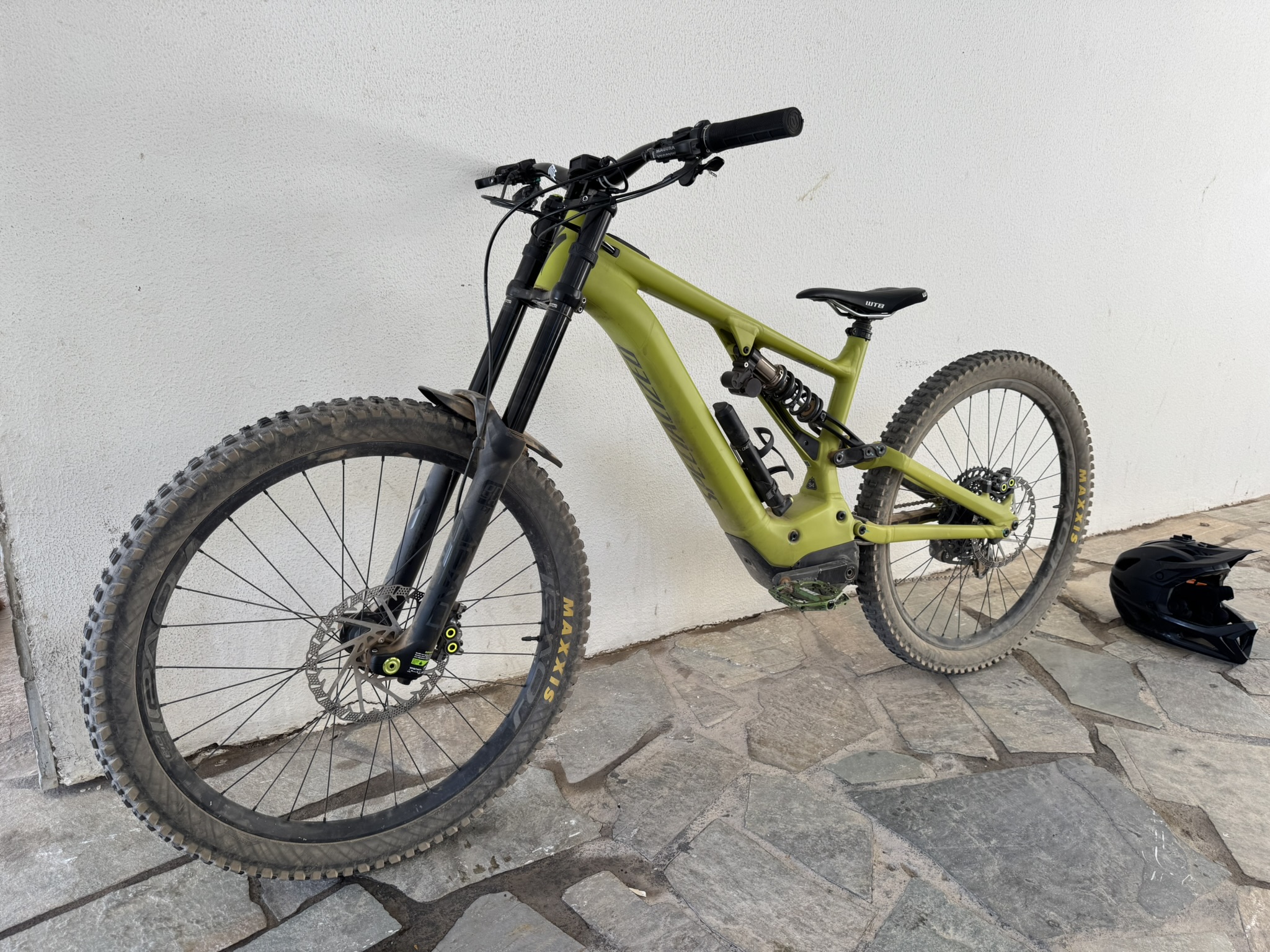

Just bought this 2021 Kenevo Expert last weekend! Guess you can call it new old stock. Bike shop owner had it parked in his garage for years and never rode it. It had 3 miles and 1 charge cycle on it and I was able to register it as new with Specialized with full warranty. Was riding an Giant Trance Elite "SL" bike that weighed ~46 lbs, and I dont mind the extra weight of the full fat Kenevo at all...this bike rides and feels amazing and I love the plush suspension travel at the bike park. So glad I was able to find this bike since they quit making them.

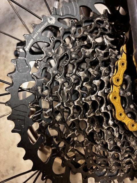

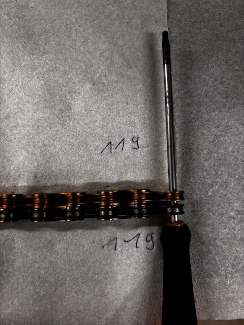

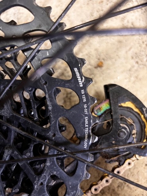

I have a question about changing the chain on my 2023 Kenevo. I did 2200 km and noticed that the original chain needed to be changed. This was checked with Topeak Chain Hook. I made checks periodically. I replaced chain with an XX1 chain (gol one - 00.2518.024.020), which skips on the rear cassette XG-1275 10-52T. It looks like the casete is worn. There were no problems with the old chain before. Do I have to change cassette already? Or did I buy wrong chain? During replacement I noticed that links of old chain are maybe a little longer then on new chain.

May I recommend your first mod be a 200 mm air shaft for the boxer.
I have a question about changing the chain on the Kenevot. I did 2200 km and noticed that the original chain needed to be changed. This was checked with Topeak Chain Hook. I made checks periodically. I replaced chain with an XX1 chain (gol one - 00.2518.024.020), which skips on the rear cassette XG-1275 10-52T. It looks like the casete is worn. There were no problems with the old chain before. Do I have to change cassette already? Or did I buy wrong chain? During replacement I noticed that links of old chain are maybe a little longer then on new chain.

I have had to change my chain every 500 miles to protect my cassette and chain ring. I think you went to long.
Does going from 180mm to 200mm change the Boxxer axle to crown length and raise the front of the bike 20mm? If, so I guess that would helps with pedal strikes and rake the bike more?
Yes and no.
The kenevo comes from the shop with the 180 a2c at about 570mm, i guess to match the single crown fork of the comp.
The actual a2c from rockshox is 560mm. The 200mm boxxer has a 580mm a2c.

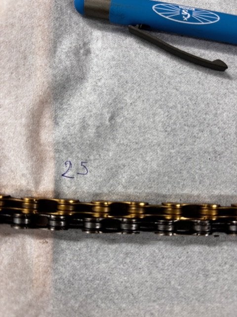

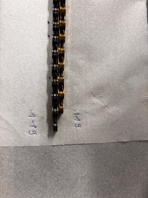

I checked both chains one near the other and I see that I need to replace my topeak tool. Both chains have 119 links and old one is longer for one link. In just 25 links there is aprox 3-4mm difference in length. I think that I have to consider going to Shimano... At the moment I need front sprocet and rear cassette.

May I suggest staying away from alloy anything. I converted my rear wheels to hg drivers so I can run nx cassettes. Gx and the XO cassettes have 2-3 alloy cogs, great for weight reduction, bad for parts lifespans. The front cog is a steal 32 tooth 104 bcd ring. Please avoid trying an alloy chain ring , I have a buddy with a Levo that destroyed one in a couple months.
