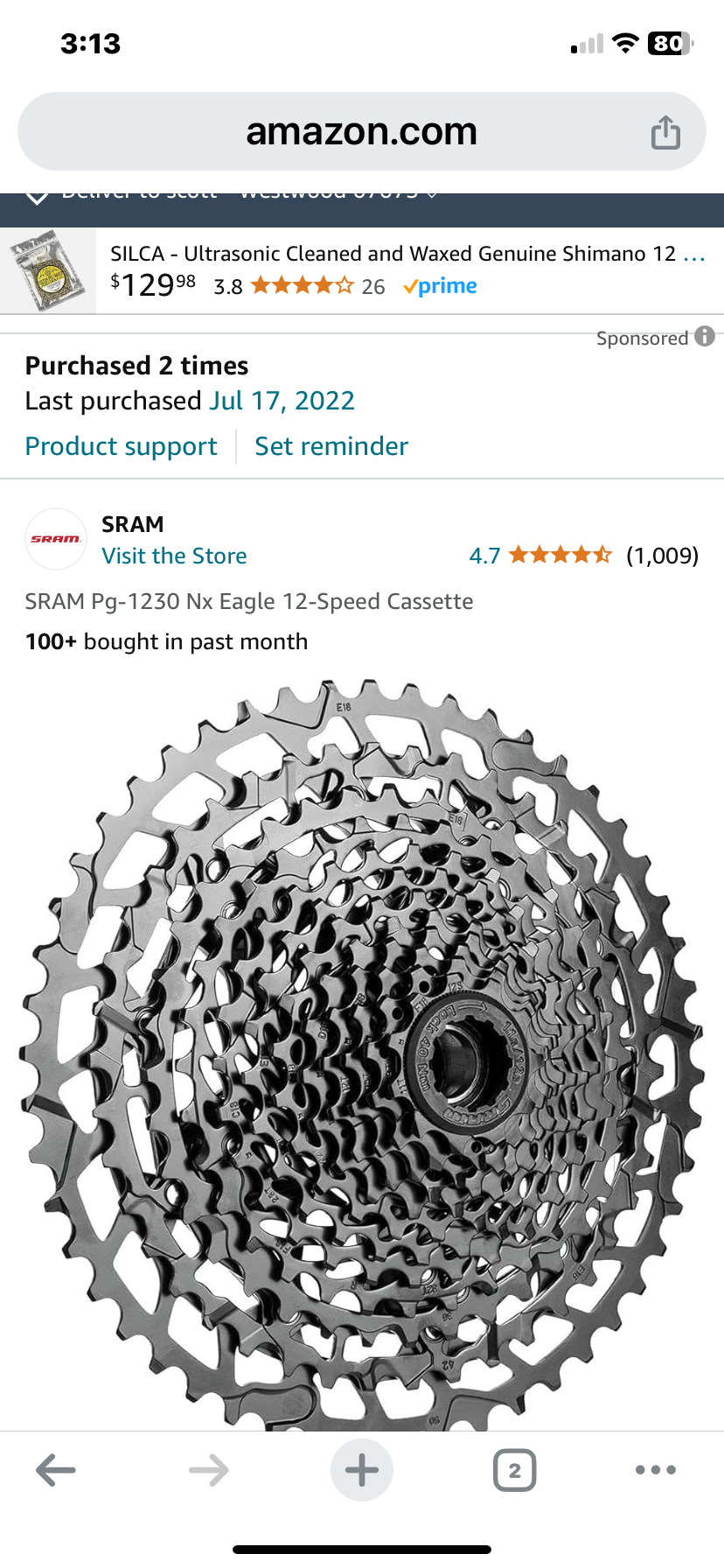

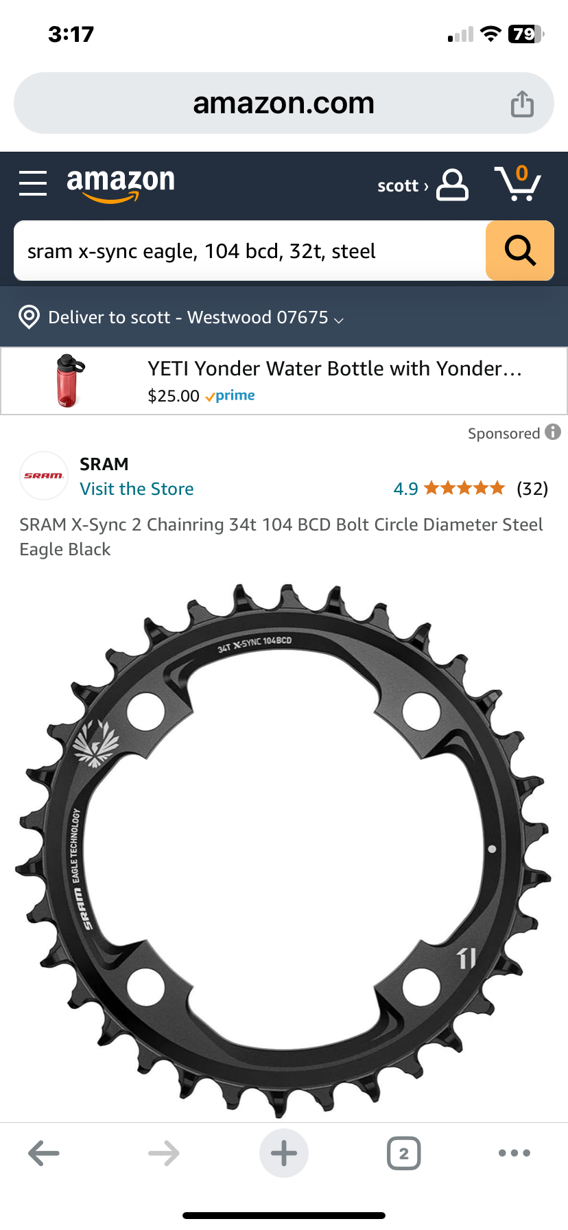

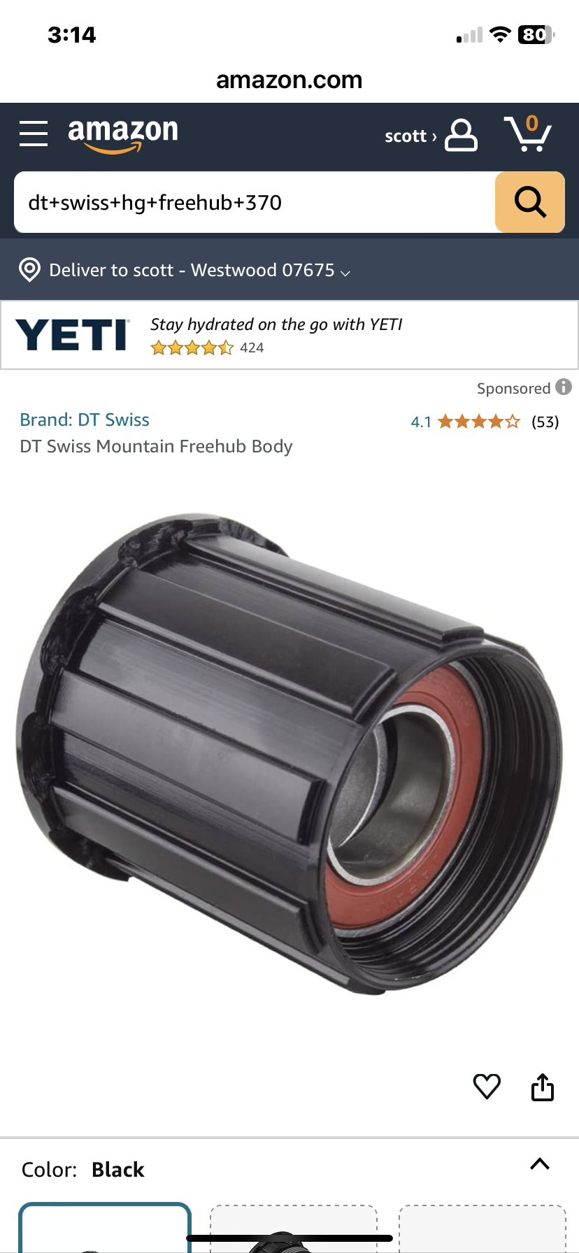

May I suggest staying away from alloy anything. I converted my rear wheels to hg drivers so I can run nx cassettes. Gx and the XO cassettes have 2-3 alloy cogs, great for weight reduction, bad for parts lifespans. The front cog is a steal 32 tooth 104 bcd ring. Please avoid trying an alloy chain ring , I have a buddy with a Levo that destroyed one in a couple months.
Can you give me advice what to get? Which Cassette and front ring?
Pretty sure these will do it, your rear hub should be the ratchet style rather than the 3 paw dt Swiss. I have seen on other forums some of the dt Swiss 370 rear hubs were paw style so you should check it.

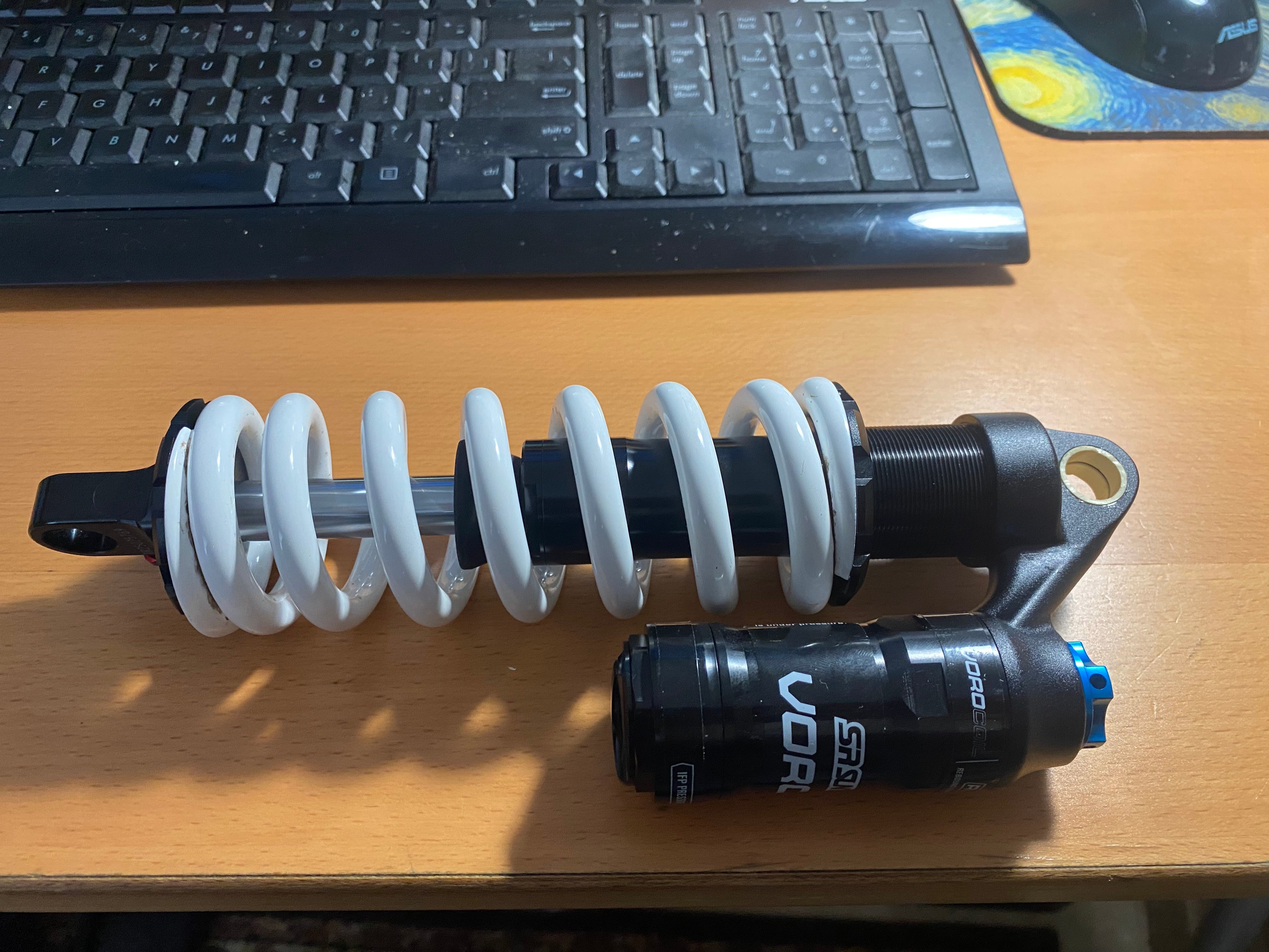

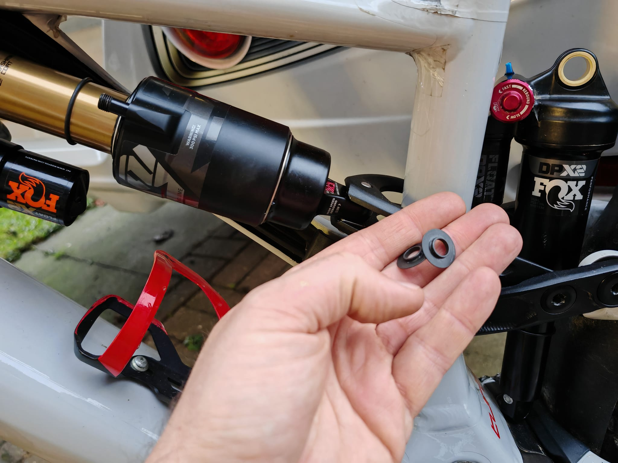

Also whilst I'm here, Just swapped the original Fox DPX2 for a shiny new Factory X2 on my Kenevo and seem to have these 2 spacer looking things left over and no idea where they are from
I've triple checked the upper and lower shock mounts plus the horst link bolts but they won't fit in any of them and I only undid these - anyone recognise them

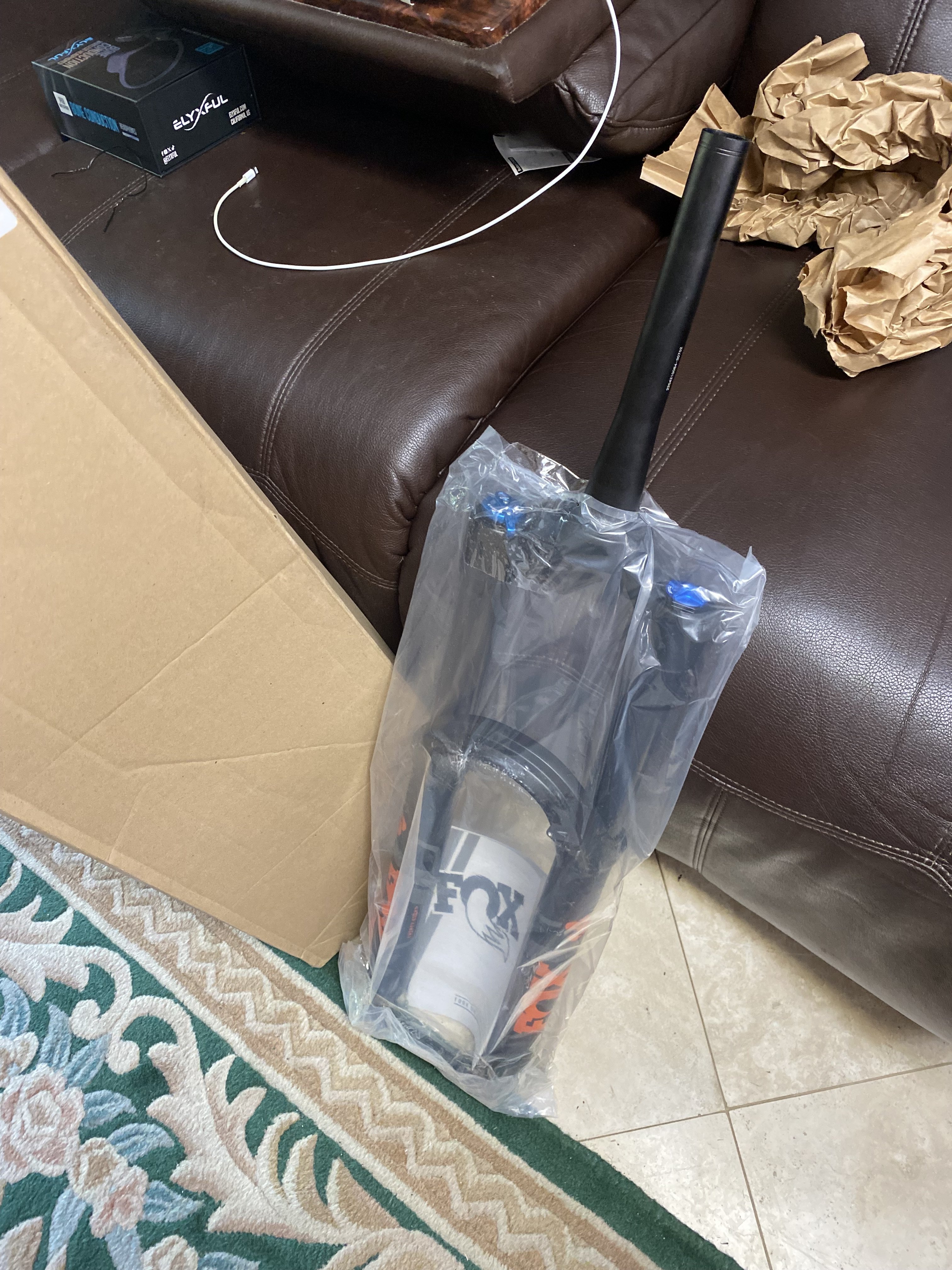

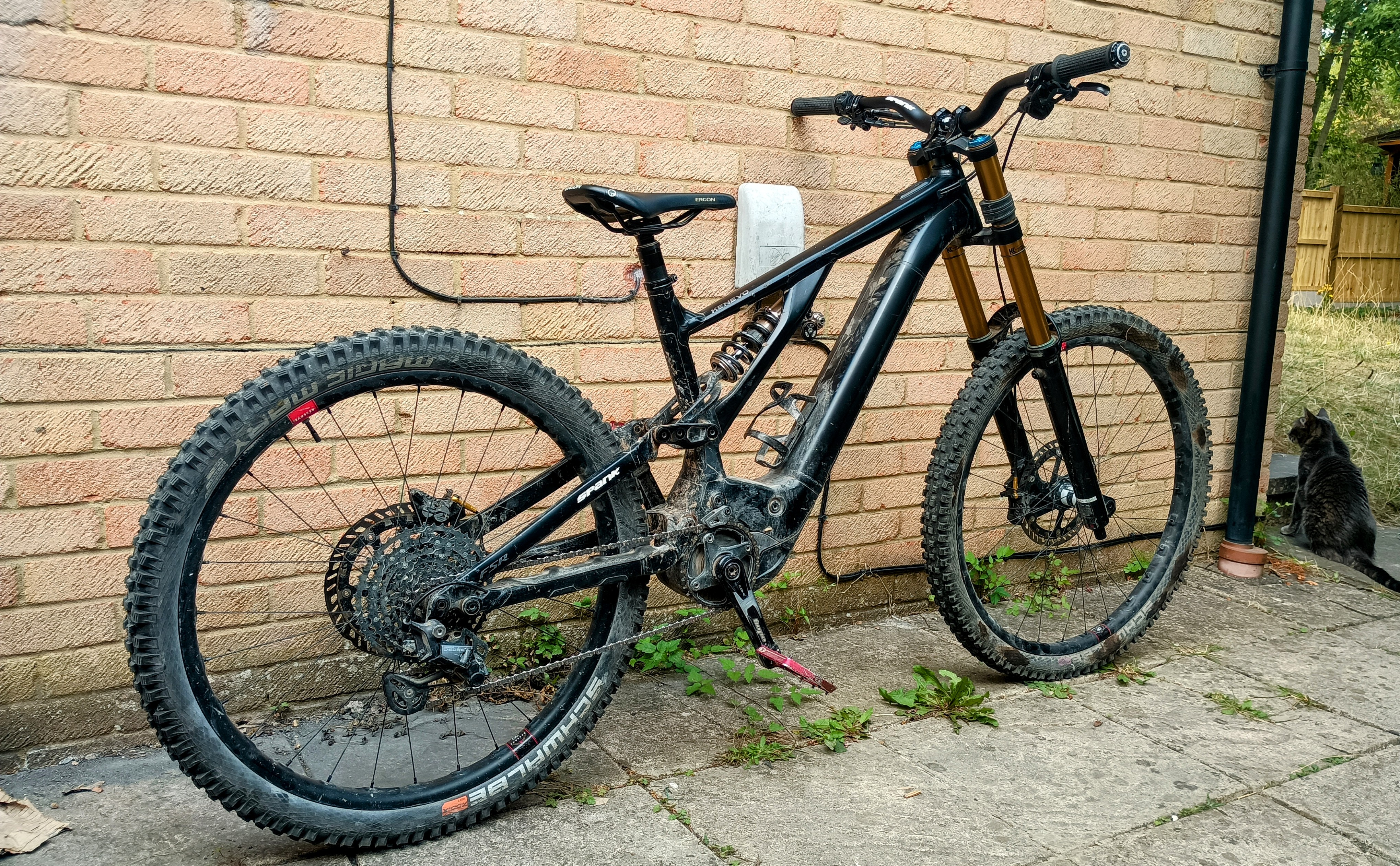

May I recommend your first mod be a 200 mm air shaft for the boxer.
So by what you say, I assume it's the same fork, just a different air shaft?
I'm having some trouble with the 180 mm boxxer, so considering complete replacement or maybe some kind of upgrade...
It's took me three and a half years to get happy with my Boxxer 😅 I think the most important things were fitting a Charger Damper 2.1 and then having it tuned by JTech. The JTech tune was the main thing but they couldn't have done that on the Select damper.
I also have the 200mm air shaft and recently switched back to the 180 out of curiosity. The fork performed fine but I preferred the geometry with the 200 so switched back again. That was a little surprising given I also fitted 29" lowers/wheel so the geometry is waaaay off stock (61 degree head angle) but it feels good so I'm sticking with it. I do have a 65mm stroke shock and the flip chip in high which offsets it a little.
Anyway, if I bought another Kenevo Expert, I'm not sure if I'd go with all the mods or sell the Boxxer unused and get a Grip X2 Fox 40 (very happy with one on another bike), or maybe try a Dorado / Ohlins DH38..

My current setup is a s3 with a suntour voro 230x65 rear shock, a Fox 38 e- tuned 170mm 29er. The bike is mulleted with 2.8 rear tire on a 38 mm wide rim for tech climbs and a 2.5 29er in front for rollover. The code rs levers were swapped for some code ultimate levers, the bars were swapped with some PNW 50mm rise to increase the stack. Some crap Amazon 155mm cranks takes care of the peddle strikes.
Some notes, the fox 38 e-tuned oem is a fox rythem with a retuned grip damper and a factory air spring and 3 tokens. I ditched the tokens and added the bleeder valves. Great riding fork, I found the 180mm 29er to floppy so I run it as a 170mm. The suntour voro rear shock was pretty much made for the Kenevo, 14mm steel shaft and damping that is great for the low progression ratios of the Specialized suspension. The bike can be a little long for tight trails but once you learn stoppies that can be worked around. Most of the time I use the 500wh battery, drops almost 3 pounds from the front of the bike.
