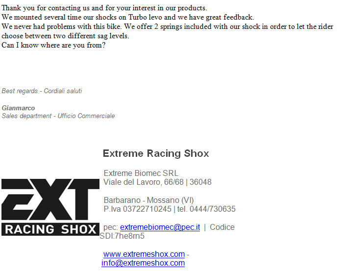

I have a contribution to the thread, and a question:
1. I received the following email reply from Extreme Racing Shox:
2. Big Tuna, did you consider a progressive rate spring? The kinematics analysis I ordered for my Levo shows that the geometry is not very progressive.

Thanks for the contribution, I'll link it in the OP.
