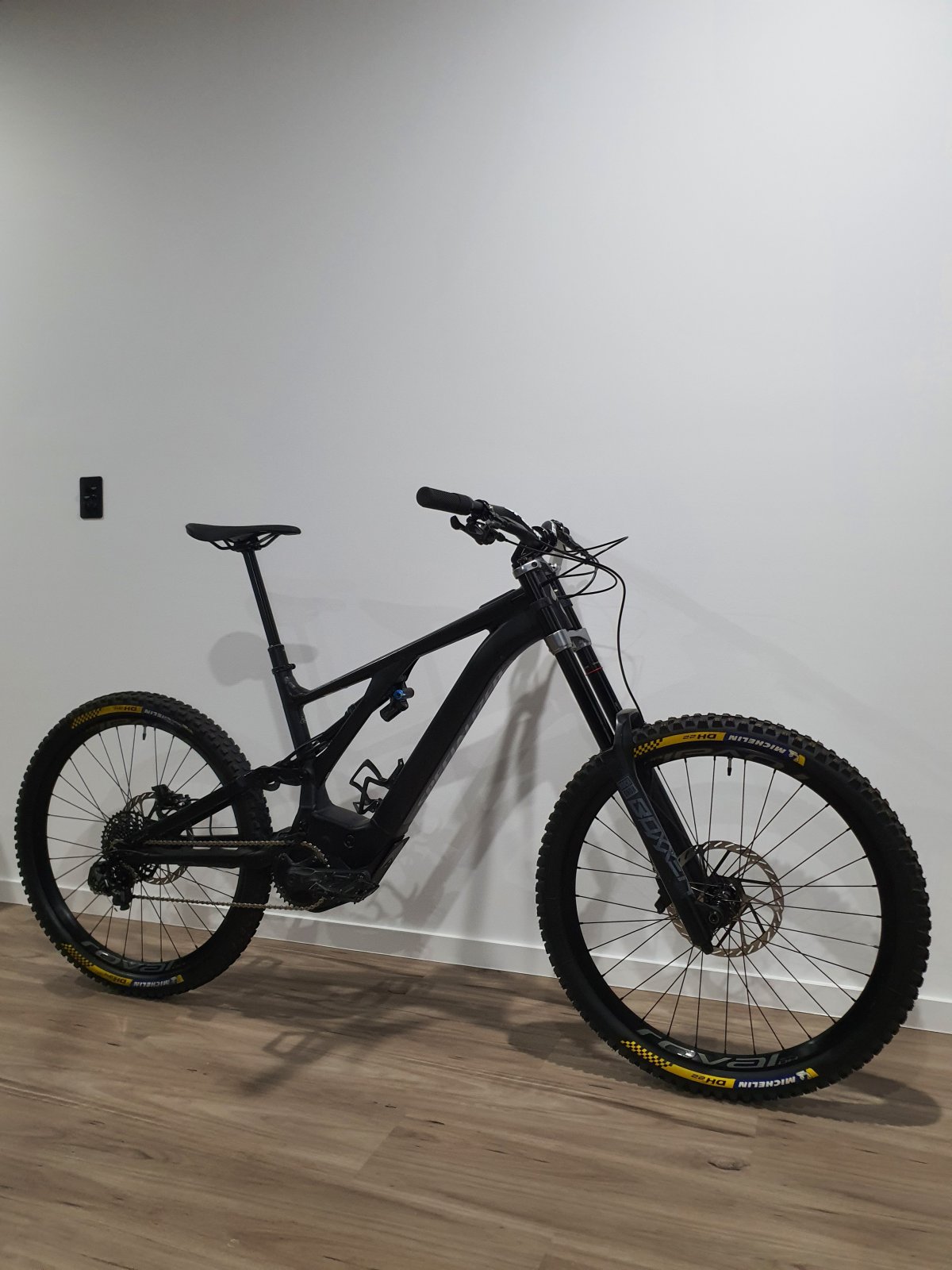

Bolts ground. Oneup 210 34.9 fitted. Any further down and it will foul on motor/cables. Perfect height for me as is anyway. Managed to do it without dropping motor, will have to pull back apart to shorten cable outer though.
Bolts ground. Oneup 210 34.9 fitted. Any further down and it will foul on motor/cables. Perfect height for me as is anyway. Managed to do it without dropping motor, will have to pull back apart to shorten cable outer though. View attachment 91791
Oh that's great news. Looks like it goes pretty low.
Can you do some measurements, total amount sticking out, seat height at full extension from centre of cranks etc?
I assume you didn't grind the dimples off the suspension bolts?

Yeah no worries i'll do that tonight. I did grind off the dimples just in case whilst i was bored waiting for the new seat post to turn up.

46mm sticking out above the seat post clamp.
714mm front centre of crank to centre of seat rail in clamp
