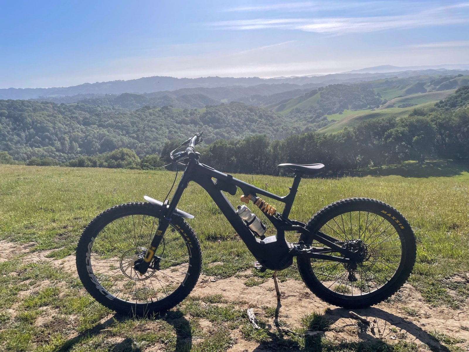

Loving the Ohlins Mullet set up. I am really impressed with fork over high speed bumps. .really smooth.

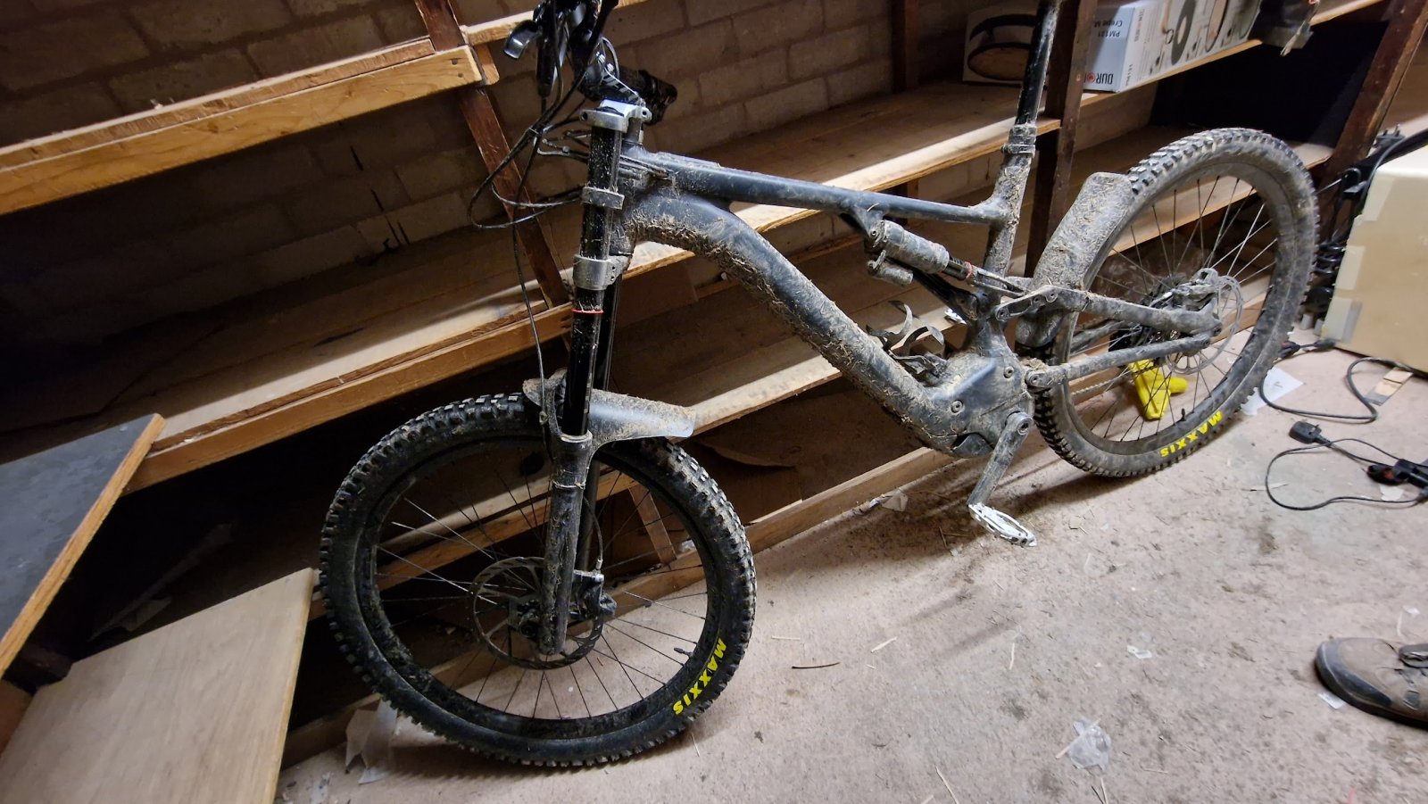

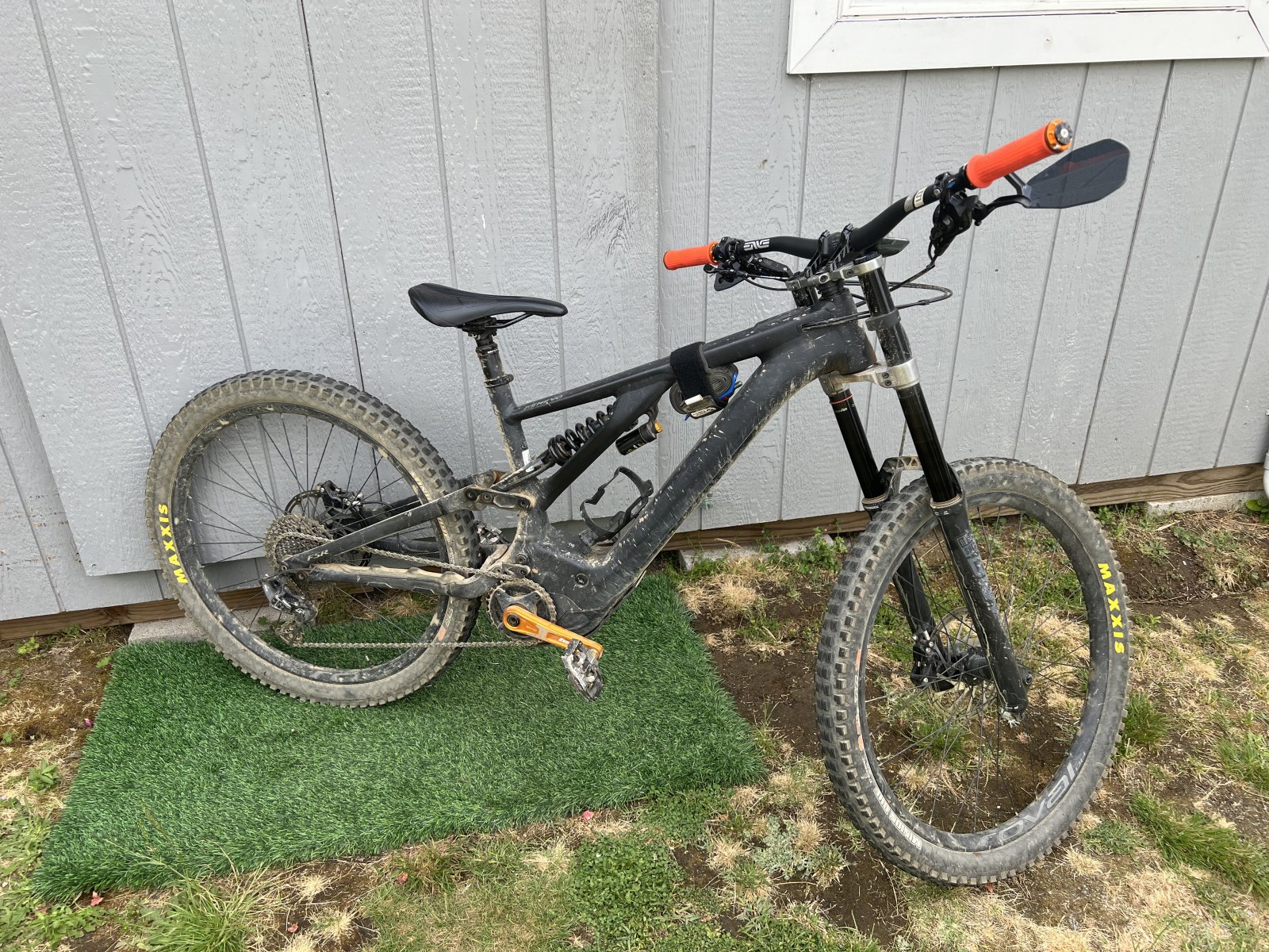

Hi everyone! I am new to the forum! Just got back from a night ride at AE Forest! Here is my 2021 Kenevo S5(I had it for almost a year now, what a machine! ;)). 220mm rotor up front, boxxer upped to 200mm travel, set of Maxxis tyres, otherwise stock. I'm just about to swap the horrible command post for oneup dropper!

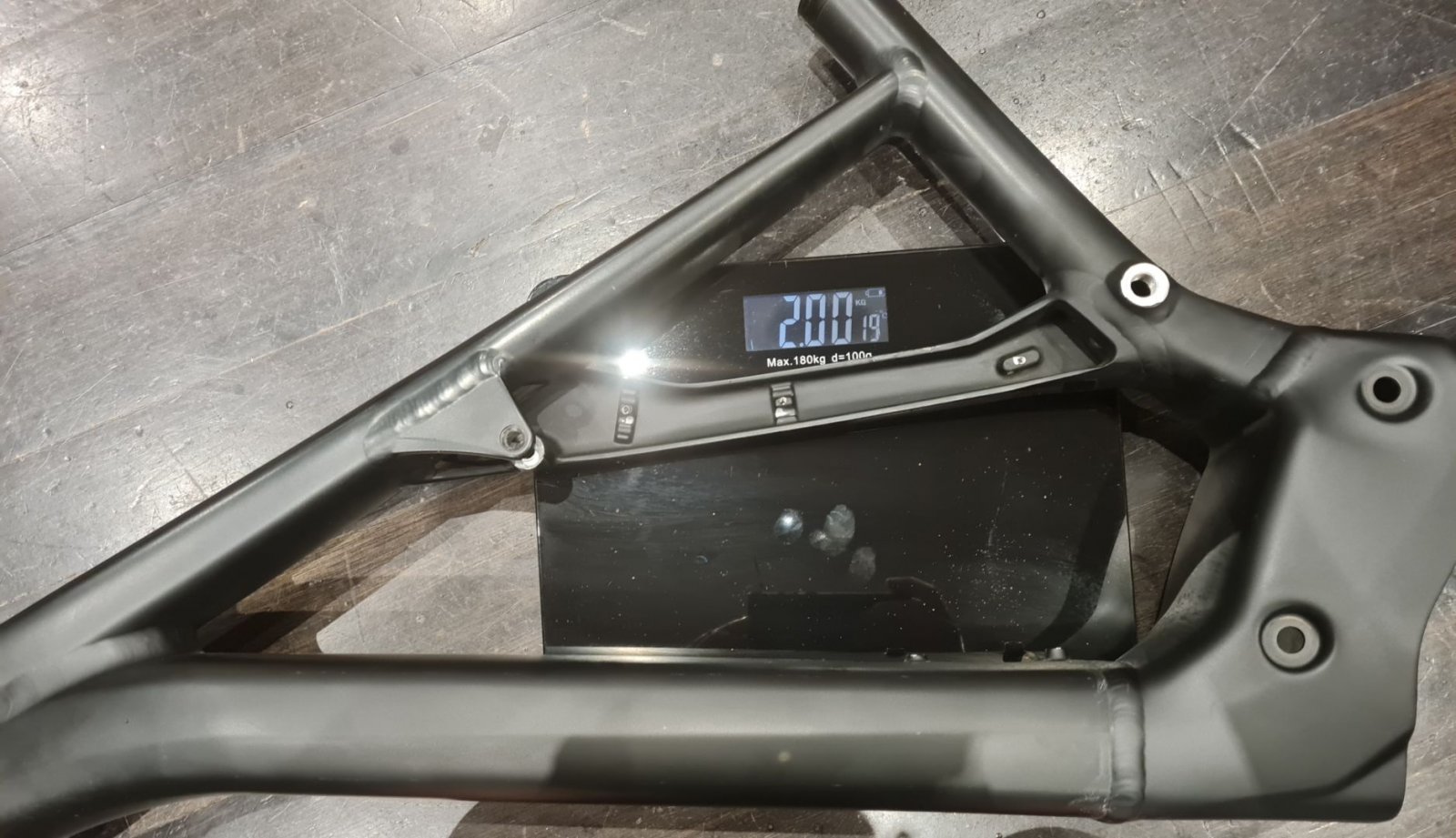

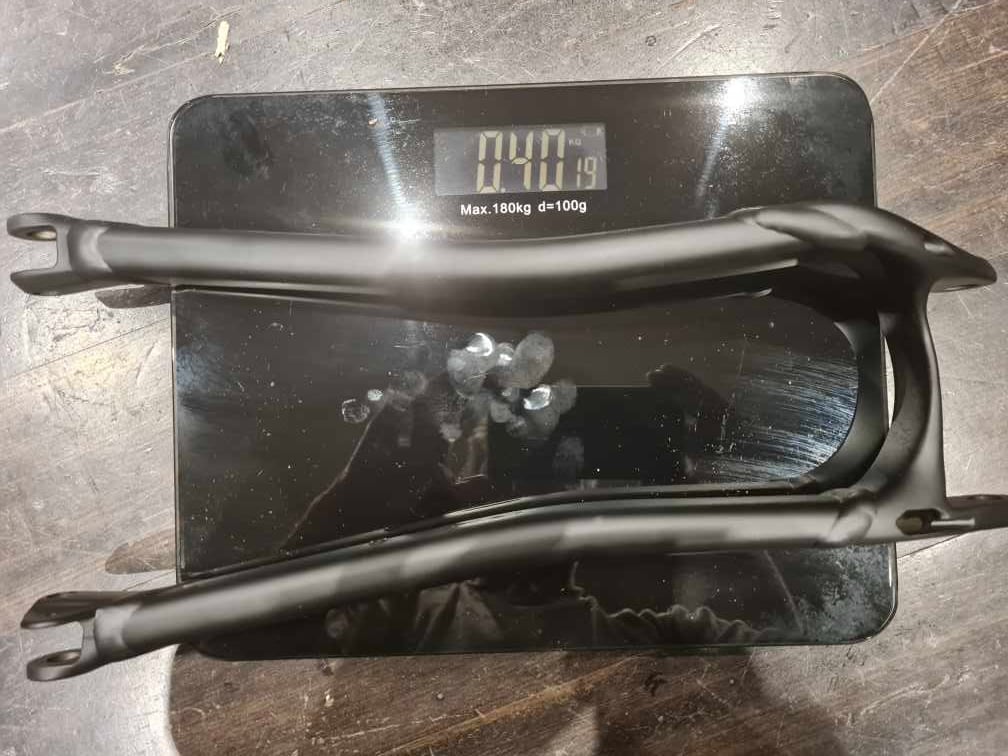

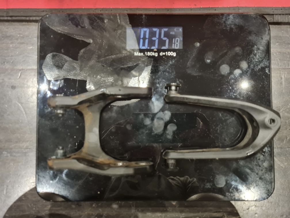

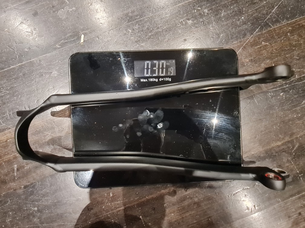

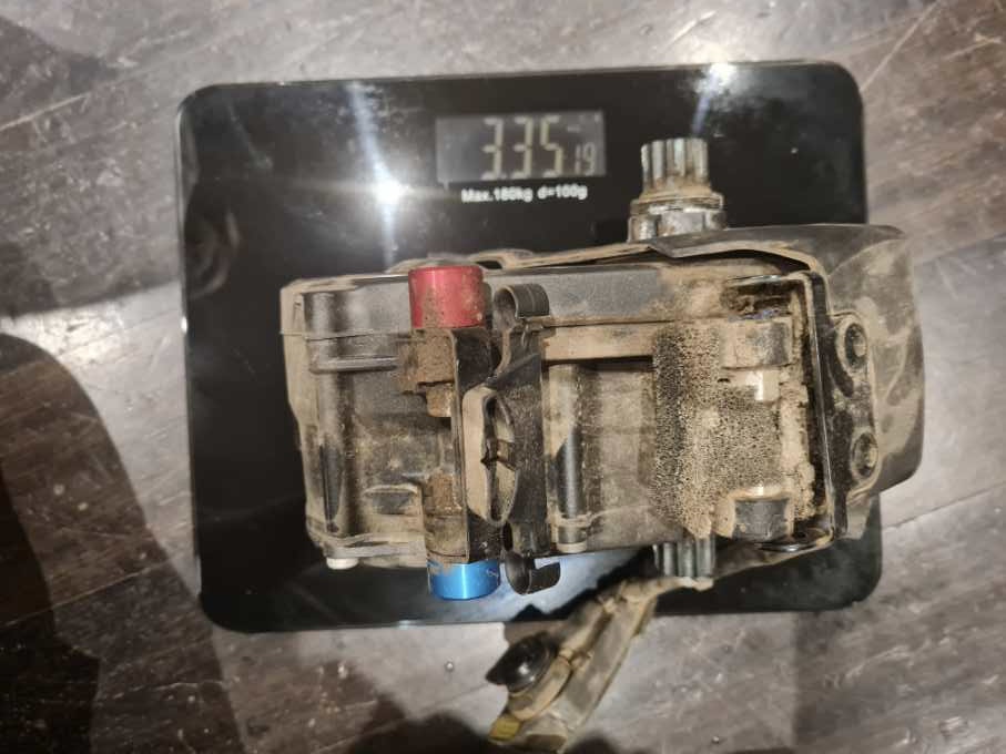

Ok so exactly what do you need measured weighed?Happy to give you any detail you like.
Frame plus motor is good for me sir. Without battery. Basically the equivalent of the frame of any other bike.
WOOOOW!
My non-e-bike has a frame that weighs 2.877 kg bare. Your Kenevo is 2.7 kg bare! (probably 2.877 kg after you add the linkage bearings in :))
My non-e-bike "can weigh" 30 pounds if I didn't have a boner for DH class tires and coil spring suspension. So it weighs around 31-32 lb.
That means if I used the same parts from my non-e-bike, my Kenevo would weigh roughly 32 pounds, plus the 7.4 lb the motor adds. Plus the 8.5 lb the 740 Wh battery adds. That is 47.9 lb (currently weighs 58 lb!!), or 39.4 lb without the battery!
39.4 is just 3 lb heavier than my non-e-bike weighed before I (for fun) started a mid-price weight weenie project on it.
The fiddly bits would add a bit of weight of course, but can you imagine a full-pedal Kenevo that weighed just under 40 pounds? And I wouldn't even have to pay $12,000 (KSL) to get there!
I didn't realize there was this much potential in the frame. That's amazing.
Can you imagine if a smart dude of some sort made an Al structure that bolted to the motor dropouts and gave you a BB mount? You would be able to convert your Kenevo to a full pedal bike and back in an hour's wrenching time and have a one-bike that can do it all. Even though 99% of us wouldn't go there, but still way cool thought. I'd pay $500 for such a thing without a second thought.
