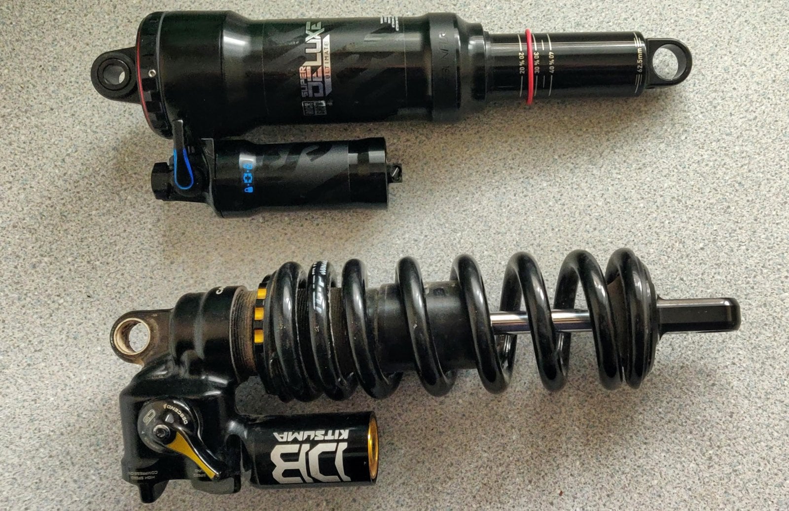

max pressure on rear shock ?
Hi there, I have finally got my new 2020 expert with airshock. have still my 2019 expert with coil - and my first impression after only one ride on the 2020 is - noisier, dont feel as strong as old one in turbo? - but it defenitly feels more steady downhill
It feels like it will jump easyer and a little longer, but I am not sure if this is due to the Butcher tires lower rolling ressistance than what I am used to - Magic Mary front and Eddie Current back (my absolute favorite combo)
But - my question is - what is max pressure for rear shock ? my weight is 105 kg and I have put 230 psi in - but it is still not enough - it bottoms out on jumps. I have 160 in the forks and looks OK
what are you guys running in pressure ?

the shock is a Rockshox Super Deluxe Select Plus , i just tested with 250 now, and close to bottoming but still acceptable, however I did not jump fully through:-) - and sag is around 30% - so OK I think
the shock is a Rockshox Super Deluxe Select Plus , i just tested with 250 now, and close to bottoming but still acceptable, however I did not jump fully through:) - and sag is around 30% - so OK I think
Ah ok. For you the "weight in lbs = pressure in PSI" seems to hold up then, as 105kg + 8kg extra weight is around 250 lbs.
Hm. So after having to put in so much pressure into the Fox Float DPX2, I've now installed a DVO Topaz on my Kenevo, and I also need to put quite a bit more pressure into it then what is recommended in the manual. :unsure:
I checked my weight with riding gear, which is around 64kg, so with the additional 8kg from the bike I end up around 72kg.
The DVO Topaz setup guide would put me to around 165 psi. I had to put in 195 psi. And 5 spacers in the positive air chamber. And am still using every mm on my test track.
The Kenevo's leverage ratio seems to greatly differ from what the shock manufacturers seemed to have had in mind when they put together their pressure recommendations.
Does anyone else have to put way more pressure into their shocks than what the manual for their shock says?
I also wonder if a more linear coil shock would actually work so well in the Kenevo, when I have to put in so many spacers into the air shock and increase the pressure so much. And originally they did sell the Kenevo with coil shocks.
My totally uneducated guess: The Ken is just not made to work well with air. After Spez figured that all the cheap coils will break, the air was the only choice left maybe saving them from reimbursing 100% of the bikes rather then maybe the 20% of people who will actually notice the issue with the air. I also wonder if the Ken is still being produced and if anyone heavier would confirm the above or not. (Please share your FOX IDs printed on the shock for easy comparison.)
I hope for you and other owners that I am wrong and that there is another easy explanation we just couldn´t see.
Otherwise in your shoes I would probably swallow the pill and buy the Oelins coil which I´m runnin for more than a year now w/o issues (100Kg+Bike) and after breaking 3x Fox/RS coils before that one.
A linkage that's designed for coil shocks would need to be progressive due to the linear characteristics of coil springs. This would normally in turn reduce the need to put spacers into air shocks, as the progressiveness is already achieved by the linkage design itself, since there's (almost) no way to make coil springs more progressive, in contrary to air springs.
And the Kenevo does seem to have this progressive curve, if you can believe the Linkage Design blog, which I'm pretty confident in (they do a lot of pretty good bike analysis):
https://linkagedesign.blogspot.com/2020/07/specialized-kenevo-2020.html
I've also asked DVO and they (Ronnie) even promptly answered (the last time I had to wait for days)!
Ronnie Dilan <[email protected]> said:
The S bikes usually require a stack up on VA spacers. In our experience your body weight is optimal for achieving the best feel on that bike with minimal damper tuning. Most riders on that bike are a lot heavier than you and require a custom tune on the mid valve to gain extra support on the compression stroke. Don’t be shy with the psi on your main chamber, but do not try to over compensate with the bladder psi. 190-200 psi is good for your body weight.
So it seems I'm in the right ballpark with the pressure I'm using, and that the Kenevo simply requires more than other bikes.
Interesting. Leaves te question what heavier riders would do other than exceeding air pressure specs of the shock...

Hi all, new to the site. I am riding My21 Kenevo Expert with Rockshox ultimate select plus as original rear shock, which I am not satisfied with.
I've noticed quite many here have put Fox X2 with 65mm stroke that gives 188mm travel. I understood MY20 Fox fits directly but MY21 not but requires some frame modifications?
I wonder has anyone put Rockshox Select ultimate with 65mm stroke instead, does it fit? Select ultimate is as tunable as Fox X2 but can be fitted with megneg to have better mid range support. Plus it helps if it fits directly...
I just put an 2021 X2 on an S5 expert and it clears but just barely. I used the stock fox bushing and sanded down the spacers. It would be easy to offset it and get more clearance if needed. There should be zero difference in the air cans between 2020 and 2021, which is the closest part.
I cut out the 2.5mm spacer on the stock super delux and tested clearance of the rear, there is plenty of room. Zero problems with 65mm stroke.
Stock shock needs extra spacers badly. Megneg would be a great upgrade if you are using all of the travel now. Ultimate + Megneg < X2. I just got the X2 as I feel its a better overall package and the cost was about the same.
Still considering changing out the Boxxer damper, but don't want the charger 2.1 and I feel like the next Charger 3 will be a ifp design like fox. Plus the stock damper is pretty good for a budget setup.
I noticed my RS coil had a crack in it last April. As lead times were months back then I replaced it with a canecreek kitsuma coil with the intent of getting the superdelux repaired, so I could use it on another bike, or warrantied so I had a spare.
Well I sold the other bike & had it rattling around in my van since then as I kept meaning to drop it into berkshire bikes for them to warranty it for me. I never got round to this so posted it to them 5 days ago & my replacement RS air shock arrived today :)
Excellent service from both berkshire bikes & sram uk.
Bit odd the sram documentation stated "replaced as goodwill as item is out of warranty" as I thought it had 2 years and was under this time. Regardless its all sorted now & hopefully this will be more reliable than the coil shock, but im not holding my breath. Never had an airshock last more than 8 months or so before leaking or cavitating.
EDIT crikey they need some psi. 300 or so for 30% sag at 100kg.
