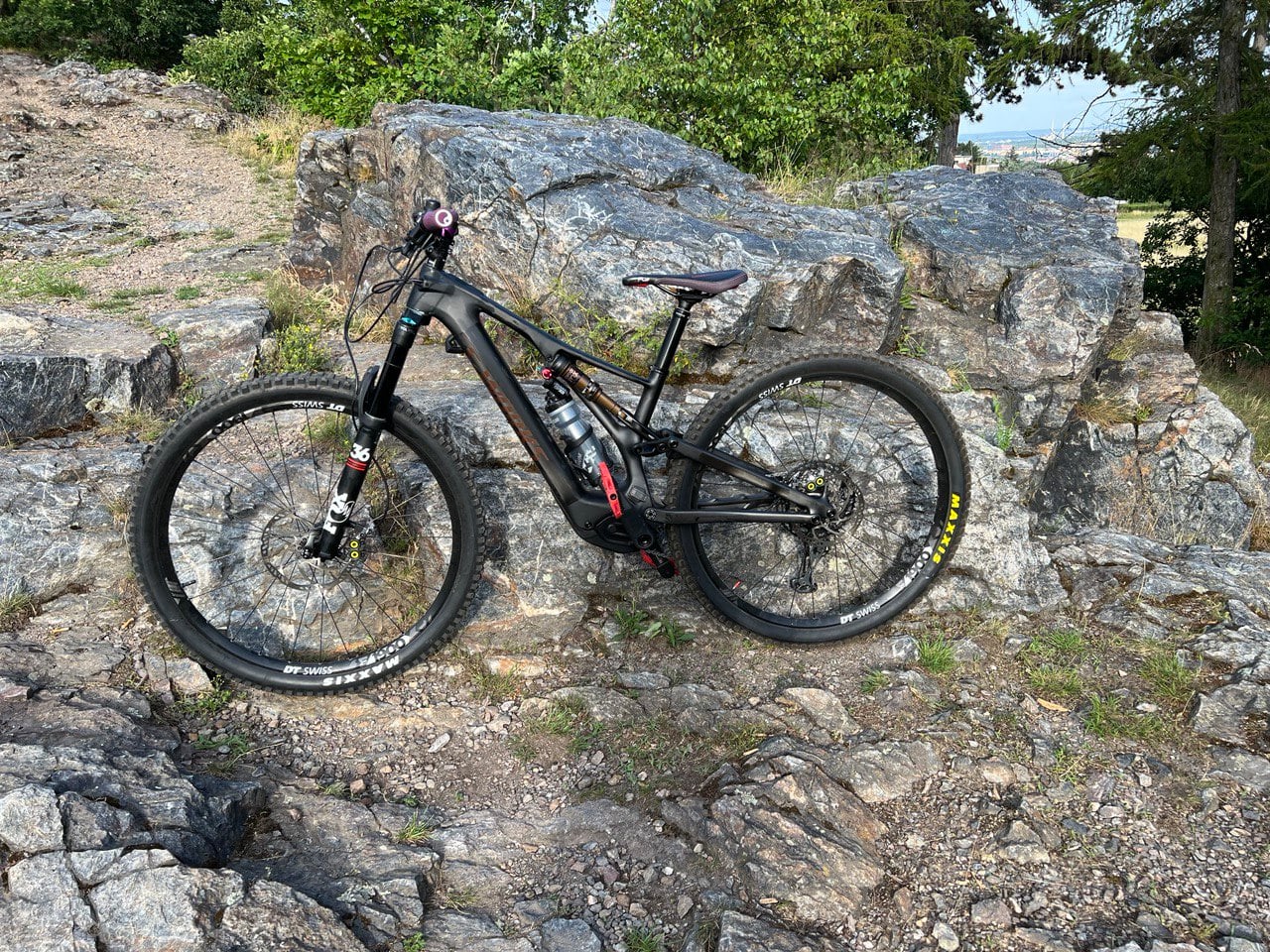

I have fitted a Fox Factory X2 with no issues. Posted a pic somewhere in the Levo SL forums a few years back

Were you able to fit the range extender / water bottle with it? I am planning this change in the Large frame - there are no DPX2 available anymore and I feel beeing over 200lbs and riding fast is a bit too much for the DPS.. SO maybe the X2?
Do you remember whether you liked it for the SL? As mentioned, I'm feeling that the DPS is just not enough for me - I'm over 200lbs, ride fast with a lot of harsh/chattery and natural terrain (rocks/roots). Changing my fork from 34 to 36 did wonders for me (I kept 150mm though) I don't jump, but feel that DPS might not be enough, X2 could be overkill? (Float X won't fit with the battery)
I really liked the set up. I always change to X2 whenever possible. I’m 240lbs
My Gen 2 levo now came stock with an X2 and I got the cascade link long shock kit. Much better with the longer stroke X2. Not sure Cascade Link makes a long shock kit for the Levo SL, but if they do, it’s worth considering

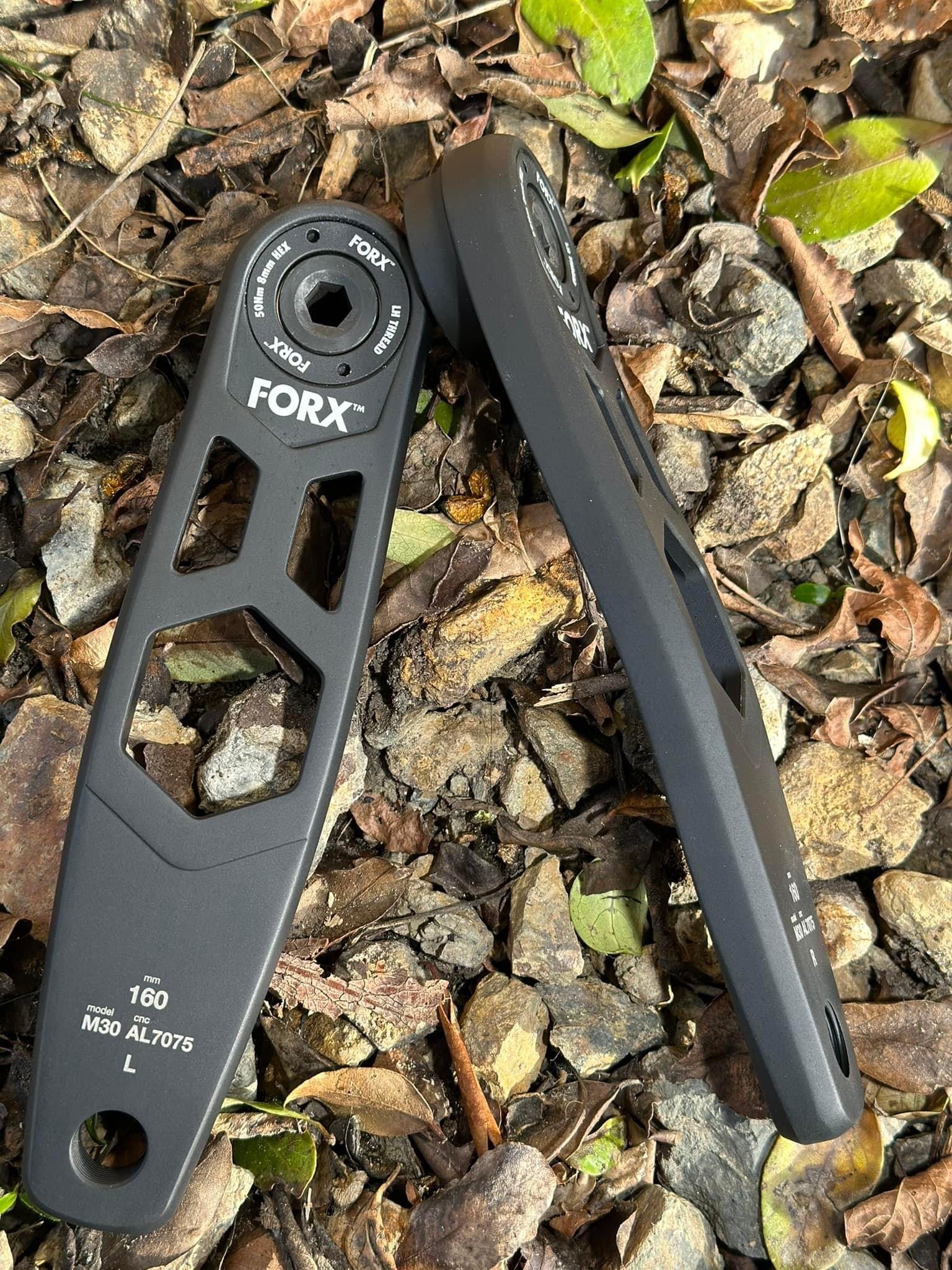

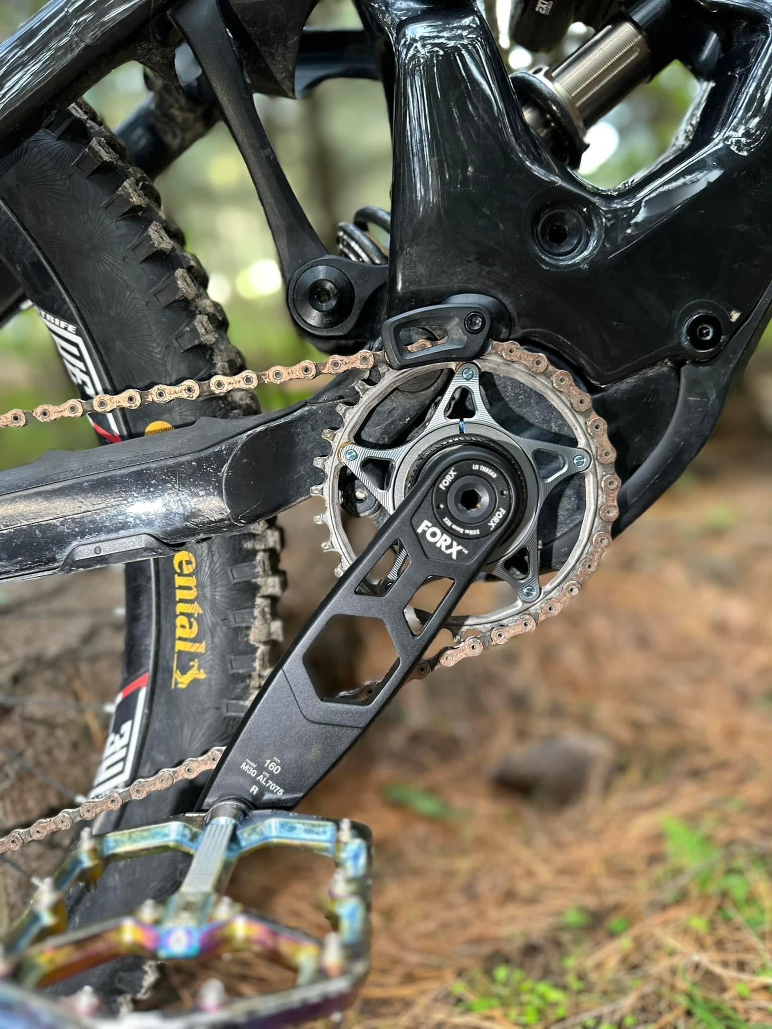

Crank arms available are the Levo SL gen1 only , Kenevo SL gen1 only , full fat Levo .
