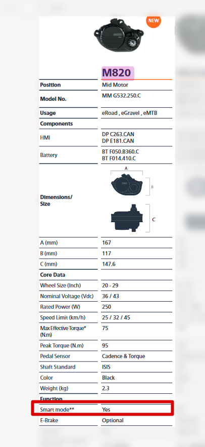

Did anyone try the smart mode? is it present? Does it work?

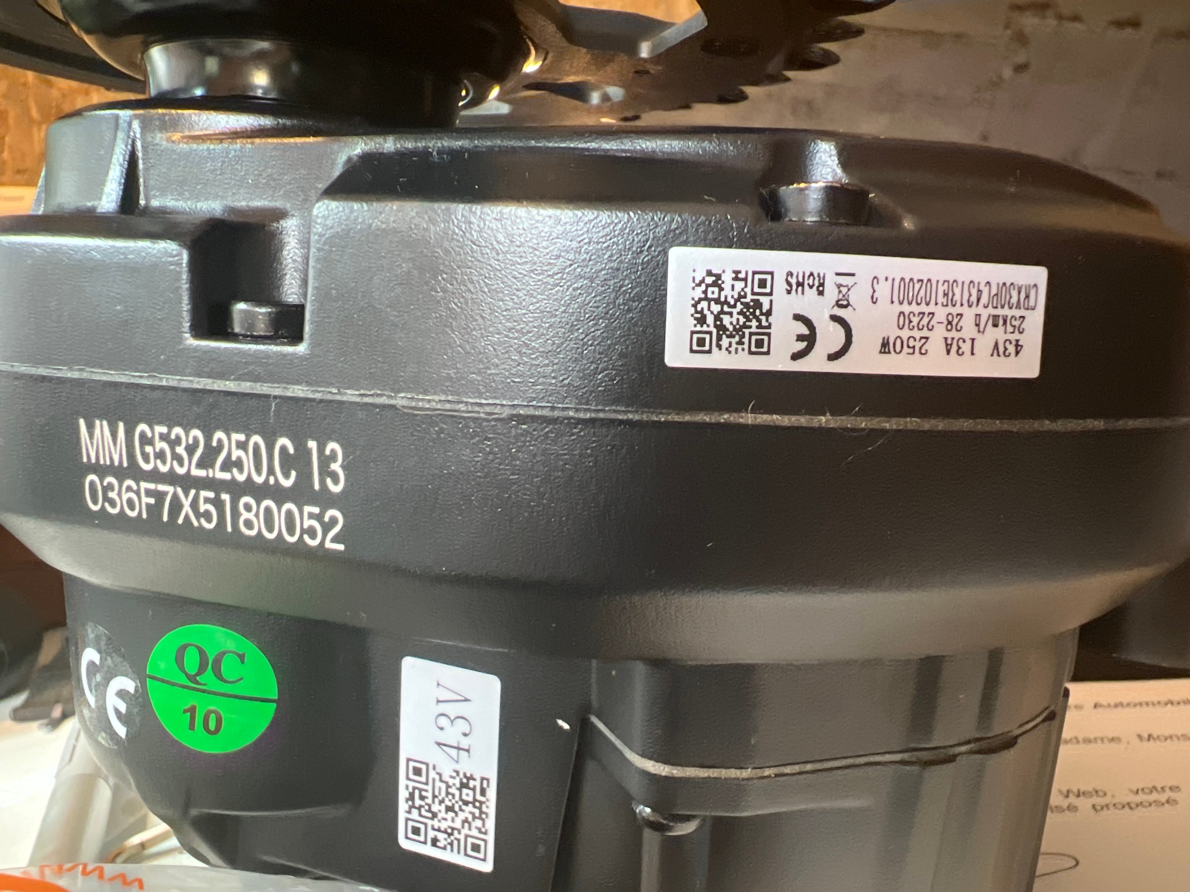

In this thread, it looks like there is consensus, that 36V and 43V are exactly the same, apart from the FW difference. Is there any proof, that this is correct? Usualy, motors for different voltages are wound differently (different stator and rotor - different number of magnetic poles) so with the rated voltage, output speed will be the same. Contoller can be the same, and it can be reflashed with different FW, so it will accept another voltage range. But this doesn't mean, that performance will be identical. For example, with different voltage applied, max power of the motor can be in different cadance ranges, than designed.
So, do we know, that the actual stator and rotor of 36V and 43V motors are the same?
Also, was anybody actually successful of sourcing different firmwares for M820 motors?

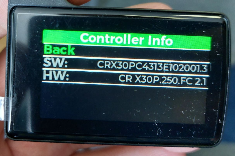

I tested my motor and I have the correct 43V FW:
Works fine at 52V.
No, works at 52V, whitch is just sligthly higher, than full 12s, 43V battery (12 x 4.2 = 50.4V).
Oh, I understand the confusion now. In this case, I didn't connect the motor to the battery. I don't have that battery and charger yet. I connected it to laboratory power supply so I checked the FW version. And I set 52V and it worked.

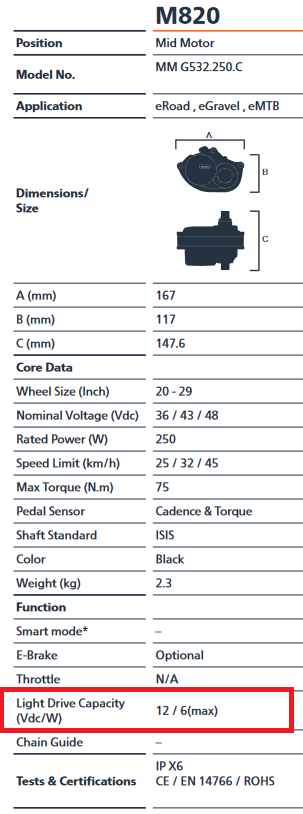

Guys, did someone checked the voltage provided by the light cables ? I'd light to buy a light for winter evening rides, but they do not all accept all voltages
@brbr did you find any suitable light?
I am also interested in this. So far, I found this one:
It has 5.6w, so it should work OK.
It is StVZO compliant, meaning it has a sharp cut off line. It is great for the road riding, but It might not be the best for the trails..
Its big brother, pro-e 140 also has a high beam, but the wattage is to high. IMO, to have something trail worthy, we will have to splice the connection from the battery and use step down DC/DC to lower the voltage.
