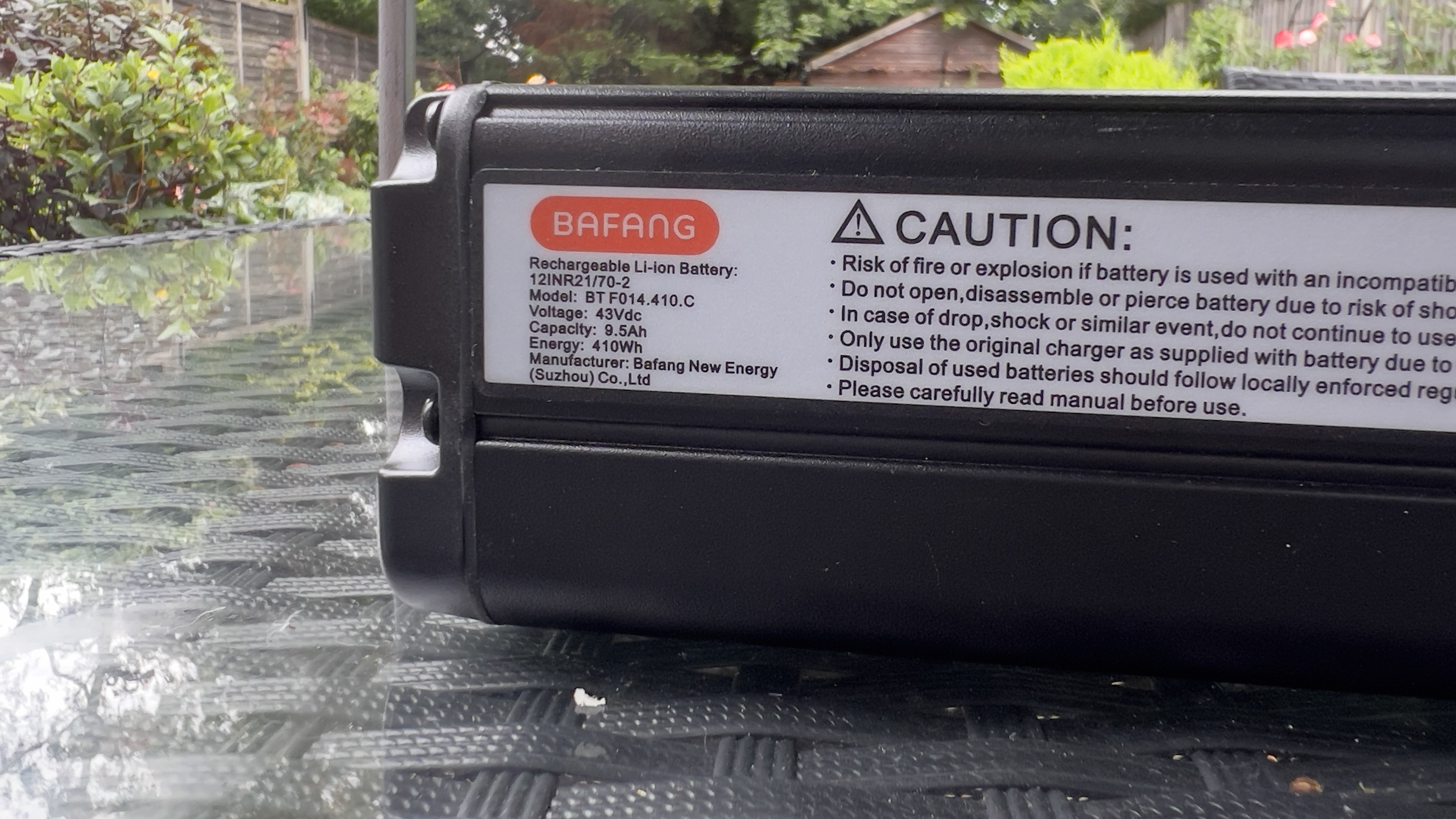

Guys, anyone has news about the Bafang 43v BTF014 battery ? My Alibaba seller says that bafang does not give them any news ... It's very frustrating.

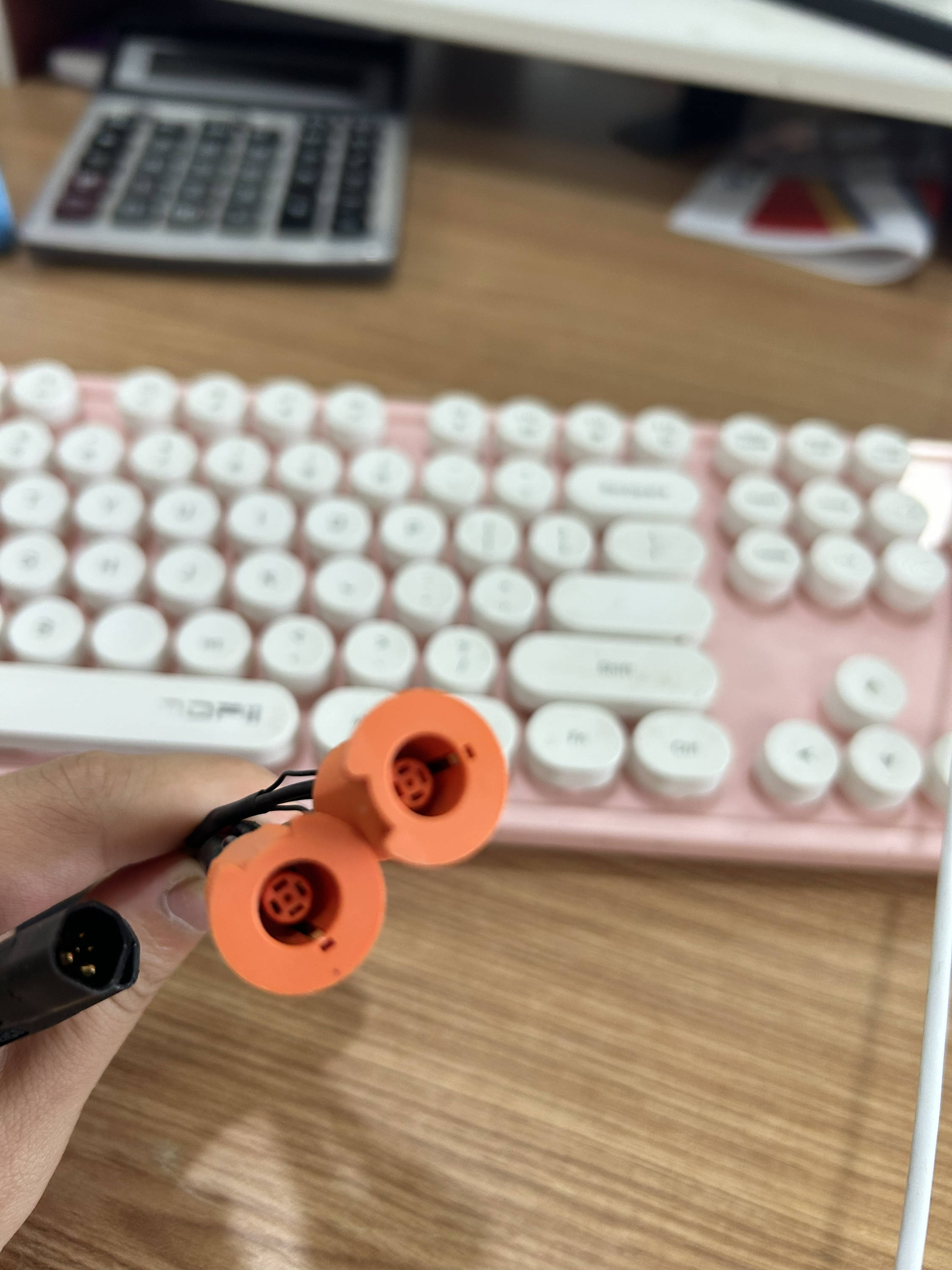

So I finally decided to buy the Magicshine ME2000 which is not the brightest light you can find but 12KCD and 2000 lumens should be a good start.
The problem is that the Bafang m820 only provides a very low power output from the light cables so I bought a DC-DC converter from Aliexpress with an output of 12v 3A. The other problem I did not anticipated is the fact that the light is always on when there is power, and as it's plugged on the bike battery, there will always have power!
So I bought a DC 12v relay and I will plug the trigger switch on the light output of the bafang, in this way I will be able to control the lights from the display.
I'm waiting for all the parts now, I'm hoping to finish this by the end of the month
