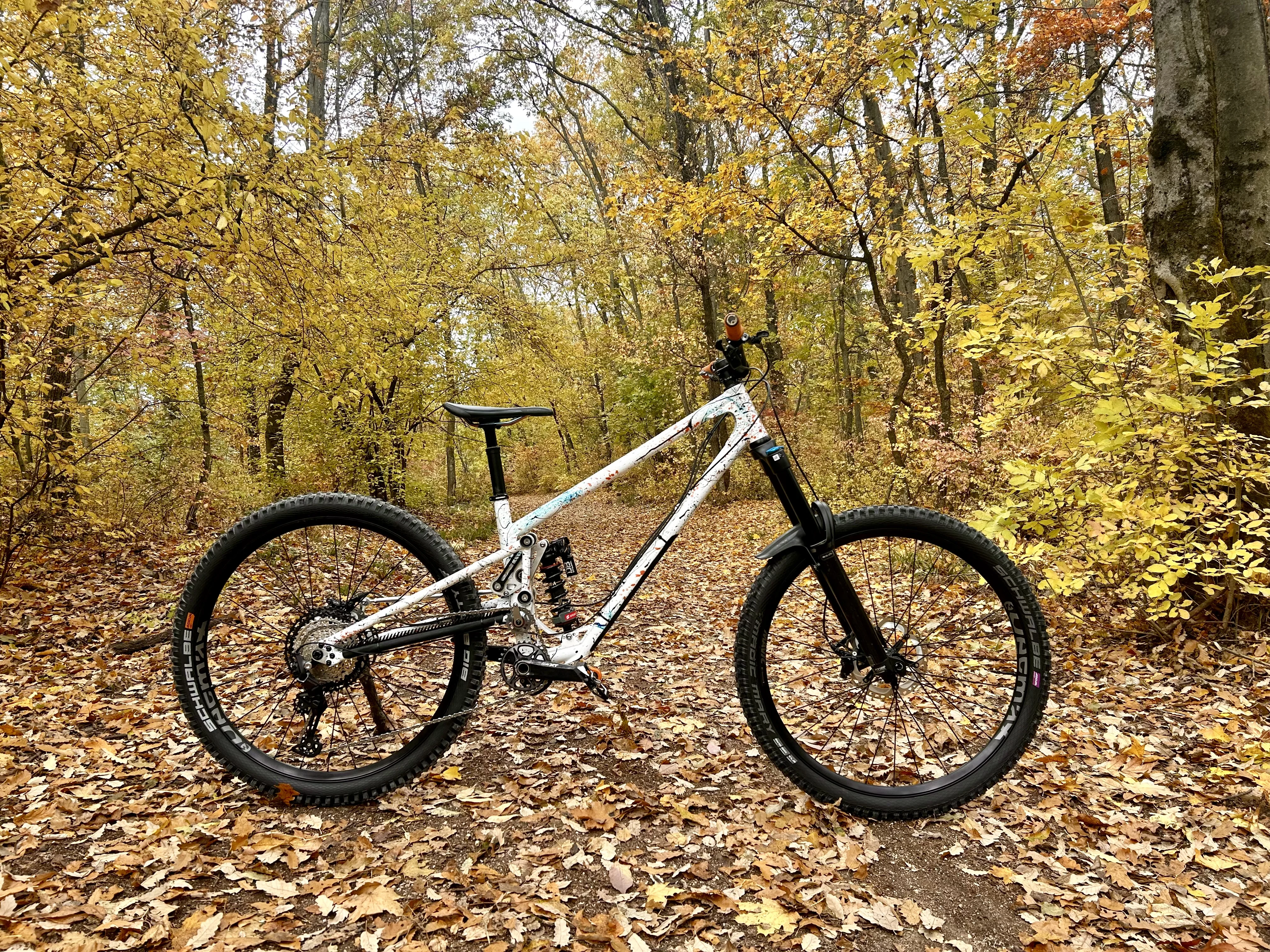

    • Current bike Mondraker Crafty Bosch Gen 5 since last year. Like the geo, kinematics, but pissed that 1 year in and they dropped the Zendit and some of my friends switched to Avinox bikes

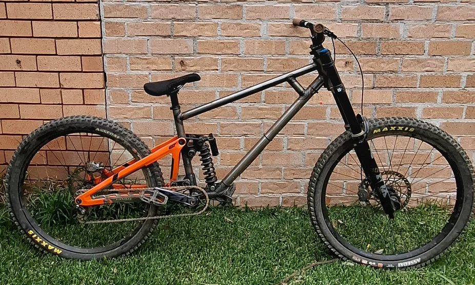

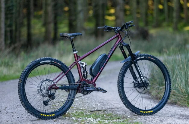

Last year I ordered an analogue frame from vesselbikeproject tailored to my specs ( geo, kinematics) and he started to do a frame with different motor mounts. So if I would go down this route, I could keep the frame (which would be almost identical to my analoge bike) and i could always upgrade the motor/electronics when I want. I’m not after the latest tech/power so a “weaker” 85-90 nm motor would be great with a 600-800 Wh battery. Looking around I have counted the following options (I’m sure there are thousand others, happy for suggestions)
  • Bafang. He has mounts for this. Initially I was thinking about the M820 but can not find a larger battery, and heard mixed feedback on the motor performance so the 510 would be my next candidate(560 is a bit overkill), not sure about total system cost
  • Bosch: again he already has mounts for this, I could take it out from my Mondraker but then I would be left with a frame probably more difficult to sell. I could also get CX 5 motor new taken out from a new bike for like 600 EUR (bo warranty) and add a Bosch Power Pack 725 (BBP3570) for EUR 429
  • New Shimano EP6 for EUR 200 with steps bt-en606 external 630 wh battery for EUR300. I know its old but at this price on bike discount it is worth checking out
  • Maxon Air S: I would be happy with this motor along a 600 Wh battery. I have sent them an email, not sure they will reply
Battery is preferred to be external as it will have bms and easier to fix to the frame. I know that I will still need to buy additional parts for the electronics, but i would not think these would make a large difference between the options.
