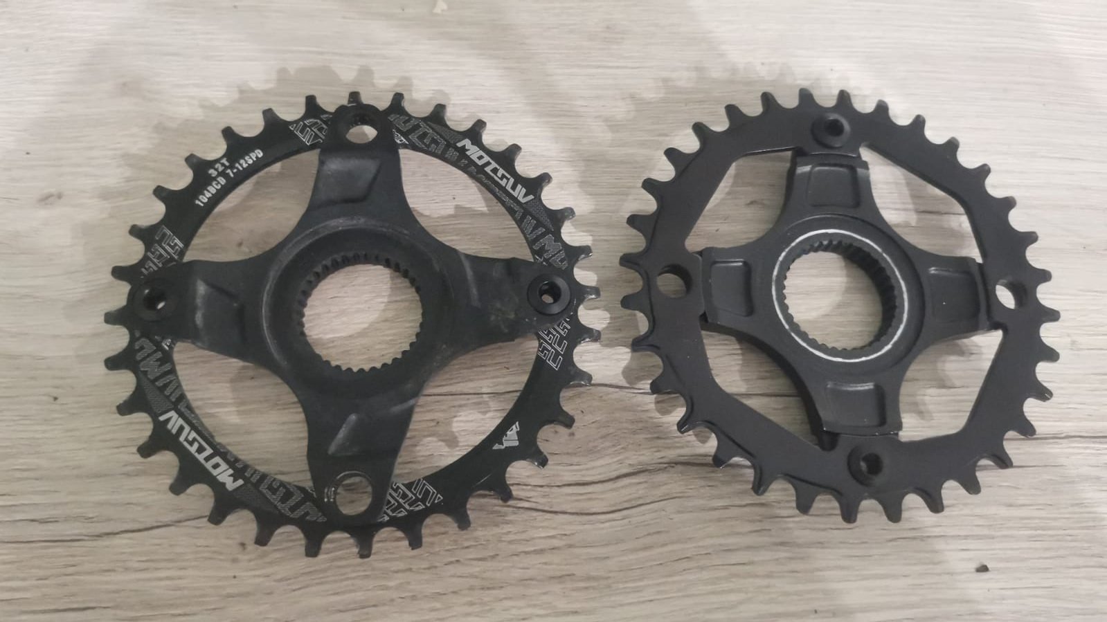

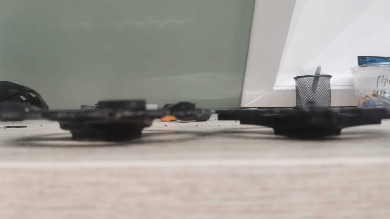

HI LAnton, need your kind advise does m510 spider fits the m820?
Yes. Right side M510, Left side M820
I don't like the spider on the M510. You cannot change the position of the front star. In the M820 and M600, you can shift the front star closer to the motor.

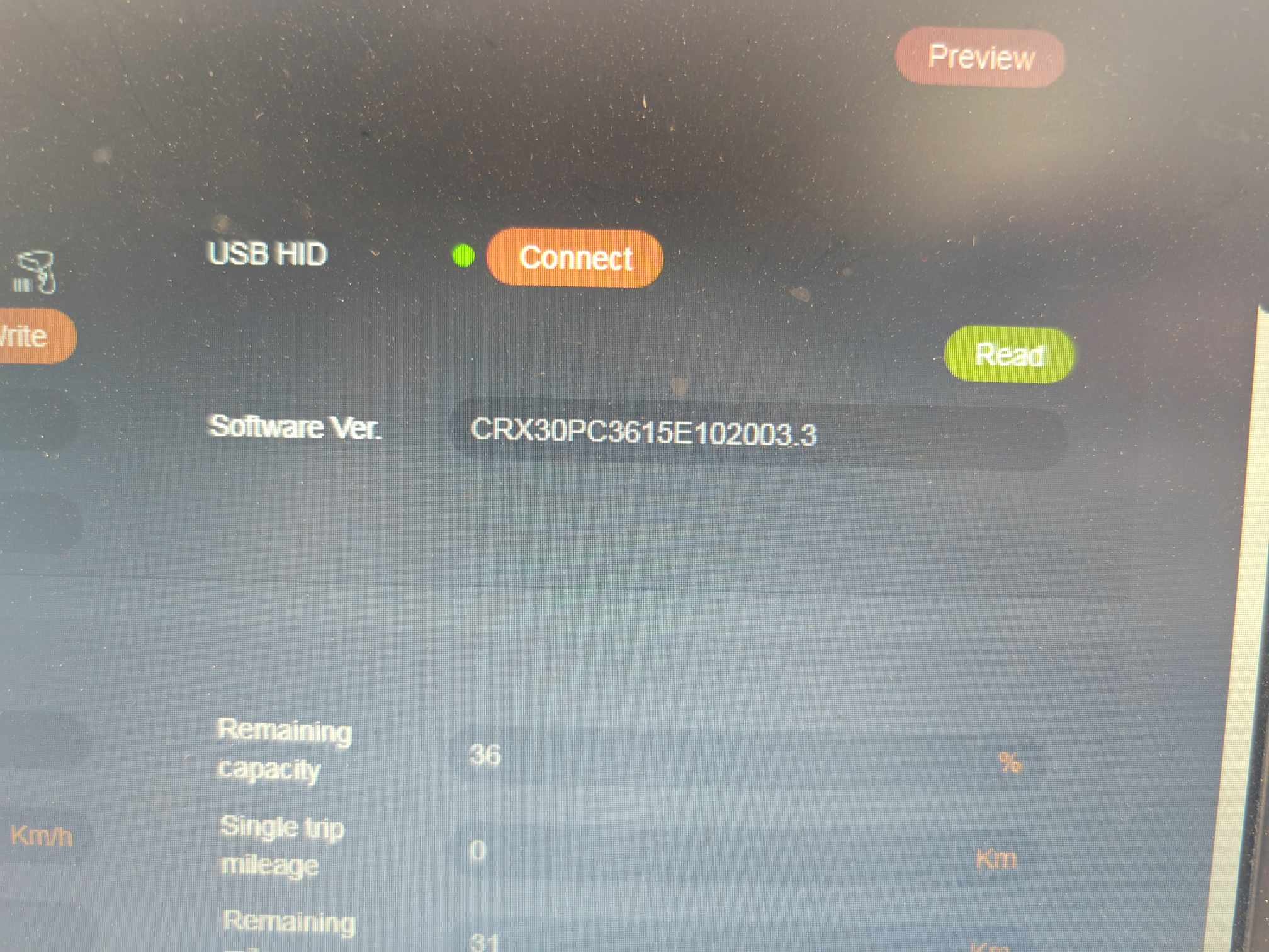

I am in process of assembly of lce930 with m820 motor.
I have ordered 43V motor and the battery kit.
Is my firmware 36 V version ??
Another issue I have, battery level indicator stays at 36% after a few hours of charge.
The charger green LED stays ON solid when I putt the plug into the charging port, have anyone had same issue ?
Thanks

Yes it looks like a 36v controller.
You have the besst tool, the change is easy
OK have a firmware. Just instruction is not clear.
Can I update firmware via interface connected into the HMI display or have to remove motor and plug it directly to the motor itself ??

Firmware updated to 43V and battery started to charge OK.

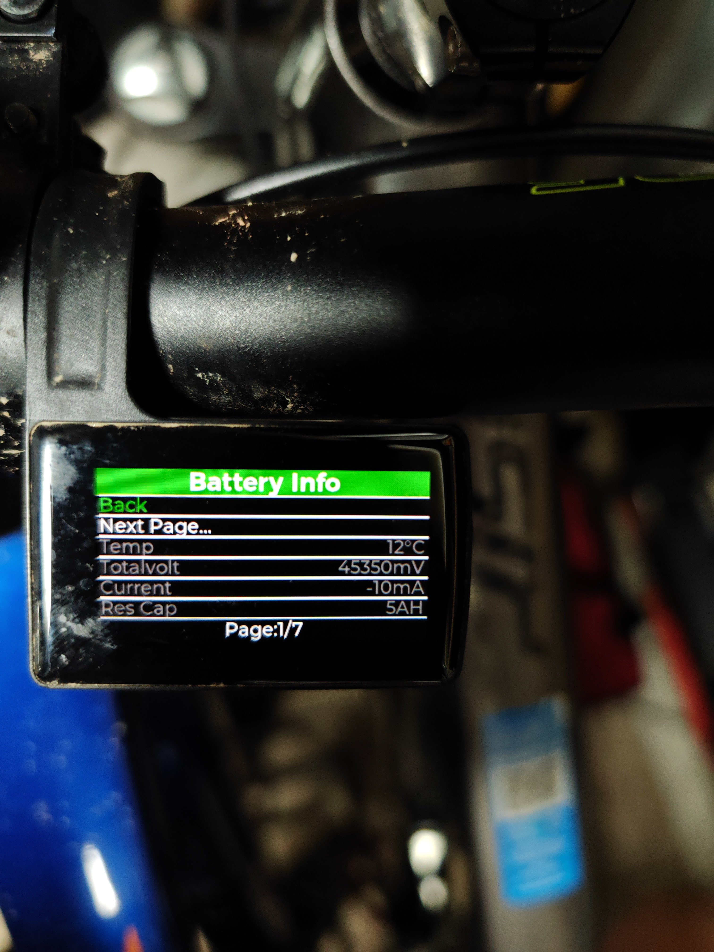

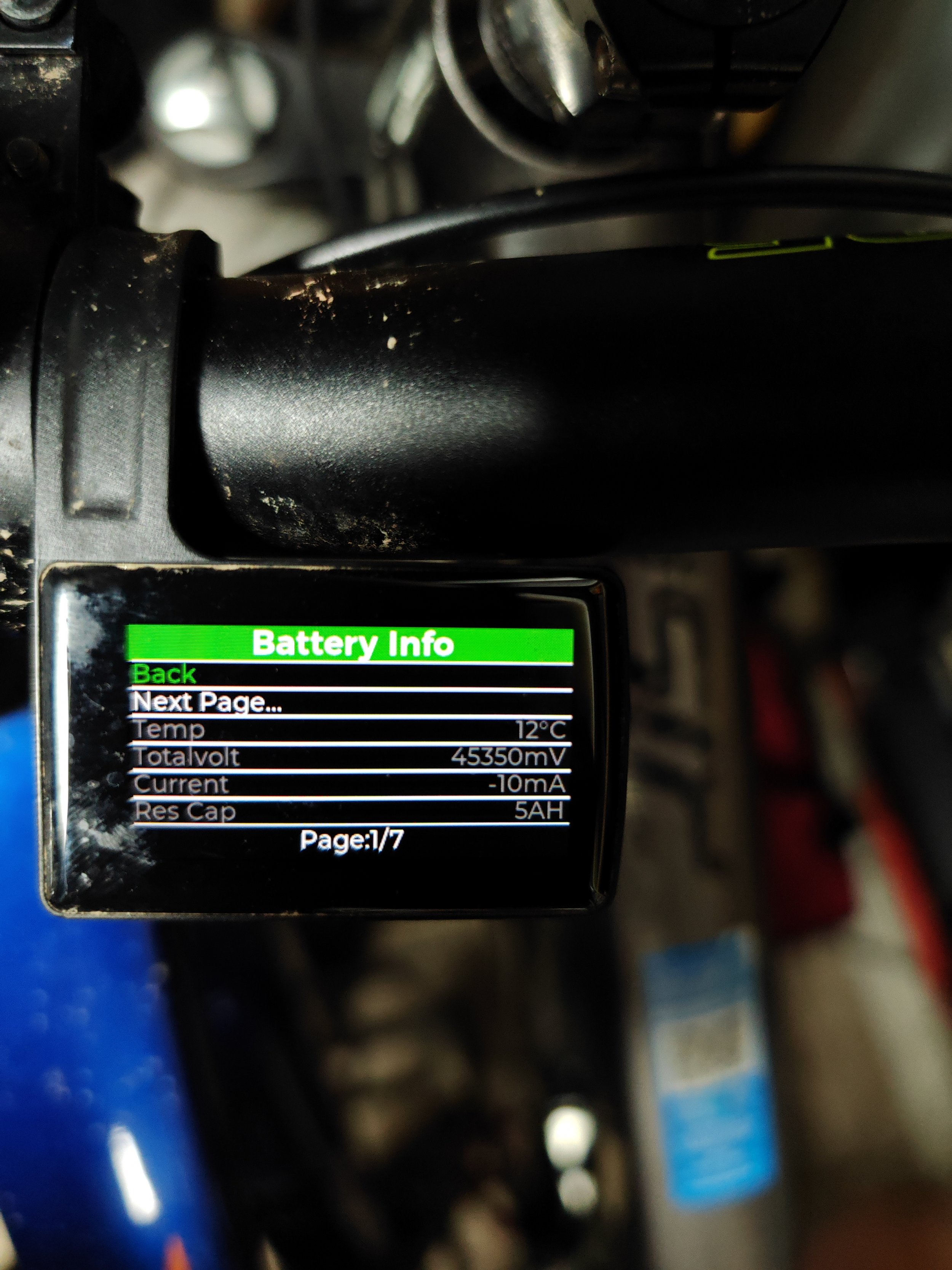

Hi. Got a bit of the problem with charging of Btf014 battery. At the moment it is 59% left @ 45V, when I plug the charger in, it does not go red(charging), lights up solid green instead (like fully charged). There is no faults in diagnostics. Just wondering if there is a voltage threshold that battery can not be topped up when over 50%?
I’ve seen that the charger sometimes is plugged but does not charge, you have to plug it again or turn it in order to have a good contact, maybe that’s the issue
If the battery charger was not for the right voltage, say 36v, it would charge until it reached 36v and shutoff.
