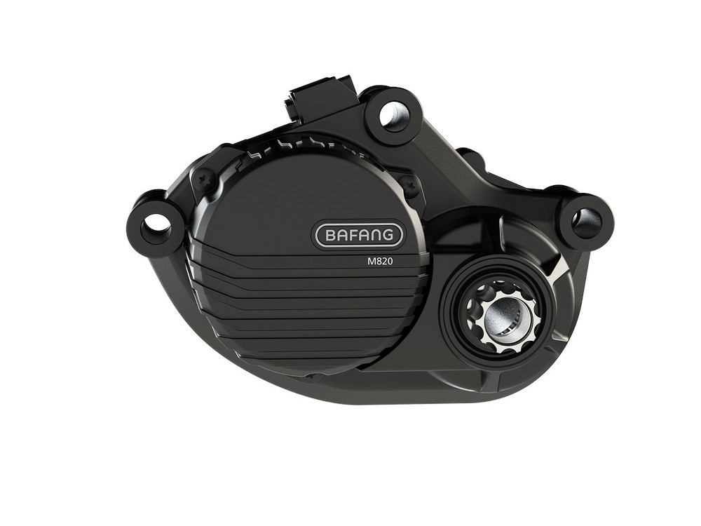

Chinese manufacturer Bafang is expanding its portfolio with the new M820 mid-engine. The model weighs only 2.3 kg and is lighter.
provides a nominal power of 250 W at a torque of 75 Nm. Depending on the application, speeds of 25 km/h, 32 km/h or even 45 km/h are possible.
Using a magnesium case not only leads to weight reduction, but also ensures higher corrosion resistance. In addition, the manufacturer promises a reduction in vibrations, which has a positive effect on the driving experience.
The Q-factor is also lower compared to previous models, meaning power transmission is more direct and lighter.
rocky mode button, as the function is also called, to overcome a small slope even faster

I like the low Q factor and 45kmh ability as well as the low weight. Not to be able to go 45kmh but to just not have a limiter basically. Would be interested in a 29"er 130mm model with a 500wh 2170 cell battery that should be able to be below 45lbs. easily to foil my M620 beast for more XC type riding. Whether or not they are going to get their CanBus act together and provide an app to allow fine tuning of the modes remains to be seen.

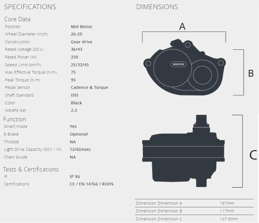

Do these mount the same as existing motors in the bafang family? Or is it a whole standard? (Ie who makes frames that fit this?)
I wondered that also and doing a quick comparison the mounting points are very similar visually but without knowing the actual measurements who knows?
DengFu makes the EO5 which is listed as a 120mm bike that can be ordered in 29" that is set up for the M500 series on their site. Would be nice to see it in 130 or 140 for a bit more down country ability but that would mean a new mould probably and a major commitment from someone to get that to happen....
I also wondered what influence the Eon drive had in this motor and figured it did have at least some. I haven't followed much about the Forestal bike to know how the Eon is performing.

In this video in Spanish with subtitles in various languages.
you can see an image with the measurements and it does not match the m510 but the batteries BT F014 410w+ 252w and also that by 2023 there is already a frame for bafang m820
Strange. That motor looks like the Eon motor Forestal uses—and now Forestal is calling it the F60-S1 motor, previously known as EonDrive. On the Forestal owners page I have not seen complaints about the motor as much as failures of the software/dashboard.

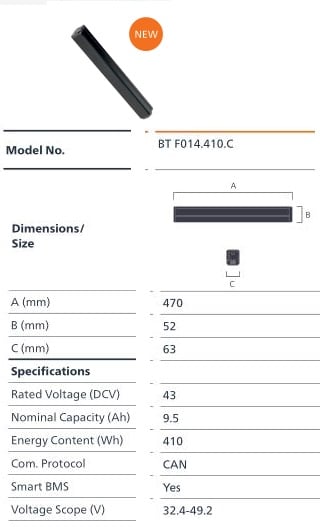

Recently we have been discussing the M820 motor, the biggest problem now is that the choice given by Bafang is only 36V/43V, the matching battery on EMTB is BT F014 which also 43V, and the battery length is very long, if it is installed in the down tube, it is difficult to have a beautiful frame geometry,
Our ideal situation is to find a replacement battery, about 600wh or more, if 720wh is better, (if it reaches 960wh, may be the length is too long)
However, now other brand battery manufacturers do not provide 43V batteries. If motor choose 36V, it is too small.
The damn 43V,

FYI the battery solution is relatively easy actually. Only hold up is Bafangs proprietary BMS that serves the CanBus protocols but in the past I found out that they are willing to share that information at least with OEM's. But it seems like there are folks building batteries for their M510-M620 with CanBus and they aren't mentioning any particular BMS needs?
Most manufacturers prefer to see a cased battery go out with their products as opposed to wrapped ones it seems? To my mind if properly installed and protected there really is no difference between the two. Reason being that if a new case needs to be designed/made that could add extra cost and take up more space actually + add weight. So I think a well wrapped enclosed battery would be the easiest solution made by a reputable manufacturer to spec over in China of quality 5A cells and let LC design around that. Personally I would aim for a 400-500wh 48v battery. Carry an extra somewhere for really long days but one is plenty for daily riding?

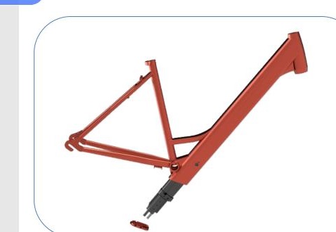

Hey, i'm here.
First, we will develop a frame that uses M820, but the battery also uses Bafang's battery, as for our own battery, it takes time.
the standard battery for M820 is BT F04, 410wh, 43V, about 2.6kgs,
A spare battery site will be reserved at the water bottle cage, but spare batteries may not be provided, and buyers who need it will buy it by themselves
the EMTB frame fit for M820 will not the big travel 150-160mm, only about 130mm in our plan, this model not fit for enduro EMTB, the MAX effective torque is 75Nm, and 120rpm.
rear shock will be 185*55 trunnion mount, also accept the rear shock with piggy back design and coil design.
now only one question ,It is difficult to remove the battery BT F014. Once the battery has a problem and needs to be removed, it may be necessary to remove the motor first.
pls make 150-160mm version. u will get more buyer than 130mm fork support.
