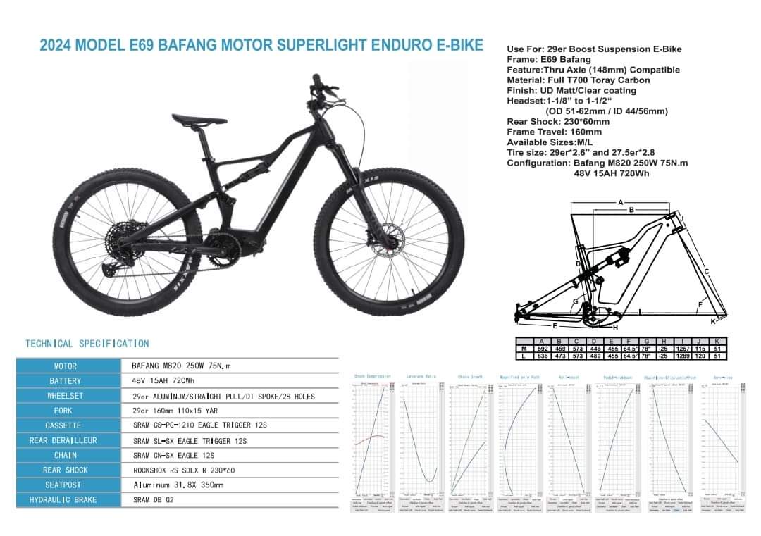

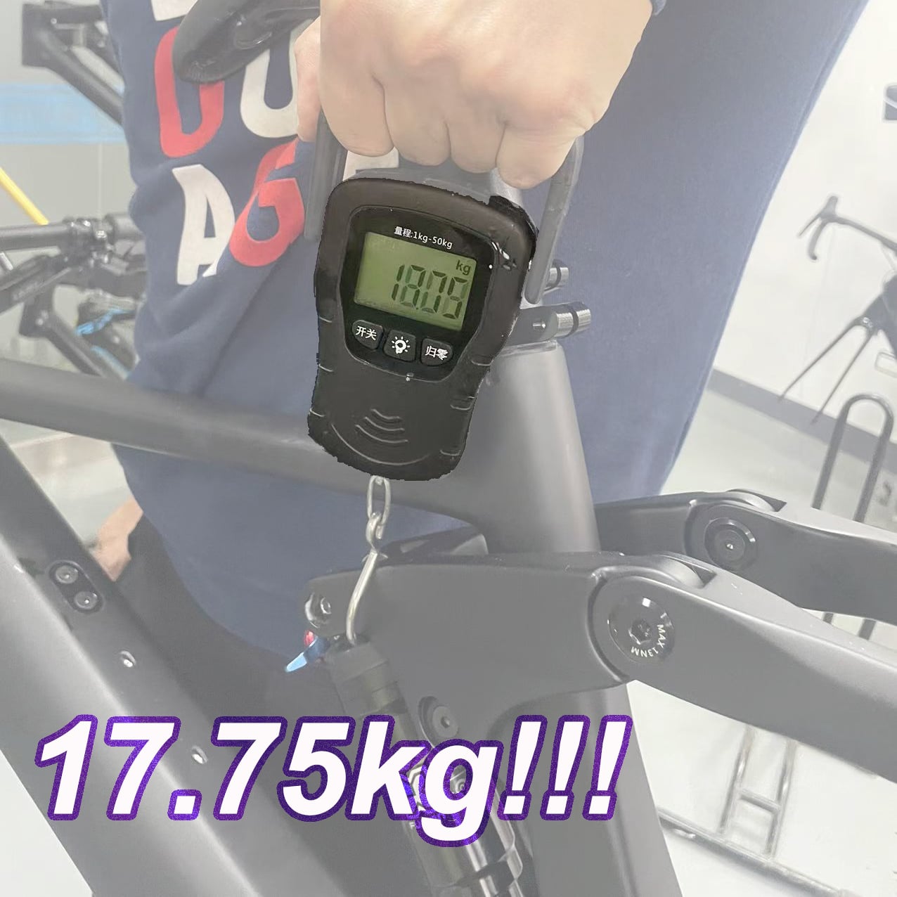

CEF50 starts from 17.75KG according to the suppliers. They have the battery option 43v 11.4ah at 2.6kg. It's a great choice to get a super lightweight emtb.

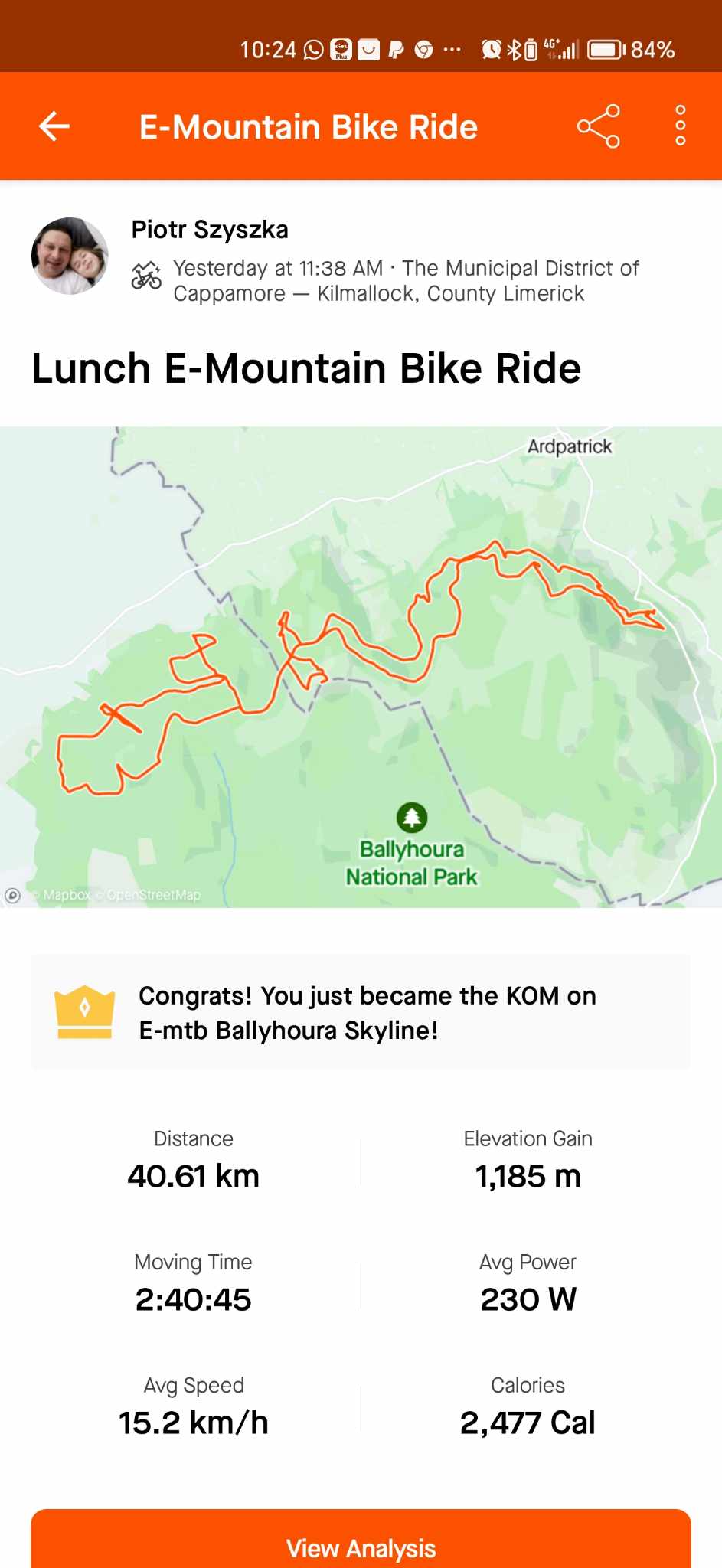

Yesterday I have done 40km@1100m about 55% battery used (DIY battery).
