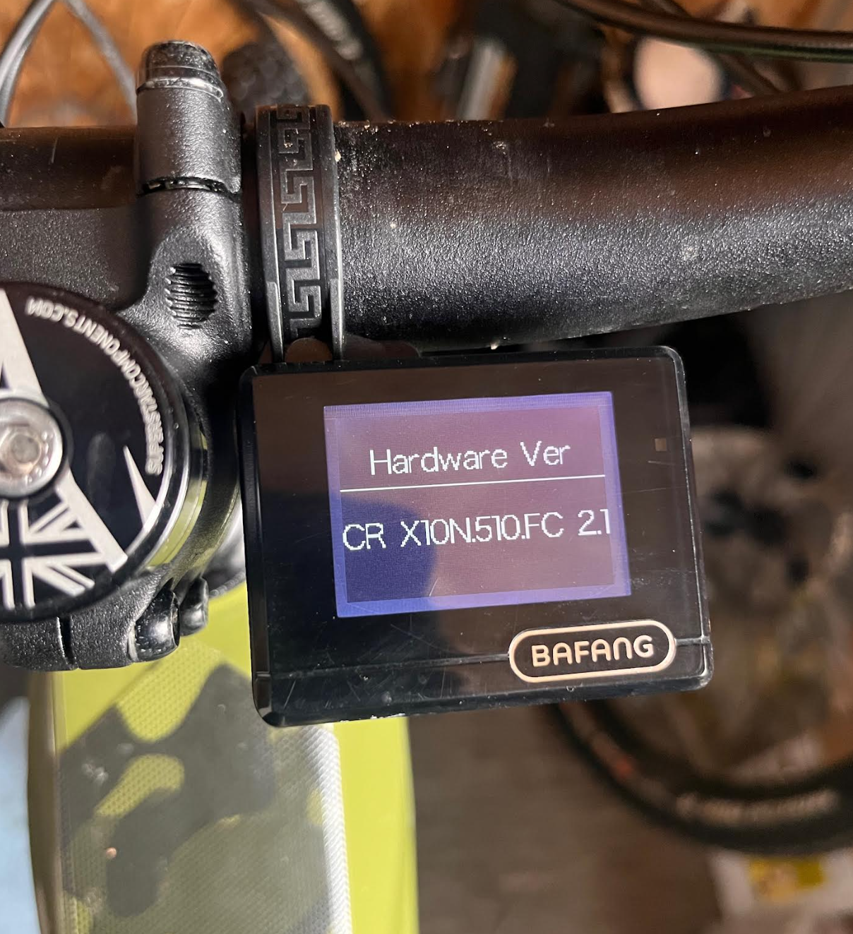

Helo guys.
Seems like there is new HW revision of controller FC2.1 and with firmware v3.1

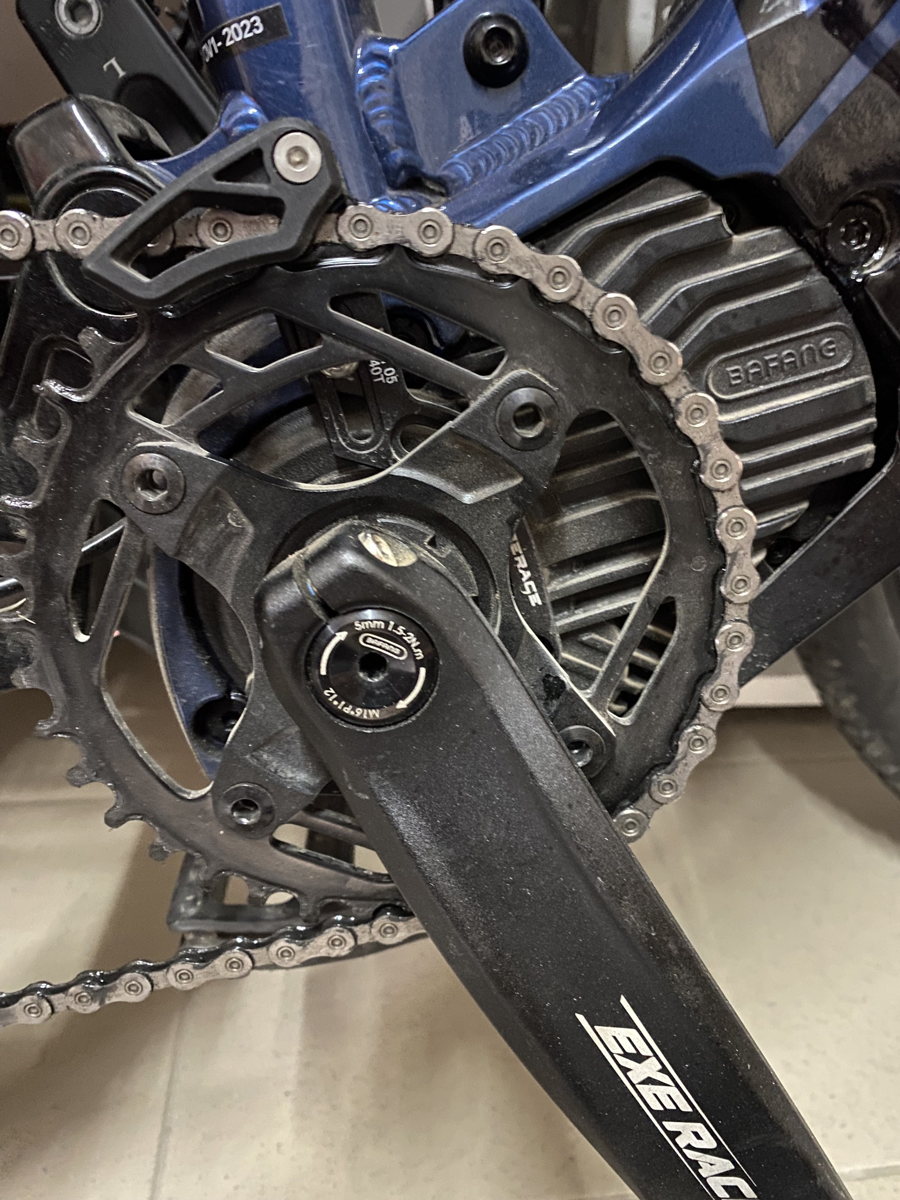

update. needs new chainguide, since m500 doesn't fit. the crankarms screw is M16, does not match the M500 M15
pictures of chainguide attached
Hi, sorry.. I just made a new post about how I can get a chain guide to fit my Bafang M510 motor... and see you have discussed this. I have seen these on Aliexpress, do they fit the M510?? how did you do it? do you have photos? thanks
Pretty clear, no rubbing at all. Yes you also get some spacers in the package. Happy with it, zero drops so far.

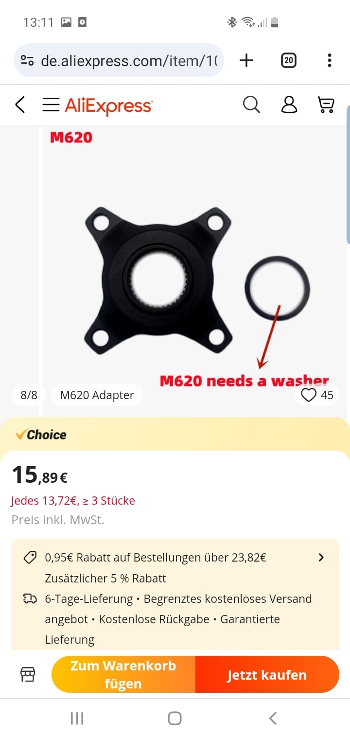

Has anyone ordered a spare spider for the chainring yet?
I bought a new motor after the old one broke, but it has a non boost spider so offset is wrong, shifting sucks and I can't remount my chain guide.
I measured old and new spider and there is about 3mm difference. Still can't get the old spider off of the old motor, so would like to order a new spider. But none of the ones on Ali Express specify if boost or non boost version.

try asking this store? https://es.aliexpress.com/store/507...earchText=Bafang&shop_sortType=bestmatch_sort
Haven't had any luck yet looking through AliE and asking shops. Has anyone removed the chainring and spider yet and can tell me if there is a spacer beneath (like they advertise for the M620 motor)?
This may explain the offset and also habing enough space to fit the screws of the chain guide to the ISCG tabs.
There is no spacer on M500 or M510. You need special tool to remove the chainring. Also it has counter clockwise thread, be careful.
hey bud, So I received the chain guard like yours in photo today... and we went to fit it, but it won't fit on my motor... It rubs really bad against the chainring... no idea if I've got a different motor... or what... but it rubs..
Like i said before, it is straight fit, bolted directly to the motor, no washers used anywhere. It doesn't interfere with anything. It just works.
hmmm..... well mine don't... when I put the 2 bolts in (with no washers) then I put the chainring back on... it interferes with the chainring big time...so mine must be slightly different...who knows..
