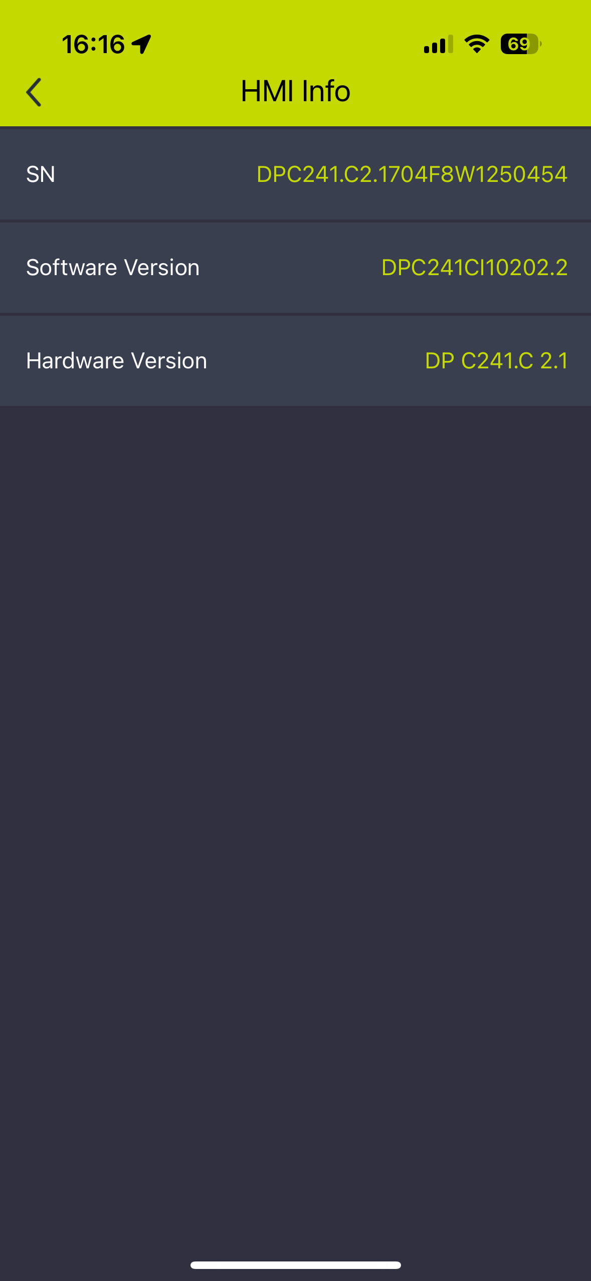

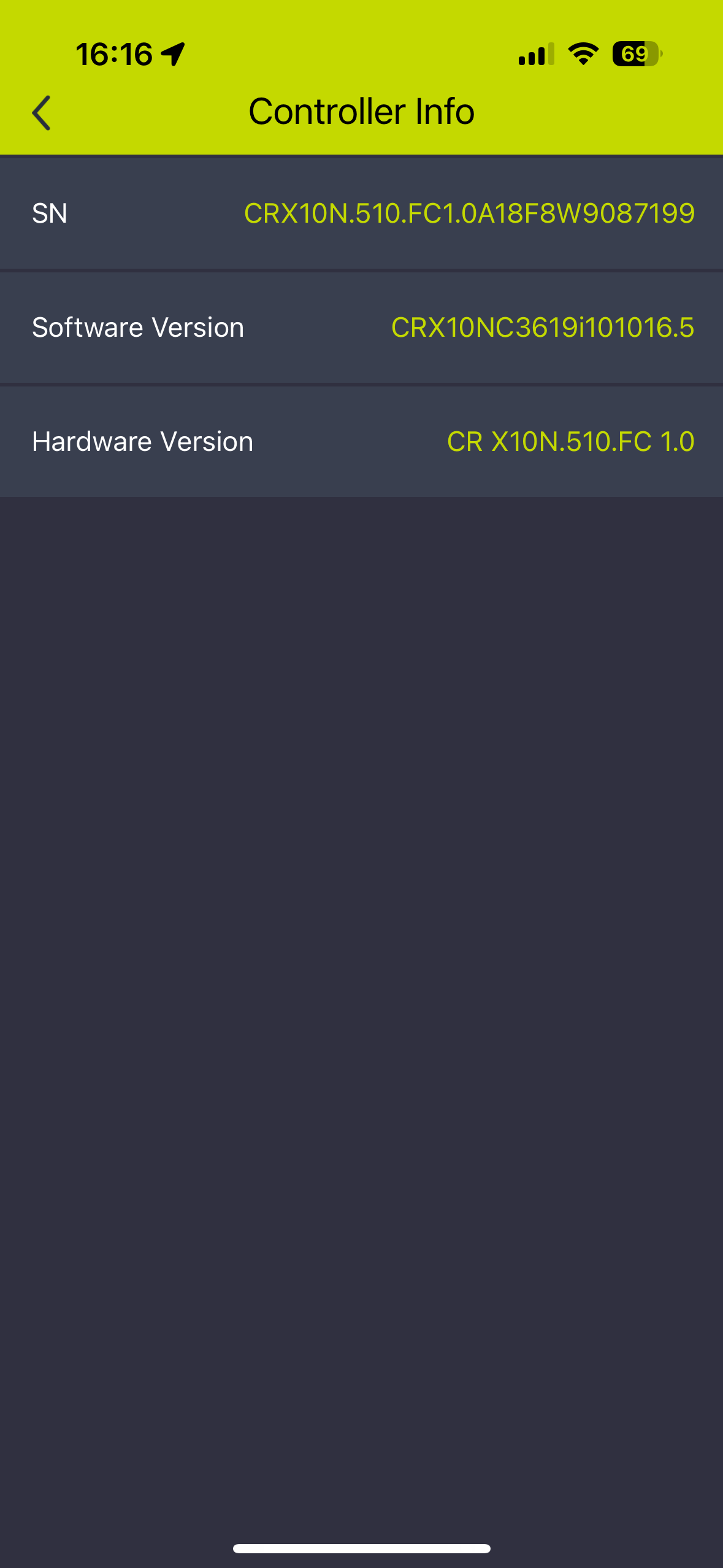

Hello everyone. I have a new bike. Leader fox with bafang m510 and LG 36V battery. I have a terrible on-off issue once pedaling lightly. Leader Fox suggested a new motor but the seller is sending me besst tool and firmware to flash. I want to flash the FW first as it is difficult to send the whole bike via post to them.
Can somebody tell me if my actual FW version is old or not?
And can somebody assist me while I try to flash my bike? Maybe @Dado if you find some time it would be great.
Thank you all. BR Petr

Hello everyone. I have a new bike. Leader fox with bafang m510 and LG 36V battery. I have a terrible on-off issue once pedaling lightly. Leader Fox suggested a new motor but the seller is sending me best tool and firmware to flash. I want to flash the FW first as it is difficult to send the whole bike via post to them.
Can someone tell me if my actual FW version is old or not?
And can someone assist me while I try to flash my bike? Maybe @Dado if you find some time it would be great.
Hello Peter.
Unfortunately Leaderfox bought M510 FC1.0 version 2 years ago and they need to sell them now (and same did also Dema and MTF). These versions are already outdated and you won't do much with firmware update. I doubt Bafang will be releasing some new firmwares for FC1.0, when now selling only FC2.0. Leaderfox know why they are proposing to replace motor. ;) Had also huge issues with FC1.0 - overheating and power fluctuations (but was peaking even 800W with overshooting, FC2.0 is regulating almost perfect). Your firmware version 16.5 is from October 2022.
Have brand new M510 FC2.0 sets if you want to buy - better torque sensor and more options to set motor parameters. Been already swapping these motors on few Leaderfoxes.
