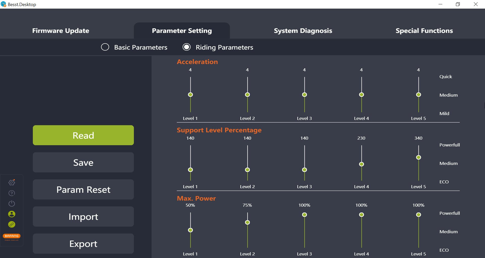

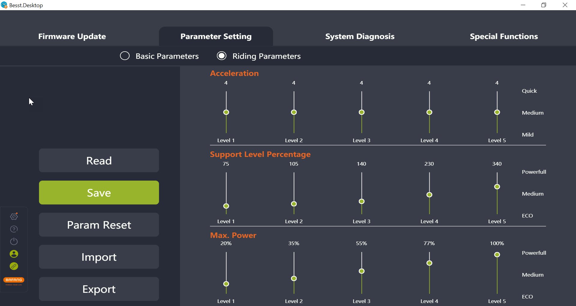

Today I plugged in the besst and found that the assist levels were reset. Has anyone had this happen? Any idea why this happened?
On the picture settings before and after
Hmm, interesting, have not seen yet to reset the settings. After reflashing firmware it is re-set to defaults.

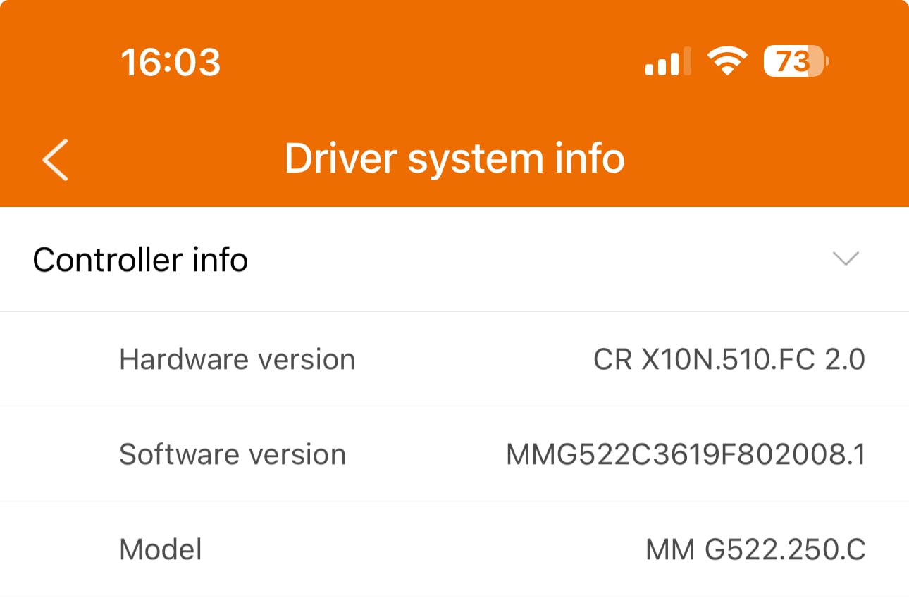

Hello,
Just signed up ….i have a basic question:
I bought in November 2023 a 36v M510 motor , you can read data in the attached picture.
It’s working very well but , is there an updated firmware?
Thanks.
Roberto
You are ok. Ver 8.1 is the latest from Bafang.
