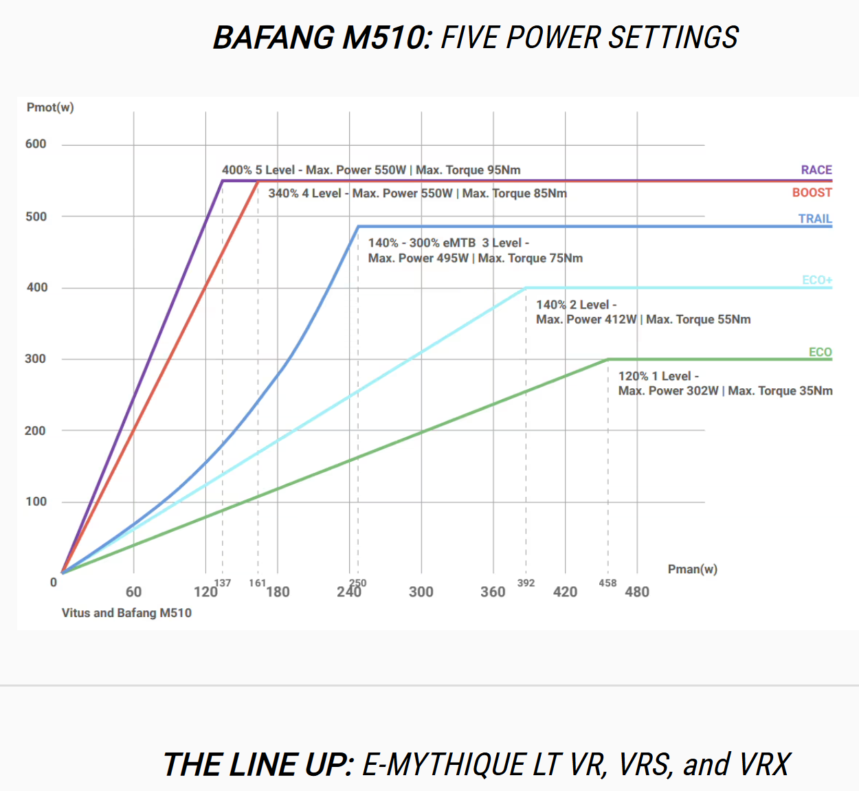

Good question. I would rather say it is not there such a thing dynamic help.
With Vitus firmware characteristics I saw this curve bent for Trail level, but up to you if you believe to this. ;)
I have Vitus firmware if you want.
Anyway to code such a controller behaviour is very simple, it is just a matter of translation rainbow table or some easy exponential function (instead of linear).

Question for Vitus owner about this "dynamic" (or automatic ?) mode (140% - 300%) seen on graph. Do you feel an diferency with this automatic mode in regard of other mode ? What you can see in BEEST tool parameter for this level (normally only 1 value seeted) ? Does somebody have an 48V firmware with this extended assist % range ?

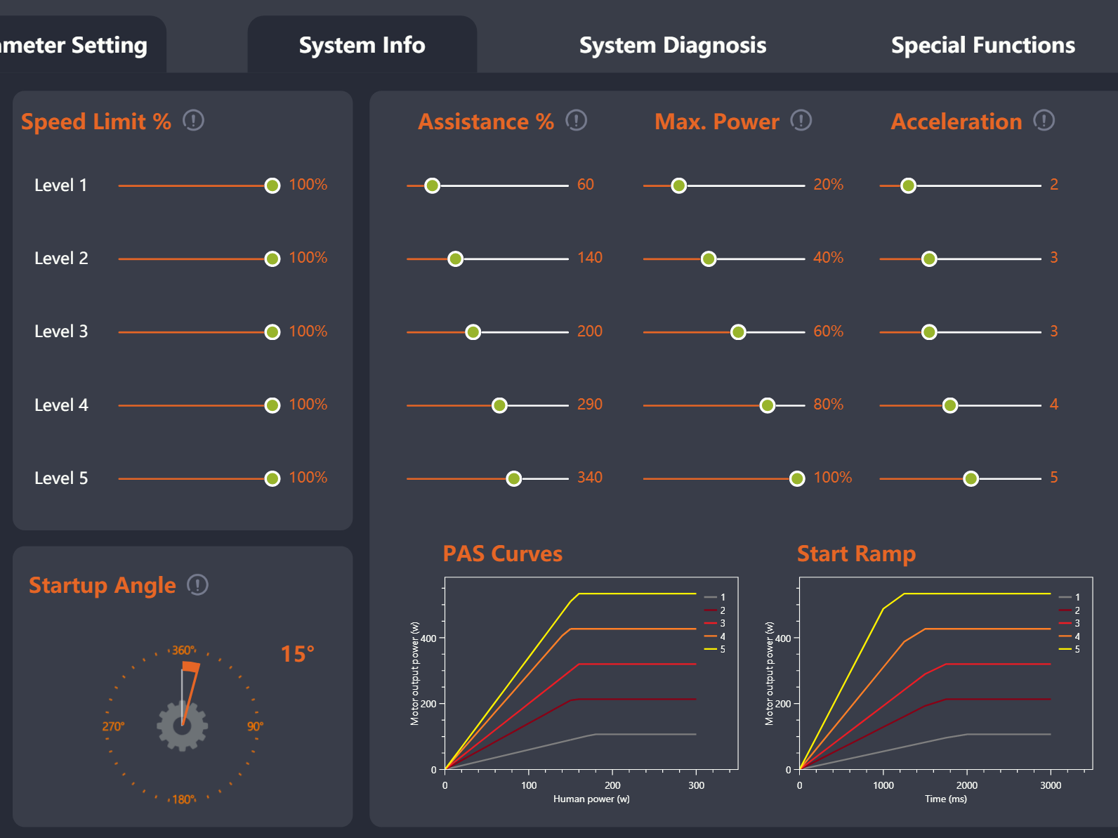

These are defaults after Vitus firmware flash, you wont see any exponential characteristics in Besst. ;)
It's exactly my personal setting at few differences (210% in 3 mode and 2 in acceleration for each mode ), after several testing.
Where do you find this setting ? At wich controler software rev it's associate ?
Hybridizer firmware, or custom firmwares v45.1 or v51.2 (36V).

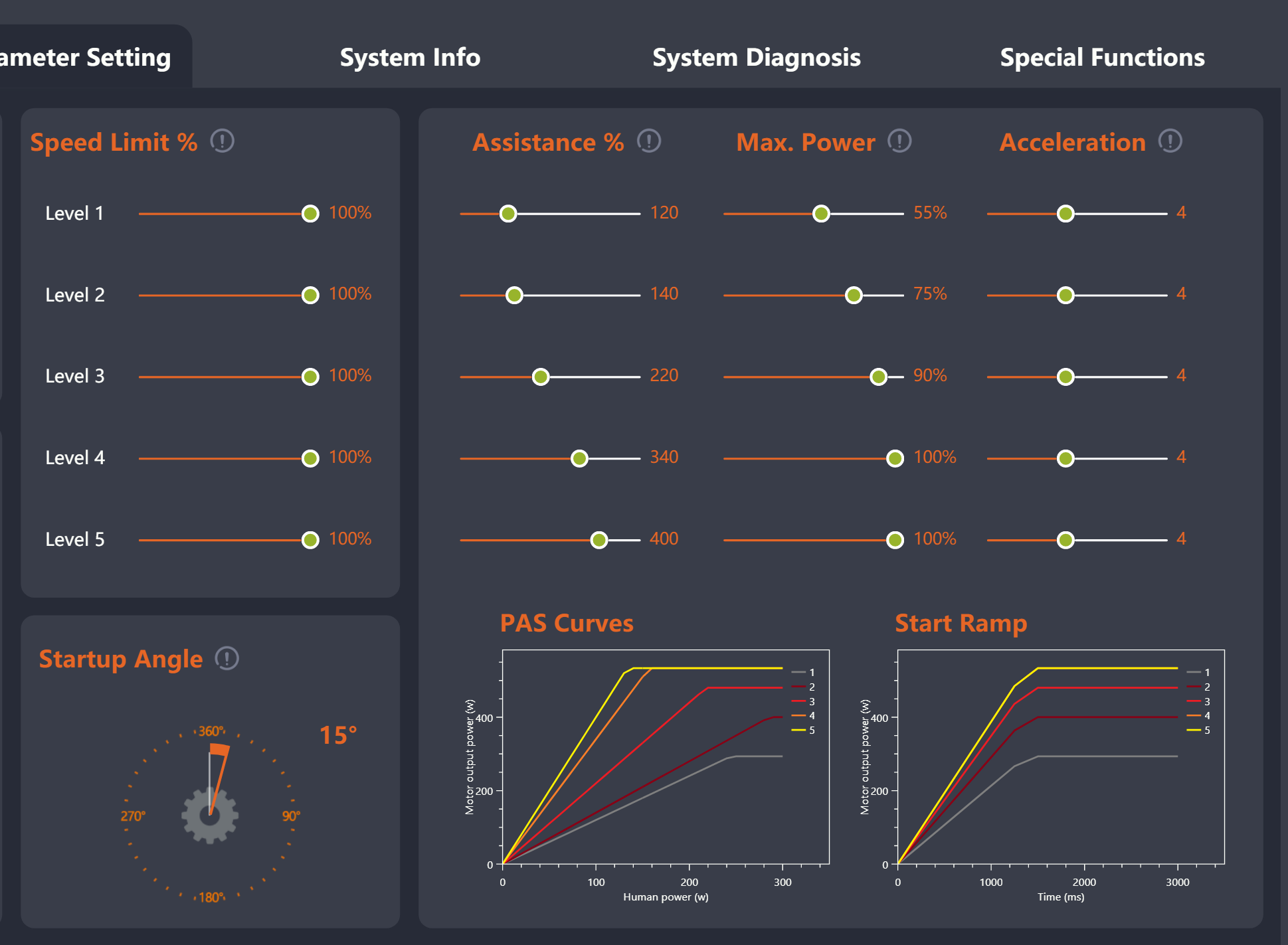

Yep, thats Hybridizer. Just a little off comparing to my last picture.
Why I pointed out? All M510 FC2.x are coming from factory with that high power settings: 50,75,100,100,100%
My mistake :oops:, i have not reading the complete name (hybidrizer). Maybe it's you who had shared it before ? i use it with these setting and i prefer at 50/75/100/100/100

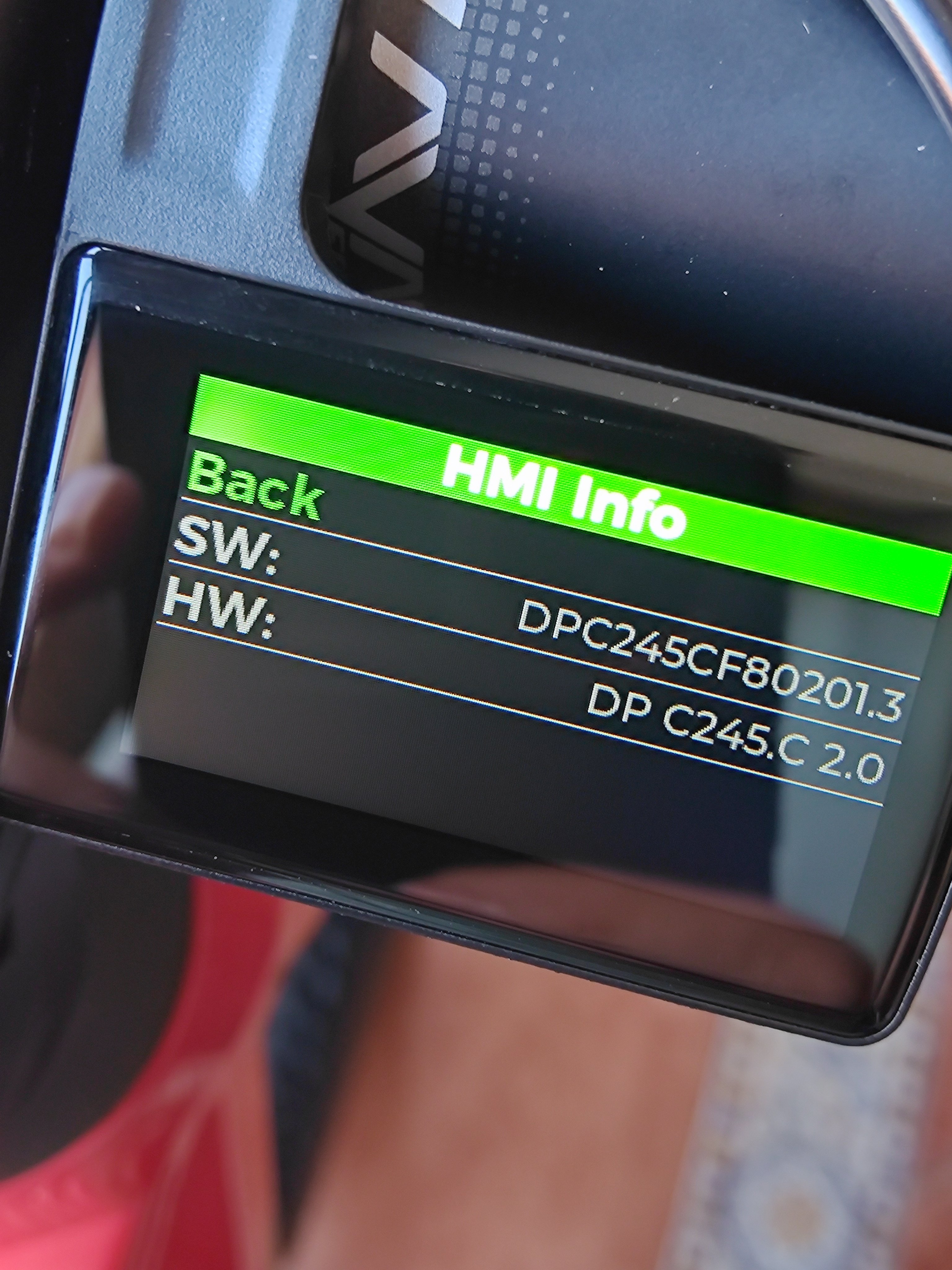

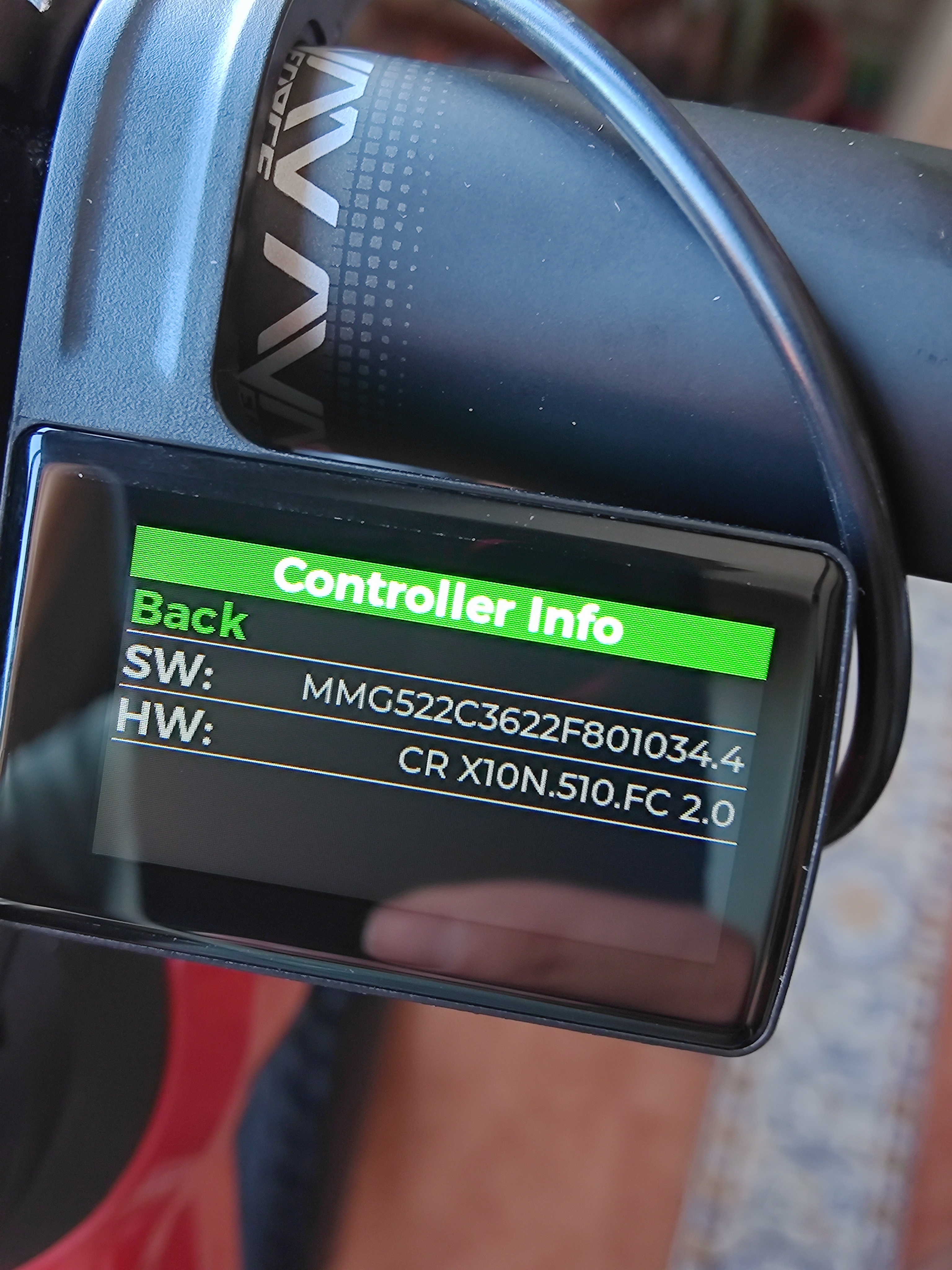

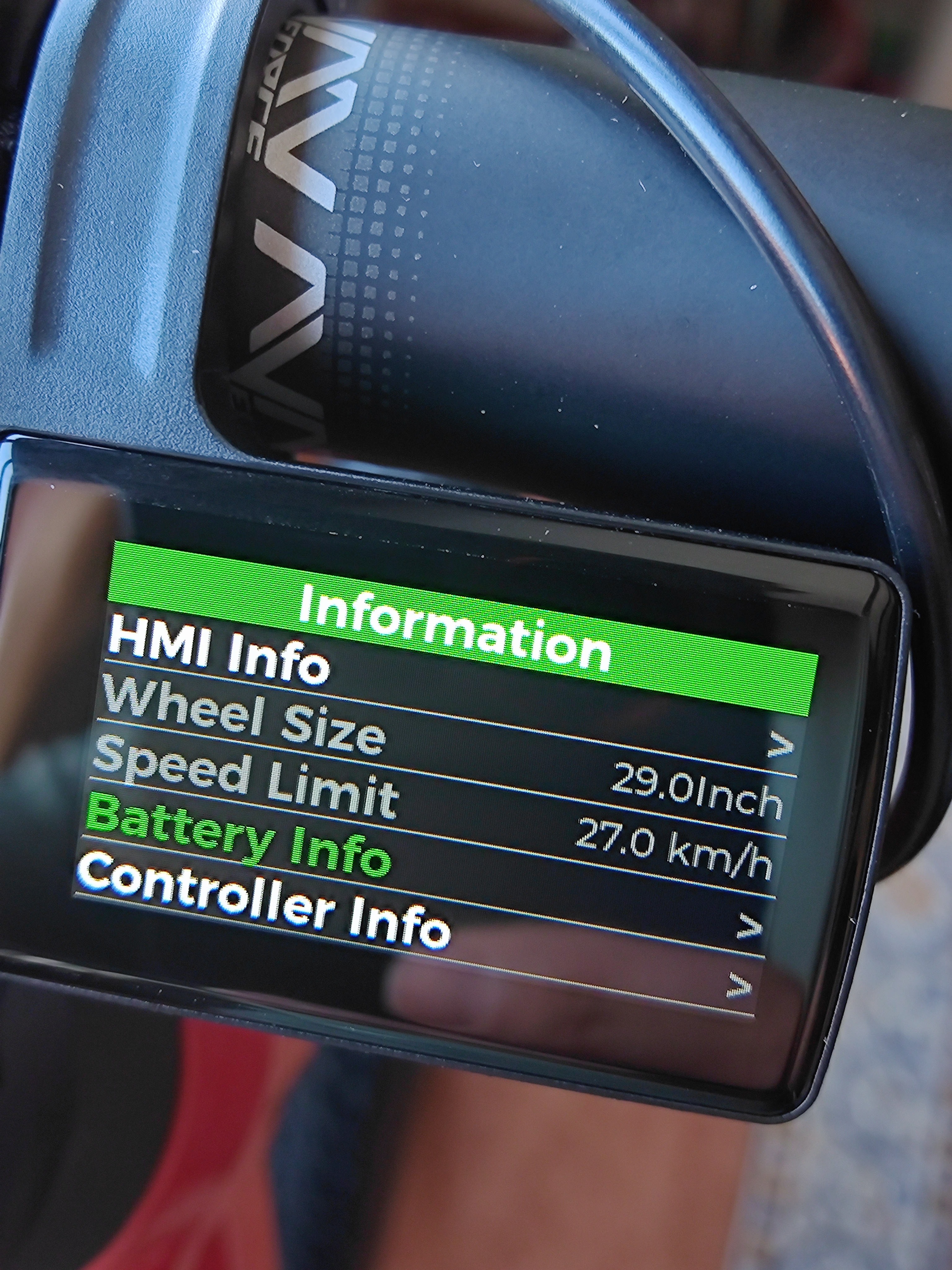

Got my bike finally Berria Mako HP6. I was hoping to get FC 2.1 ....but 2.0 should be fine hopefully.Sharing some info about it.Interesting that my speed limit is 27 km/h...

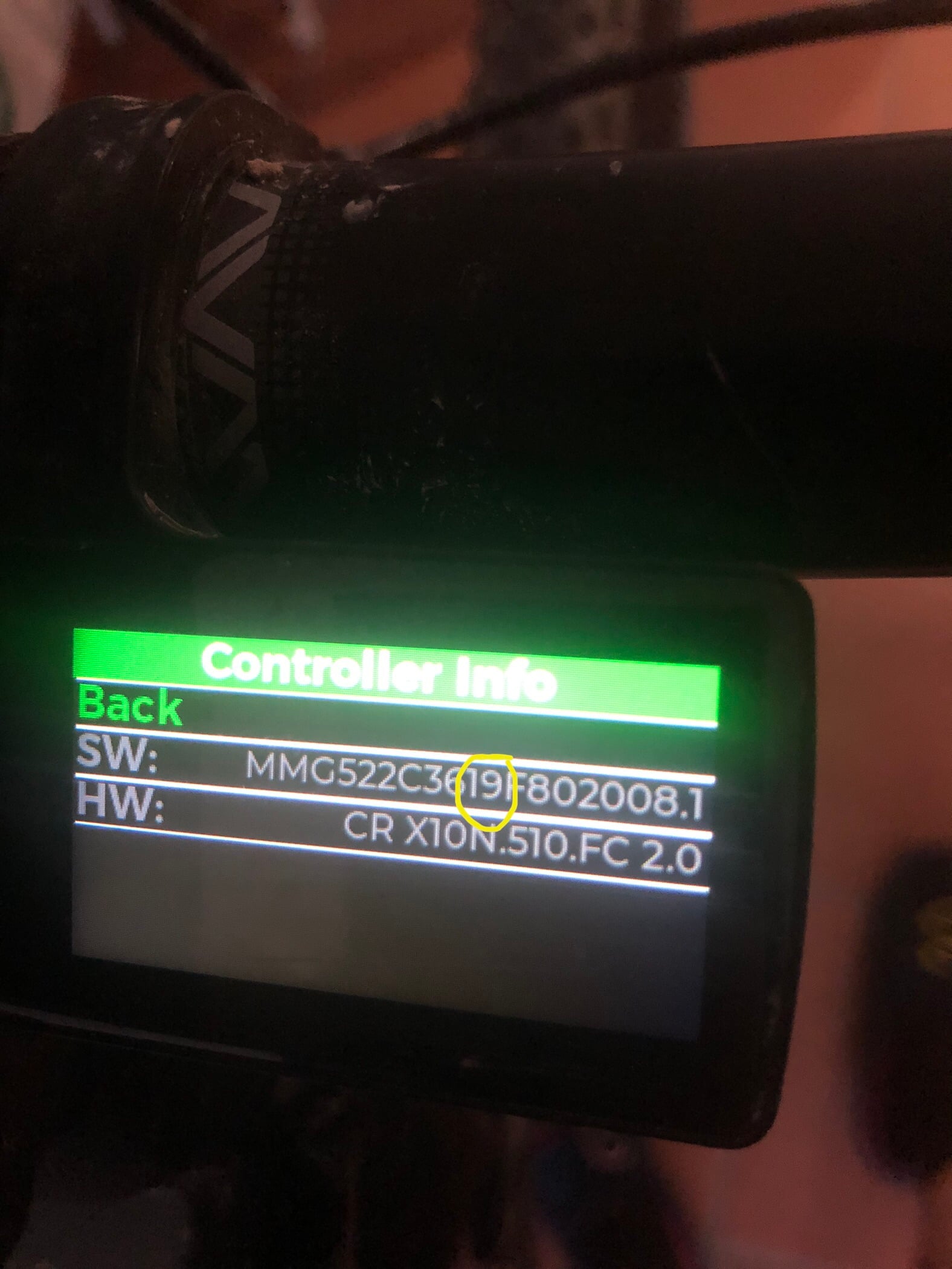

Looks like there is some custom more powerful 22A firmware, if somebody will come to this bin fle would be great:
SW: MMG522C3622F801034.4
HW: CR X10N.510.FC 2.0
Seems my Berria have exactly this SW and HW. So it is some more powerful firmware?

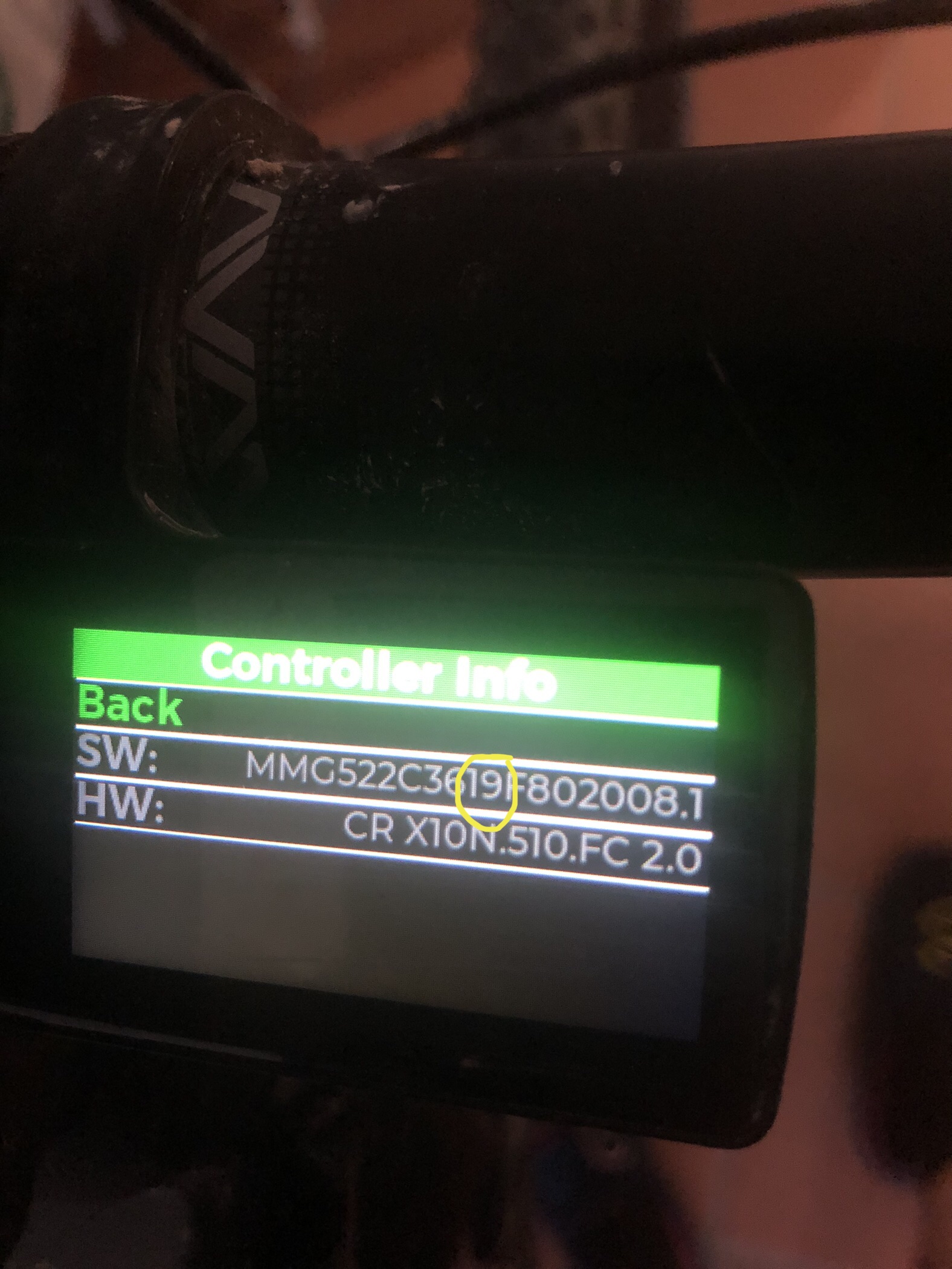

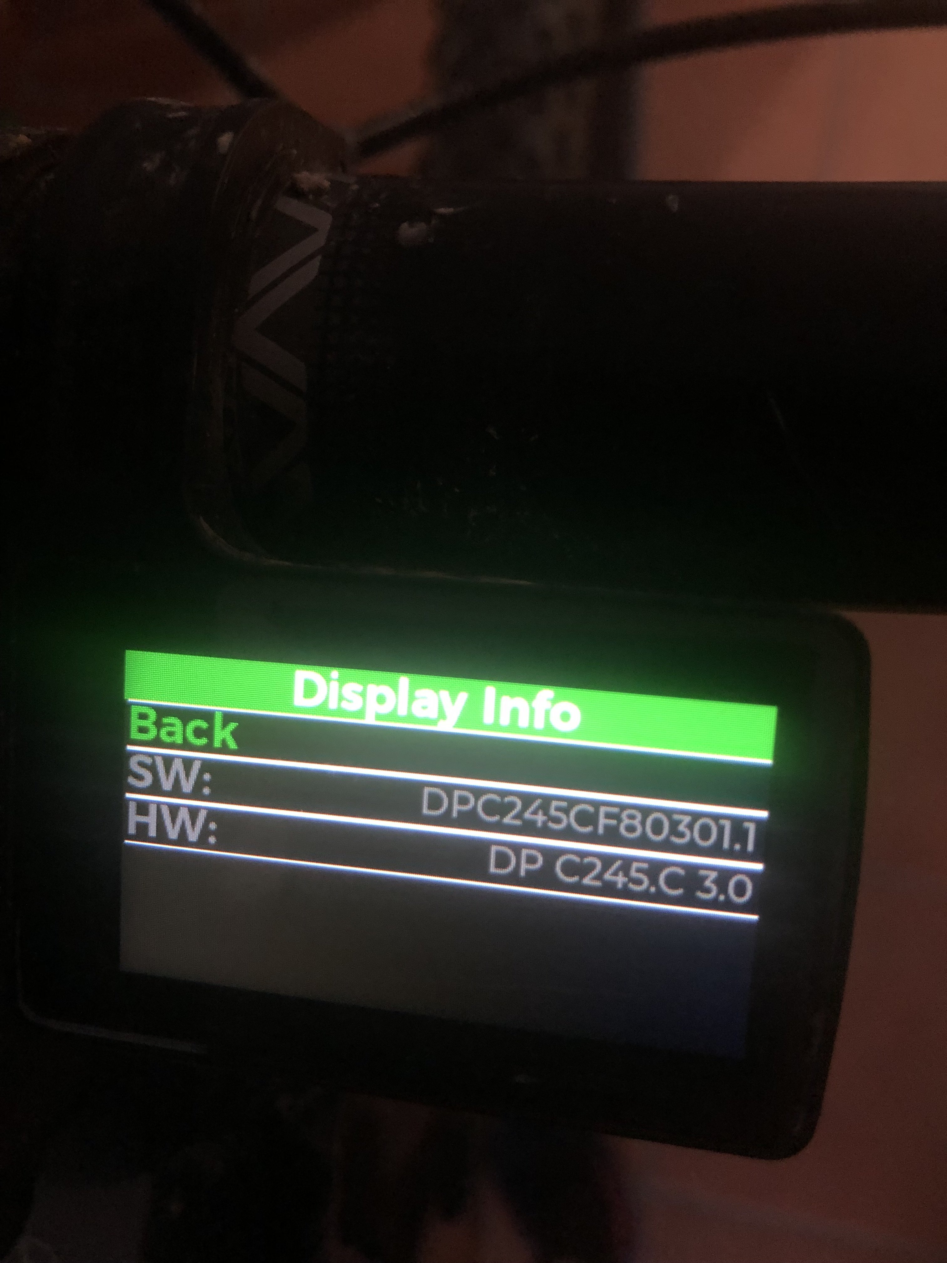

Hi, I have this one and I upgraded it from 15A to 19A and I see that yours is 22A. I think it's better to see if those who understand well can tell us, and mine is also a 2.0 fc from a berria. IMG_5541.jpeg
View attachment 158057Hi, I have this one and I upgraded it from 15A to 19A and I see that yours is 22A. I think it's better to see if those who understand well can tell us, and mine is also a 2.0 fc from a berria. View attachment 158058
Mine came with this firmware. So this is the most powerful firmware (22A) for M510 ? Unfortunately my display is v2.0 so I can't adjust the power levels no matter which appr or version I use.
Yep, seems like 22A. So 830W peak electrical, that will be cca 670W mechanical. New Brose S-works has 720W. Not far away.
Yep, seems like 22A. So 830W peak electrical, that will be cca 670W mechanical. New Brose S-works has 720W. Not far awaw
I guess Berria decided to be generous with their Mako ...or I just got luck and they have no idea what firmware they put. Either way ...it's good to have some more power. And it's strange why my speed limit is 27 km/h.
Dont know why 27kmh. Maybe like that Trumps tarifs. Just out of nowhere. ;)
Just change the speed. Can give u some discount to K1 Flash.
