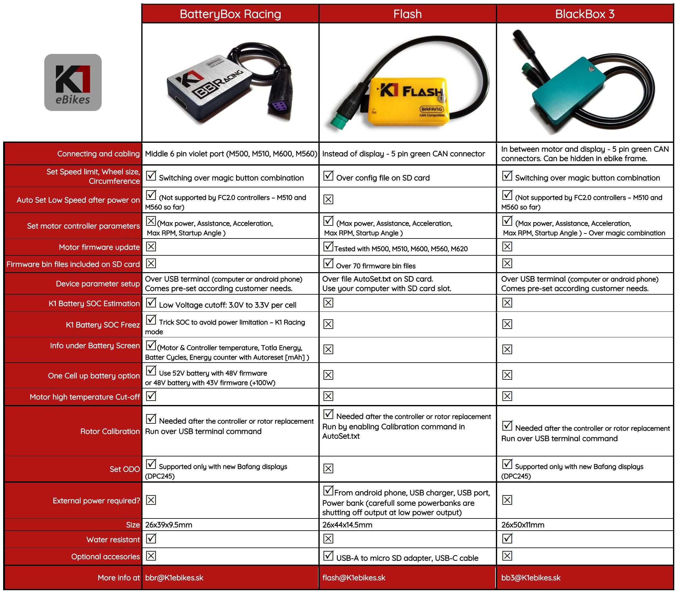

Thats right. I guess you dont have original Bafang battery with CAN bus. Then motors are starting to limit power later. Depends on firmware though.
Shouldnt be starting at 50% - thats too soon. M600 was starting at 30%, M510 FC2.0 at 25%
There will be soon something to trick this - K1 BBR. ;)
There will be soon something to trick this. ;)

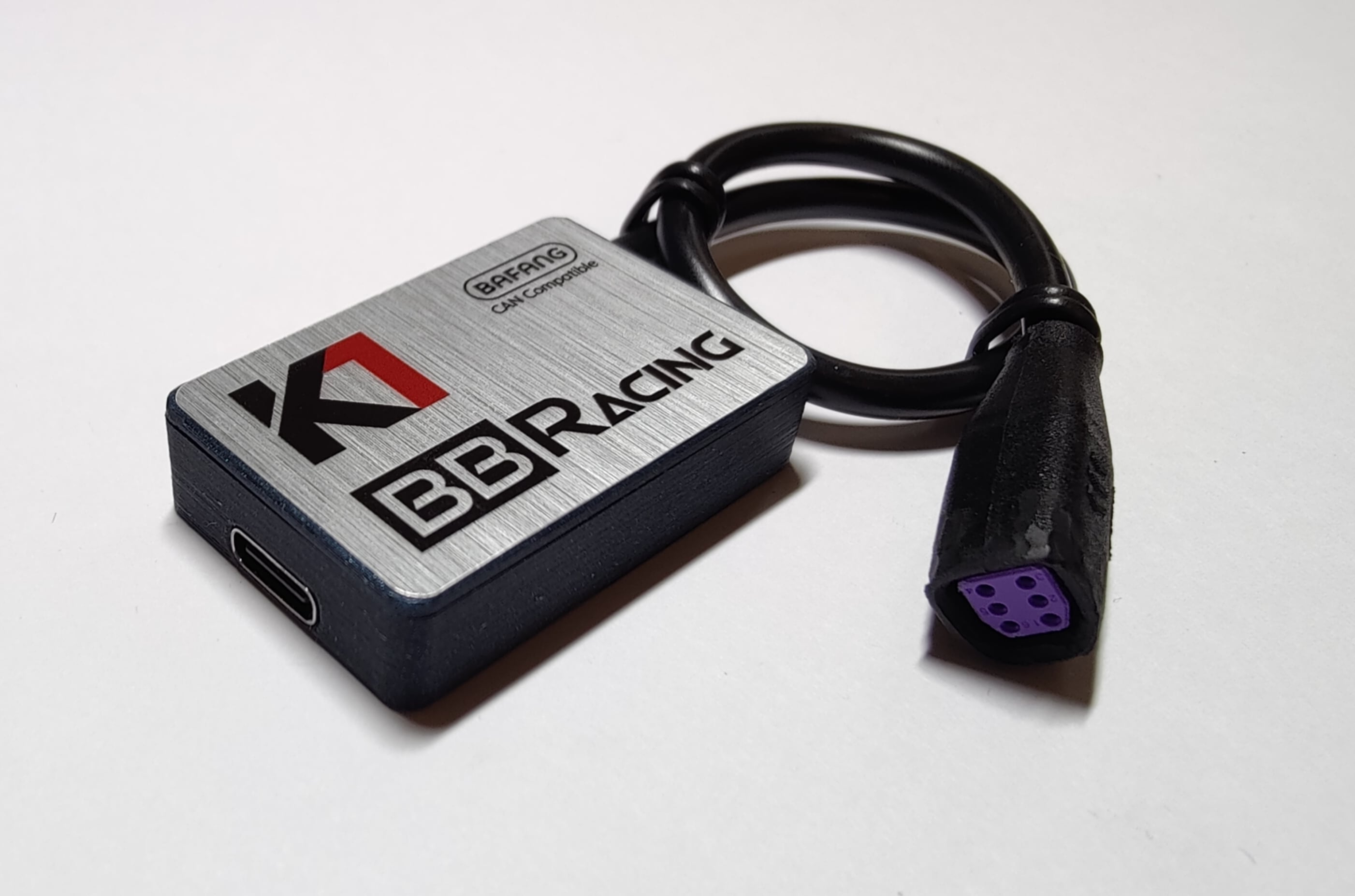

You wont have correct SOC reading if you dont have 52V firmware.
But there is a trick with K1 BB Racing device.

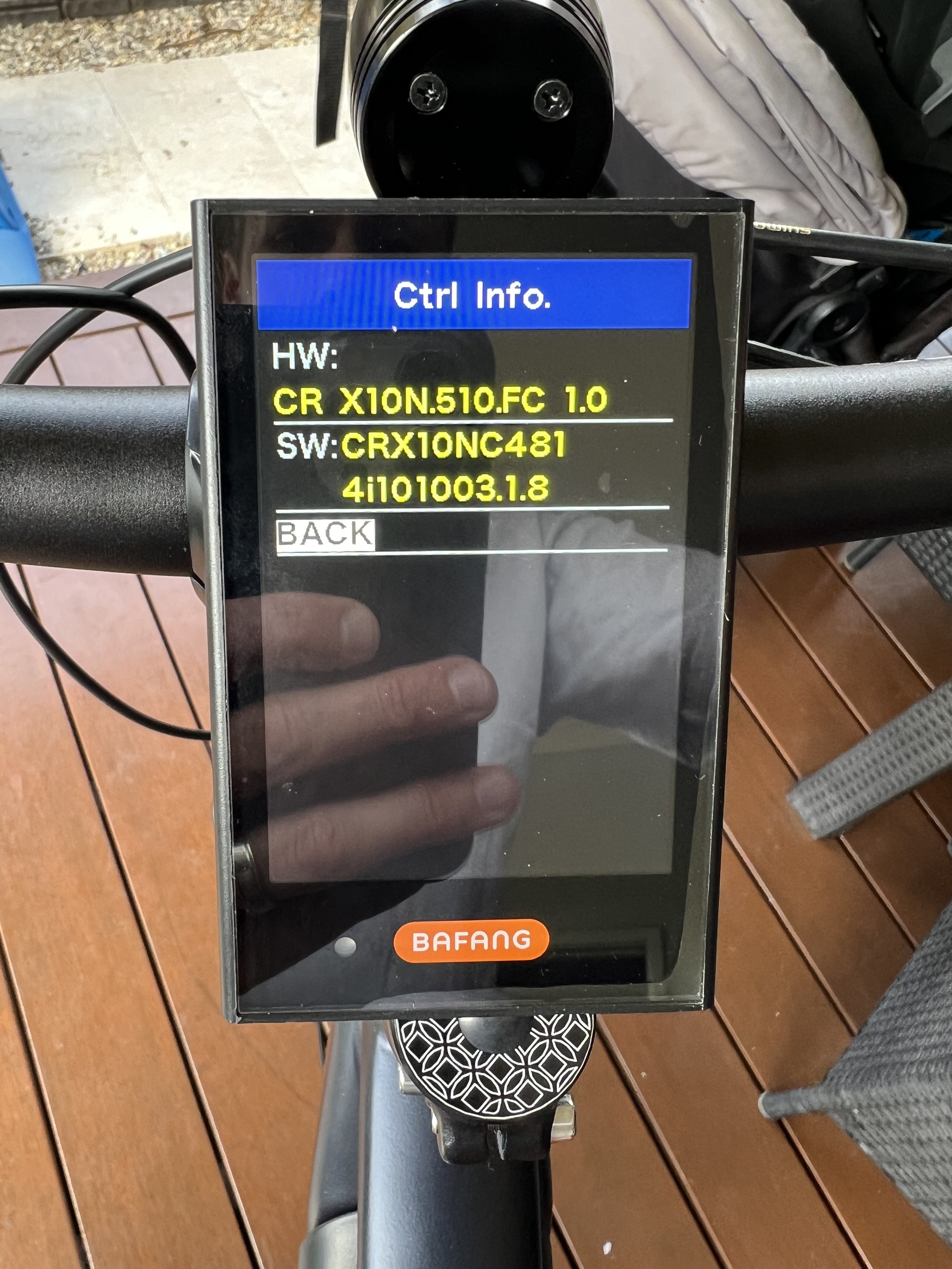

Dado - here is the firmware I’m currently running. It seems to work ok with the DPC18 display I currently have. Not sure if that means it’s a 52v firmware or 48v.
Thanks.
Hello.
You have 48 Volts firmware. ...C4814i... Thats voltage and max allowed current 14A. Have not seen yet 52V firmware to M510.
Are u sure u have 52V battery? Then it would hold some time SOC at 100% after full charge. Even 1/5 of battery capacity.

You are peaking 800W with this combination. More poweeeer. ;)) Also K1 BBR can do this, there is even little more Wats with 43V firmware and 48V battery combination.
