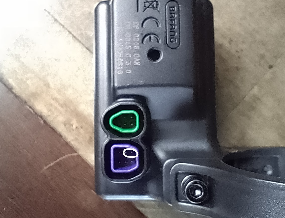

Hi. Washed my bike yesterday. It rains very rarely in Turkey, I can't remember the last time I washed my bike, the next day it wouldn't turn on :) The problem is that the buttons or the display DCP245, I'm not sure which one, are not water resistant as Bafang claims (Bafang says it's IPX6). Replaced with an old control kit and all is ok. Considering I haven't used a high pressure washer, it's not not good for the first wash (for the display and buttons, I mean). There is no damage or cracks on the buttons or display. Has anyone encountered any problems like this?
The buttons and the 245 seem to be running into several issues as they've become a bit more main steam EMTB in wet climates (with the Vitus).
You can jump start the 245 by shorting the two display pins nearest the centre of the display to identify a buttons fault :
There seem to be several other bikes needing replacement displays, a few days of drying to work again or bikes throwing up random 05 and 35 errors and some even riding off on their own with no throttle on the bike or anyone on the bike.
Several are just loose display connections, but haven't worked out what all the others are yet.

My guess is it's the buttons, 2 times the bike turned on but no mode switching, also the bike turned on 2 times when I put the battery in
