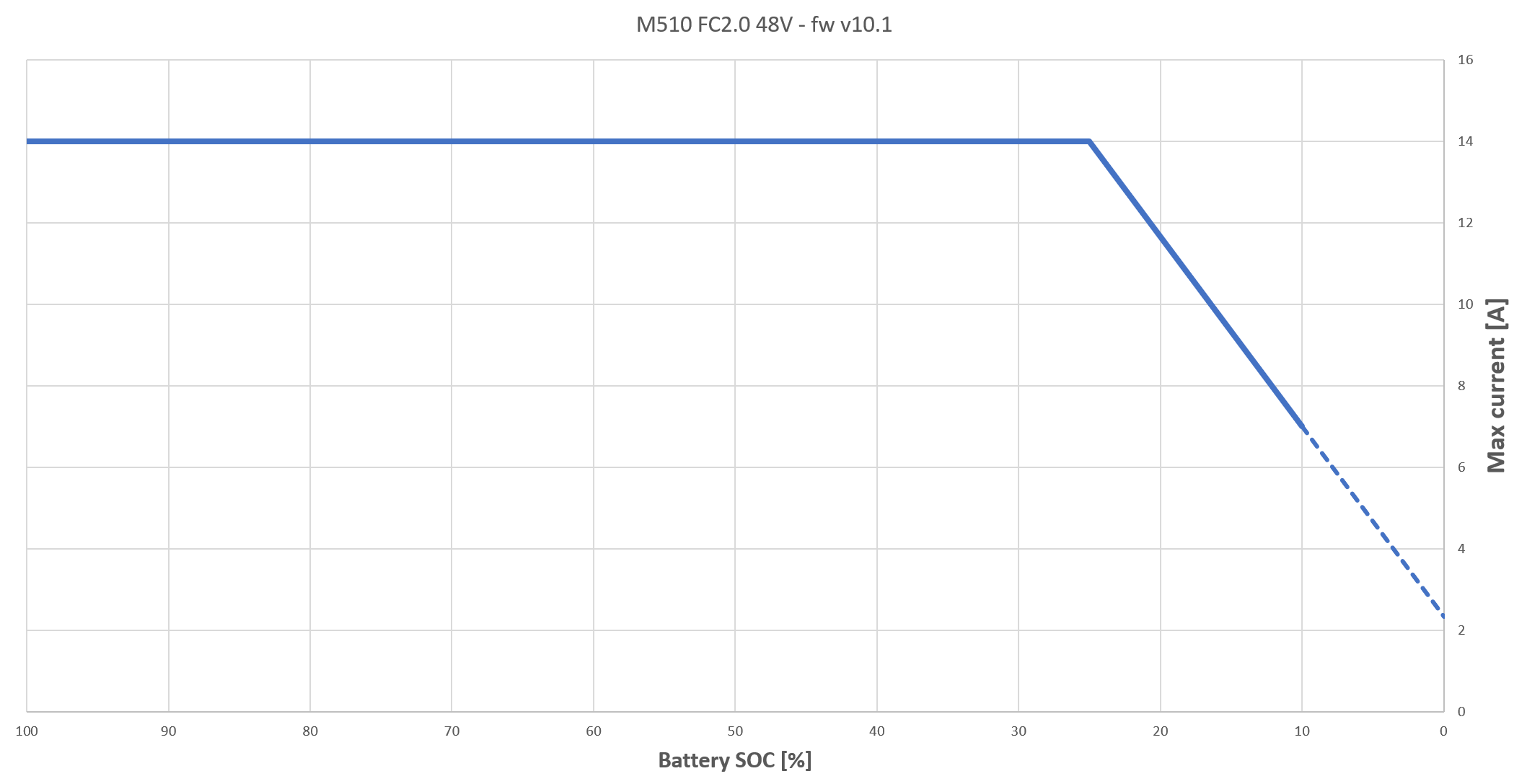

Yes, best is to check current at max power, what usually displays dont show. :( Try app.
But Bafang finally managed how to lineary ramp down current - woohoo. Till now there was just power jumps at 30,20,10%. How hard is to multiply current output function with power limitation function?

Interesting. I see up to 700W with my 14A firmware…
This is the power limitation ramp down for 48V v10.1
And current regulation is really precise now.

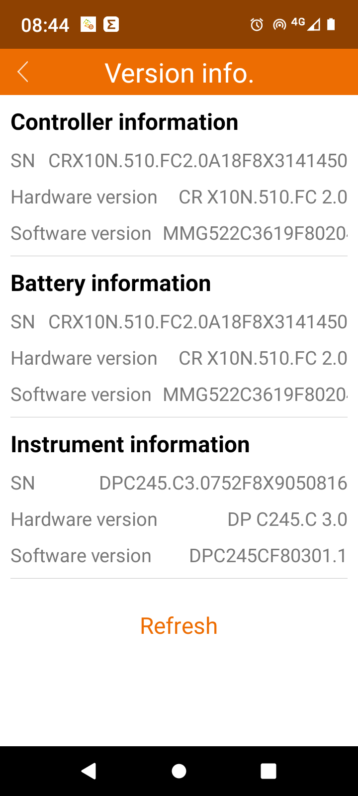

C245 v3 finally arrived yesterday after FedEx shipped it round the world several times.
Connects to phone and works without the error you get connecting to the v2.
New phone only had Bluetooth 5, not 5.1. So not sure why go+ insists on 5.1
Display boots with the bafang screen not the Vitus screen and all the modes are the bafang modes not the Vitus modes, so presumably some of the control info is held in the display not the fc2 ?
App was a waste of time, couldn't see or do anything. Less than go.

Vitus have already said I'd need a firmware update to use the 3.0 - most likely to update the screen software. (V3 - DPC245CF80301.1 , V2 Vitus DPC245CF80221.0)
The most relevant part though was surely that even though GO+ actually now works, is that it's totally pointless and shows you less and lets you do less than using a V2 with GO.
