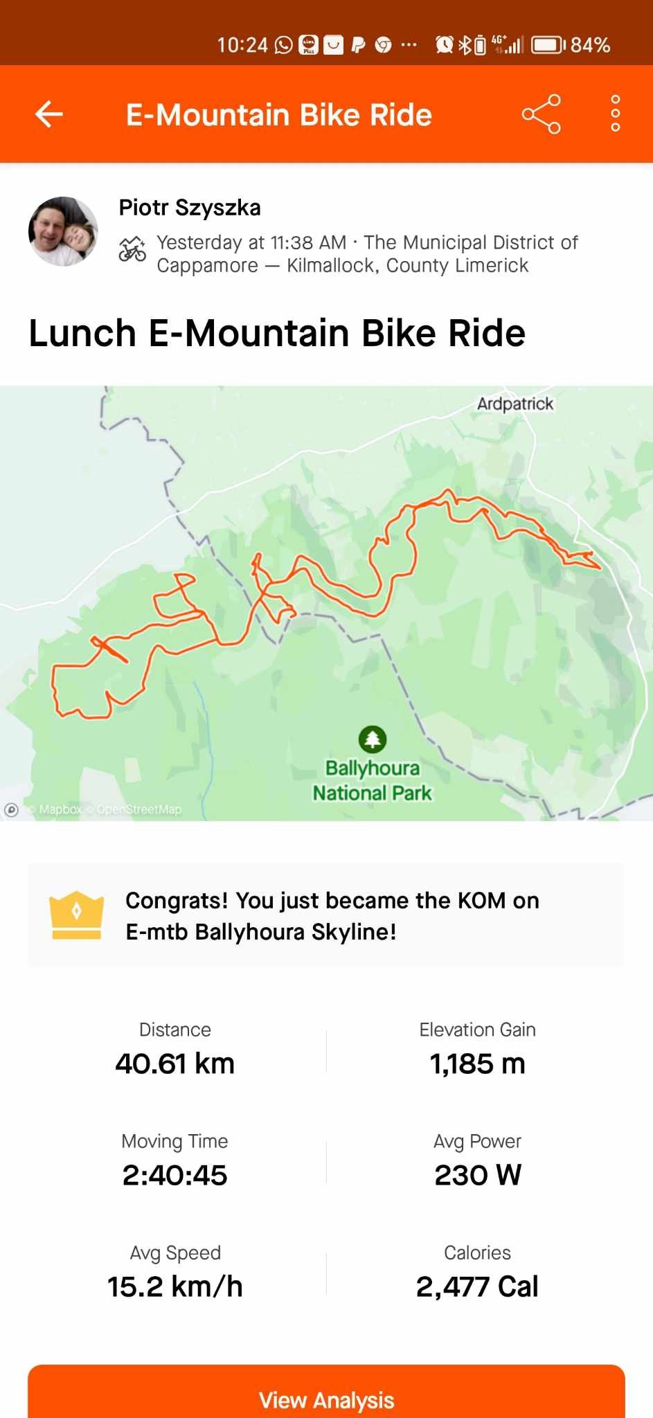

I weight about 95kG in the pants so close to 100kG geared up.
Yesterday I have done 40km@1100m about 55% battery used (DIY battery).
''i can't climb 20% during long time, that i can do with the M510''
Please elaborate a bit if possible, is it M820 throttling and loosing power after a long climb ?
