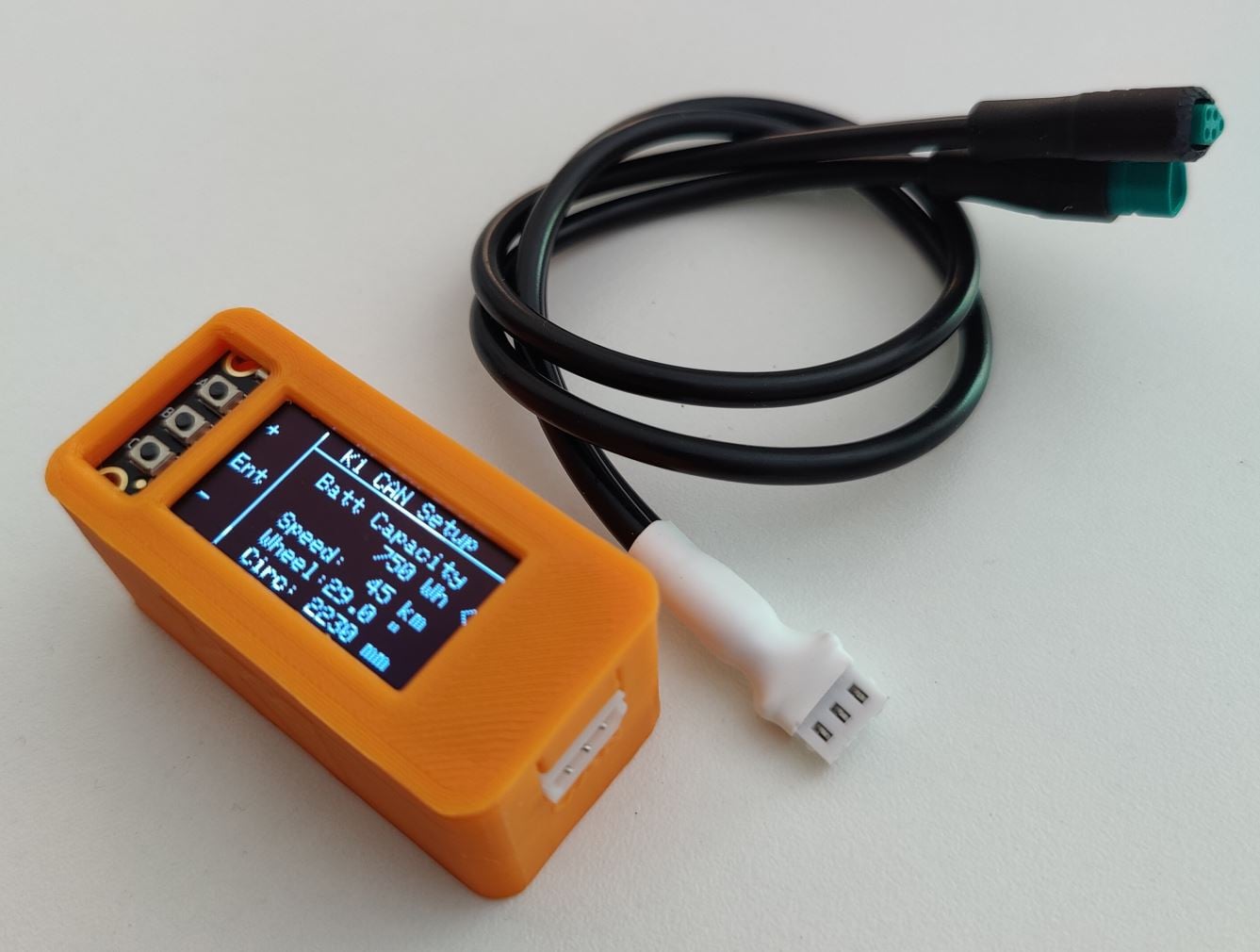

K1 eBikes has designed small, portable and simple K1 CAN Monitor & Speed Unlocker - no need computer or mess with BESST. Works ONLY with Bafang motors with CAN bus (green connector to display with "house" shape 5 pin connector).
For more info check the following link:
https://endless-sphere.com/forums/viewtopic.php?f=31...
How to unlock speed:
https://youtu.be/6z3TzEqNWsQ
If you interested, send an email to [email protected], will answer any questions and will send user manual.
K1 CAN Monitor is determined for testing purpose only and is not waterproof.

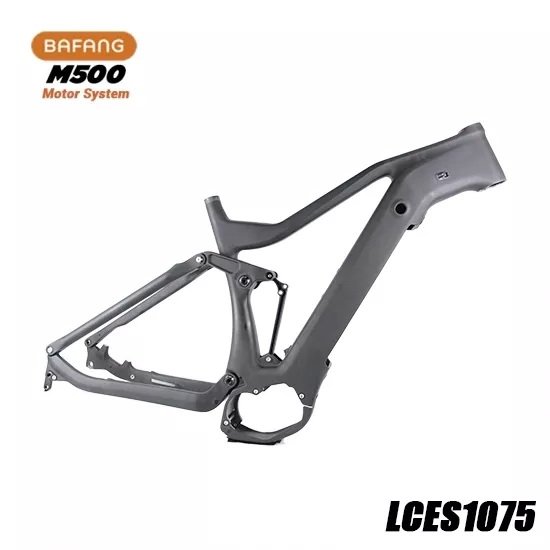

Hi Jim ! Tell me, does the LCES1075 frame really weigh 2800g? Is it a weight with a lid and a battery mount? You already have a ready-made lightweight frame, why don't you install the M820 motor on it?
The frame LCES1075, the production capacity is not enough, because the production process is too troublesome, so it is only provided for some large partners. Individual customers need to wait for the opportunity to have inventory.
And In actual use, the feedback of LCES1075 is not as good as that of LCES004, LCES004 is the classic frame,
The new frame uses an ultra-light motor and ultra-light battery, so the weight of the whole vehicle can be close to 18-19 kg, which is very close to the new EMTB of treck, while the weight of the LCES1075 is 22-24 kg, which is lighter less than 500g than LCES004. We have used it as a prototype and developed more than 15 proprietary molds, including the LCFS1075, which was also originally based on the LCES004 and designed for a brand owner,

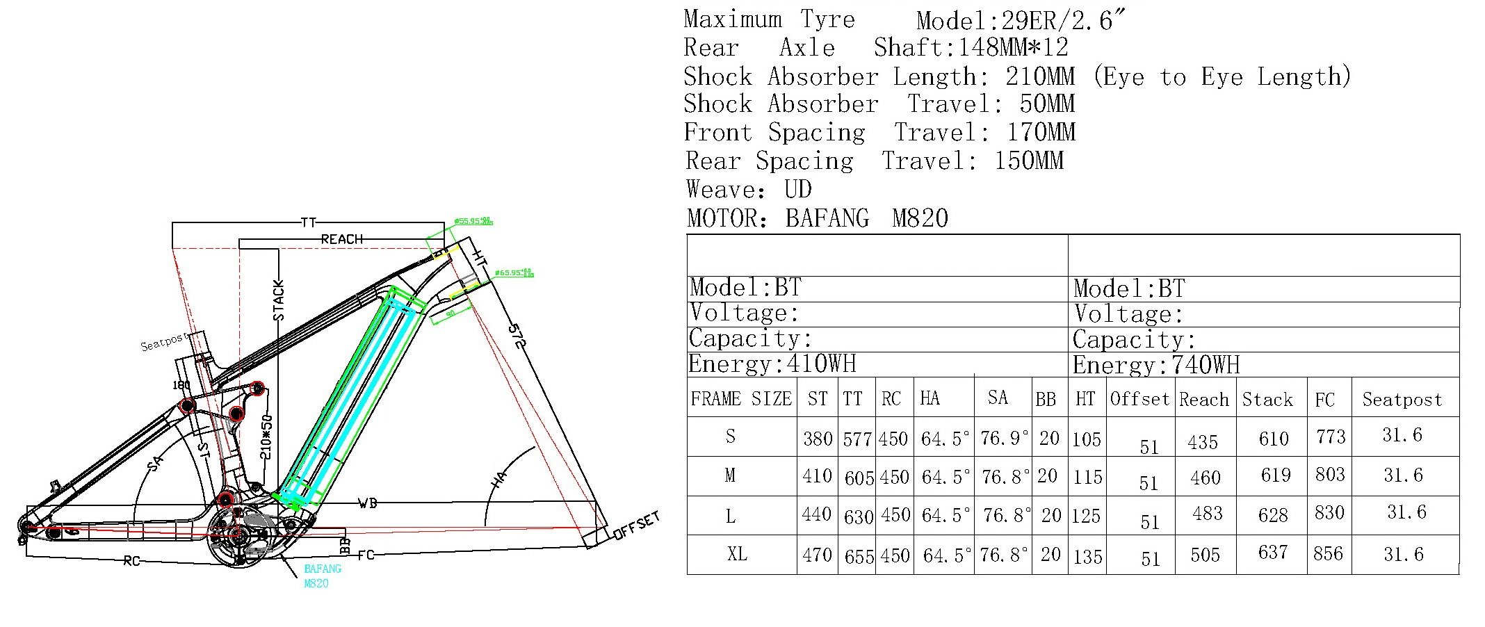

The LCES1075 frame attracted me with a smaller weight and a smaller stroke of the 51mm rear shock absorber. The RockShox Pike 2023 140mm fits well with such a frame. And why didn't users like it?
Let's discuss the new frame for the M820. I don't understand why the rear suspension stroke is stated to be 150mm. Shock absorber 210x50mm. Fork stroke declared 170mm
I would love to buy a frame with a 140mm stroke. You can install Pike ultimate 2023 with a weight of 1800g on it.

The frame is promised to be made at the end of December. What do you like about geometry? I can't understand why this frame has a stroke of 150mm, a shock absorber stroke of 50mm.
It is kind of odd, I usually only see those size shocks on 130/140mm bikes, but I’m no suspension expert.
This is a trunnion mount shock, therefore the shock length is relatively short for 50mm travel. At an average suspension ratio of 3:1, the 50mm shock travel will provide 150mm suspension travel. You could easily overstoke it with a very common 210x55 shock by using offset bushings if needed. Ending up at appr. 165 mm travel.
