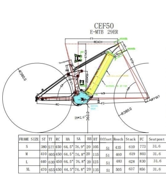

Assuming a comparable price point and parts availability I'd purchase an XL frame. The reach, HA, and stack are looking much better on this one. I was considering getting a E11 frame from1can but they haven't ever listed the 20.5 inch frame for sale.

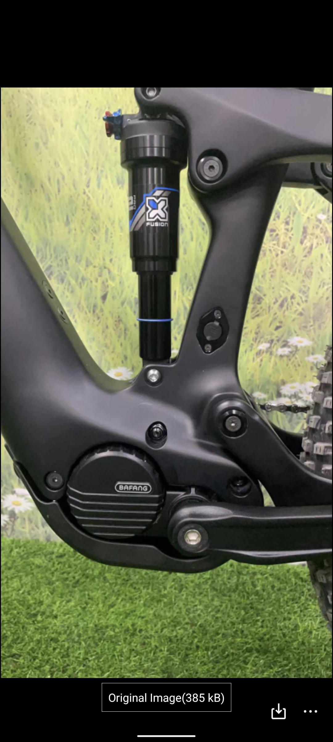

Can anyone confirm the mounting pattern of M820 is the same then M500/510/600?
I think the mount is different. The motor is smaller. But we can always install it on the E10 frame using good hands and a good tool. I have already ordered the M820, it will arrive in 2 months. I want to try to install it on E10 and test it.

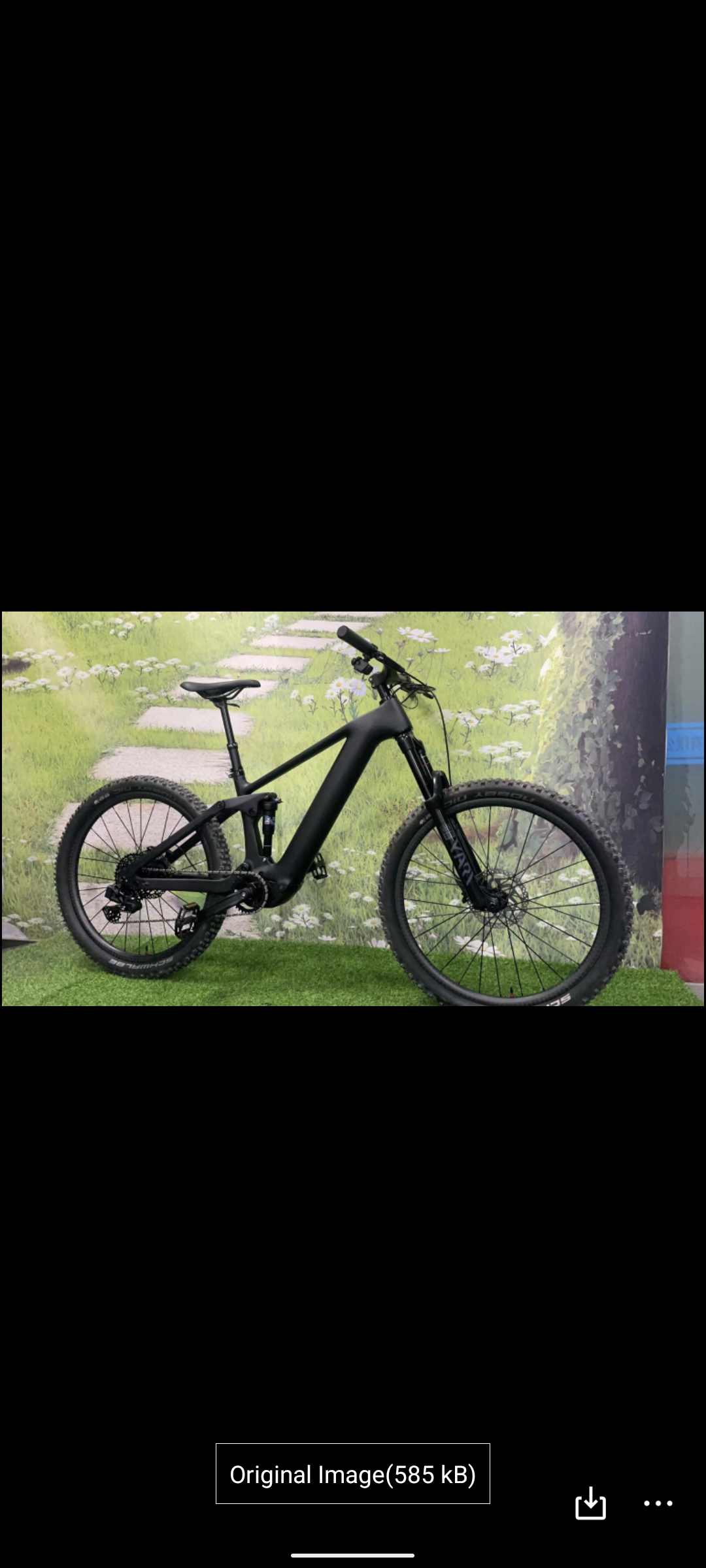

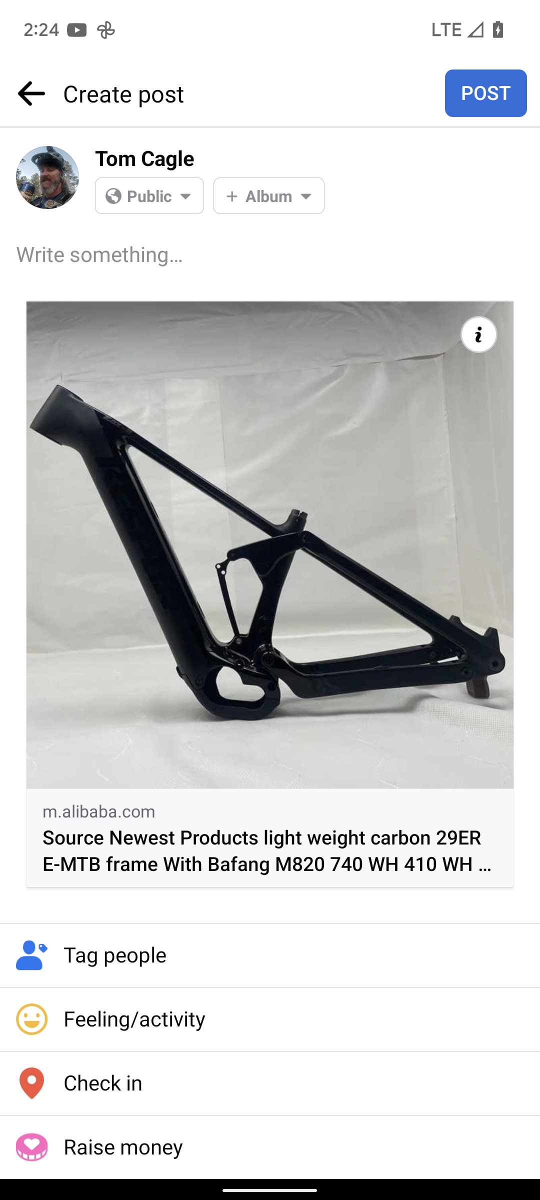

It seems that a frame will be available with the possibility of ordering it with the motor and two types of battery, with a 170mm fork and a 150mm shock absorber. Any news about it.
The frame CEF50
Shipping to Europe
¤¤¤ Frame only $726 ¤Frame+motor+battery= $1770
¤¤¤ The shipping cost is 308 USD by air with DDP service( door to door and include customs tax)20days
¤¤¤ Ship by boat is 202 USD with DDP service( door to door and includes customs tax), 40days

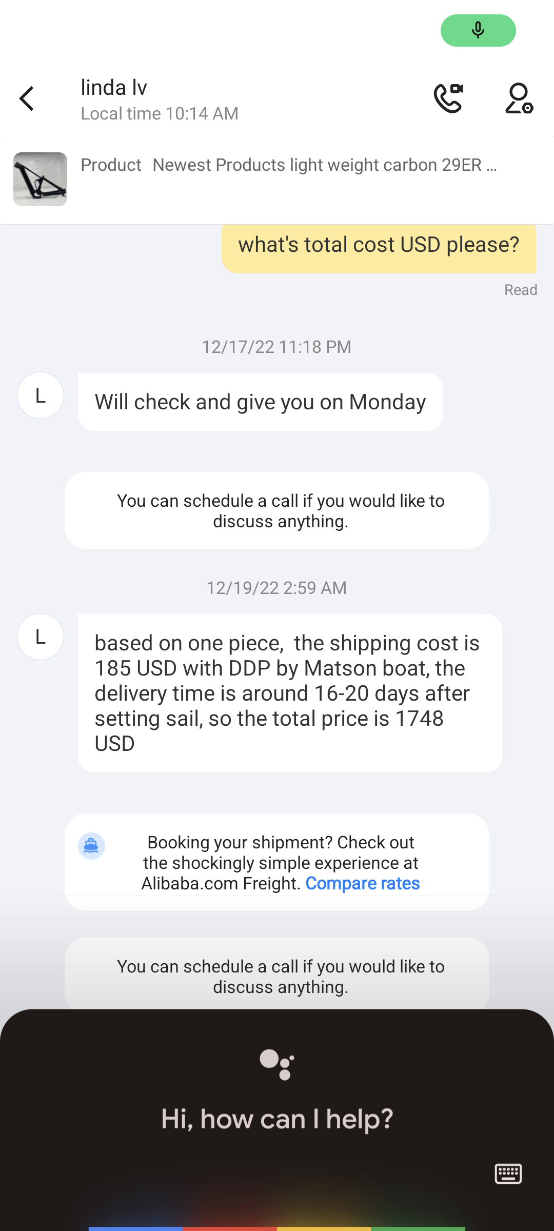

Good follow-up! 👍 I communicated with "Linda". I specifically asked her if price including shipping in the "total" in that quote.😜
It's why this forum does well to help ferret out the huge miscommunication potential in dealing with China direct factories--- I've been burned a few times for not grilling the salesperson like a legal prosecutor in a court trial.😄

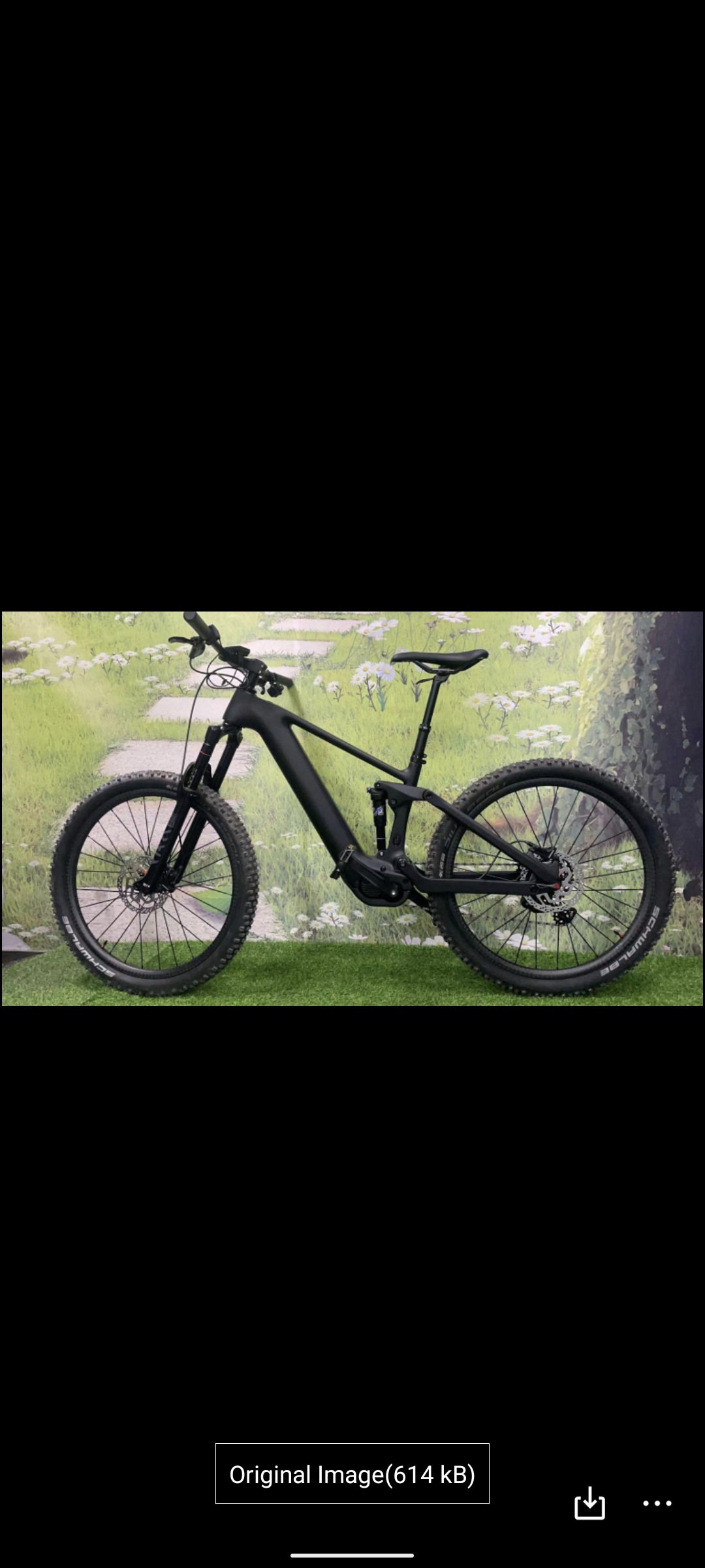

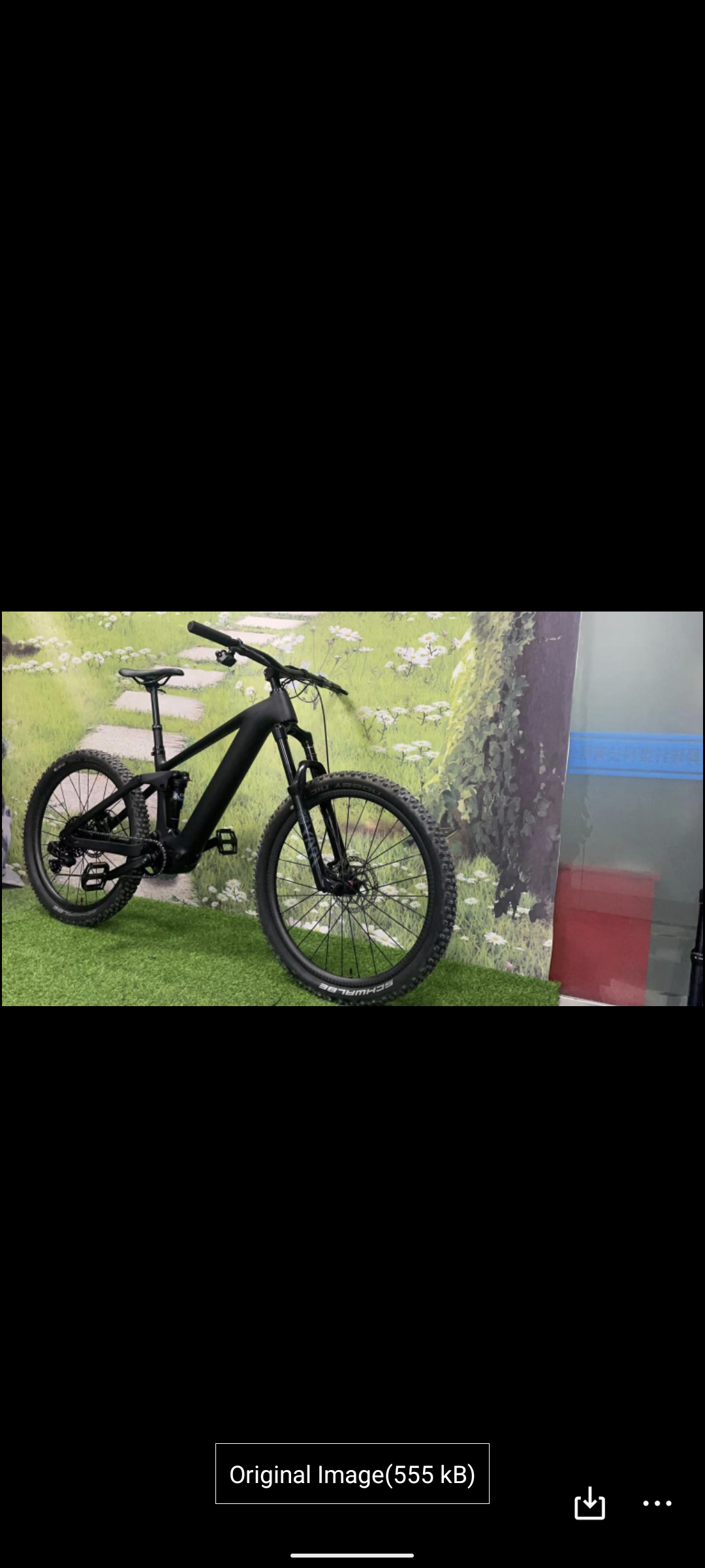

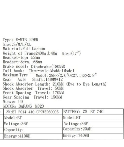

The frame CEF50
Shipping to Europe
They are also supposed to be the manufacturers of this frame (actually like everyone according to them)
¤¤ it is avaiable around end of Feb 2023
¤¤ the highest capacity is heavier than the bafang battery 1.2kg.
The Tantacycling frame will be released before this one. lightcarbon at the moment seems to be delayed.

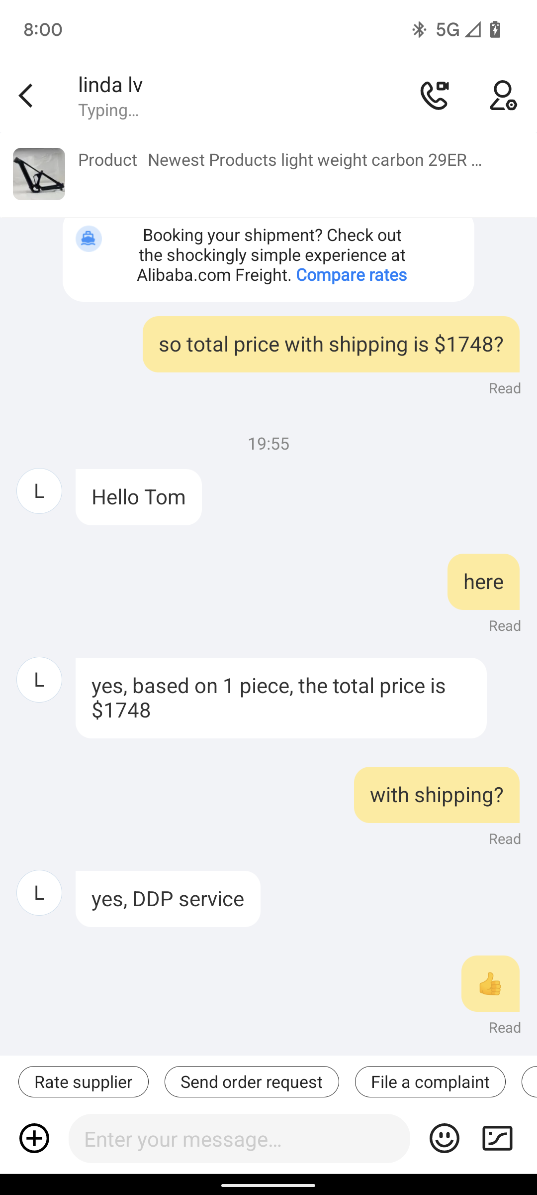

Shoot! But good news. $1748 includes shipping to me in US.

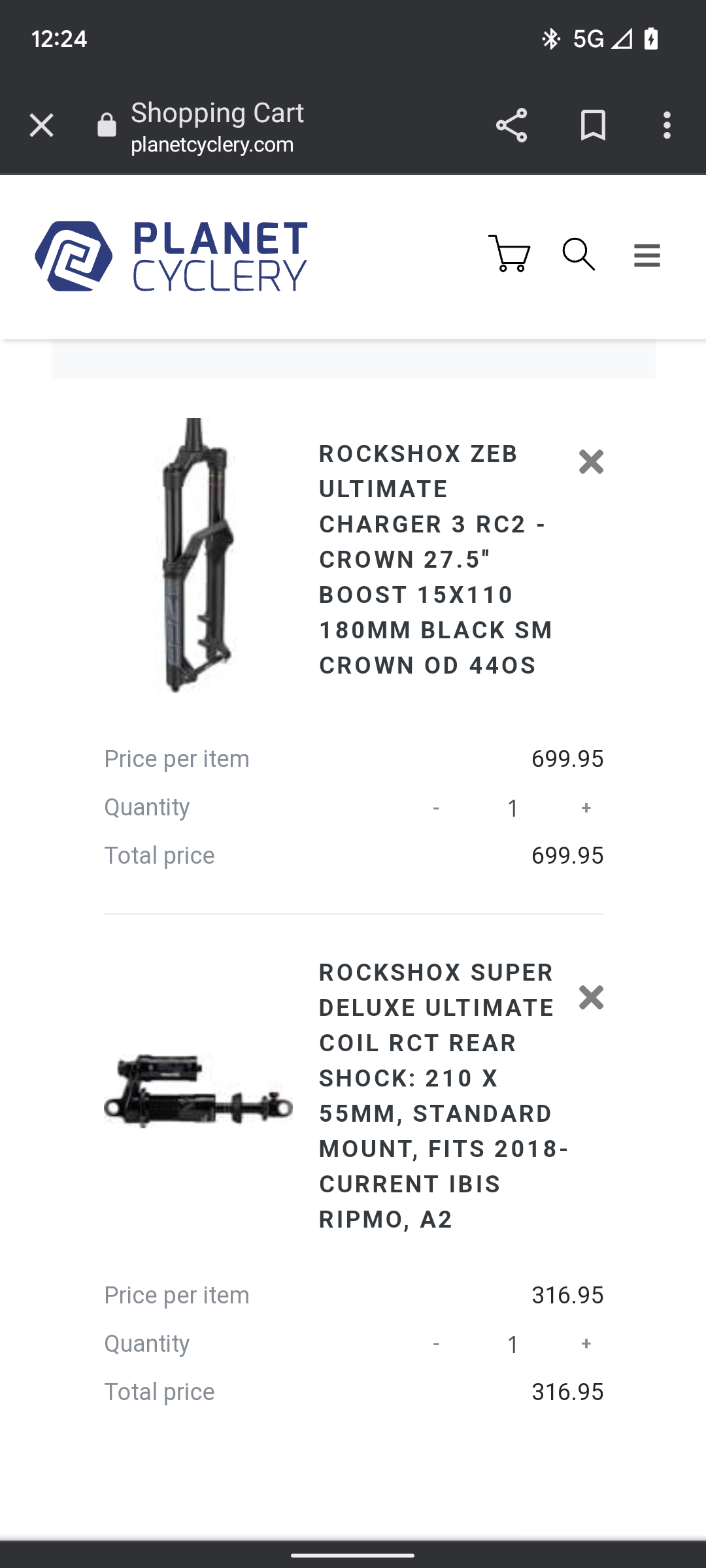

Gonna try to overstroke it a bit 160r coil (🤞)/180f Zeb.

I bought a Large. Total price plus shipping was $1748 USD to my US address. 💪
good price. You have bought them with shipping included, which gave me the price of the bike only, not including shipping. We will wait for news how the bike looks in person and if it really comes pre-assembled that would be fantastic
