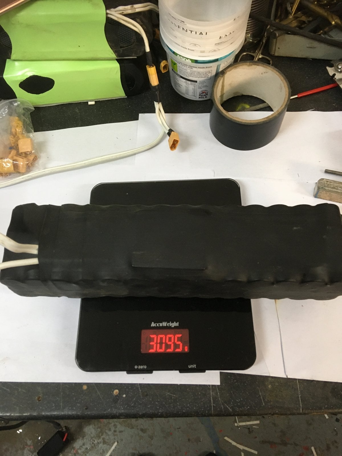

Note the weight of this 21700 800Wh battery. Sorry but the 18650 batteries still have the best density and power to weight ratio, the 21700 series have a larger radius and thus leave greater gaps between the cells.

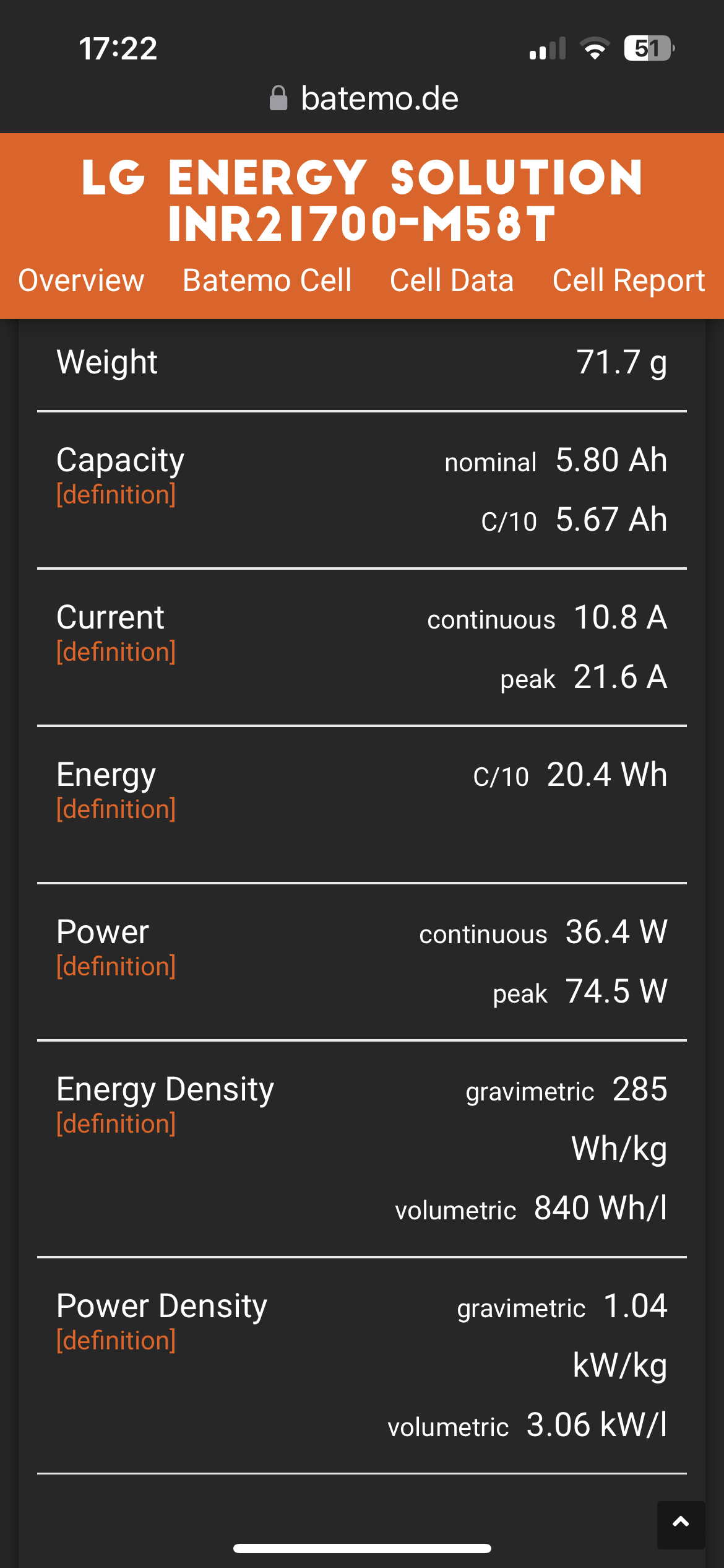

Hmmm…the 21700 cells are slightly better at 71 mAh/g then the 18650 at 70 mAh/g. Almost no difference. The 18650 are still a very good choice, robust, technically mature, cheap, available. Depending on the room/volume available and the battery configuration You need it could be the best option.
Looking at the Dengfu 840 Wh battery using 13S5P configuration 18650 cells, and a weight of 4 kg, this is a great powerpack.
I recently saw the specs of a LG 21700 cell with 5800 mAh. If this is correct, and the C-rating is matching Ebike requirements, this would definitely change the game.

The advantage of the common 21700 / 5000 mA vs the 18650 / 3500 mA is minimal from the energy density point of view: 255 Wh/kg vs 253 Wh/kg. This is almost nothing. Therefore, to use one ore the other cell format, is more driven by space and required battery configuration, imho..

Exactly. With today’s available 21700 cells there is almost no advantage above the today’s 18650 cell (the video shows 257 Wh/kg vs 252 Wh/kg). The future cell they state 302 Wh/kg. Thats a big improvement, but not for today, unfortunately.

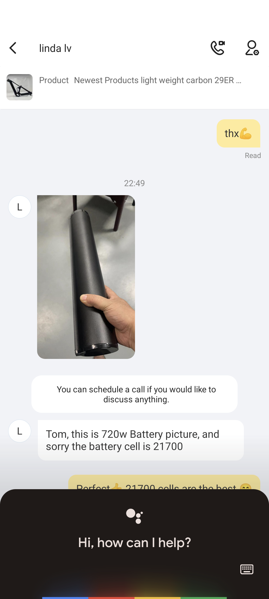

Totally agree. We‘ve somehow lost track on the thread purpose, the M820. My bad. For me, I‘m thinking about getting this CEF50 frame with the 740 (720?) Wh battery, targeting +-20 kg for the complete bike. Expecting to be able to keep up with any full fat ebike, speed and range. But a more playful bike, like the best compromise out of both worlds. I‘m only struggling with the missing option to remove/change the battery. Today, for the epic full day rides with my buddies, we all have a 2nd battery with us or in the car. At least a range extender option would be great in my opinion.

The motor-drop removable (for frame integrated) 720Wh battery is the only reason I was willing to try the M820 on the CEF50. Bottom-line, I'm a heavier rider that consumes battery.
