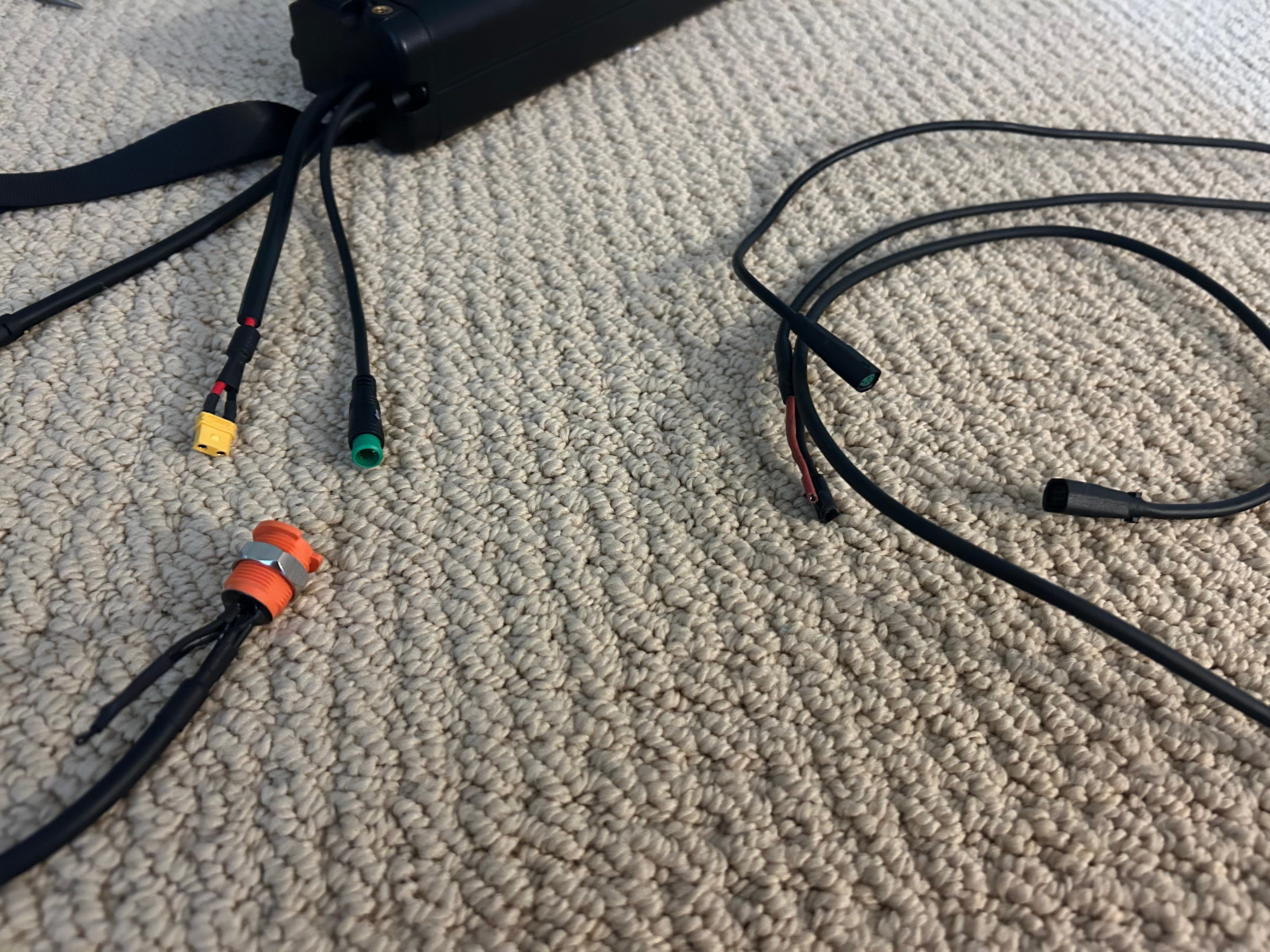

Picture of battery wires on left and incorrect wire on right.
So now I saw already 4 different types of connectors for battery CAN. Thats crazy.
I doubt you would find easily main cable with green round connector to battery.
You can try to build it DYI. I just did one recently to one customer as he wanted to have throttle support. That was 3pin triangle though. Anyway, you can run it also from speed sensor connector.
And motor works also without Battery CAN connector.

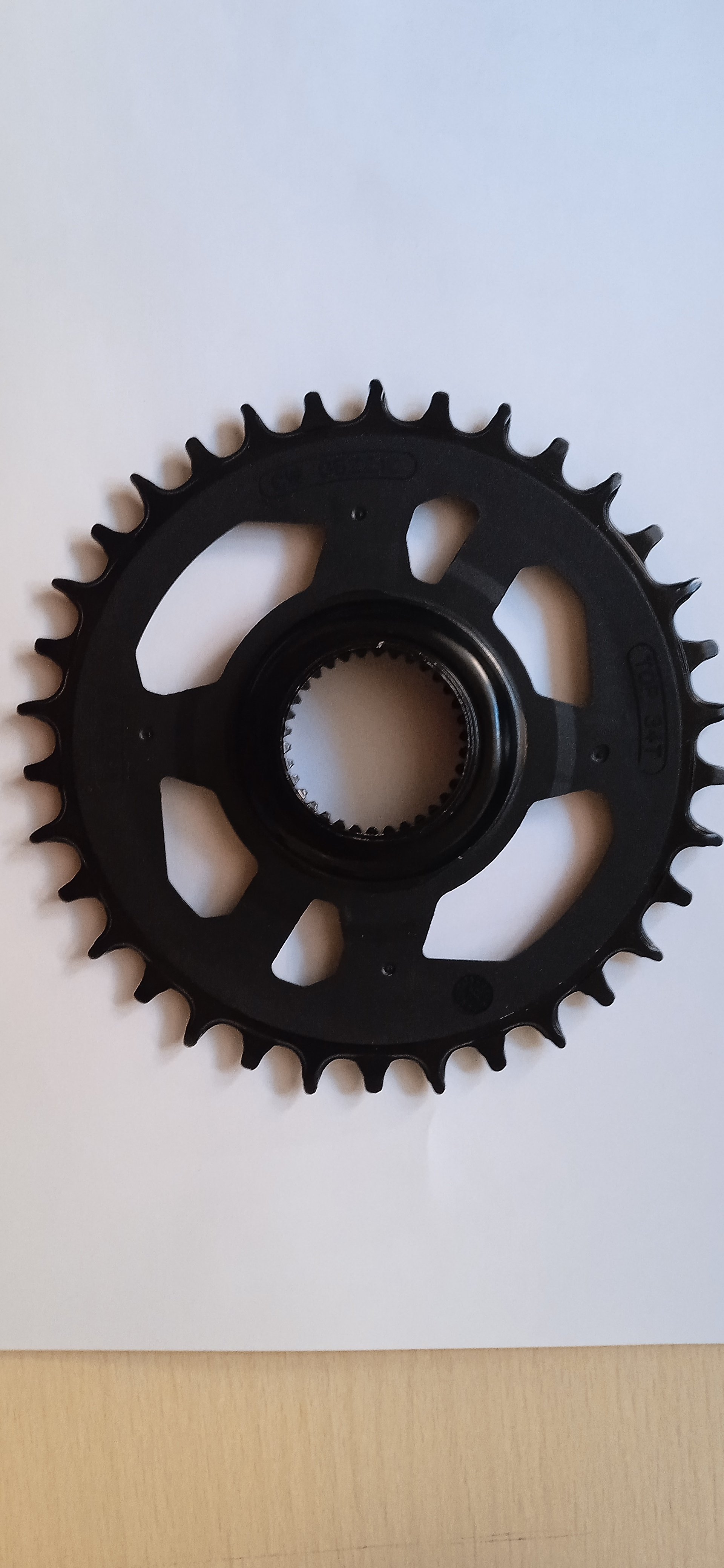

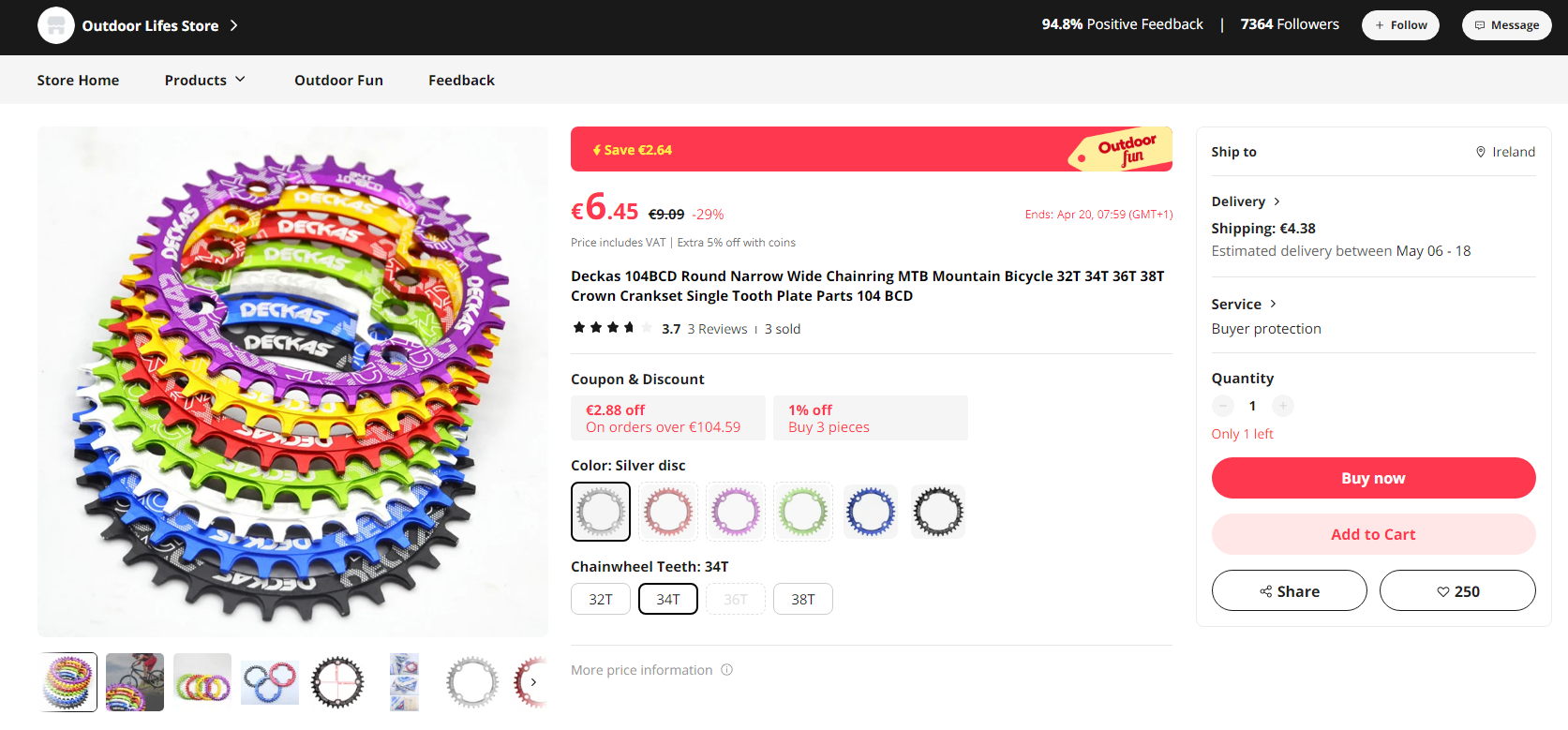

Hello.
What I'm looking for is a 32T chainring since the one the motor comes with is 34T and I find it too big for me. Currently on my mtb I go with a 32T chainring and it seems to me that it will be very big.
I would like to buy a 32T one
greetings
Hello.
greetings
Ok. clear. Your motor is not provided with spider (first time i see that ?). You can find a lot in ali (same than M510). But, as i haven"t purchased i can't recomand one in particular, i'm not sure that all keep the same width for chain line. ask to dealers if they have original width. Or ask to your motor supplier, the original bafang spider.

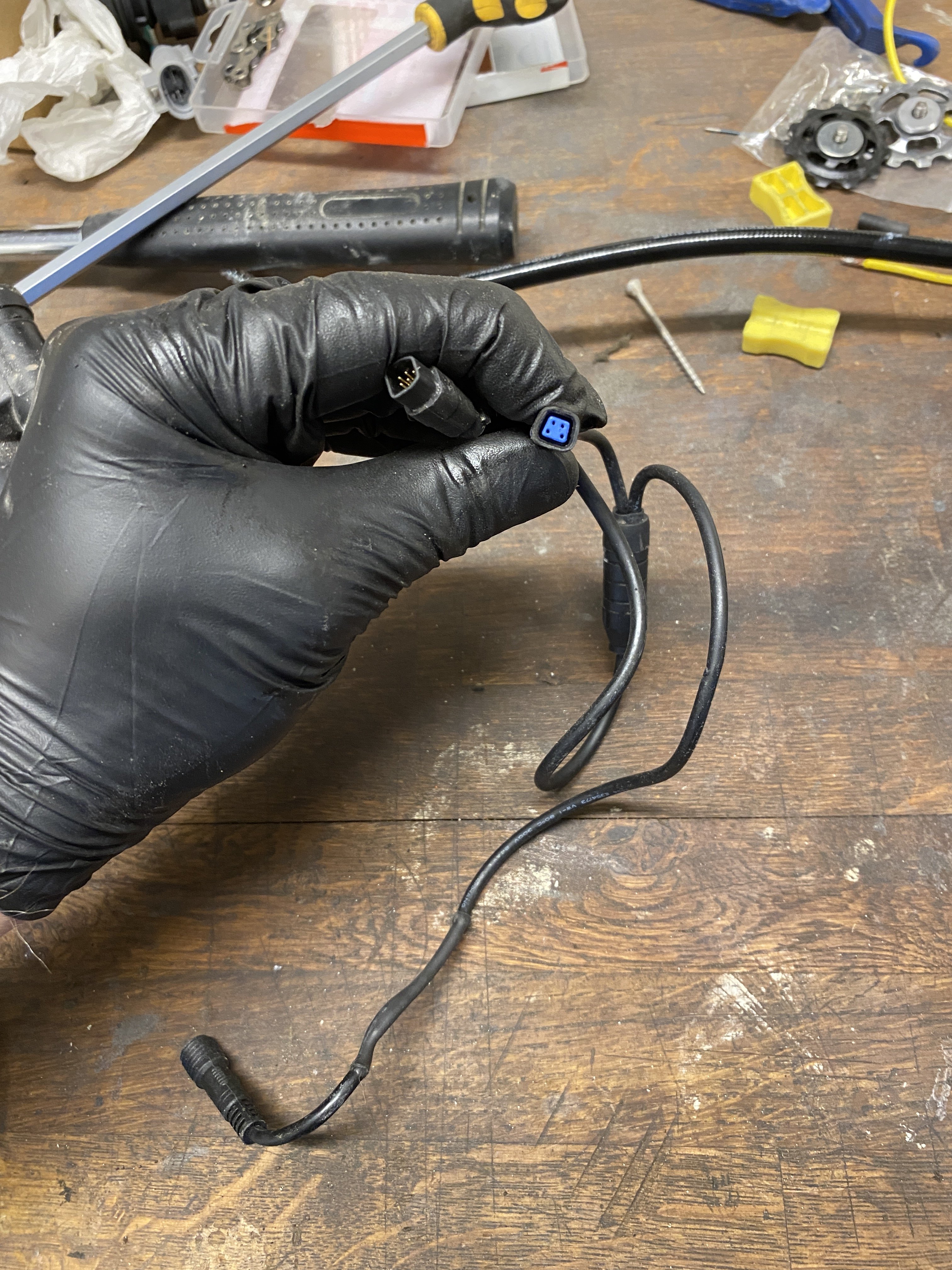

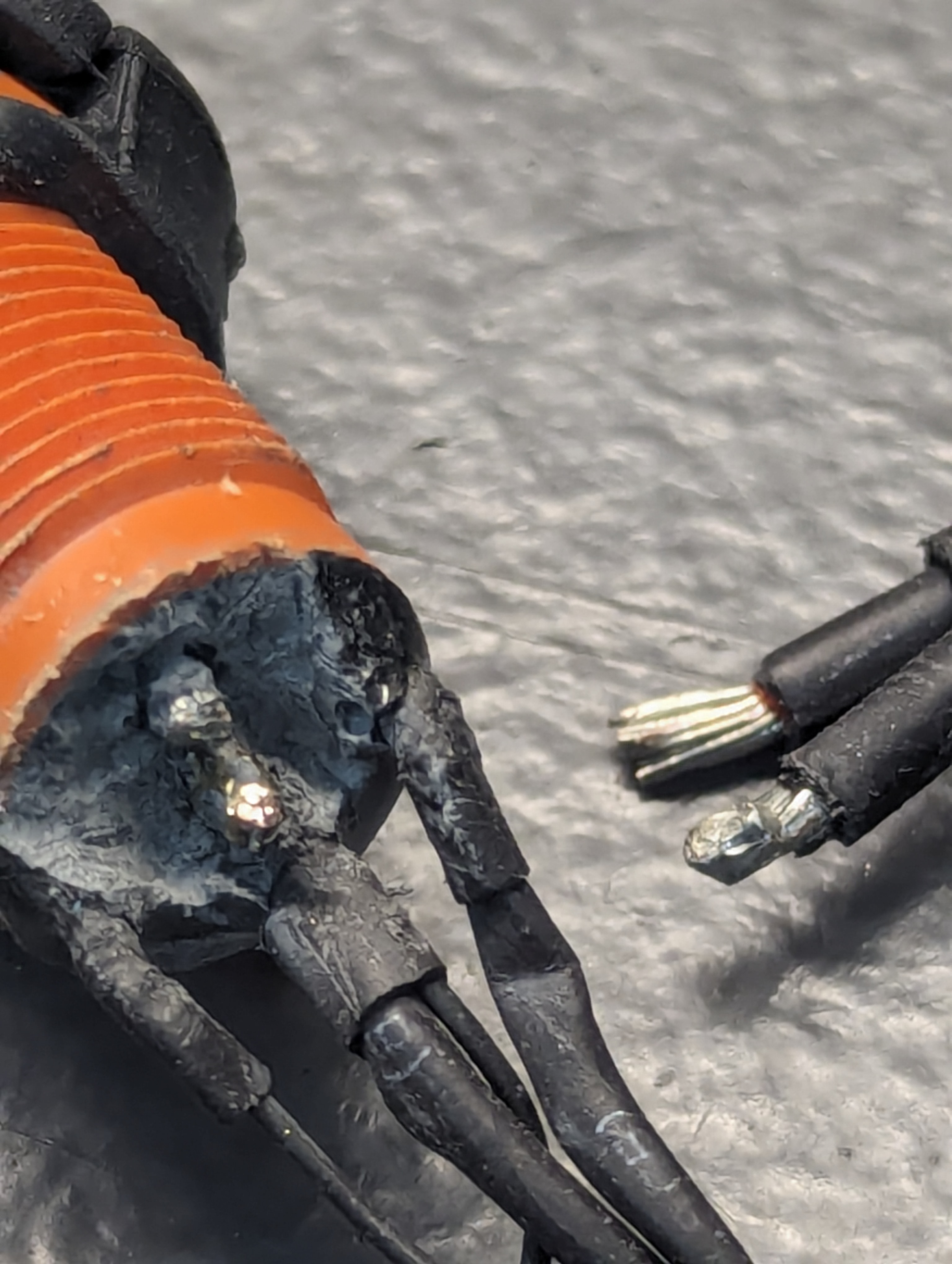

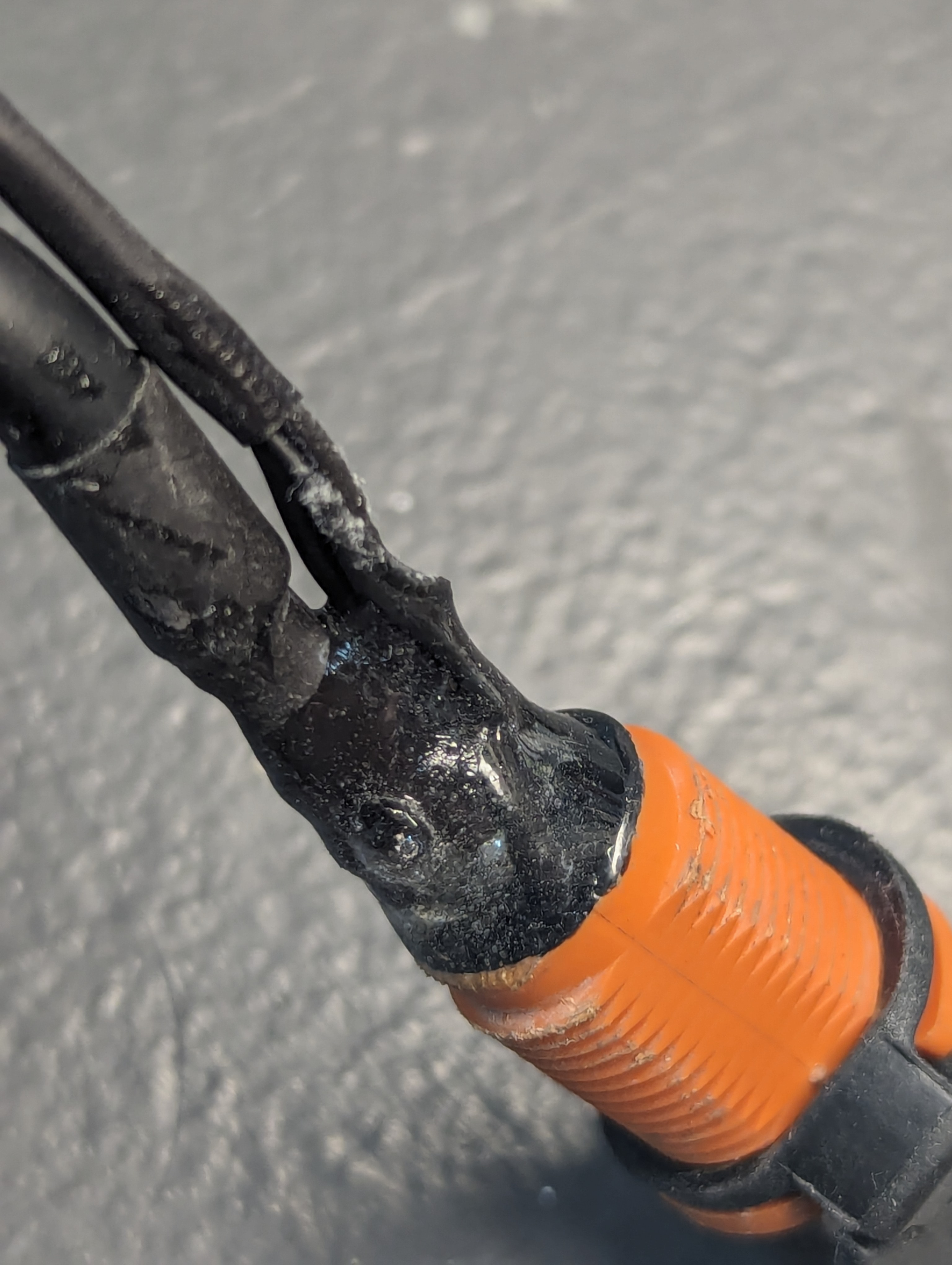

Does anyone know the part name of the cable from motor(8-pin) to lights and speed sensor(4-pin). I have managed to bend and then brake one of the pins and now I get speed sensor error E21.
If you know a supplier I would be even more happy!
