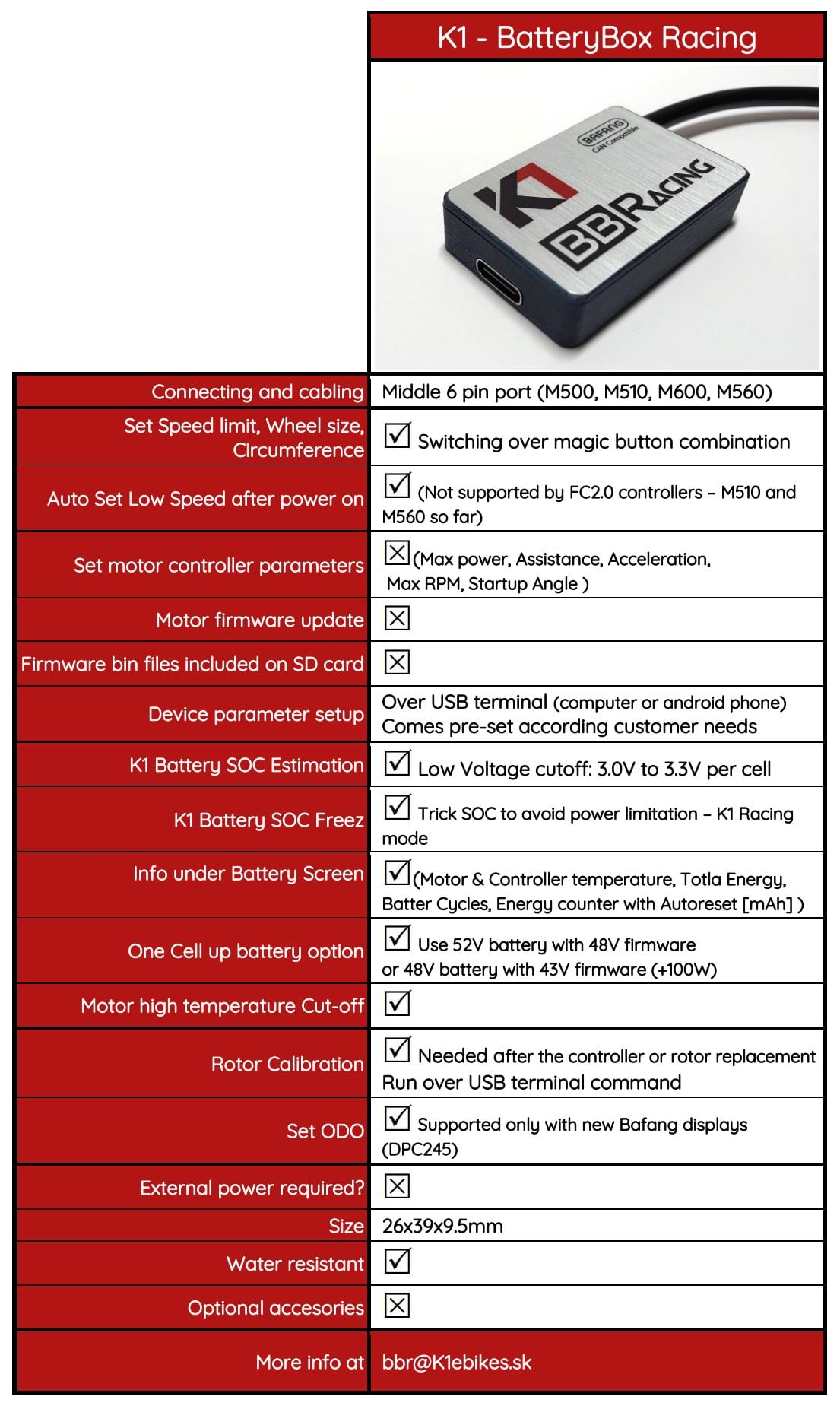

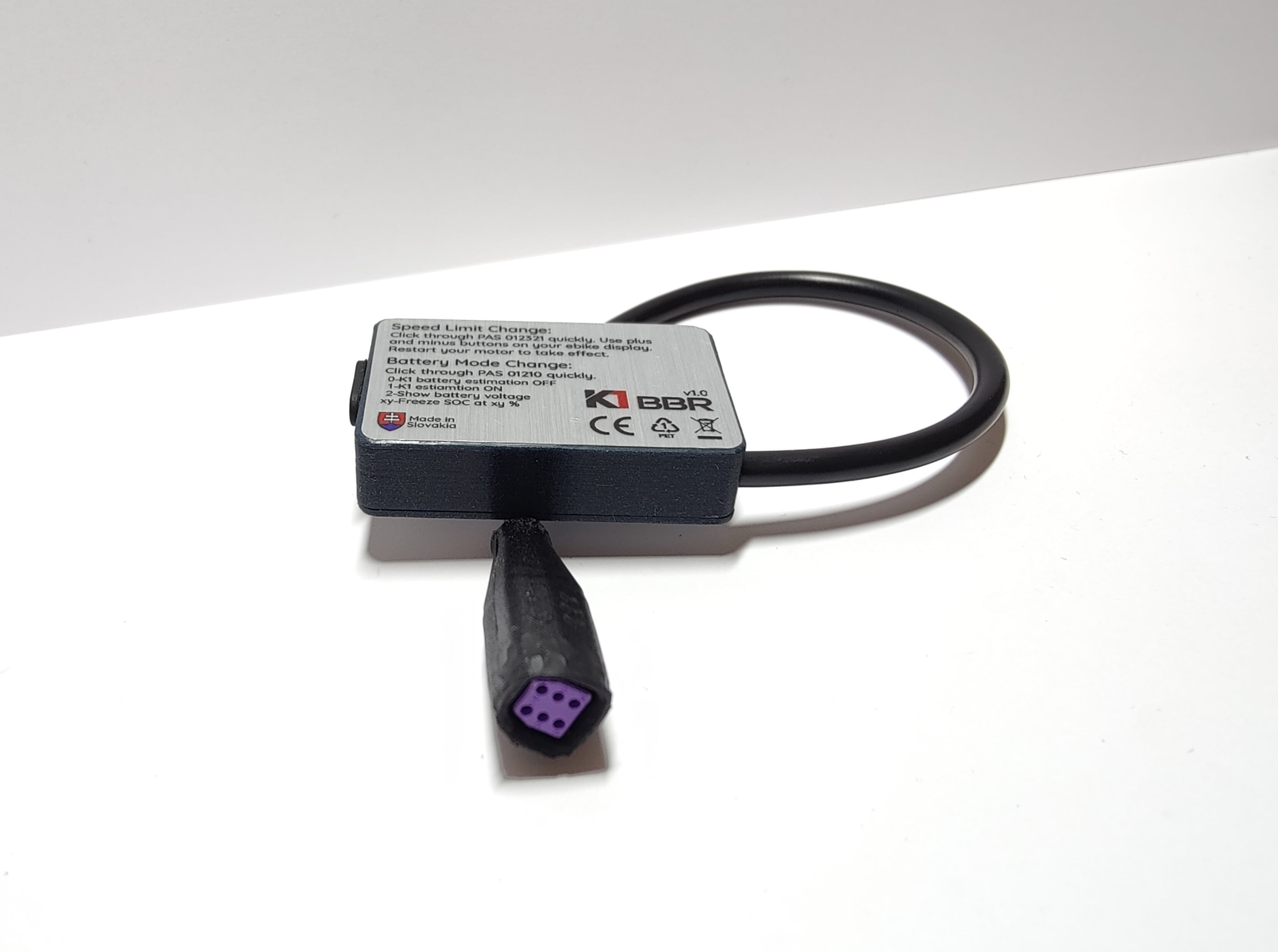

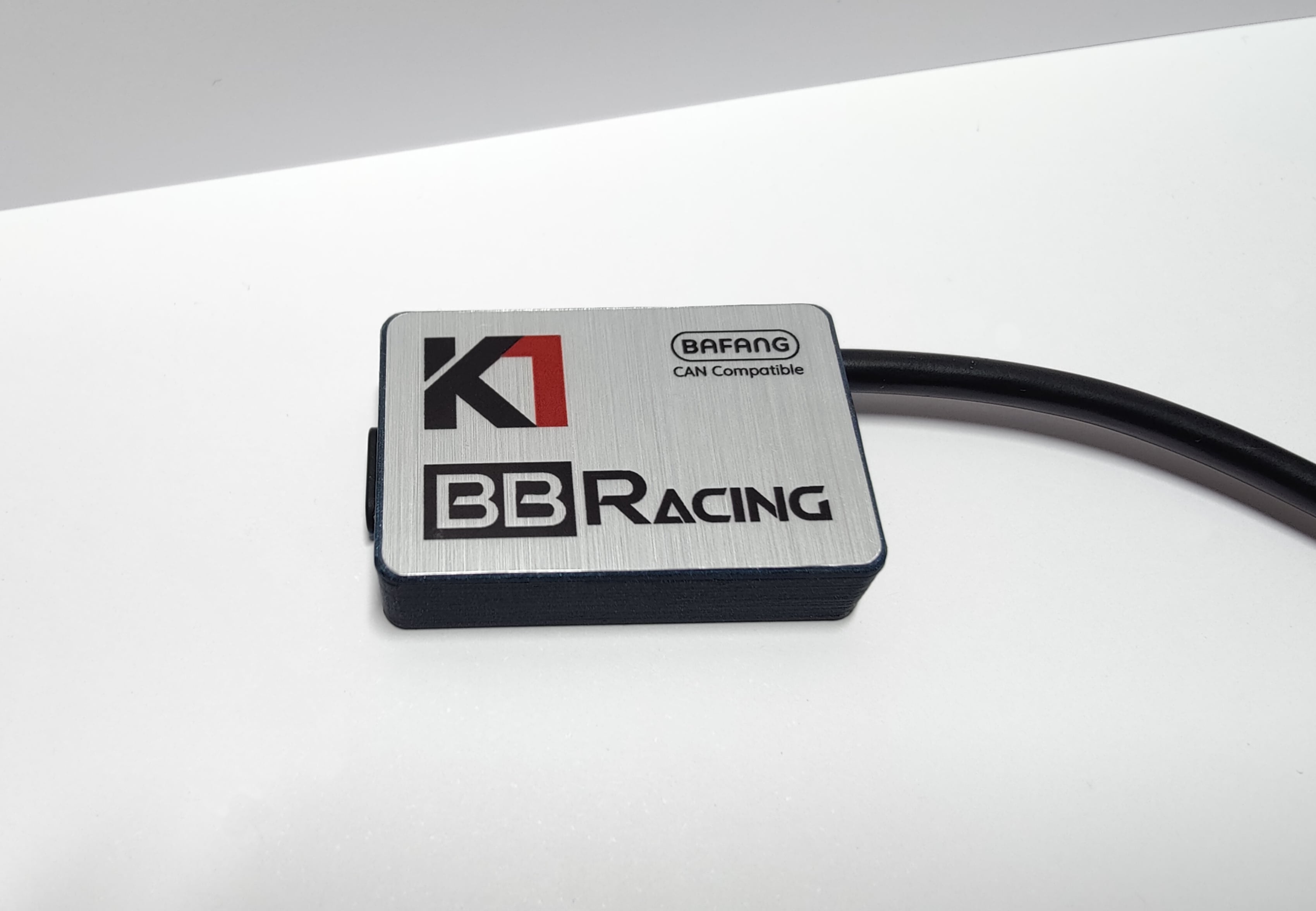

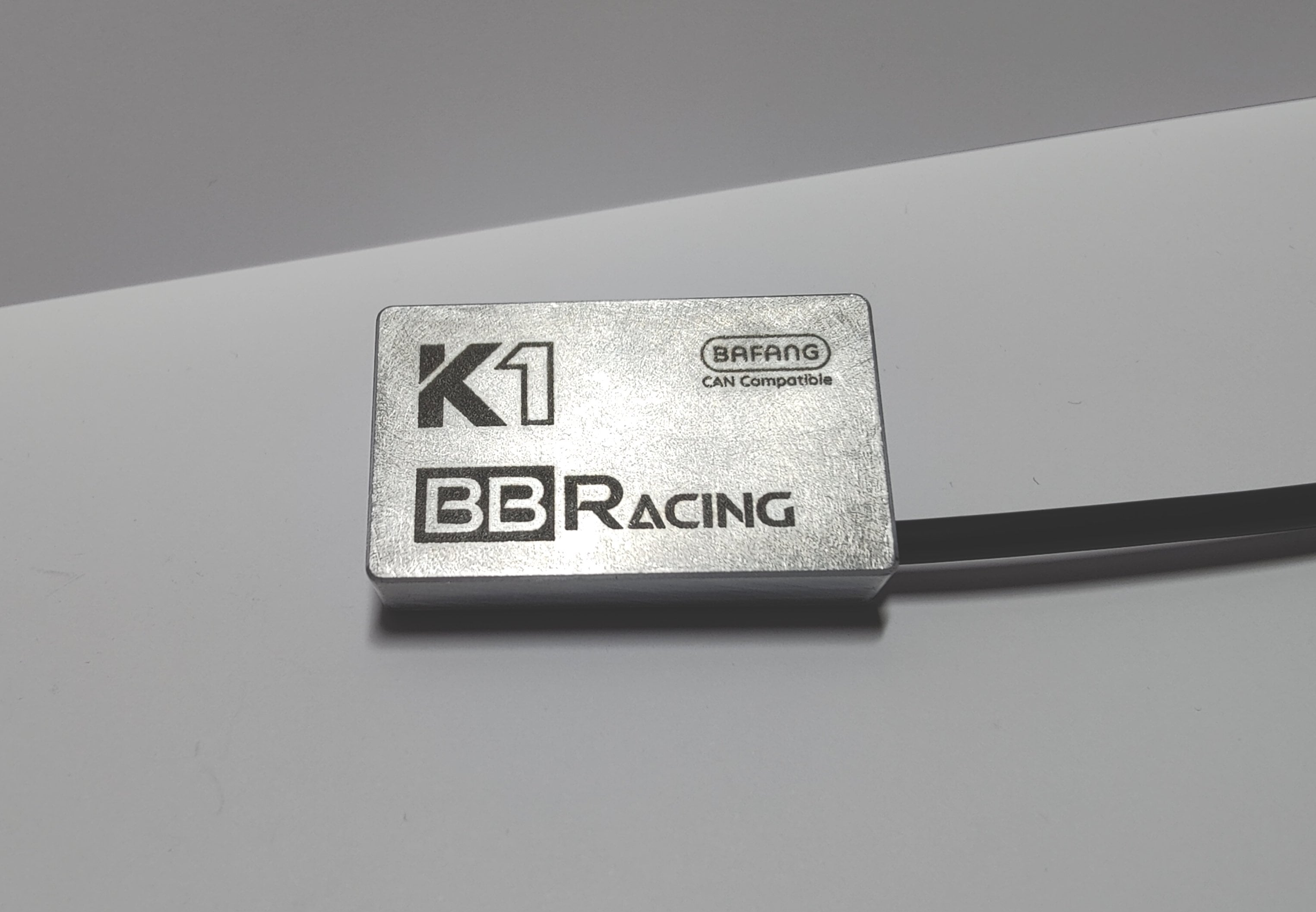

And soon will be available to use one-up cell battery with new K1 BBR device. (so 43V firmware and 48V battery or 48V and 52V battery)
With good SOC reading and even lower discharge capability - down to 3V per cell.
Has the K1 BBR already been manufactured?
Hello Lanton
Almost done. ;) In a code just a small changes to do. Now little problem with testing - cold.
But if somebody wants to become a beta tester, will give a discount. BBR Spec.JPG BBR 01.jpg BBR 03 - connector.jpg BBR Al.jpg
Hello Lanton.
Good question. Once I pour it with silicon, then not possible to bring microcomputer to bootloader mode and simple copy UF2 file over USB. :( Usually it is double click on reset.
But there must be a way how to re-flash UF2 only over USB. Will find out, did not try it yet. Will be some simple utility application I guess.
K1 Flash is not waterproof so there is a reset hole on the case.

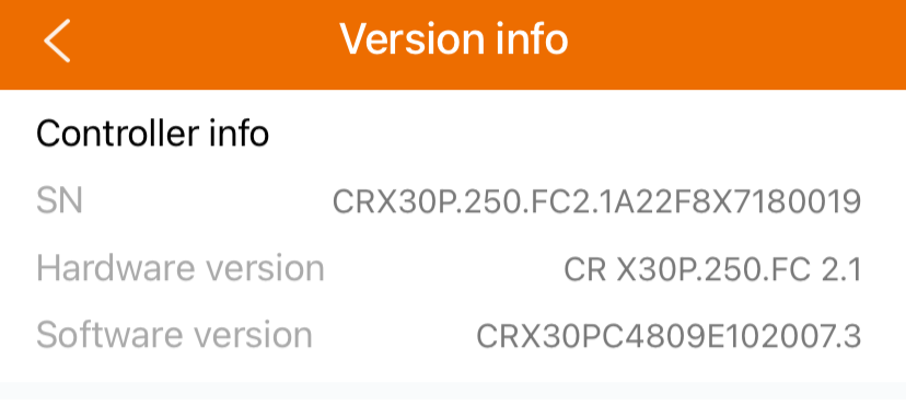

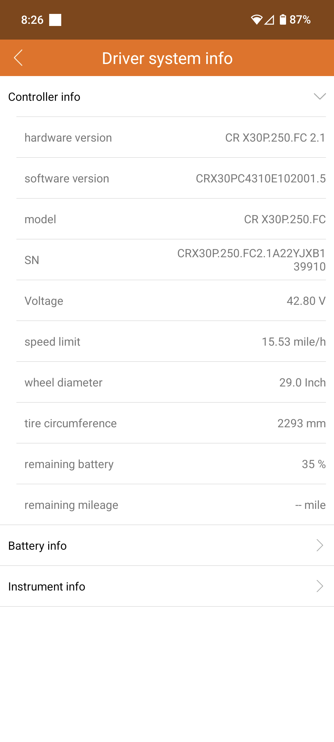

What firmware are you running? I have this one:
Probably doesn't matter, just to check if we have same. GO+ telling me this is the latest..
Me too, it's +- 10° outside. anyway the motor is not hot when i touch it. I hope that linda will can find helpful competent contact in the bafang company (hard job, i know).
And everything is relative of course, we have had -30 degrees for the last week in Finland! 😁 But coldest have been around -16 when I have been riding.
Yes, the same: CRX30PC4809E102007 3_eMTB_230721, i have also tested with CRX30PC4812E102006.3_eRoad_230721. I have not seen differency between the 2. It's not possible that the motor is too hot, it consume 1/2 less than the M510 to more ore less the same performance

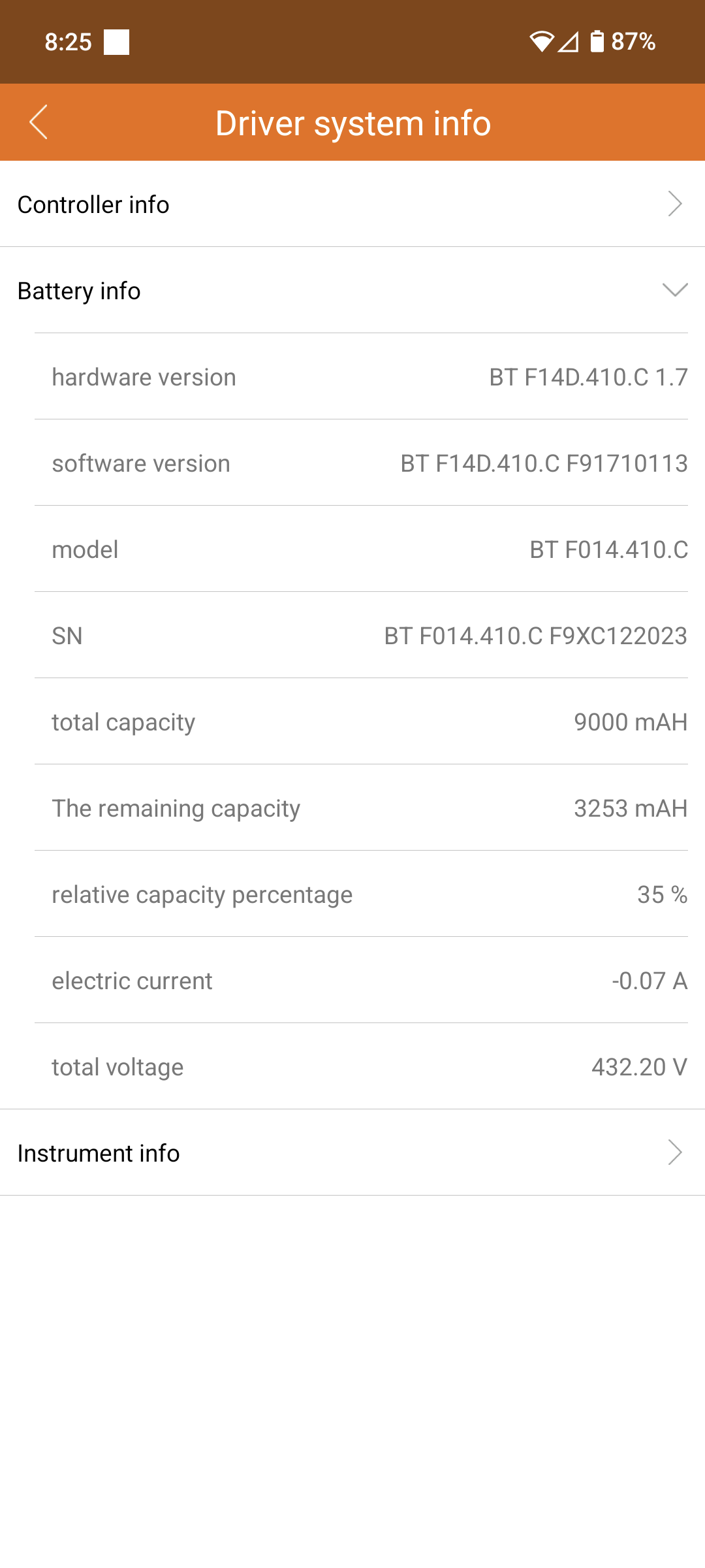

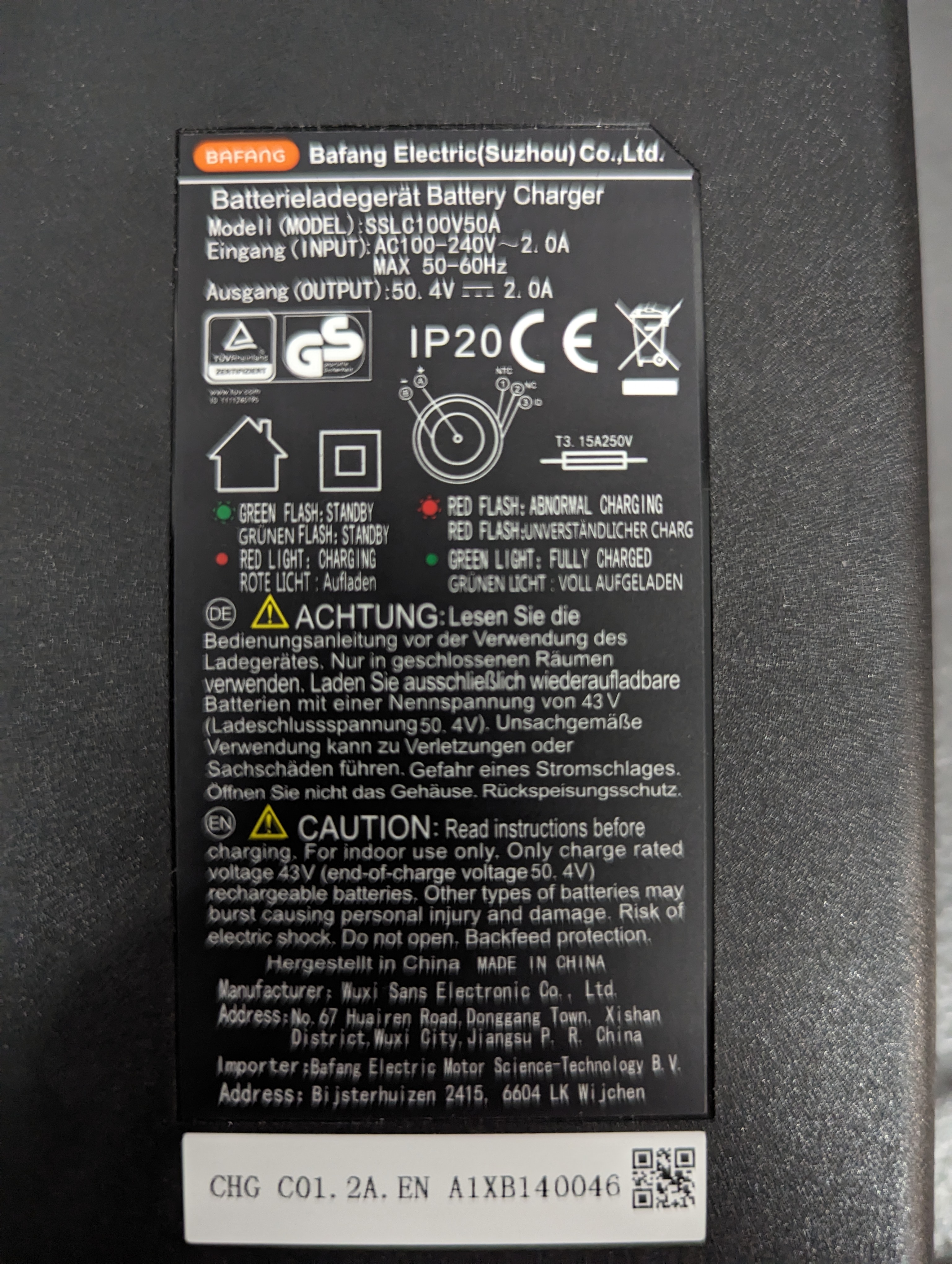

I am just finishing the build on my LCE930 with the 43v 410wh battery and I am having a charging issue. The charger flashes green as it should when it's not plugged into the charging port but when I plug it in it goes solid indicating the battery is full when it is only showing 31%.
Any advice would be greatly appreciated.
The charging plug is shitty, try to turn it or adjust it. I have the same issue almost at each charge
Thanks for replying. The pinout in the manual you sent appears to be the same pinout on the charger feildbikes sent, they are both bafang.
Mine
The manual
I had replaced bafang charging port with standard one. Had a cold solder joint in my plug causing charging issues. There can be one of 3 issues.
1. ID resistor 4.7kR not connected-charger will not provide power.
2. THERMISTOR issue - charger will not provide power.
3. Main cable issue - charger will provide power for 2s and it will cut off due to no current consumption.
I had the issue no3.
Interesting, that Bafang used extra pins on charger and used thermistor and ID pin - just complicating things. Would expect rather CAN bus.
According to the manual that part number is a canbus battery. There are enough pins extra to be canbus signals, maybe the labels are arbitrary. It is the right part number for the correct charger. The behavior would be indicative of the canbus sensing full when it is not.
Yes, is a CAN bus battery, but looks like there is no CAN L/H at charging connector. Can connector is separate.
Thank you all for sharing your knowledge! The canbus connector for the battery comes off of the motor/controller. I wish I would have tested the charger before I mounted the motor covers, cranks, etc.. Oh well, looks like I'll be dropping the motor and checking the connections and charging connector.
