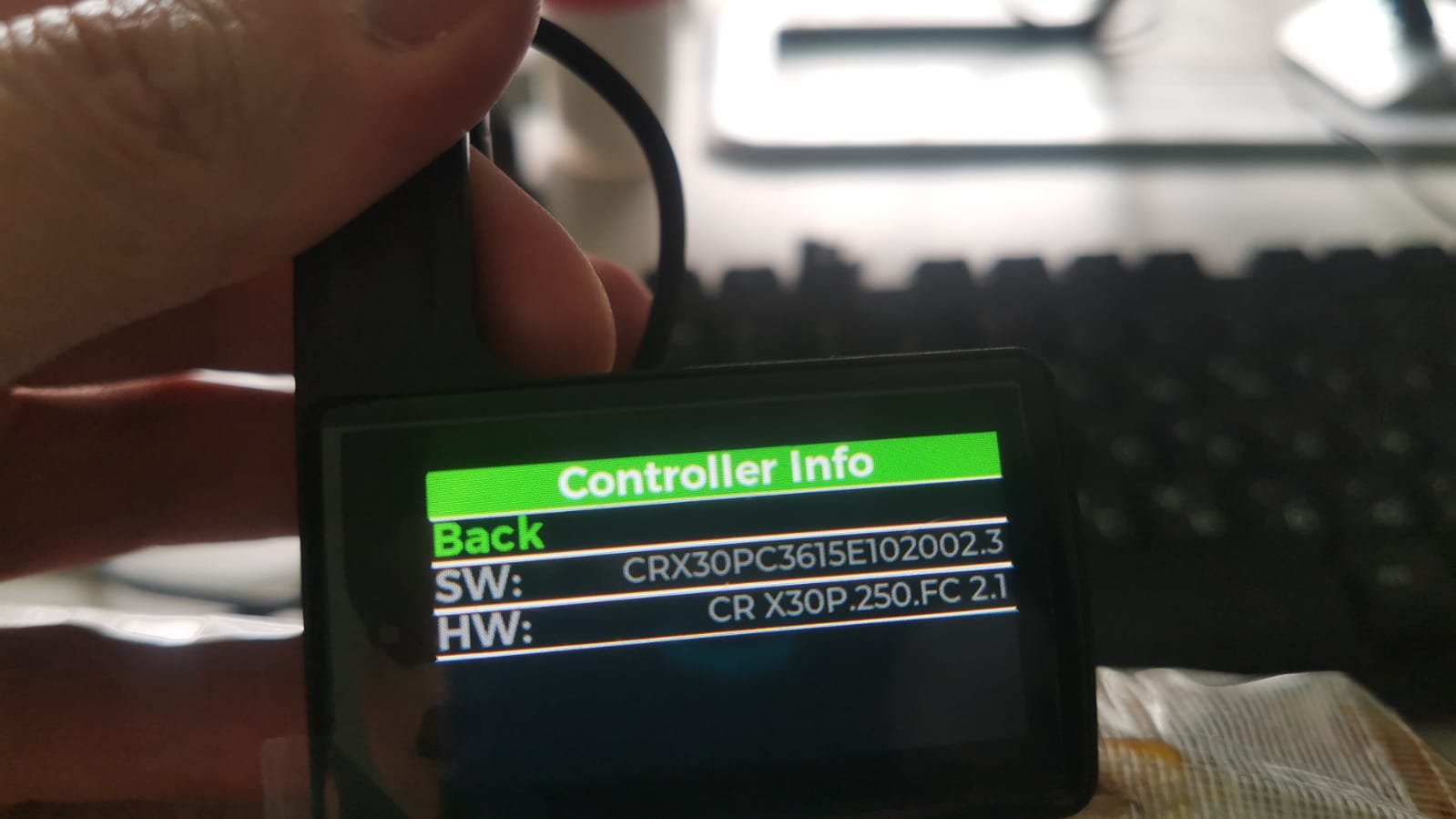

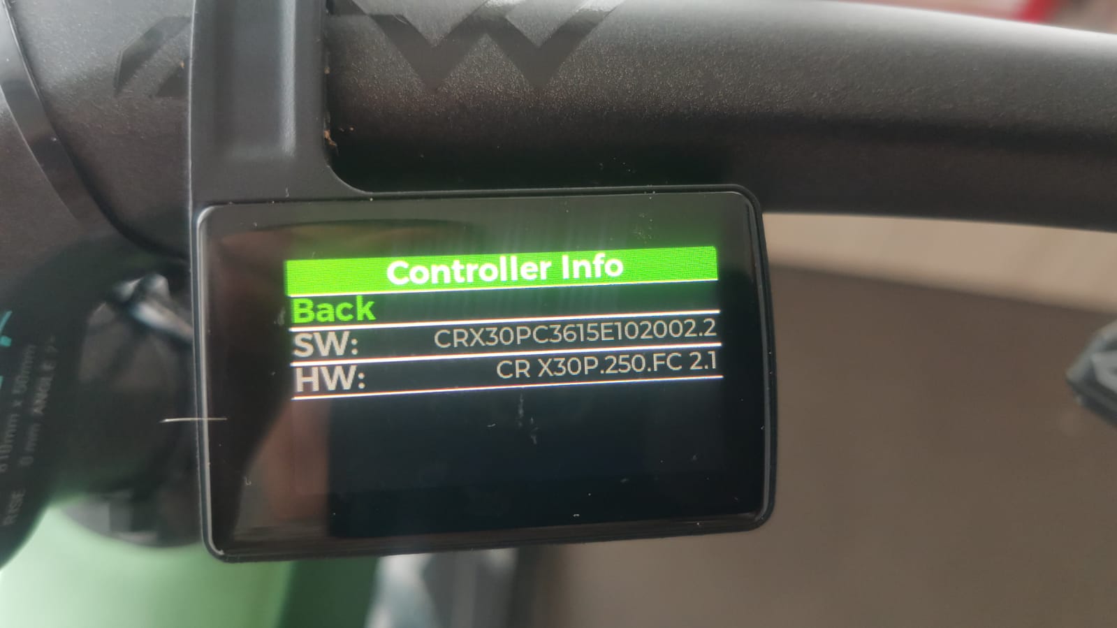

The second motor has a different firmware. What has changed?

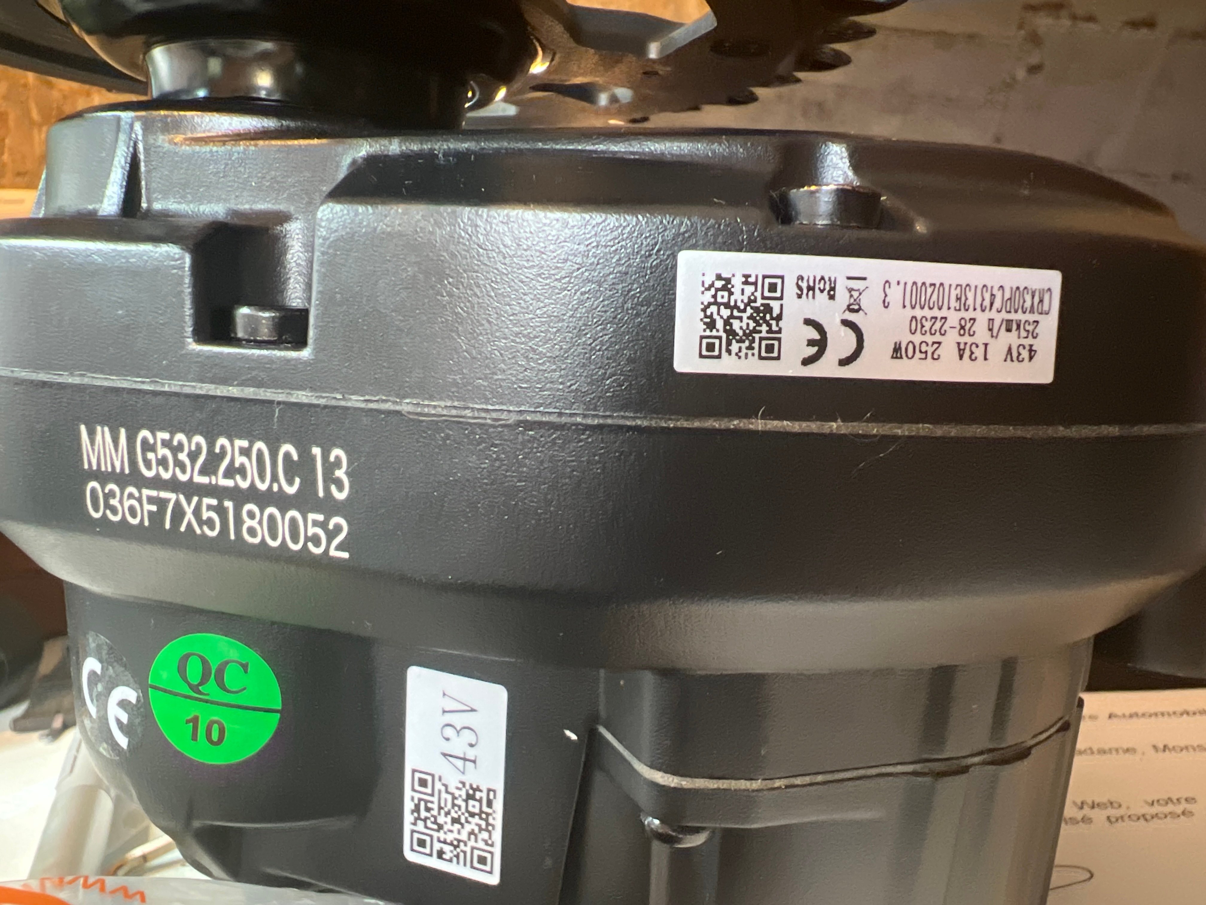

If I build 43v m820 version, what type of charger I can use for 43v battery? 50.4v charger?

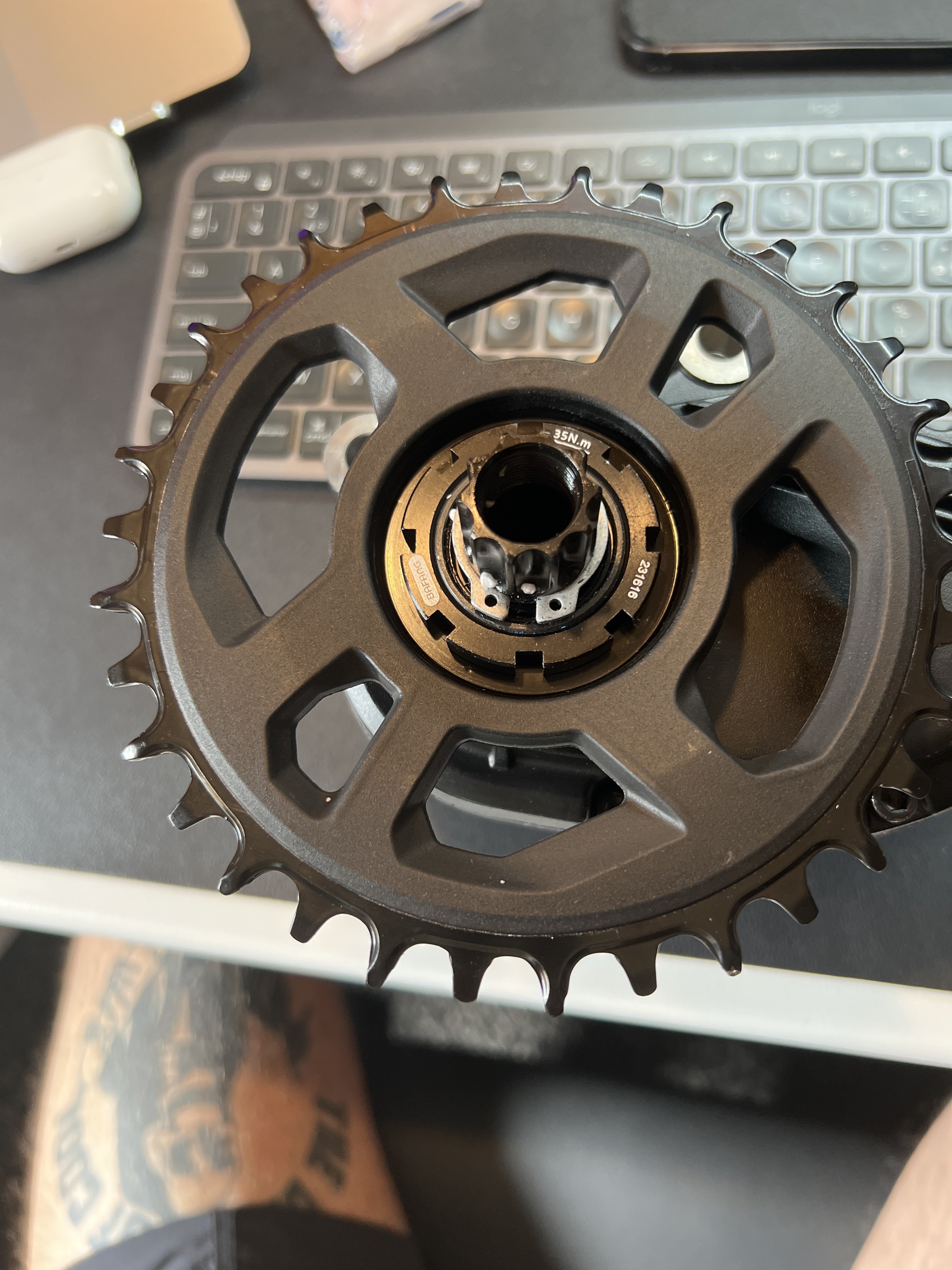

Guys, 1am I the only one with the direct mount and not the chainring spider?
Seems like steel teeth. :( Thats unlucky they do not sending spider, where u can mount good alu wide narrow chainring.
How is outer ring mounted to spider? Some screws from the back? Or just pressed?
Please put it on a scale. That spider seems to me quite massive.
