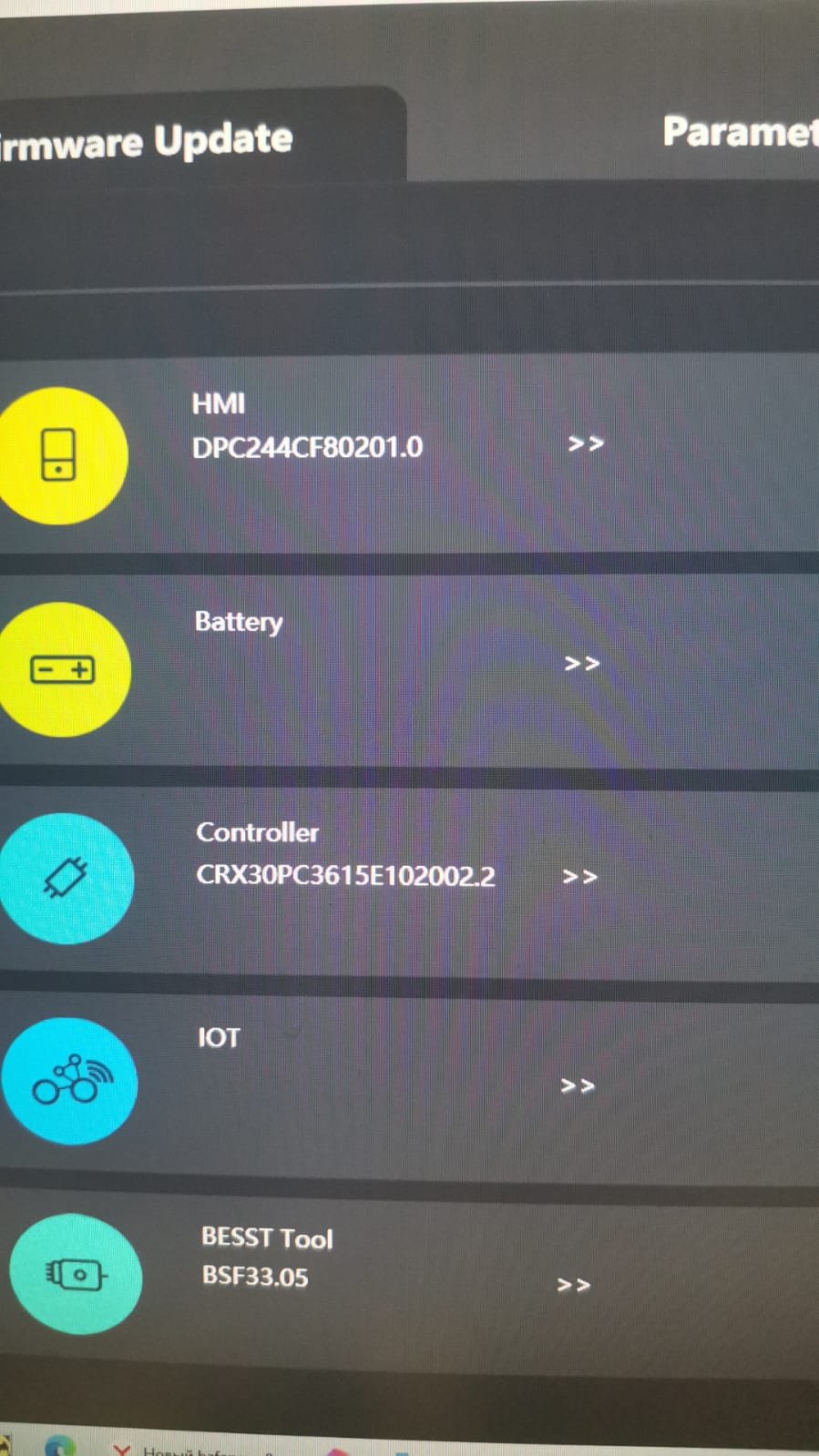

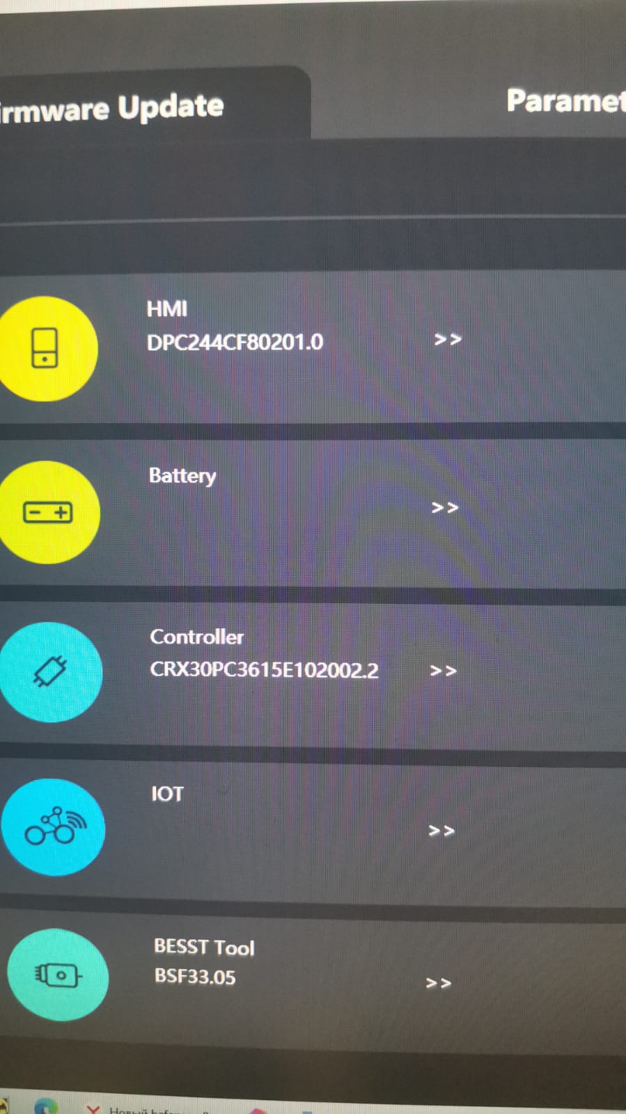

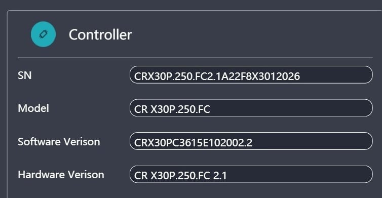

@LAnton or others who already have M820 36v. Do your engine have the same firmware like mine?

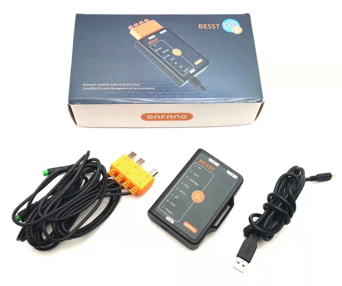

Just to clarify the Besst tool requires a dealer user ID and password, or a bypass script, for any use? Or can you do basic things like changing the assist levels without the login?
Thanks
Thanks
U have to login for changing parameter. U can get username and password from your seller.
If U only need to change speed limit and wheel size just buy $42 cable. But if U wanna change level parameter setting buy Besst tool.
ah, ok. Was hoping it was the cheaper option! Maybe I'll wait and see if the Bafang Go+ gets updated to work with setting M820 parameters before I fork out the money for the full Besst tool

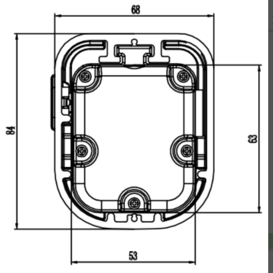

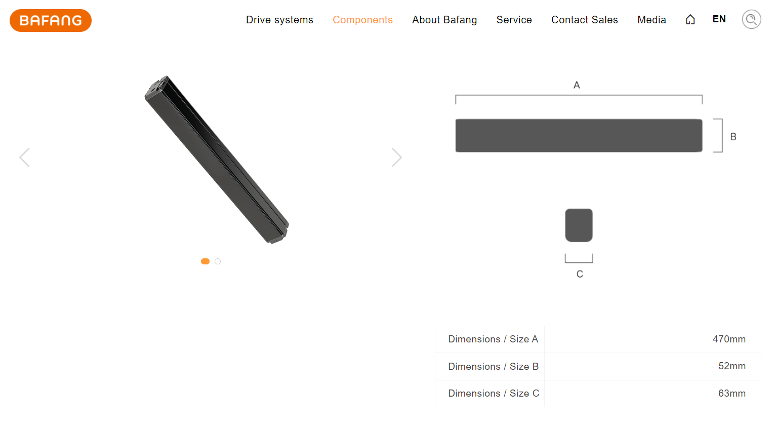

is there any detail dimension for Bafang BT F014 battery? so we build our custom DIY battery that can fit into Lightcarbon frame or Tantan frame.
With 470x52x63 I just calculate if we use 18650 cells we can get 10s4p configuration. If we use 3500mAh cells we can get 518Wh capacity. Any thoughts guys?
Sounds like a good plan. I was planning to use 21700 5000mAh cells, 12s3p. That would give 645Wh theoretical.
