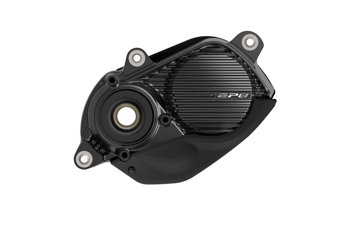

Shimano's EP801 — the firmware-evolved EP8 — remains the lightweight benchmark of the mid-power class: 85 Nm of torque from just 2.65 kg, tuned for riders who like to spin rather than grind.
EP801 eMTB motor
Shimano's DU-EP801 drive unit: 85 Nm from one of the lightest housings in the class, at a measured 2.65 kg.

The verdict
Shimano EP801 is the firmware-evolved DU-EP8: the unit that rewrote the weight column for full-power Shimano e-MTBs at 2.65 kg for 85 Nm, lighter than almost everything else making real torque. The catch was always character. The early EP8 was a high-cadence motor that asked the rider to keep their legs moving and faded if the revs dropped on a steep, low-gear grind.
The EP801 closed most of that gap. The motor is rated at the legal 250 W of continuous power but Shimano claims up to 600 W peak, and on the dyno Velomotion recorded around 562 W at the wheel across the useful 60–110 rpm band — enough, in their words, for it to "play in the same league as Bosch CX & Co." How readily it releases that power now depends on firmware: at launch in 2022 the EP801 hit full assist from a fairly low rider input, and the free Race-Specific Firmware Update of October 2024 lifts maximum support to 400% so roughly 150 W of rider input unlocks everything the motor has — light-legged riders get the lot without standing on the pedals. That 400% figure is the race tune, not the launch baseline.
What hasn't changed is the personality: sporty, lively, efficient on the flat and happiest at a brisk spin. Push past 90 rpm and power tails off sharply — by 110 rpm it has effectively quit — and the descents still bring Shimano's signature coast-clutch rattle. But for its weight it remains one of the most usable, range-friendly trail motors you can buy.
“Featherweight for the torque it makes — just keep your legs spinning and it never runs out of breath.”
