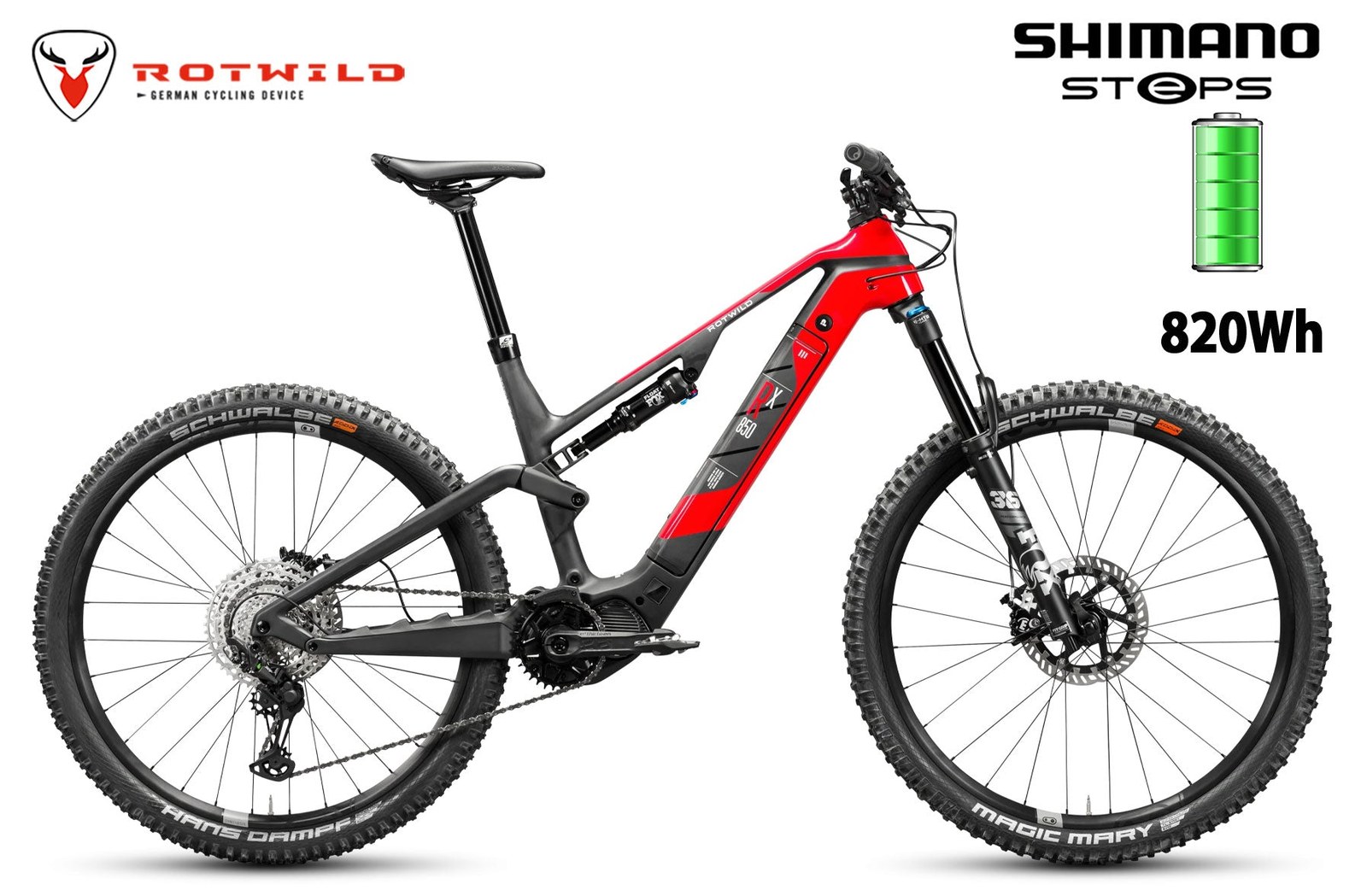

All-mountain eMTB with Shimano EP801 motor and 820Wh battery
The Rotwild R.X850 2026 is the German engineering brand's reworked all-mountain carbon eMTB and the successor to the well-regarded R.X750. It runs the Shimano EP801 motor (85 Nm, 250 W rated, 600 W peak, 2.7 kg) with an in-house 820 Wh integrated battery — the largest in its segment. Travel is a balanced 150 mm front and rear, head angle a notably steep 67.0°, and the bike is offered in four sizes from S to XL. The 67° head angle places the R.X850 in the trail/all-mountain category rather than chasing modern slack enduro geometry — this is a versatile platform designed for varied European singletrack rather than gravity-focused riding. There's no significant community thread on this exact model yet on the forum, but Rotwild's reputation as the in-house brand of ADP Engineering carries genuine technical credibility.
Drive system and range. The Shimano EP801 is the polished evolution of the EP8 motor — 85 Nm torque and 600 W peak with notably quieter operation than its predecessor, Bluetooth diagnostics and full Di2 compatibility. The 820 Wh battery is the headline win here: among the largest packs available in the eMTB market and 10-20% bigger than the 720-800 Wh standard on most rivals. Expect 1,400-1,900 m of climbing per charge in trail conditions, helped by the efficient 150 mm rear kinematics. The E-Tube Project app provides ride mode customisation, firmware updates and detailed diagnostics. Removable-or-integrated battery design is to be confirmed at dealer level — earlier Rotwild platforms used removable packs but the IPU850 family on the R.E850 sibling is integrated.
Geometry and handling. The 67.0° head angle is notably steeper than most modern trail eMTBs (typical figures are 64-65.5°) and signals Rotwild's intent: this is a fast, agile all-mountain platform rather than a gravity tool. Reach progresses S 430 mm, M 450 mm, L 475 mm, XL 500 mm — modern numbers with sensible 20-25 mm jumps between sizes. Chainstay length is fixed at 450 mm across the range. Wheelbase grows from 1,200 mm on the S to 1,282 mm on the XL. The steeper head angle suits seated climbing and tight technical singletrack, but riders coming from a modern 64° trail bike will need adjustment time. 29in wheels front and rear is the standard configuration.
Build and value. Rotwild typically offers the R.X850 across two or three trim variants in the German domestic market, with components scaling from Shimano XT/Deore 12-speed and four-piston brakes on entry trims through to Fox Factory Kashima suspension and SRAM Eagle Transmission AXS on the top spec. The 820 Wh battery represents a clear value differentiator at any trim level — that's substantially more energy than equivalent Trek Fuel+, Specialized Levo SL or Mondraker Chaser builds. Rotwild's German engineering pedigree is evident in cable management, motor integration and frame protection details.
Caveats and known gripes. The 67° head angle is the most significant compromise: in 2026 this is a conservative figure for a 150 mm-travel all-mountain bike, which makes the R.X850 feel less composed on steep descents than slacker rivals. Riders who push the bike hard on technical terrain may want to slacken the head angle via headset cups. Rotwild's UK and US dealer footprint is thin — the brand is strongest in Germany, Austria and Switzerland, and warranty/service paths outside DACH need confirmation before purchase. The Shimano EP801's 85 Nm is now mid-pack against the latest Bosch CX Gen 5 (120 Nm) and DJI Avinox M2S (150 Nm). Limited community ownership data on this exact platform on the forum means real-world reliability and ride feel feedback is still building. Lack of mullet wheel option may disappoint riders who specifically want size-specific 29/27.5in setups.
Verdict. The R.X850 is for the rider who wants an all-mountain-class travel platform with the biggest battery in the segment, proven Shimano EP801 motor and German engineering polish. It suits European trail riders, especially in DACH countries, who do more pedalling than gravity hammering and want versatile geometry rather than the latest slack figures. It is not for buyers chasing aggressive modern geometry, riders outside continental Europe without dealer access, or anyone who wants maximum torque numbers. Production status is current and the R.X850 ships for the 2026 model year alongside the longer-travel R.E850 sibling.
