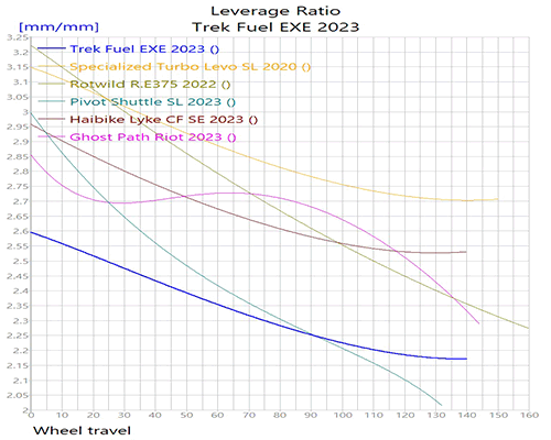

Fuel EXE has 16% progressivity and with an extended stroke, the end stroke is completely linear in the added travel. Leverage ratio at the end of travel is 2.16 so you would add 10.8mm of travel when you extend stroke 5mm. A Cane Creek Valt progressive spring would be a great option for this frame.
Yep I was just speaking in general terms.
Not really sure a coil is a good option though. With a slightly digressive curve like that I feel that even a progressive coil isn't great. The bike feels great throughout the entire stroke for me with an air shock with max tokens in and HBO but I still bottom out hard sometimes. I wouldn't want to run this bike with a coil for that reason. Same reason the Rise feels bad with a coil, even with a progressive spring (for me).
I am not aggressive rider, and sometimes bottom out with linear Ohlins spring, but the way how bike behaves is day and night to the air spring. I will try cane creek or mrp progressive spring. It is purely personal thing but I am 100% convinced I prefer no air in rear shock.
In the end, that's all that matters. If it's better for you then that's what you should run. I just added my own thoughts to the mix.
Also I guess the curse isn't digressive but just hanging, leaning more and more towards linier at the end.

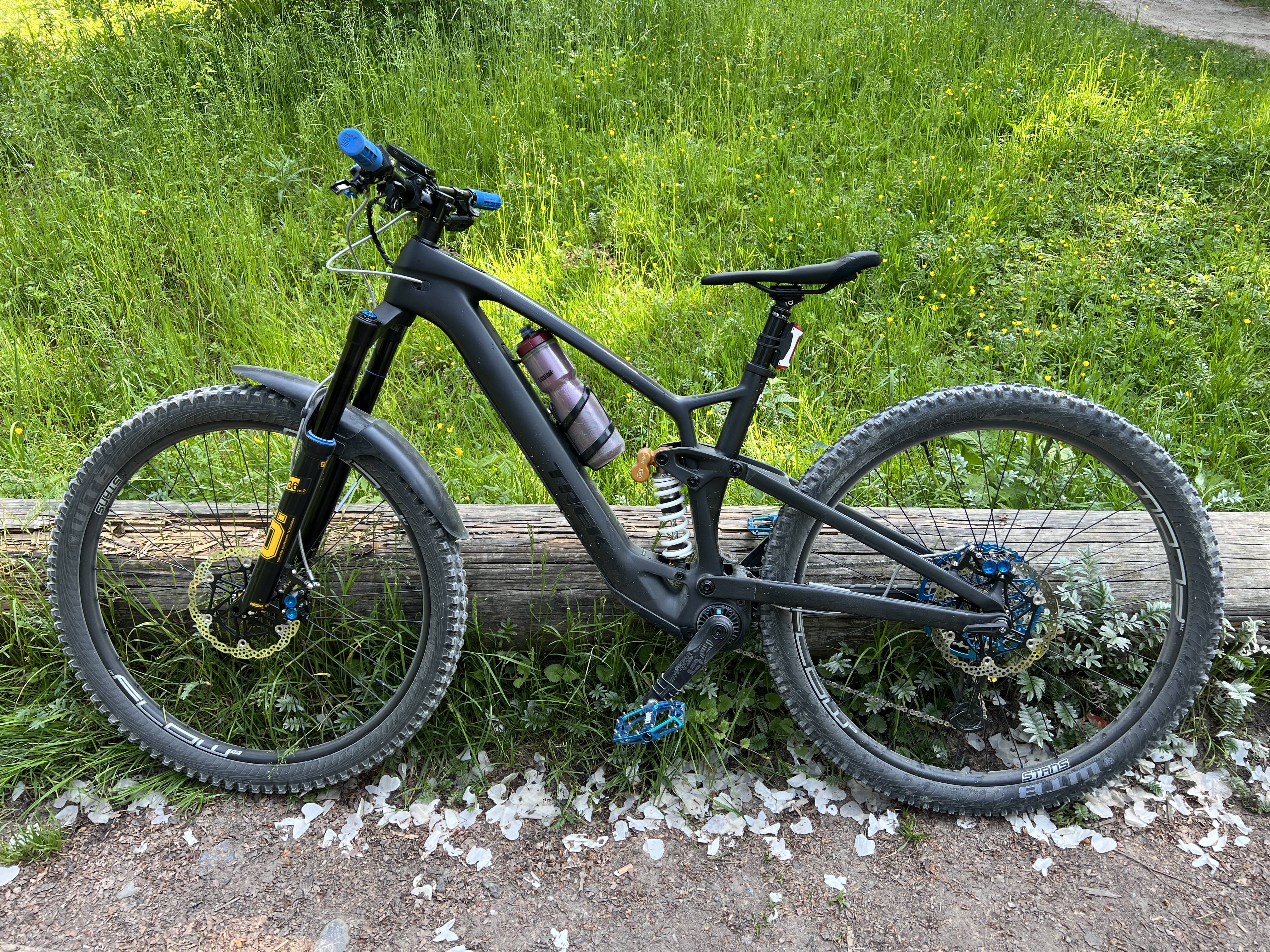

Changed spring to progressive 400-488 from CaneCreek. Best combination I can imagine.

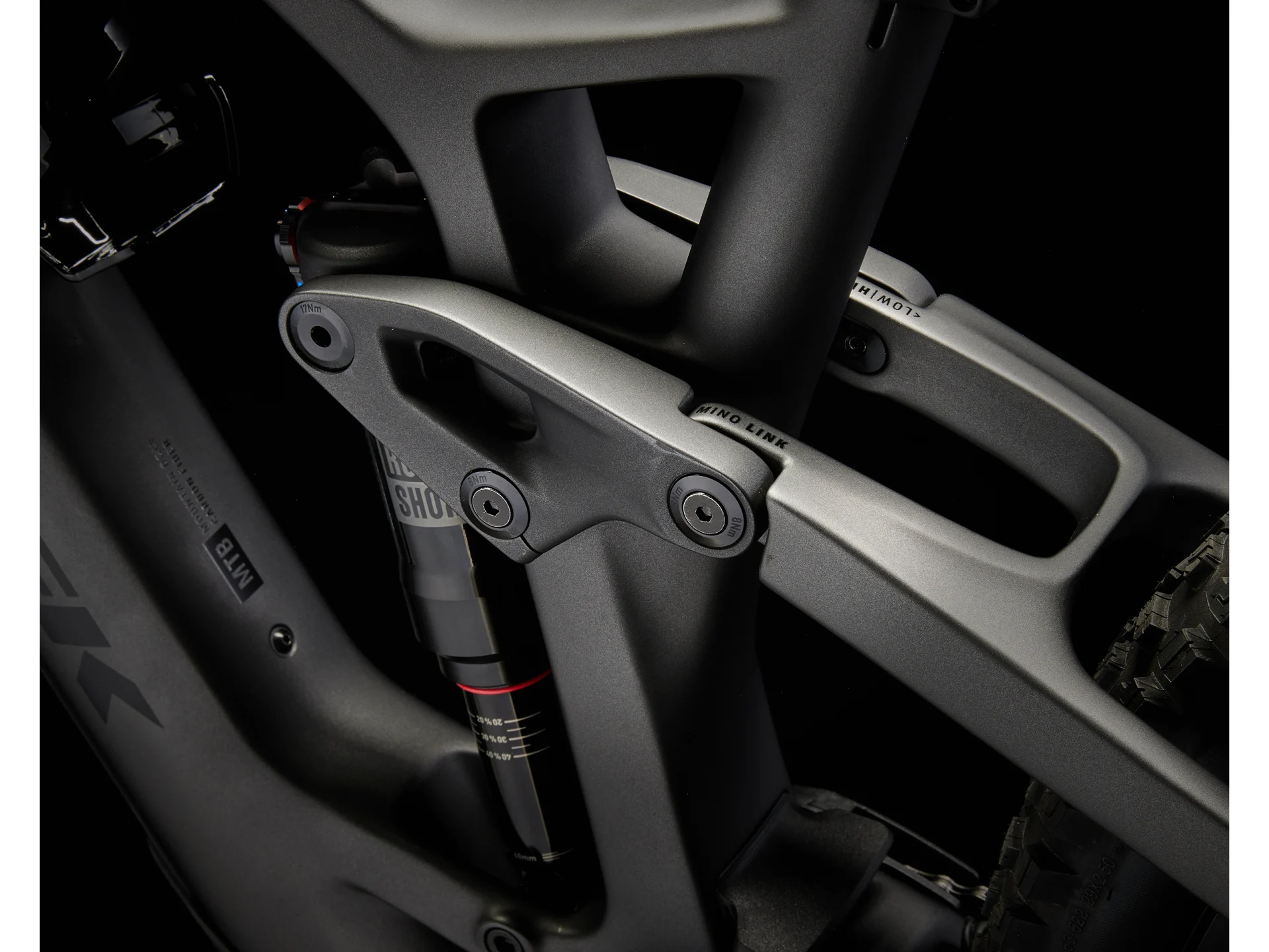

I am considering stroking my Exe to 62.5 or 65mm, but unsure if I have enough clearance for this. I have a medium frame and there is 11mm clearance left with stock shock bottomed out (no air). Since a few of you here posted good results doing this on a large frame, can someone with a large frame provide how much clearance they measure with stock shock bottomed out with or without stroke mod? I appreciate any feedback.
62.5 is ok ok low, 65 is not ok on low but might work in high. I use 62.5 because I want the option to use low setting.
I'd like to follow up on this and include a question for those that have stroked to 65 mm. Have any of you had any issues with clearance? I am on a large frame. I see that several people have done this, but I haven't seen much of a report back. Thanks in advance.
I had the same thought. But after flipping links from low to high, it made no difference. Either link position measured 11 mm clearance.
11mm clearance between what parts of the bike?
Ok yeah makes sense. The shock is moved more than the wheel. I just tried once in the low, compressing the shock fully and determined it was a bad idea to run 65mm. Never tried high because I knew it would be trouble when I run it in low.
Doesn't make sense to me... :unsure: Surely when the mino-link flips to high position it increases the gap between the seat tube and the seat stay bridge? Isn't that the concern people have with running a 65mm shock stroke - that these will smash together? @Piccirilli is this the 11mm gap you're talking about?
I think what he is getting at is : changing the mino link increases the gap between bridge and seattube when the suspension is at full extension - ie not compressed at all, but when the suspension is fully compressed, the rocker link is in a more vertical angle, so the minolink changing position doesnt move the seatstay bridge away from the seattube by as much as you might think. I havent measured whether it makes no difference at all though.
I see what you mean. Suppose it depends on what the mino-link changes - looking at it I assume it effectively makes the seat stay a bit longer, but if the effect is to make the rocker link longer then I can see why that wouldn't change the gap at full compression...
Yes, the 11mm gap I am referring to, is the distance from seat stay to the rear triangle brace with all air removed and shock fully compressed. On my medium frame I measured no difference with mino link in either position. See for yourself. However, I'm not convinced at this point I will gain anything noticeable by adding 2.5mm or even 5mm stroke. No who has done this here, has reported significant shock improvement. IMHO the issue is more mid stroke support on these air shocks. Rather than risking breaking something with this ancedotal mod, I plan to add more positive tokens and play with varying air pressures to improve performance. If that doesn't do much, then I'll look into coil suspension.

I'm really interested to try a coil on mine (size L). Aside from the best choice of stroke, I'm wondering if others on this thread have thoughts on picking a suitable unit?
I'm leaning towards getting a basic model, rather than blowing a ton of cash to find out if I like it with a coil. There are some units on eBay (new, but 2021 models I think) which are <£200 and come with a 400lb spring, which seems about right for me. Anyone got any views on the following:
- Fox Van RC Performance
- RS Super Deluxe Coil Select
Are these basically fine, but without latest dampers (i.e. like lower end forks) or in some way a bad choice for an EXe? Do I need to replace the stock (presumably linear) spring with a progressive?
Thanks in advance for any tips.
Whatever you buy you have to experiment with coil rate. I am on Ohlins platform what works amazing and it was noticeable from the very first minute on the bike (without setting up all adjustments) two negatives of coil - weight and linear characteristic. I ended up with CC progressive spring (400-488) as purchased based on web calculators 388 was too soft in second phase of travel, and used 456 was too stiff in first half of movement.

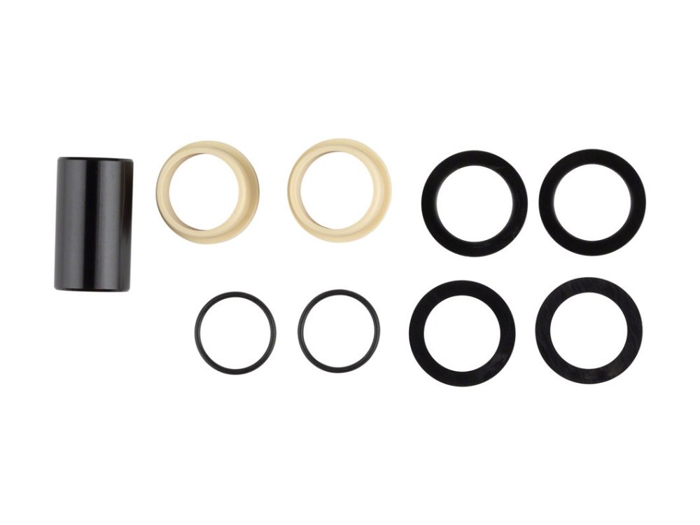

This kit, oddly, seems to have cured my issues. Requires less clamping force at the lower mount. 8 x 40 version. (stock is 8 x 39.8)
Thanks I've seen this floating around the megathread. I may purchase this, just to have it on hand in case lower shock mount play does occur. I just need one kit for the lower, correct? Appreciate your replies.
