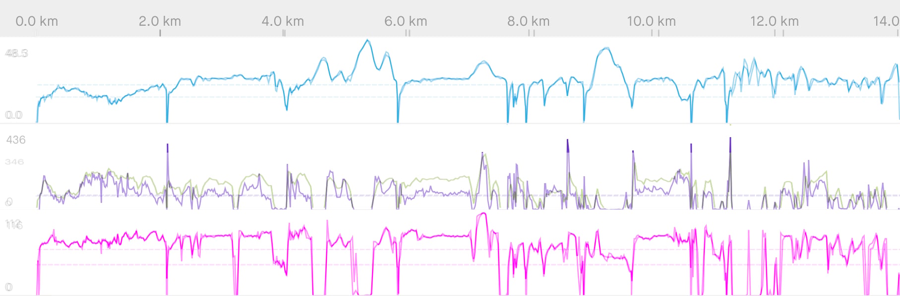

In case anyone wants to know …
Here is the overlapped power data comparison from Strava for a ride recorded with both the Trek Central app and Garmin XC200 pedals (via Edge 1030). Shown top to bottom is speed, power and cadence.
Website plotting functions can be a little ‘vague‘ (see km markers, or the ave. speed lines that should be the same …), so I used the stopping points mid-ride to scale the distance (x) axis so that the timing matched for everything else.
+ The speed data are near enough identical, max. was 48.3 & 48.5km/h. I read somewhere that Trek Central App uses the OS GPS data in the saved file, so this is effectively Edge 1030 vs. iPhone 12.
+ The cadence is also near enough identical, which is what it should be. Any differences are next to negligible.
+ The power comparison is a can of worms! Due to different max. power values, I had to scale vertically as best I could – in general, I had seen that there was wildly varying differences, often factor 2, but there is one short passage at around 8.4km (uphill, speed below TQ cut-off), where both consistently showed approx. 100W, that I used to match the vertical scaling. The margin of error (due to how often I looked to compare) could easily be +/-10% or perhaps more. What is worse,, the average power lines should not overlap (I think 78W vs 117W), and if I had scaled so that they were relatively correct, the following would be much worse!!
The reality is that the TQ values (green) were rarely the same as the XC200 pedals, and in fact usually higher – look at where I hold speed, power and cadence (by accident, all above cut-off): the TQ data was 50-100% higher. Elsewhere the data doesn‘t match much either. The TQ data shows bloated values just about everywhere, but there was also consistent ‚overrun‘ shown ‚real time’ on the display for 1 or 2s, meaning that updating was generally slower. Given that Garmin has had many years to qualify their pedals (ha ha … yes, but we all know Garmin ;-), that TQ freely admits that their power data is a ‚guesstimate‘, and adding that to what I saw while riding, then, frankly, the TQ values are nothing more than ‚ball park‘ … and a fairly big one at that.

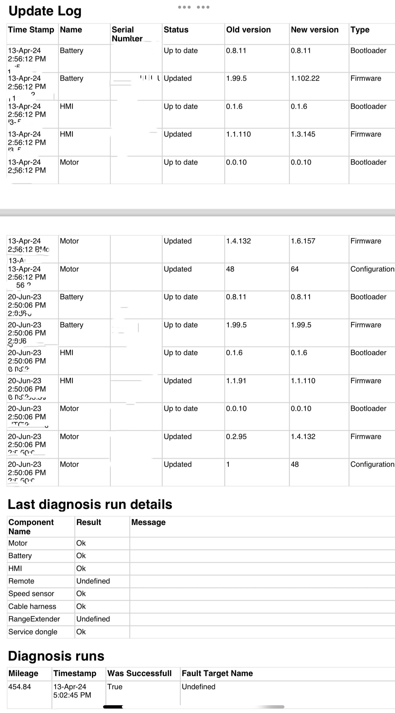

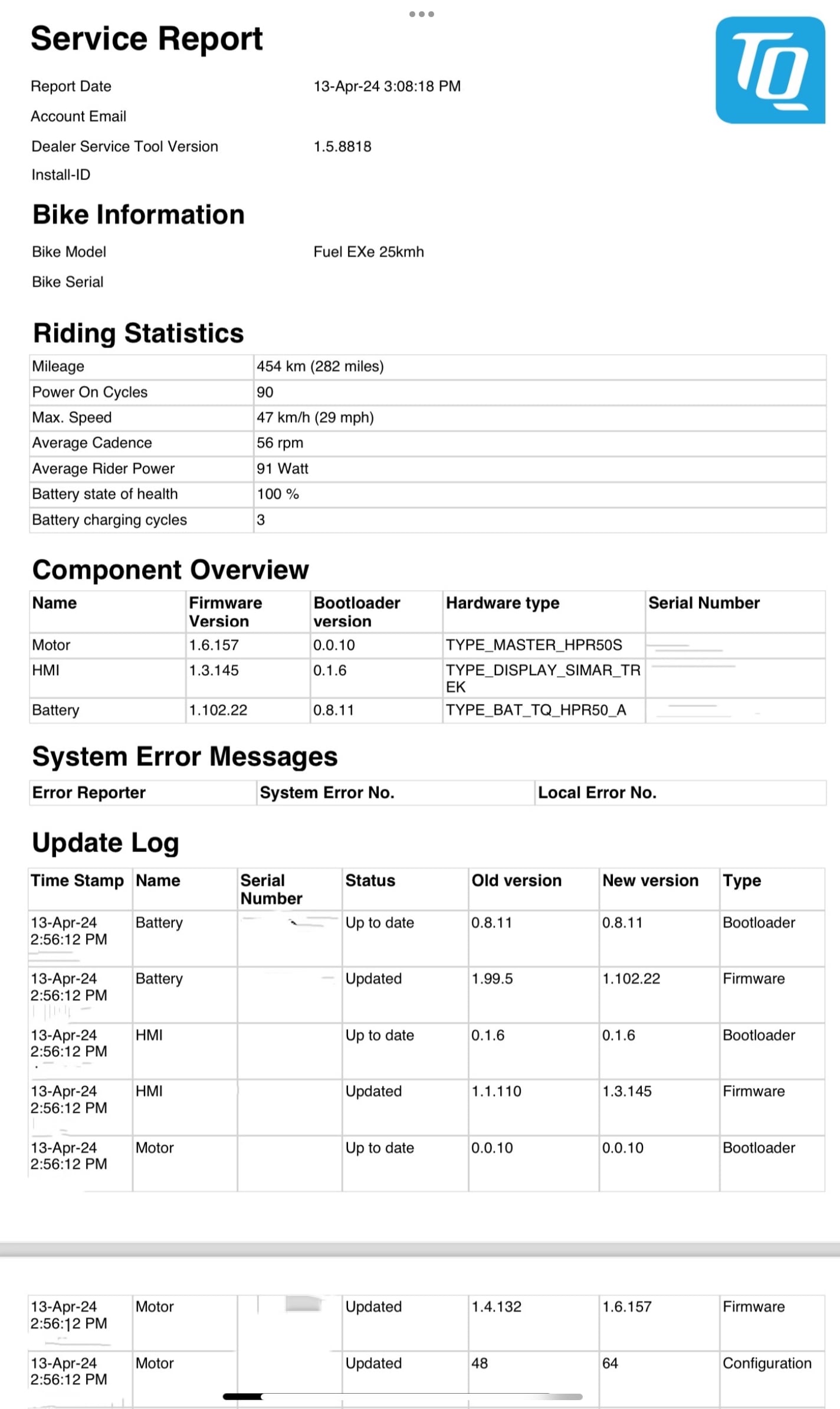

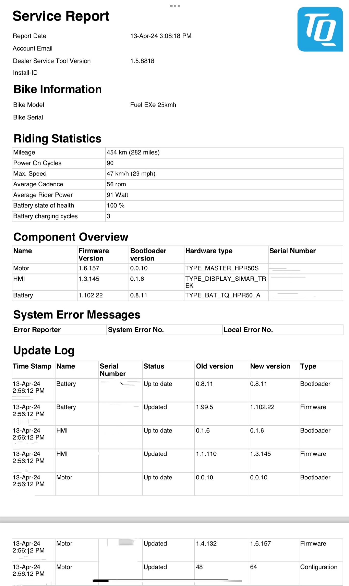

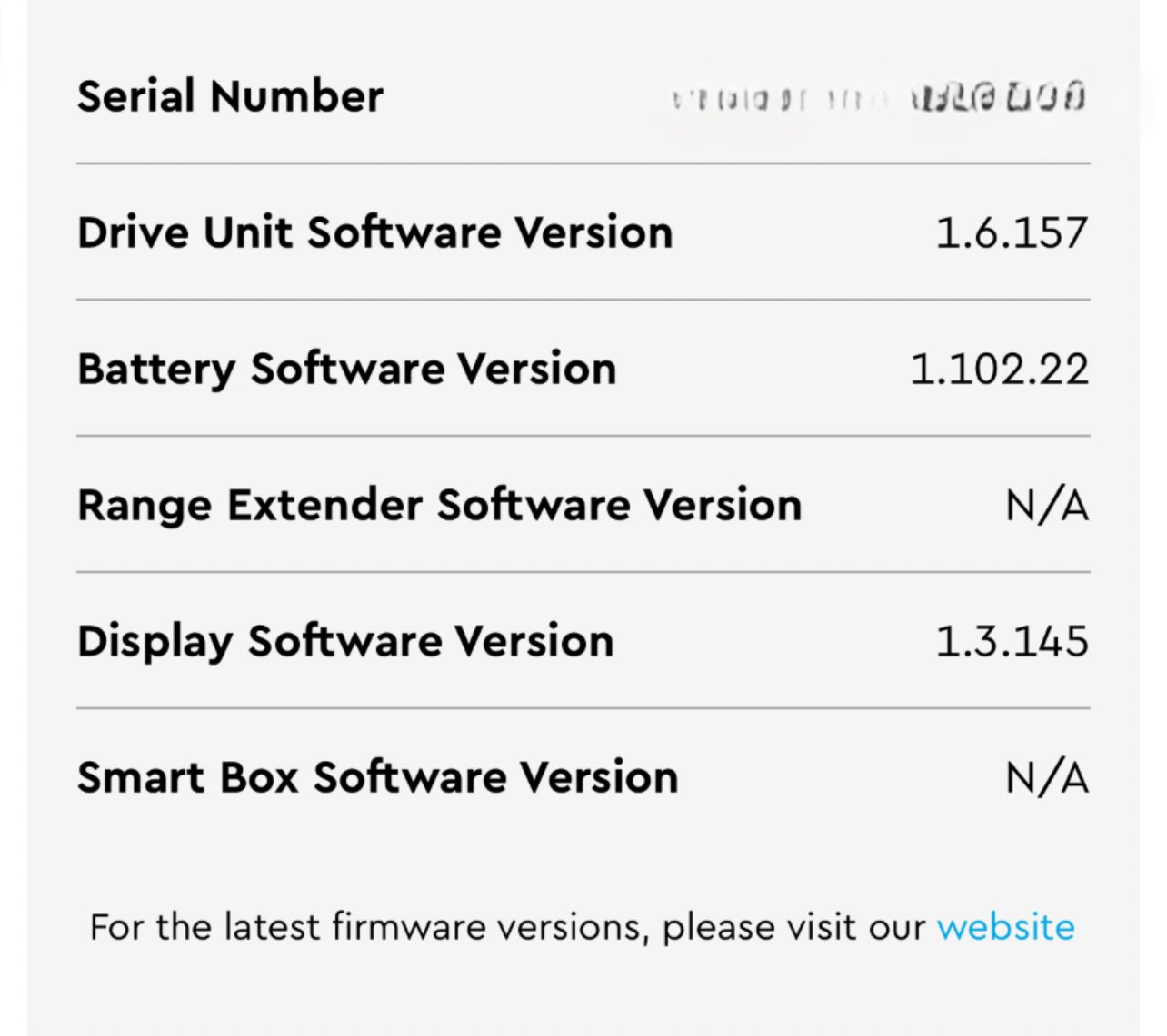

Dear all
I have received my TQ service dongle and updated my Fuel ExE TQ system firmware and have noticed better performance in my ridding .
Thanks for that. Could you try and describe how the firmware has Changed the motor performance?
It looks that motor response has delay to pedaling when I compare with present condition and had some small noise in starting of assist , I was looking to find a way to override 25 km speed limit to 32 km (USA version speed limit )but not find it.

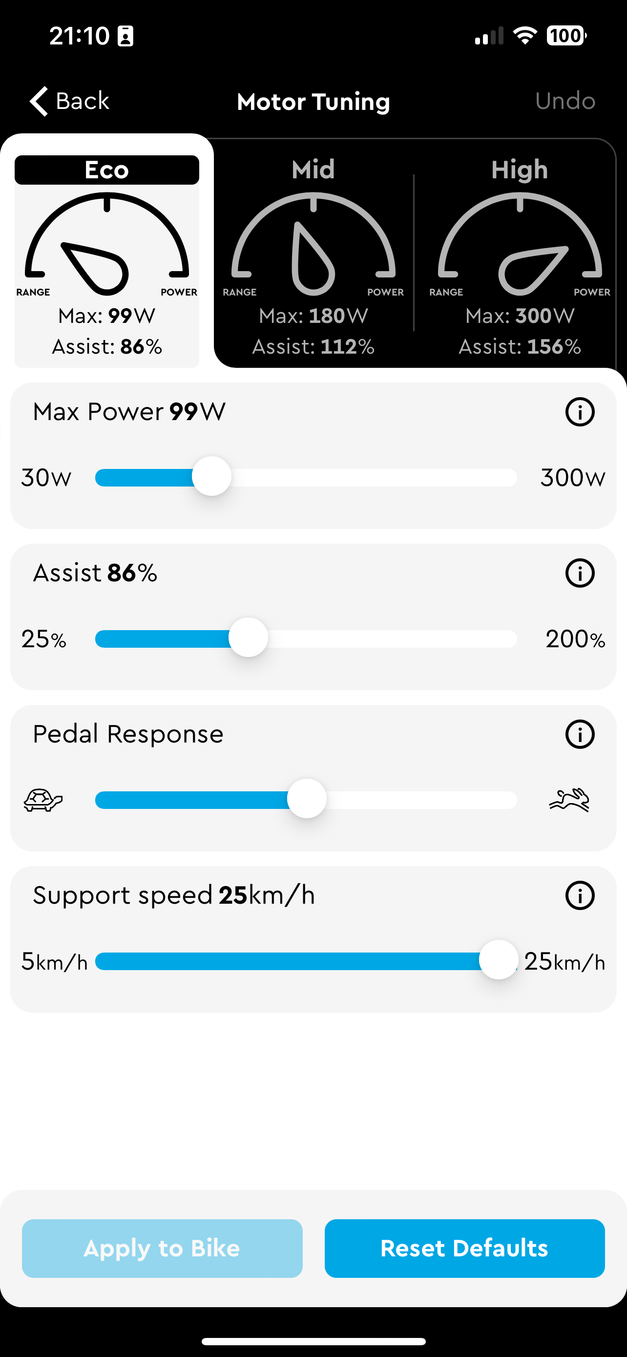

Is there any way to change speed limit from 25 km/h to 32 km/h (20 Miles / h like the Ebike in USA)
