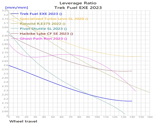

First you need the generalized leverage ratio, which is travel divided by shock stroke. 140mm/60mm=2.33
Then multiply your body weight (in lbs) by leverage ratio for target spring rate (in lbs)
187x2.33=435lbs
I'd get a 450lb spring
You can reverse that formula to see how much extra travel you get by increasing shock stroke. i.e. 62.5mm x 2.33 = 145mm. 65mm x 2.33 = 151mm
None of this takes kinematics or leverage curves into account.
There is mass sharing with the fork so I would think the total weight x leverage ratio equation would result in a higher number. For instance, at 187lbs TF gets a 400lb spring rate for a 4 bar.

It is simple math, 60mm stroke gives 140mm of travel, every mm of stroke gives 2,33mm of travel.
62,5 make rear 146mm, 65mm gives you 152mm
Yep except when the progressivity changes throughout the stroke. Then you can have different amount of travel at each end of the stroke per mm.
Very linear frame of EX-E, in analog brother EX there is a flip chip to correct progressiveness.
Fuel EXE has 16% progressivity and with an extended stroke, the end stroke is completely linear in the added travel. Leverage ratio at the end of travel is 2.16 so you would add 10.8mm of travel when you extend stroke 5mm. A Cane Creek Valt progressive spring would be a great option for this frame.
