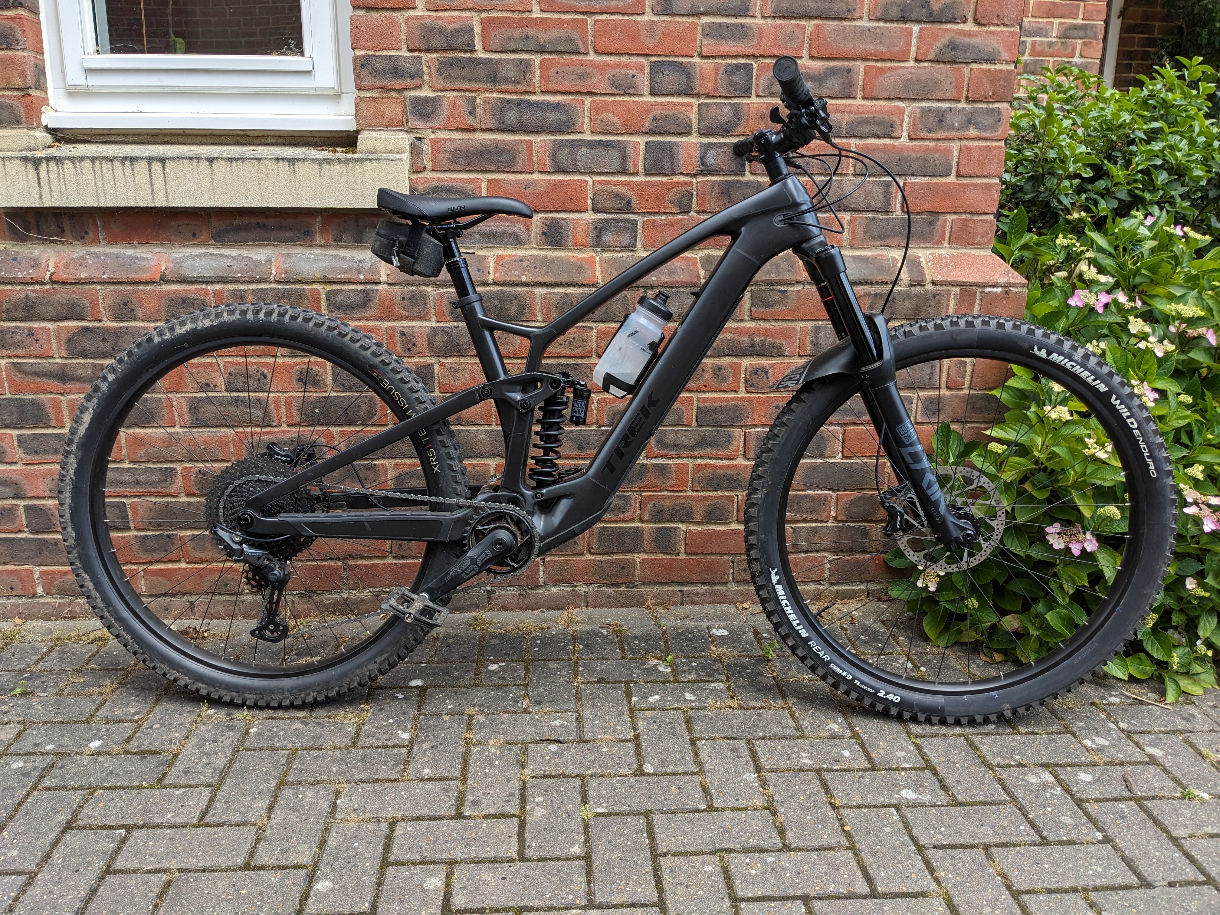

Thanks guys for the feedback, I got the coil fitted at the weekend:
It's a 62.5mm stroke unit, so I fitted it without the spring at first to see what the clearance is like between the seatpost and seat-stay bridge. This is it with me sitting on it (so compressing the bottom-out bumper a bit):
I couldn't really measure it with the wheel in place but I'd say there was about 12mm gap (mino-link in low). I'd think a 65mm stroke would be ok, but I'm not sure how much the bottom-out bumpers compress on a hard landing - could be tight.
Anyway, the test ride went ok, it feels marginally better than the standard Deluxe Select+ unit. I'm pretty sure the 400lb spring is a touch too stiff, it feels firm to ride, and I only just get 25% sag. I looked at Cane Creek's website and the formula they recommend for choosing a spring says to take the leverage ratio at 30% travel (2.4 according to the chart posted by @BiGJZ74 in post #90) and multiply by rider weight (180lb in my case) giving 432lb. I'm not convinced.
I'm wondering if the lighter 350lb Rock Shox spring might be a little too soft. 375lb doesn't seem to be available, but there are various progressive options - of which I have zero experience. I seem to use full travel, but I've only got the hydraulic bottom out two clicks in, so maybe I don't need a progressive. Pearls of wisdom much appreciated!

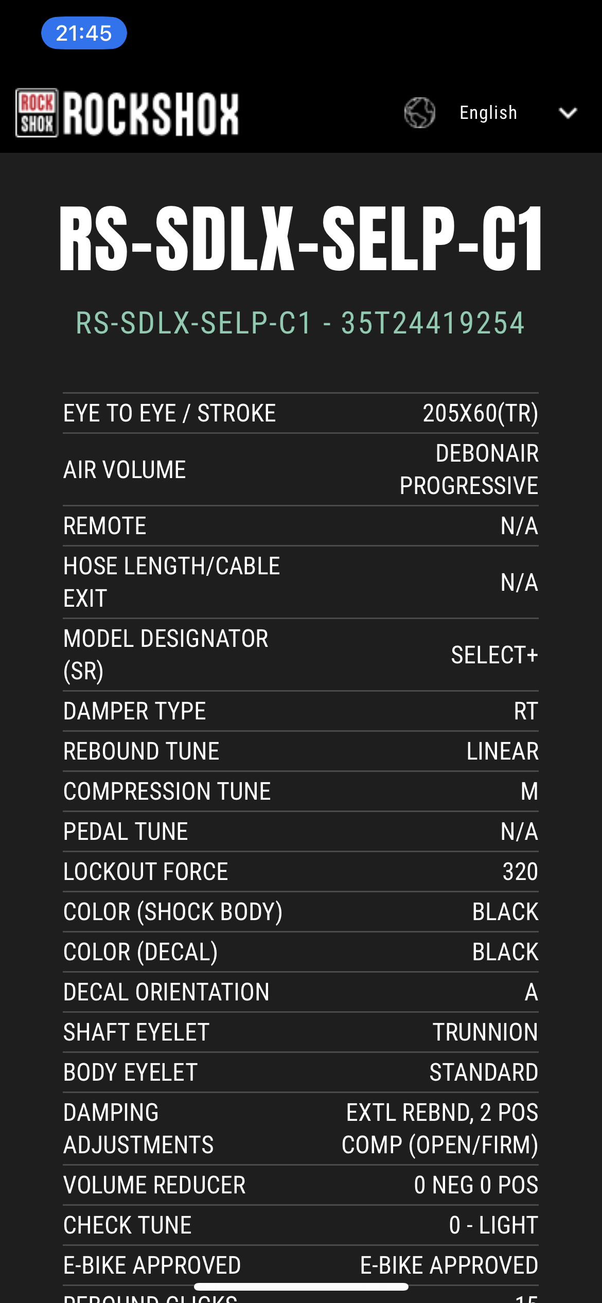

I'm running the RS Select on the 9.5 and looking for something with more volume - I'm 110kg geared up so it gets overloaded pretty quickly.
I'm not attached to a particular brand, but paying AUD1k for a shock is pretty out there, particularly when my Durolux cost me AUD600 and is such a good bit of kit
Has anyone run a Bomber Air or a DVO Topaz 3 on the EX-e yet? These are significantly cheaper over here and look a bit simpler. An RS Super Deluxe is a touch under 1k, but a Fox Factory X2 or new RS Vivid is >1.1k!

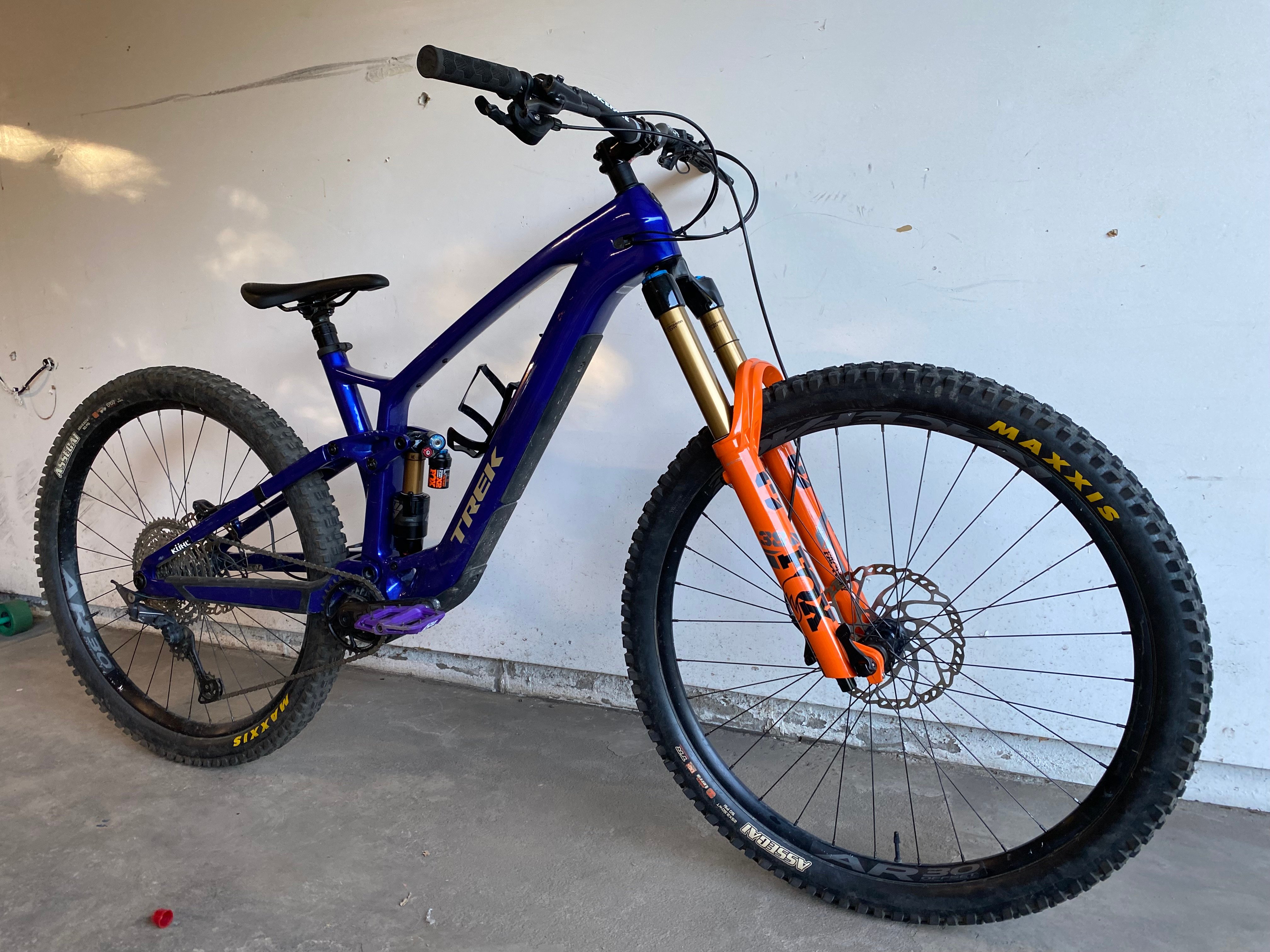

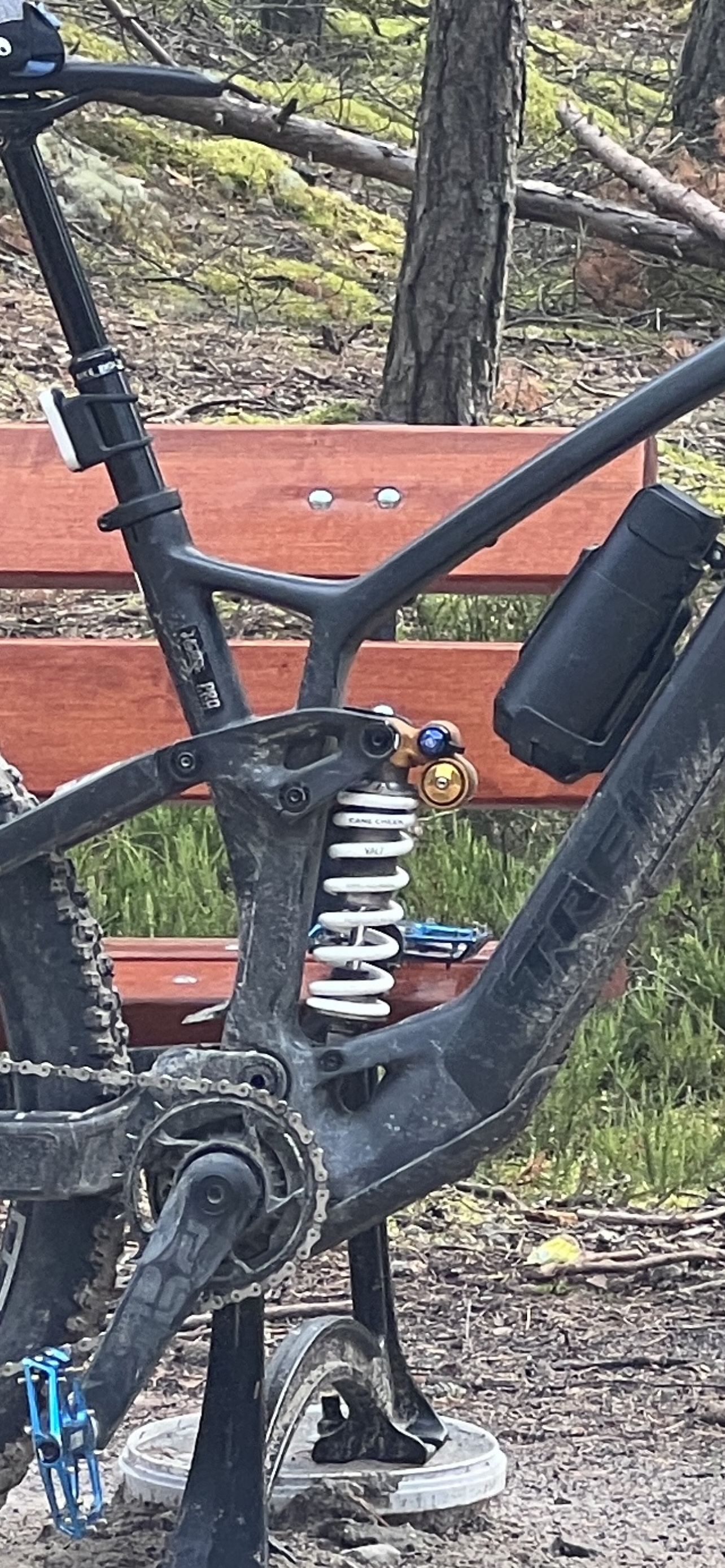

Maybe useful to someone here …
After initially hugely missing the subtle/capable/buttery feel of my trusty 2014 Intense Tracer T275 (with 2015 Marzocchi NCR & 2017 Float X2, giving 160mm f/r), my Fuel EXe 9.8 XT with stock RS front (Charger 3) & rear is finally starting to feel the same. How did I get there?
+ I finally found a local trail that yields rapid Shockwiz results - basically a fast, fire road accessed, part big root trail, which seems to give Shockwiz everything it needs in a single loop. Love it or hate it, but Shockwiz gives usable results for me.
+ I upped the fork to 160mm and used 5wt. oil in the rebuild (as opposed to the recommended RS Maxima Plush Dynamic Light which is 7,5wt.). Rider weight is 71/72 kg ready to ride – I‘ve gone the ‚lighter oil‘ route in every fork I own, and it has always paid off.
+ Even though the shock has no adjustable compression, Shockwiz requires no changes and it feels good to me.
Certainly now no immediate need to try other suspension components for a while – I am sure there is still some fine tuning to go.
The bike has 370km on the clock. FWIW, thrashing it over this trail 20 times has likely also helped loosen things up. Also, after repeatedly pinging the rims on roots, I realized I need another 2-3psi in the tyres (anyone else know this rule: snakebite + 0.2 bar?).

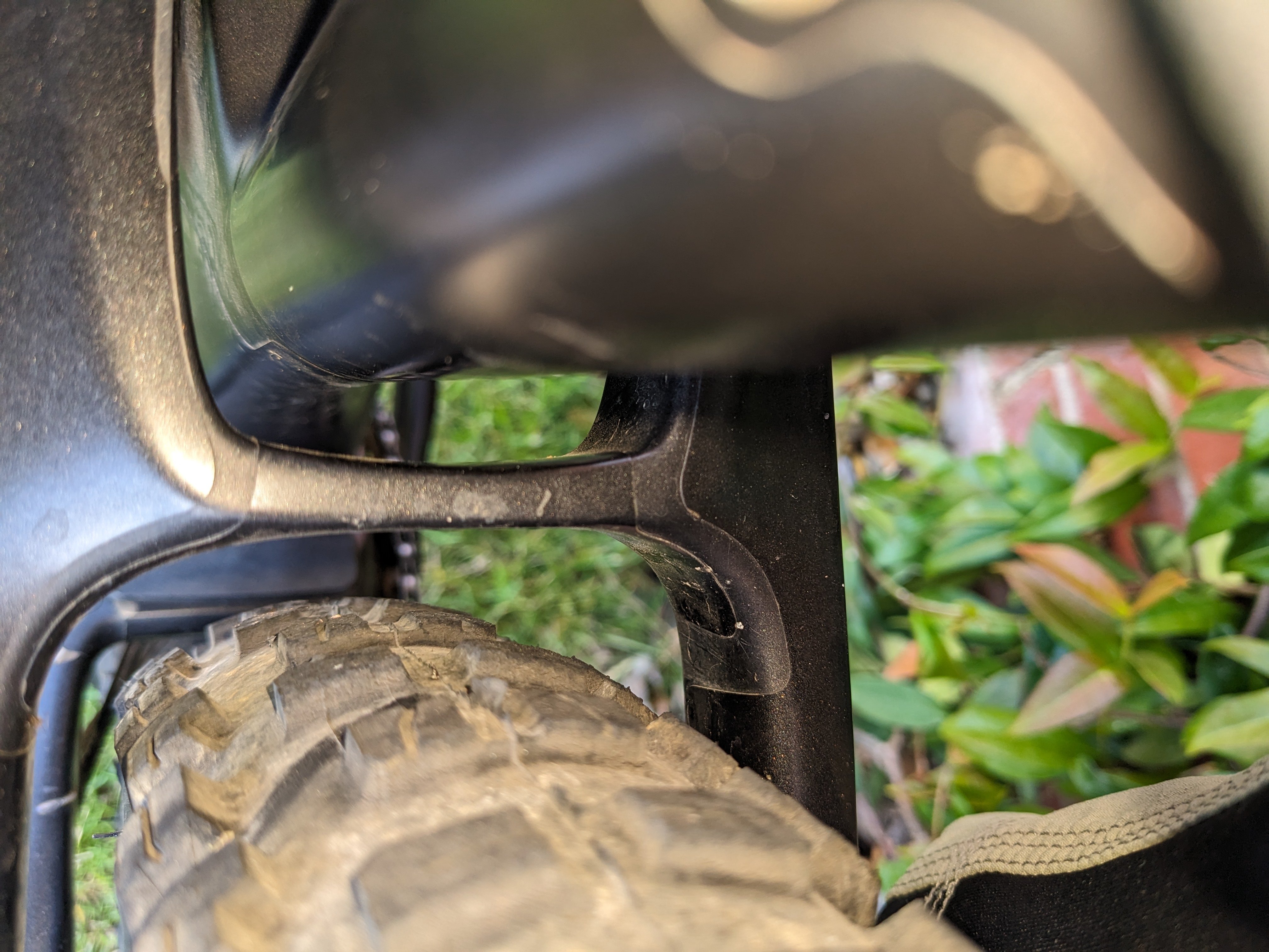

So, been talking to Craig at Avalanche about custom tuning for this bike, He knows quite a lot. Most of the info is here.
Just the initial stuff:
  • The EXe has a 16.5% progression ratio. This is about the minimum for coil-compatibility, he says. Requires some sort of bottom-out control. Totally makes sense to me, this is why I've got my Ohlins TTx1 stuffed with spacers and still bottoming out at 30% sag.
  • The clearances on this bike are tighter than I realized. I can see that the Ohlins TTX and EXT E-storia have advantages here, with their sideways (transverse?) reservoirs. We should all be very careful with over-stroking this frame, as even with a lot of 205x60mm shocks, reservoir will hit the downtube at full compression. This is compounded (literally) by coil shocks which use full travel more easily.

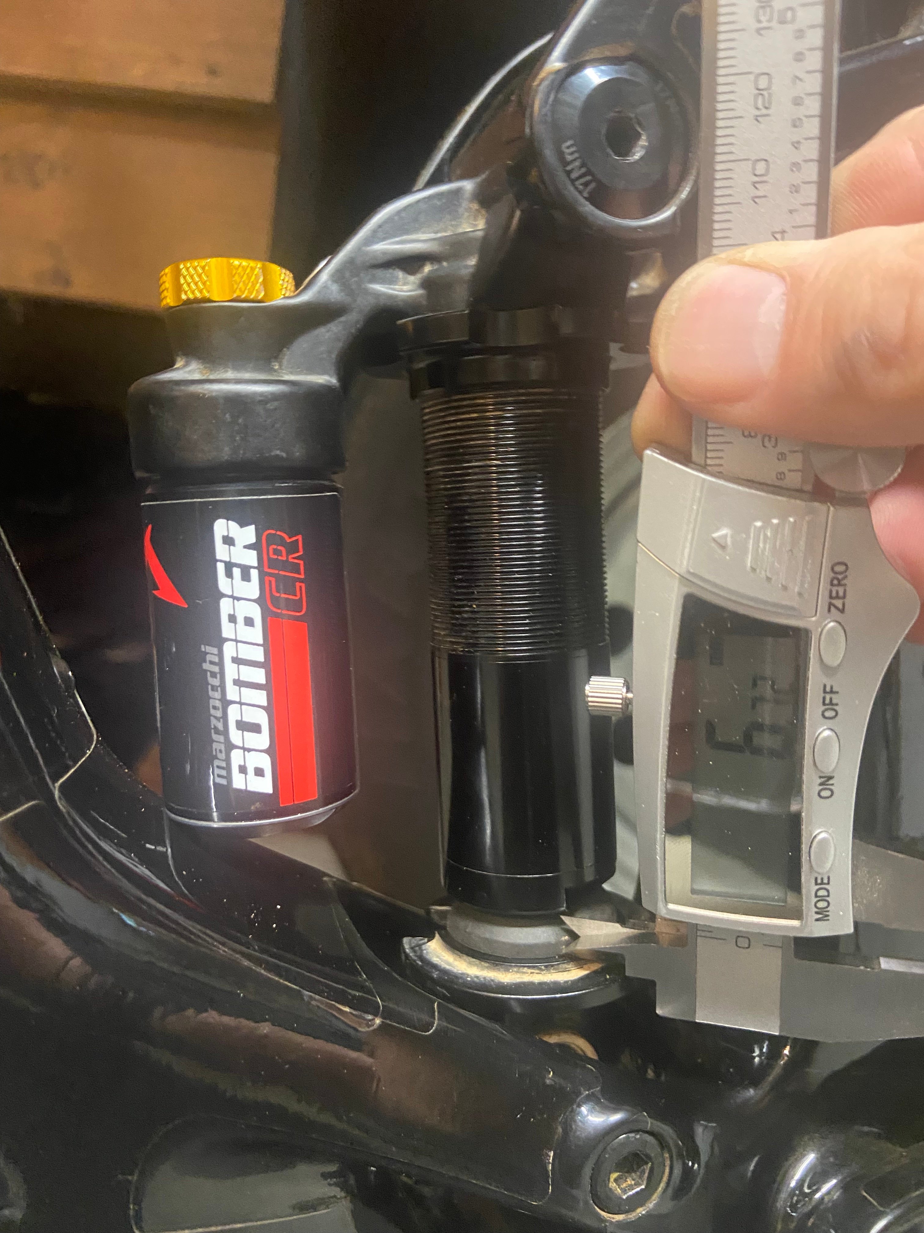

Here's a clearance check with a 205x62.5mm Bomber CR. Reservoir hits the downtube with the BO bumper compressed as shown. A 205x60 should not work either. Craig at Avalance will chop 1cm off the reservoir, replace the damping entirely, and add a large conical bottom-out bumper with cup. Basically everything that can be done to add progression.
