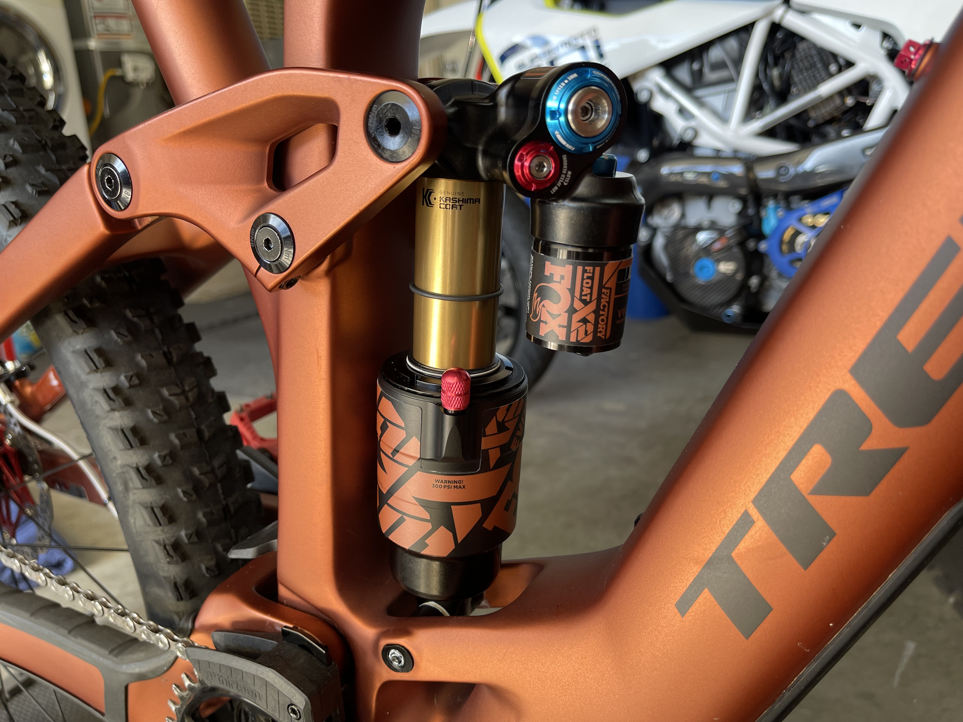

Yes, I run one on my 9.5. I will agree they are unreliable with the =<2021 model years. But, you can buy a 2021 and have a suspension shop replace the entire damper body with the improved 2023 version for 45$ when open for a rebuild, which solves a lot of issues.
They need service every year or they will die, but if you keep them clean, they are so nice. It is also compatible with the 205x65 overstroke, because the reservoir doesn’t hit the frame, giving a really nice 152mm travel.

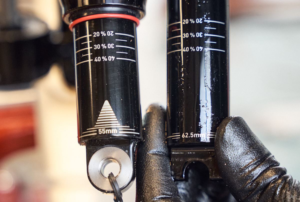

How can you tell if a RockShox SD Select+ has the HBO?
(do all Select+ fitted to EXe's have the HBO?)
mine didnt have HBO.
A shock with HBO has different graphics on the shaft compared to one without HBO. IN the image below the shock on the left has HBO, the one on the right does not have HBO

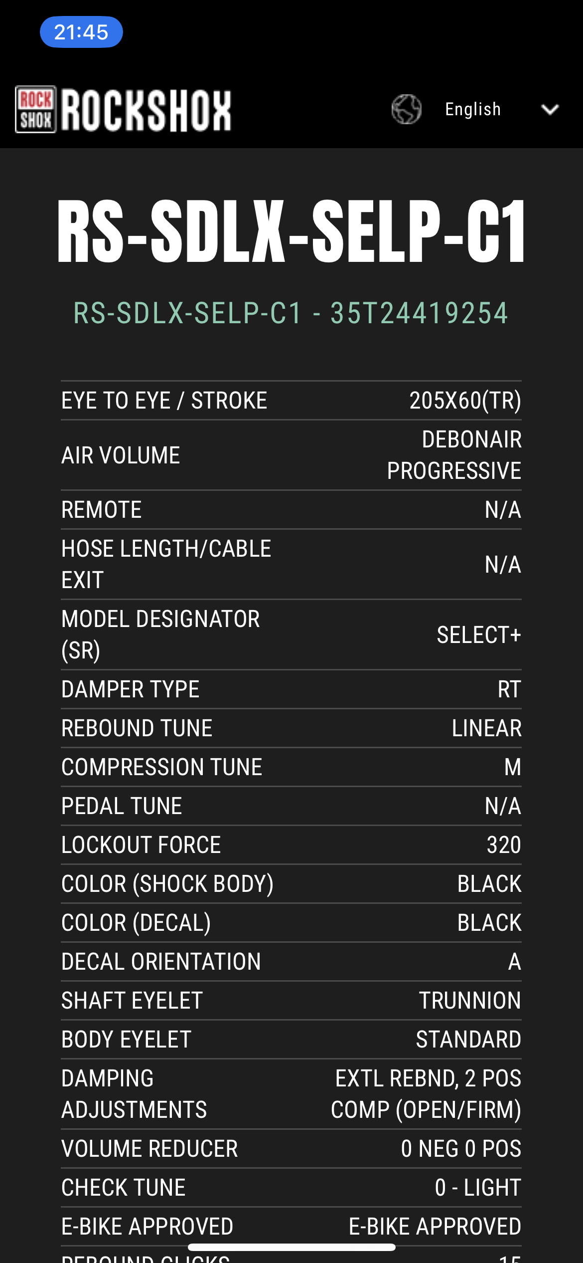

I have a RS Ultimate Select+. I'm only using about 80% of travel, I have opened the shock and there are no volume spacers within it. I bought it from eBay, it was listed as coming off an EXe, so I can only assume it is the correct tune.
I have it at about 28% sag.
Suggestions on what I can do to get more travel out of it? (other than send it harder ! )
@Dave_B That's weird. Many have had the opposite problem, the suspension is pretty linear.
Have you measured with calipers to see how much stroke is actually being used?
You have the compression lever open when setting sag?
Past that I would try more sag, but you may have a dud shock.
When I had the same stock shock, at 30% sag/190lbs I was getting full travel with max spacers on most every ride. Did not keep it long.
Set it at 1/3 sag. The EXes are very unbalanced to the front. So run the shock with a lot of sag and run the fork on the small end of the sag spectrum with more compression than normal. You may even try 35% sag in the shock. But honestly, you should be more worried about how the shock feels then how much travel you’re getting.
These RS deluxe/superdeluxe shocks have the option of a progressive or linear air can, if the shock came from an exe it will have the progressive air can fitted by default, you could swap it to the linear air can, but I wouldnt recommend it, it makes it far too linear - I have tried both air cans.
When you opened it up to look for volume spacers did you take the air can fully off? I ask because on these there can be spacers fiited to the negative air chamber,which arent visible until you fully remove the air can. But these affect the beginning of the shock stroke rather than the end stroke which is what positive chamber spacers do.
I had the same issue as you - couldnt get anywhere near full travel when everyone else was complaining they bottom out too easily - I just increased sag slightly in the end, there seems to be a very narrow sweet spot for sag at around 32% ,for me anyway. Too much sag and you bottom out all the time, too little sag and you dont get anywhere near full travel - Ifound it quite tricky to find the sweet spot.

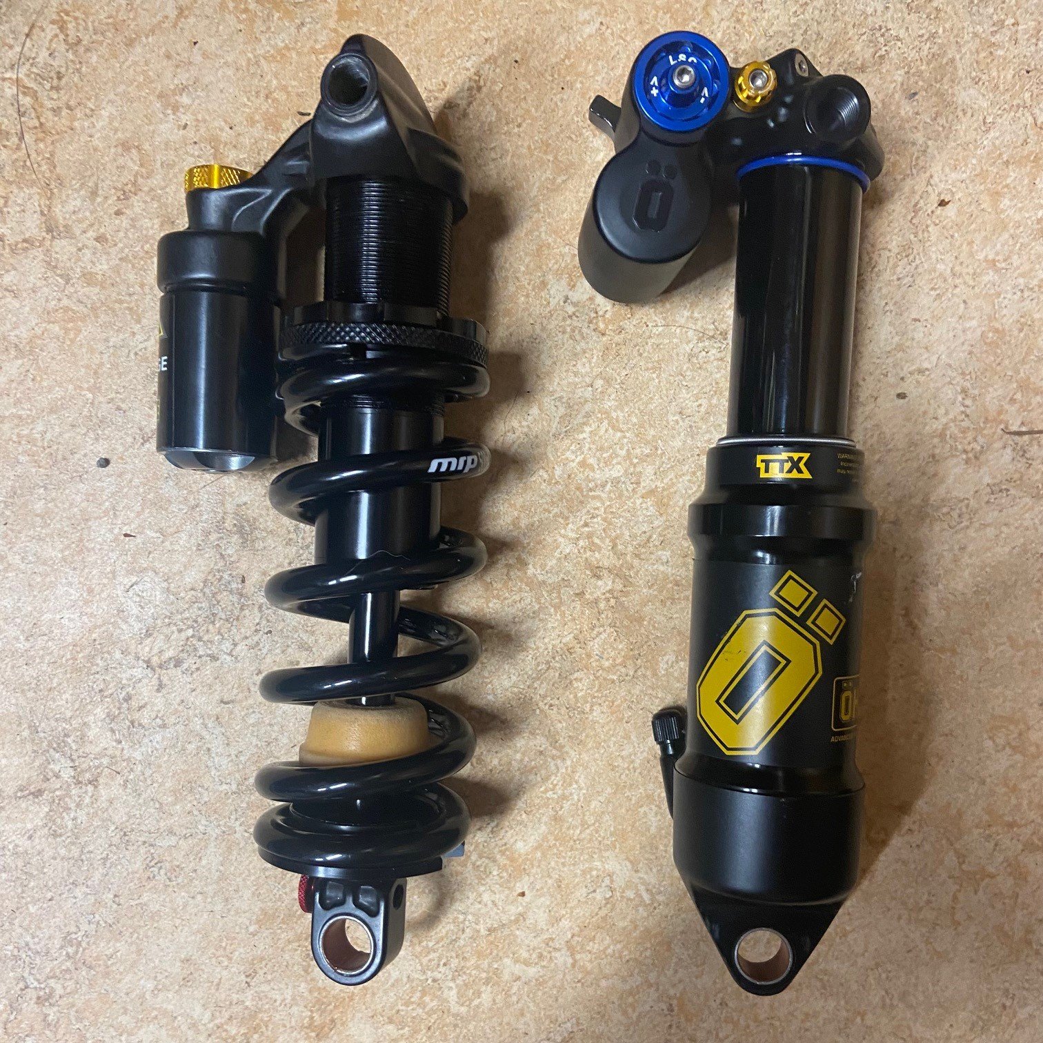

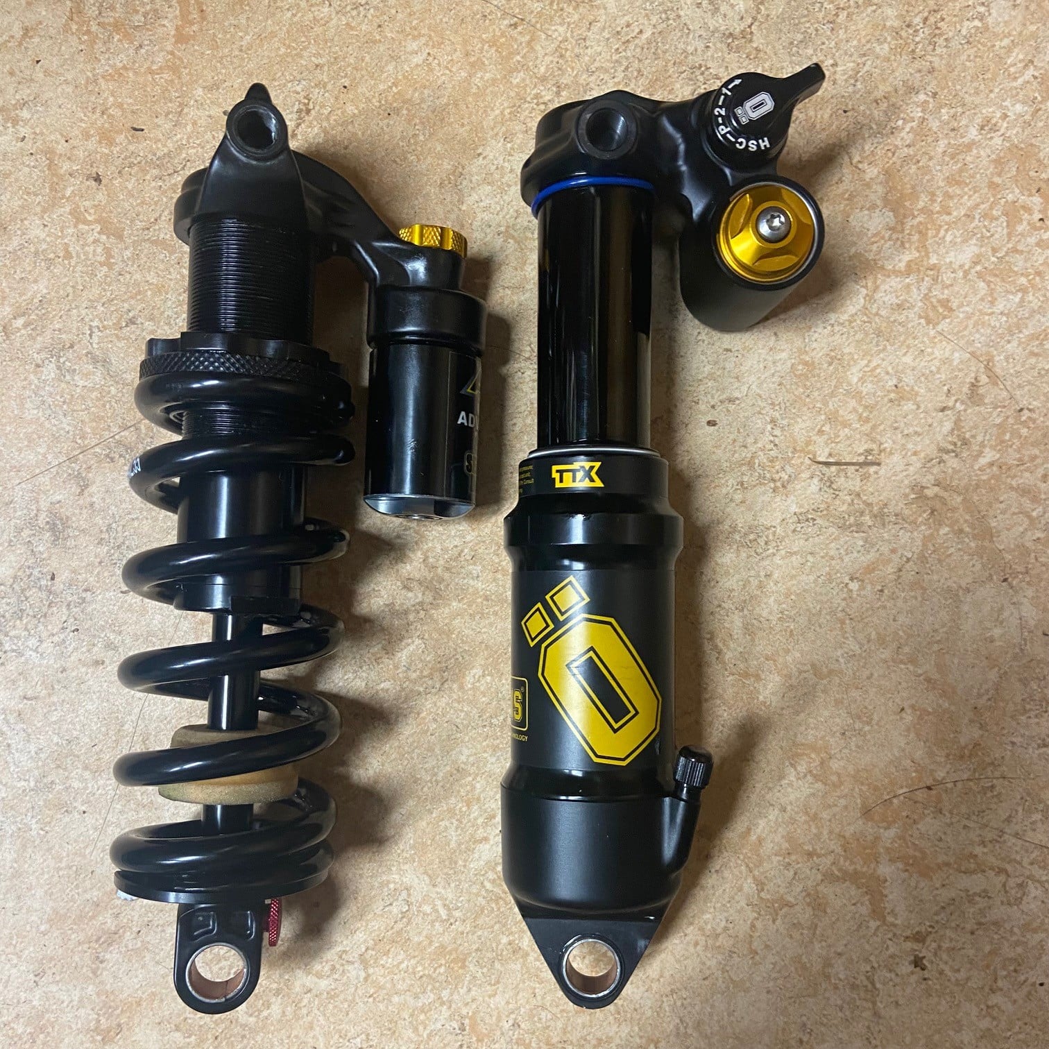

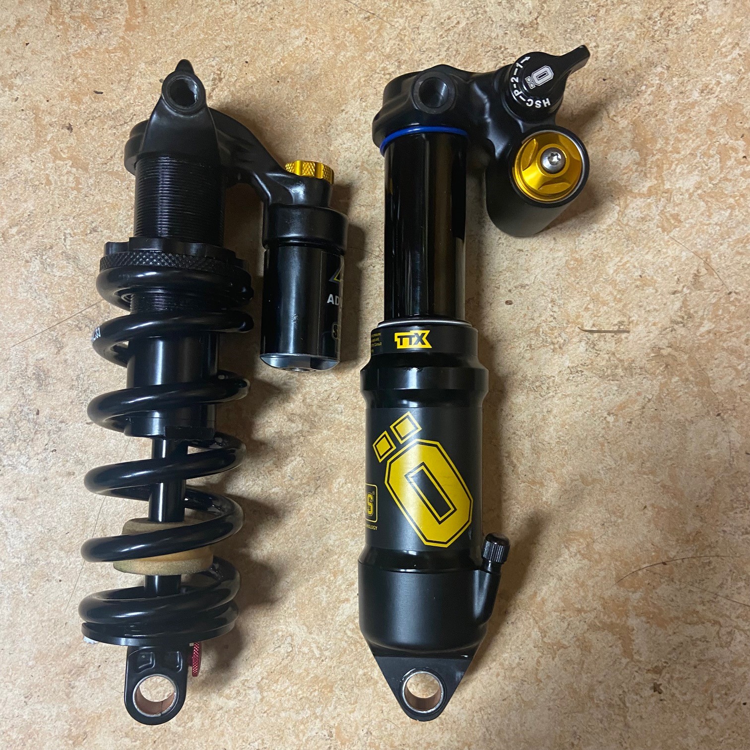

I finished out the season with a dead remote, cracked rim and a blown rear shock. The shock saga was interesting- basically I could feel the damping in the Ohlins TTx1 fading, so I bought a $150 used Marzocchi Bomber CR which i planned to use as a back-up while the Ohlins was getting rebuilt. A quick test fit showed the bomber reservoir did not clear the frame, so I sent it off to Avalanche to have the reservoir shortened & converted it to their SSD tuned for the EXe. Meanwhile the Ohlins became unridable, so I sent that off too, along with the cracked wheel. All in, my EXe was out of commission for 13 weeks, during which I was back on my Chromag. An unplanned challenge to go back to a hardtail with no motor and shitty G2 brakes!
I got both shocks and the new rear wheel back over the holidays. The bomber is great so far, very supple on small stuff, but it doesn't go deep into travel easily as the Ohlins. At 190lbs I am running a 500# SLS spring. I ran about 200psi in the Ohlins with their largest volume spacer. Both are now 65mm stroke.
I would really recommend keeping a spare shock around. The 50hr service intervals recommended by most suspension companies goes by fast on eBikes, and lead times for rebuilds aren't quick (13 weeks for the avalanche and 6 weeks for the Ohlins, which was 9 months old).

Just for the sake of documenting my experience :censored:

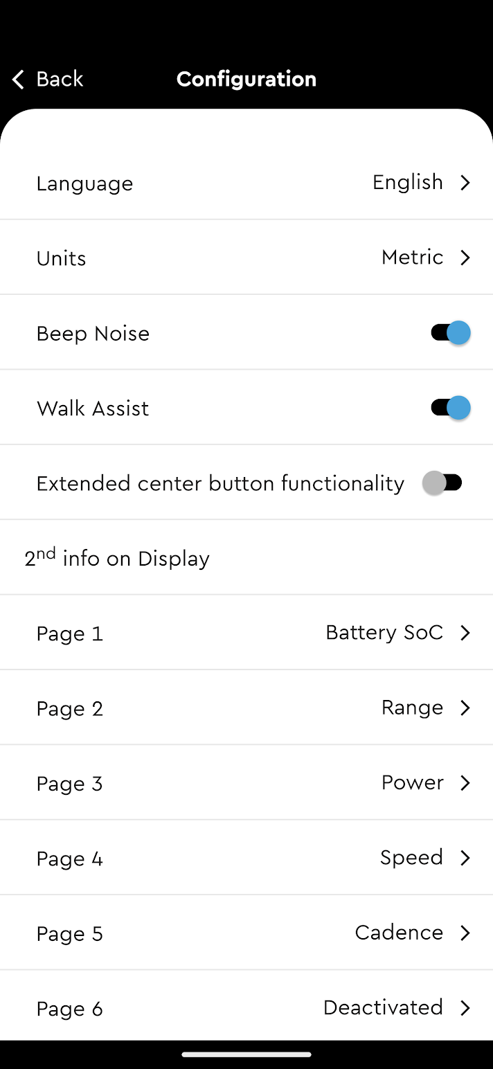

FYI for anyone not aware, you can set your display button to control ride modes via the TQ app. This can be done trailside in a pinch, or if you want less clutter in the cockpit area.
You pair to your phone, go to configuration, turn off walk assist, and turn on the extended center button functionality. The button just goes up in modes until 3, then pressing again it goes down to 1, very basic but it works.
You pair to your phone, go to s down to 1,
That’s a great tip. Of course what happened was the up/walk button failed, so I did a restart which stuck me in 0 mode with no way to change modes. It was all DH to the end, but your tip would have gotten me another day of riding.
