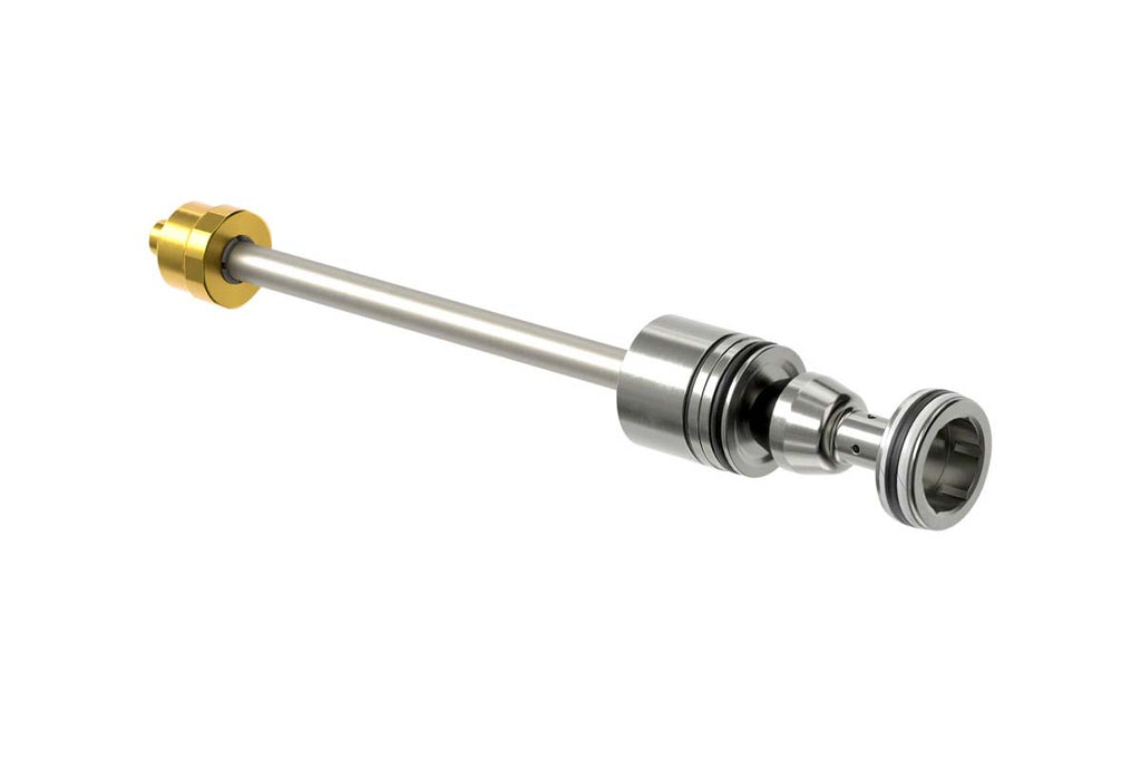

I just swapped the airshaft assembly in the original Lyrik Select+ from 150mm to the 160mm with buttercups but have not had a chance to test it out yet. Supposedly buttercup on the one side is still a decent upgrade, we'll see. Cheap easy try, and the entire air spring side had WAY too much grease anyway, happy to have been in there.
DebonAir+ Upgrade - FS-UPK-DBP-A1 - RockShox

Any feedback on this mod? I didn't know you could put a buttercup air spring in a select +. Other than the 10mm increase in travel, could you feel the butter cup?

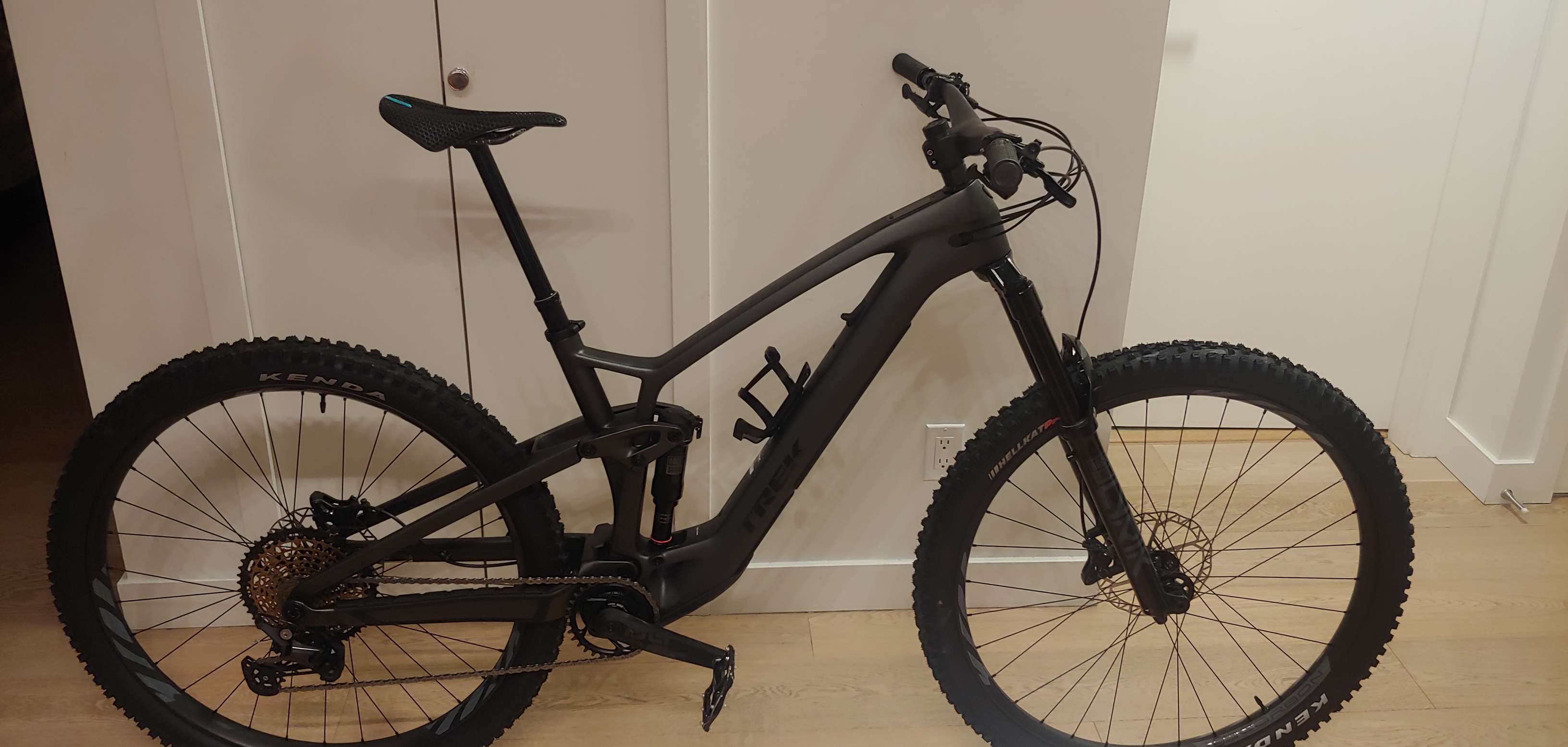

My beauty ))
Honestly not sure, i changed so much at the same time it's hard to tell what did what. I love the way it rides though, no complaints. If you're already going to increase travel, might as well buttercup it.
