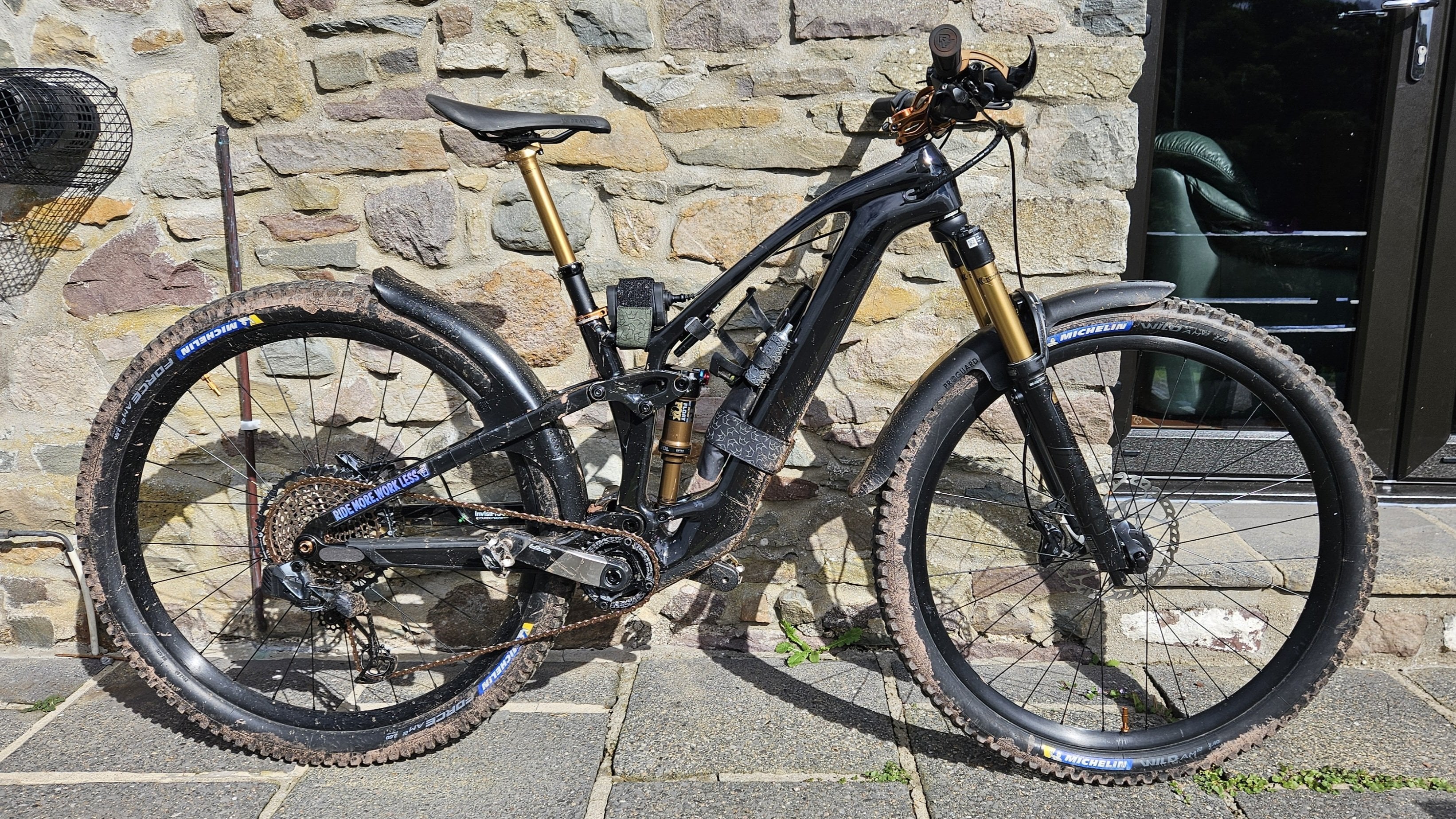

I can't remember if I've mentioned this before, on this thread, so apologies if I have. I always have a slight inward chuckle at people wanting to max out their travel on this bike, as I have actually reduced it and am having an absolute blast! I run the 2024 Fox Float shock at 57.5mm, giving me 135mm of rear travel, and the Fox 36 fork at 140mm but with a Reverse steerer tube spacer, which preserves the geo of the bike with the 29" wheels F&R. I genuinely love it and ride it on everything from big XC days out (50+kms and 2,000+m of climb) to some of the rowdiest stuff we have locally, even the Ard Rock Enduro all 3 days back-to-back (the full course as event sweeper) and there's only one place where I've genuinely wanted it to have more travel (and for that I have my 150/160mm Levo SL). My honest opinion is don't go 170mm. 160mm is plenty for this bike - I can't imagine much I couldn't ride on this bike at 150/160mm. It's easy to get trapped in that way of thinking that more travel = better bike, but that's not necessarily the case. I'd be interested to know your thoughts if you do try it though - nothing wrong with experimenting!
Happy trails all! 🤘

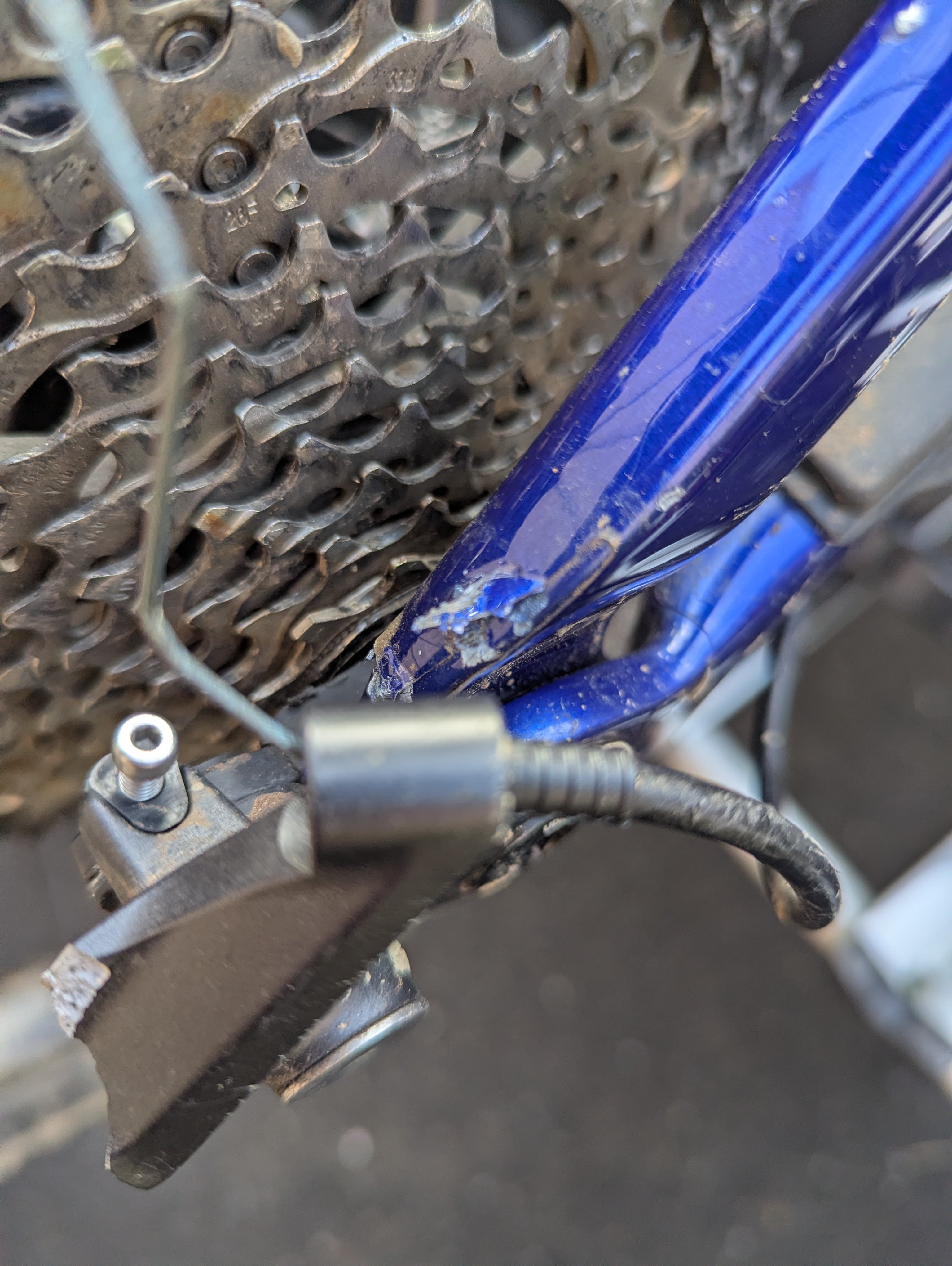

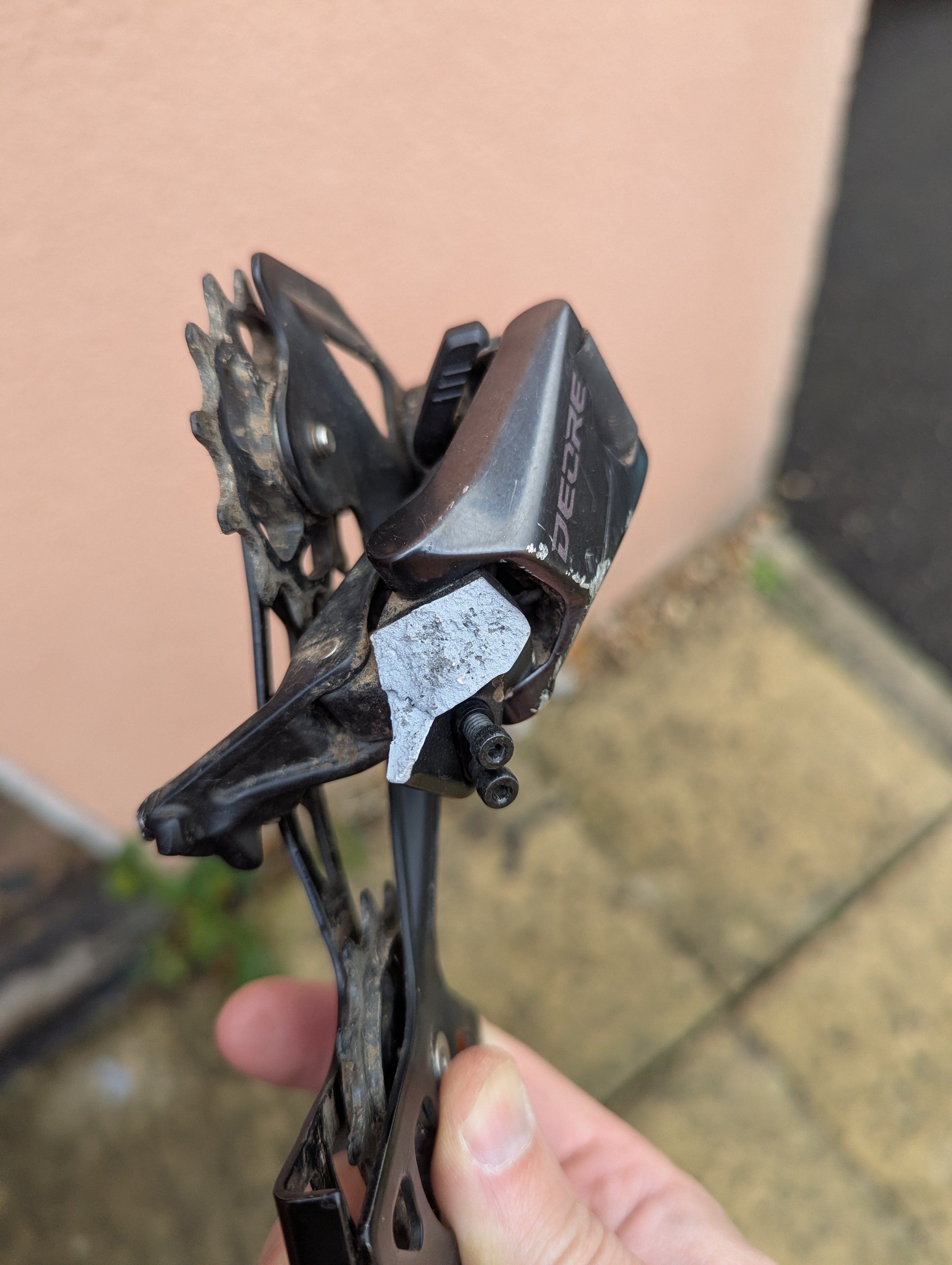

Upgraded to 65mm stroke on the rear recently. All cushty until today when the derailleur snapped (Deore). Wondering if I needed to lengthen the chain when increasing rear travel? Anyone else done this?
Ooof! Not nice.
Had a similar incident with my Norco a few years back (caused by loose rear axle I think) rear mech got caught in the spokes and got pulled around. Damage to your seat stay looks familiar. Hope it doesn't turn out expensive to fix.
Running 65mm stroke on my EXe and not had a problem, but maybe I've not happened to use full travel on the big sprocket.
