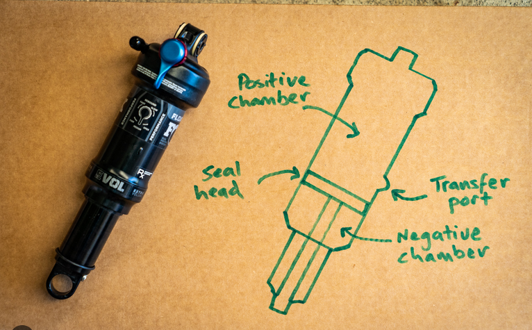

So, today I let the air out of my suspension and pumped it back up the recommended way, by cycling the suspension a couple of times on the way up to the recommended PSI, to get air into the negative side. It made a big difference on the small bump sensitivity. Because of the rain I was only able to take a fire road with small bumps in it. But, my guess is that it will also help with the medium bumps. So, right now I’m a lot more happy with the suspension.

Not sure if it's placebo then? It should even itself out even if you don't pump it up that way after a while. It is just that the port is located a bit into the travel and if the negative chamber is low pressure you will have a harder time cycling it but jumping on it a few times should get you there. Feels like shit at first and then get more and more normal.

Well, no to be blunt. The negative and positive chambers will ALWAYS equalise and be at the same pressure at X% of travel. If you pump up the fork without cycling it you'll just end up with 10 - 15 psi less than intended after a few compressions.
Well, I actually know a lot about dirt bike suspension, having being a Pro Open class motocrosser. And, I also know a lot about setting cars up for canyons. It took me a while to figure this out in my brain. My suspension knowledge is a little rust. But, here’s what happens, If you don’t cycle the suspension to get air into the negative spring. It does get in there, like you said. But, it drops the PSI down after you’ve put air in and pulled the pump. Then you have more than you need on the negative side. So, then the suspension wants to blow though the initial part of the travel. The initial part of the travel soaks up the small bumps. The negative side needs to be a certain percent of the positive side. That’s achieved by cycling the suspension from the get go. I could feel the difference, in the garage, before I even got on the bike, by just pushing down on the suspension. With your idea, it’ll blow through the initial stroke and won’t want to ramp up at all in the mid stroke. That whole senerio also really affects the rebound side. So what you get is a really dead feeling suspension that doesn’t want to flatten anything out. Most people feel that Fox’s PSI recommendations are too high. But, that’s exactly why they recommend the pressures that they do.
It's just a dimple in the can that makes it equalize. No rocket science. It will equalize. On the picture here it's marked with "transfer port".

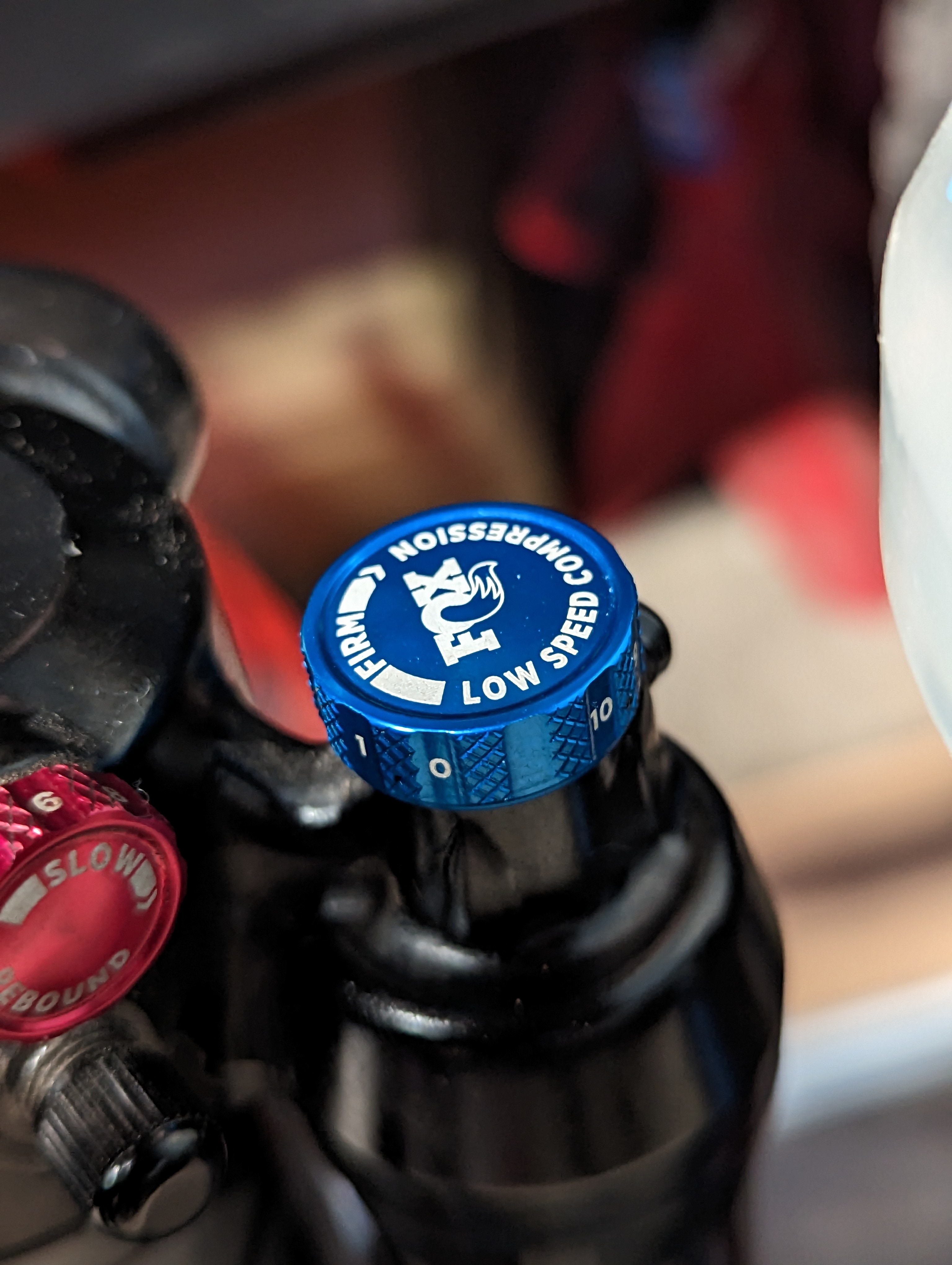

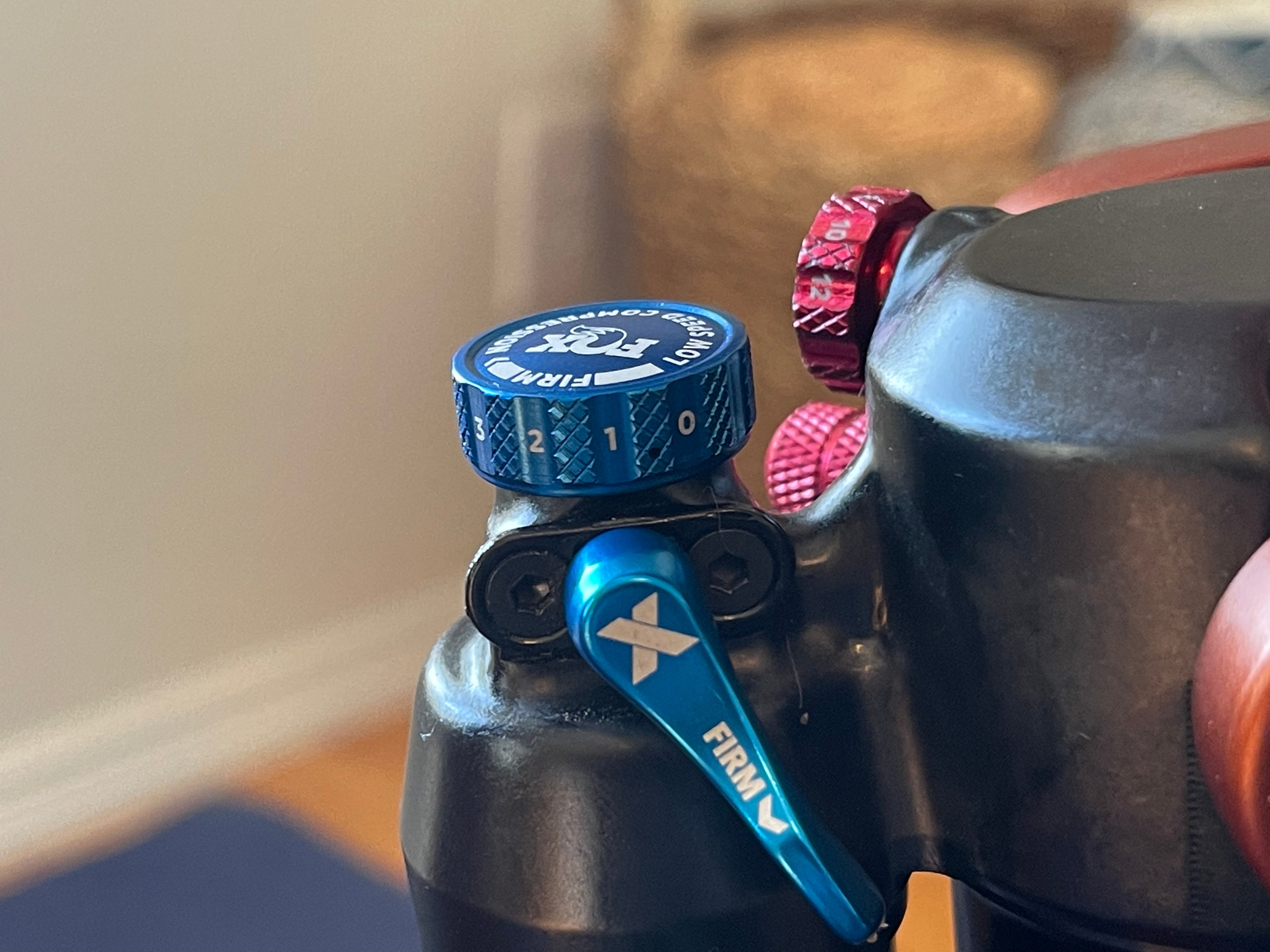

So, my girlfriend ordered the LSC compression adjuster kit from her bike shop for the Fox Performance Float X shock on the 9.7. I’d pass on how much it was, but I get everything at wholesale prices. So, I have no idea how much they are. Freeing up the LSC helps soak up the small to medium rolly type of stuff. For those of you that don’t know. This shock comes with a plastic cap, where the LSC adjuster comes on the more expensive Fox shock. So, you can take that plastic cap off and install the LSC adjuster kit that comes from Fox. That kit part number is: 808-17-470-KIT.

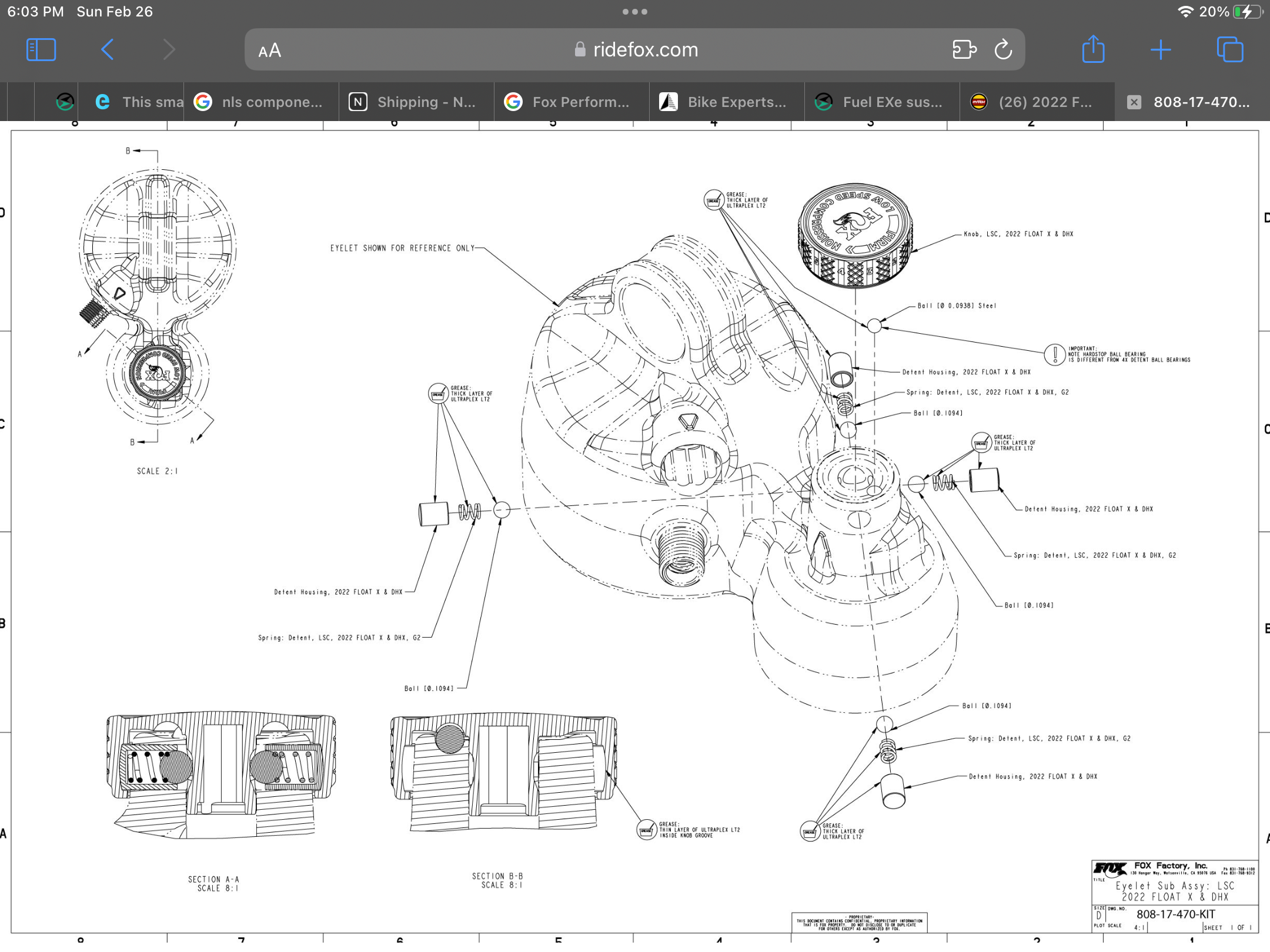

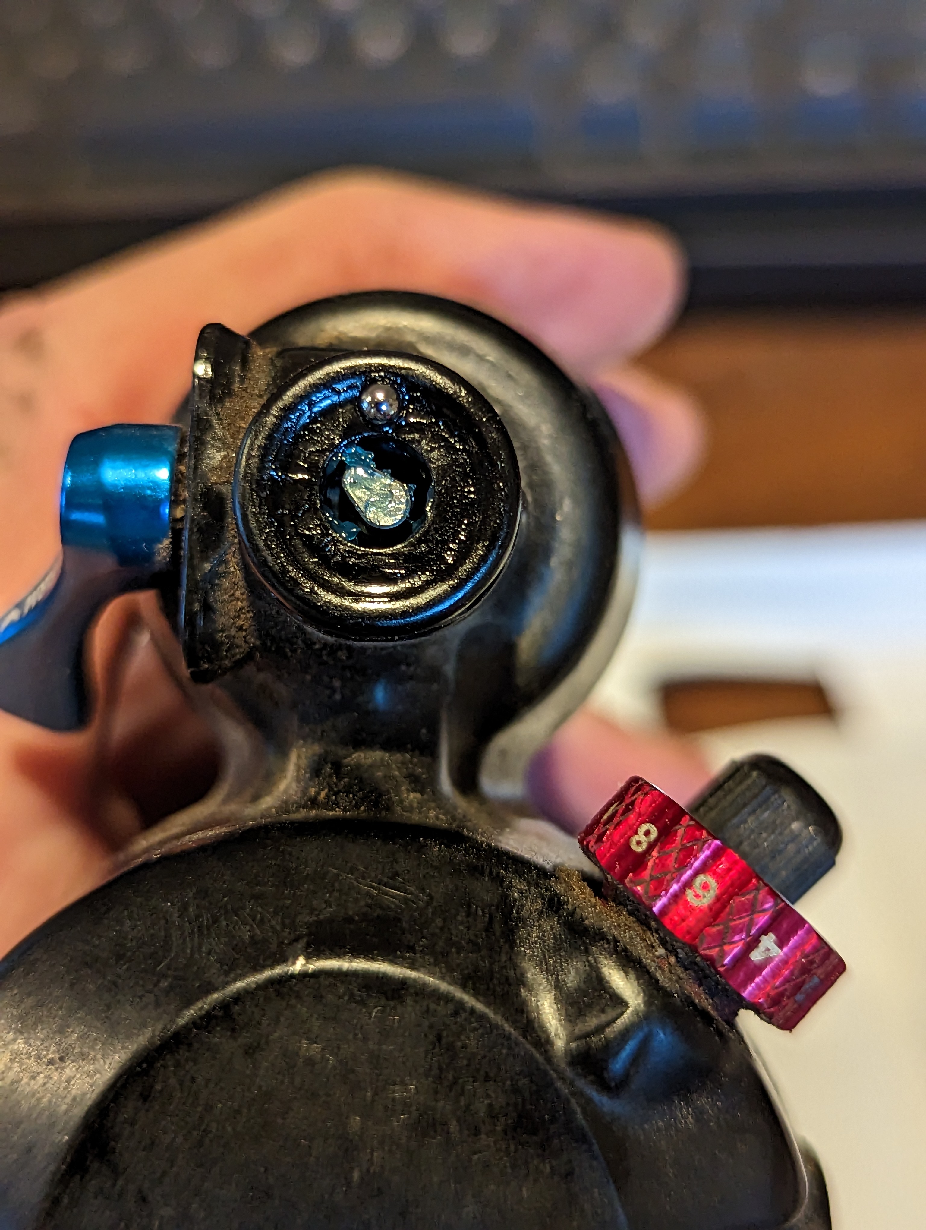

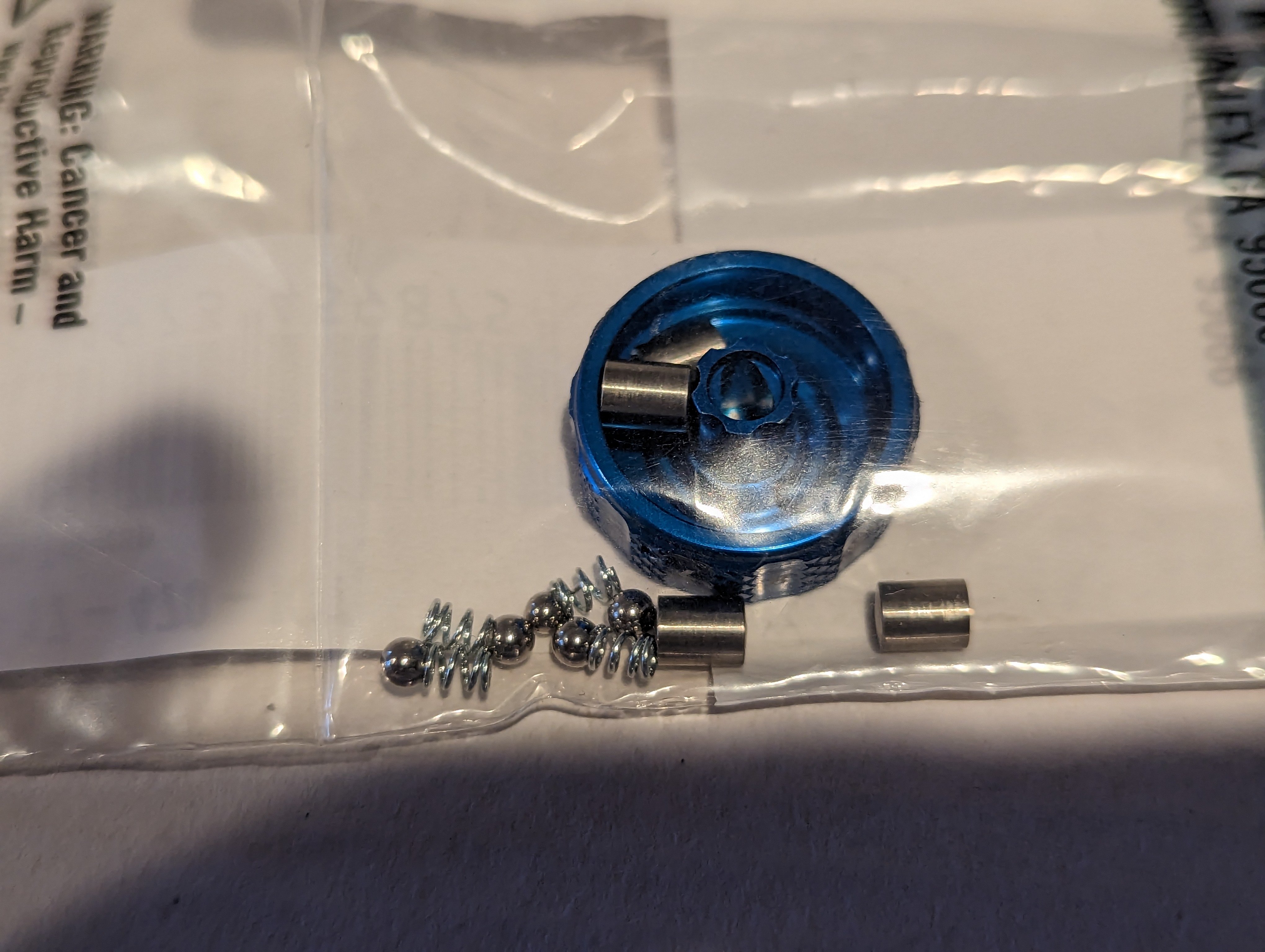

I installed the LSC adjuster kit today. It’s super easy, once you realize not to push in the collar/spring/ball bearing assemblies all the way in the holes. You have to leave room between the four ball bearings and the adjuster shaft, so the blue adjuster knob can slide over the adjuster shaft. Once the knob slides over the shaft, you can push the assembles in two at a time with your fingers, tilt the knob over them and repeat that with the other two assemblies. I used a little Finish Line grease to hold the collar/spring/ ball bearing assemblies together and in the holes. It goes grease on the spring, put it in the collar, put the ball bearing on top of the spring, push it in and install that assembly, ball bearing first into the hole. The kit comes with 5 ball bearings. You won’t need to use the one small ball bearing, as that size ball bearing is already under the black cap. It’s that ball bearing the stops the adjuster knob at full open and full closed. Without that ball bearing you could just keep spinning the knob around and around. The factory setting is 7 clicks open from full firm. So I can open or lighten up the LSC another three clicks. I was hoping that I could open up the LSC a little more. Because, this bike just doesn’t bob under pedaling loads at all. So, I’m going to leave it fully open and I’ll see what it feels like tomorrow. This is a picture with the adjuster in the original position, as it was under the black cap. I also included a diagram, so you can see how everything works.
Received and installed the LSC knob kit to convert the Float X to a Float X 'Elite'. Couple of observations. The plastic cap can be rotated to four positions in 90 degree increments to change the LSC on the the Performance as is- it is set to full open from the factory. When you pop the cap off you will see the keyed shaft and ball detent. My advice is do the conversion on a tray of some sort as there are a number of very small parts that can get away from you. Grease is your friend holding the springs, detents and balls in place.
The trick is to not push the four detent assemblies into the bores in the shock very far. The balls prevent the cap from going in if you do. Once the blue cap is indexed to the key on the LSC shaft you can push it down against the detents and slowly start pushing the detents in under the lip of the cap. If you apply constant pressure in the LSC knob its pretty easy. Once the cap finds the groove its probably on there forever.
For $30 all in with shipping and tax this was a worthwhile experiment.
