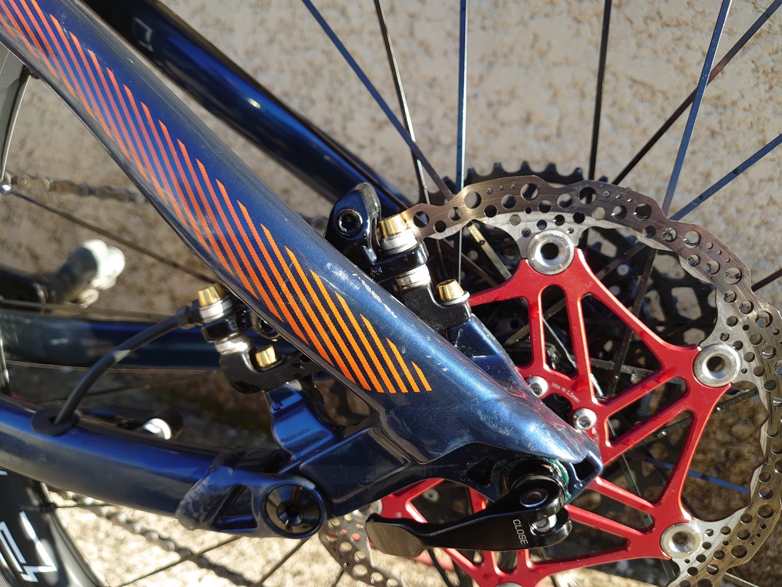

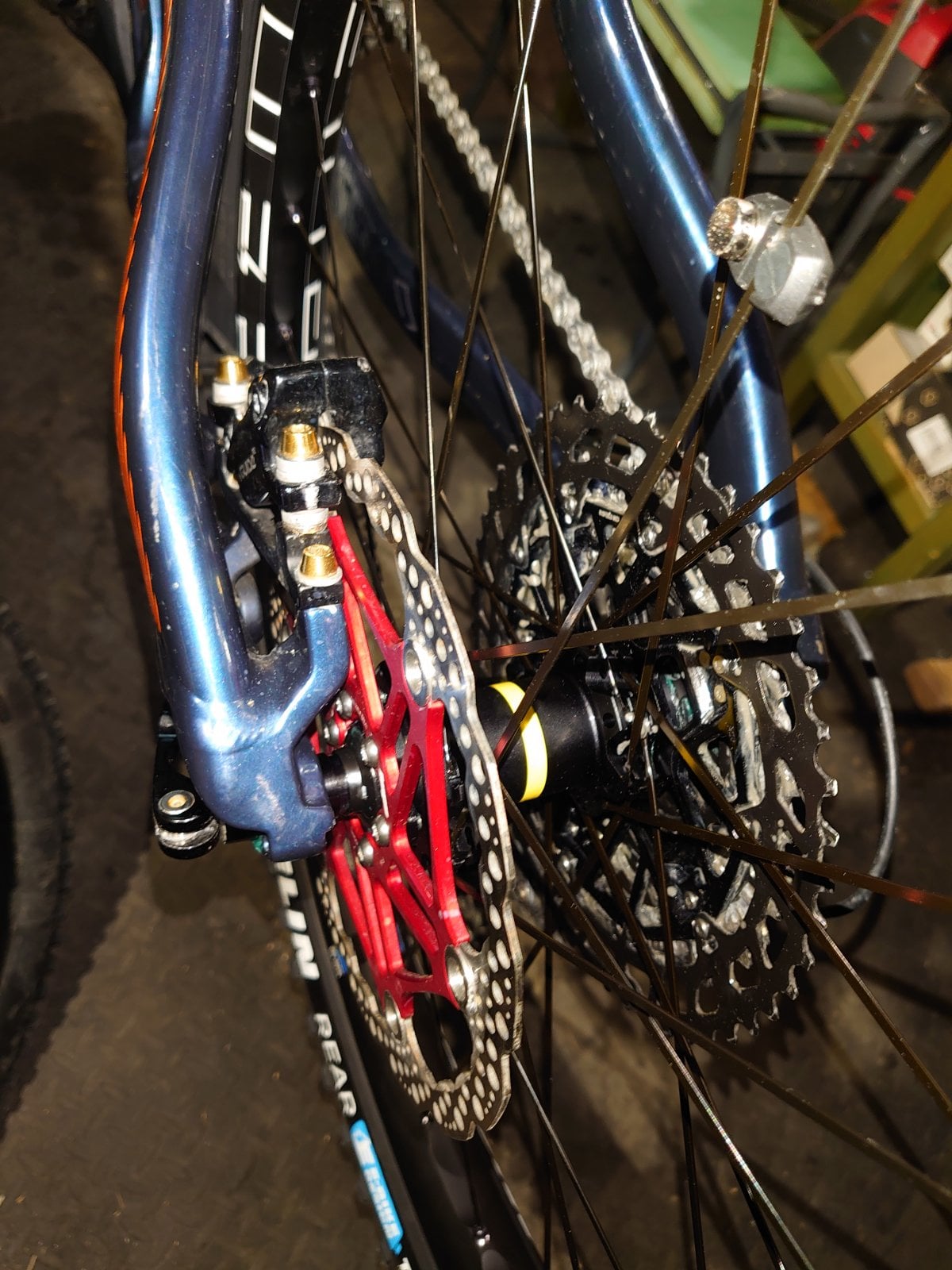

C'est peut-être évident ici ... mais j'espère que les rotors flottants de 200 mm ne sont pas compatibles avec Sram Guide R ou RE. Je viens de découvrir ... dommage ... de belles choses .
[ATTACHER=complet]63802[/ATTACHER]
[/CITATION][/CITATION]
si quelqu'un réessaye, il semble que celui de devant fonctionne mais que celui de l'arrière ne soit pas bon.
[/CITATION]
avec quelques rondelles

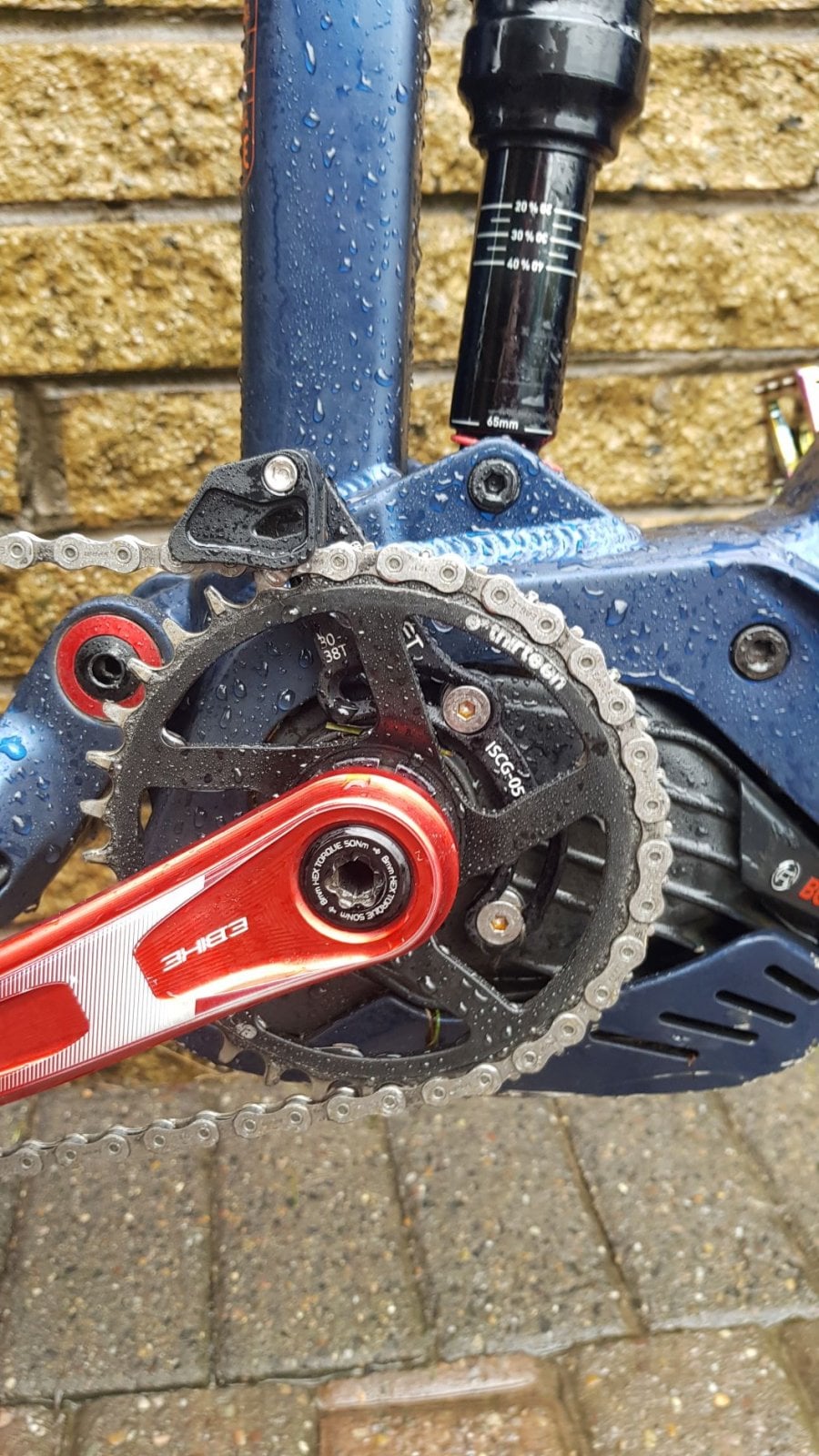

I have started having issues with chain dropping off front ring, I replaced front ring with E13 narrow wide 34 tooth, all ok for first 350 miles, but ever since on fast downhills chains drops every time if ground is rough uneven. There goes all my KOM attempts lol. Does anyone else have this issue, i think it may be the E13 chain ring, as derailleur as just been changed again now on Shimano SLX and chain is new also and still it drops the chain. Is there any chain device that can be fitted?? I tried the old fashioned DIY chain device fitted to chain stay and it made no difference at all.
Hi
I would first, try to shorten chain and test it. My chain never dropped, even on rough terrain downhills.

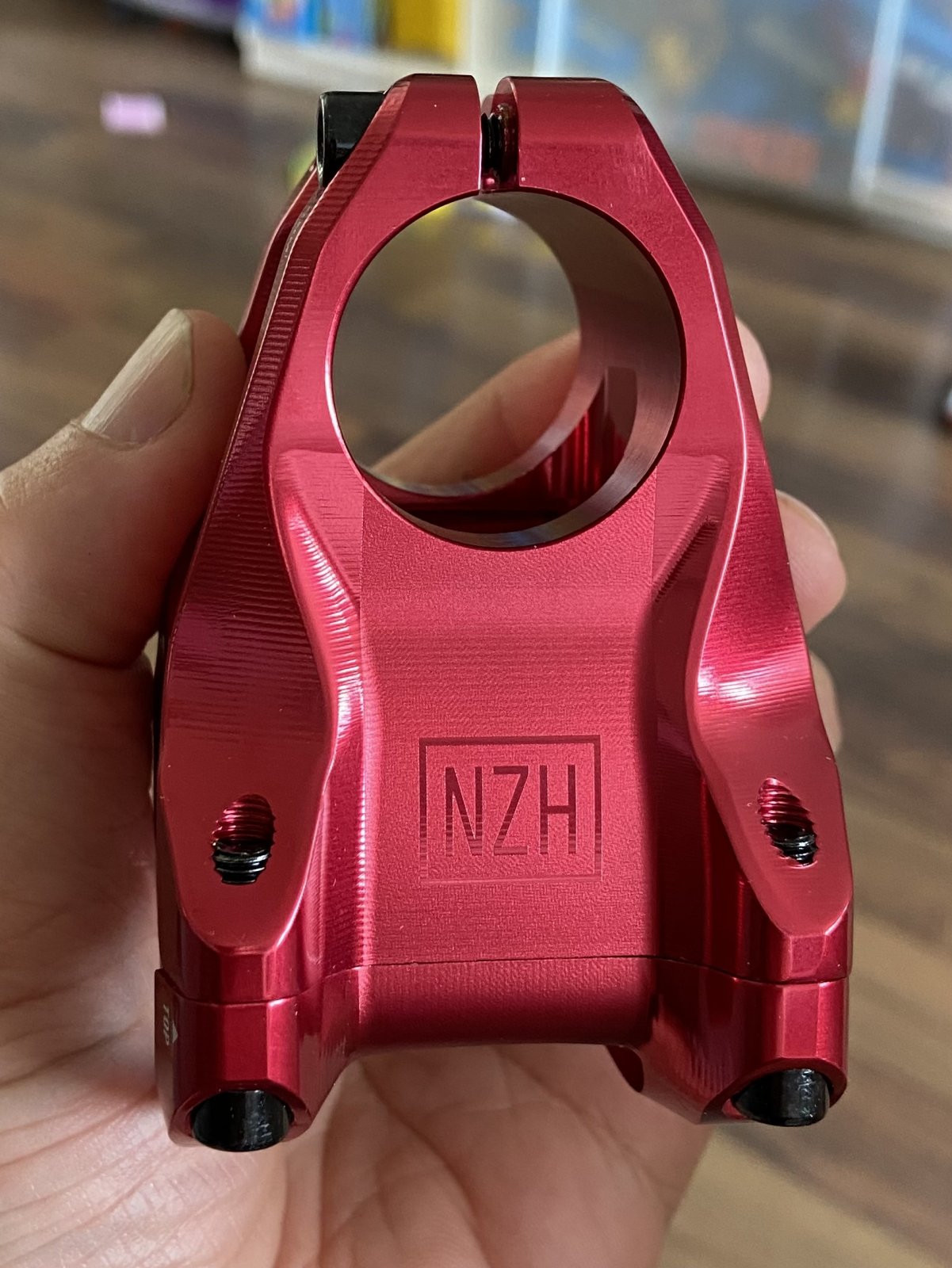

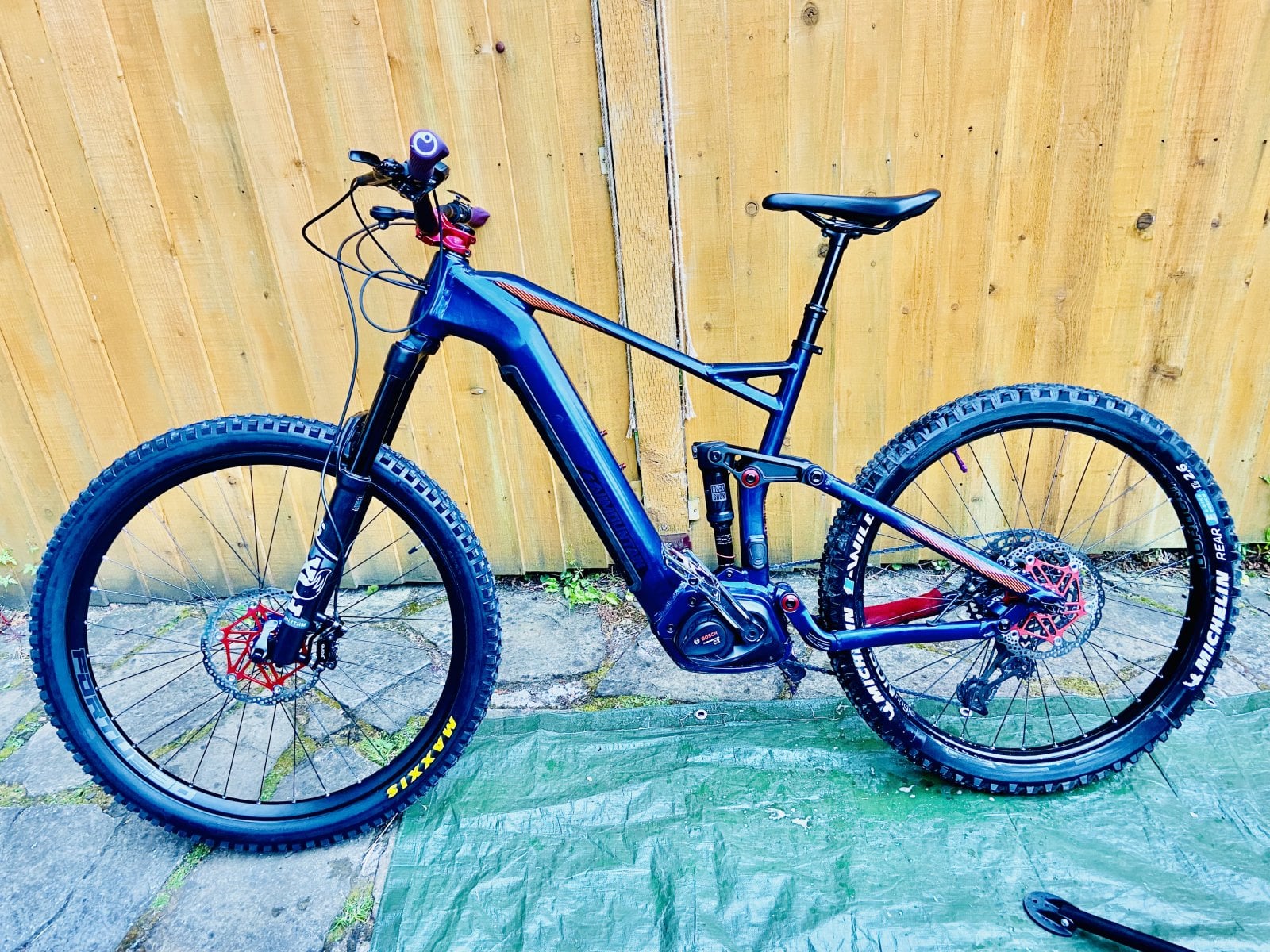

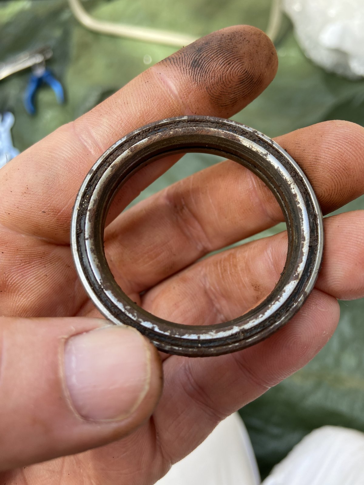

finally mulletted. Got a ghetto stem with horrendous bearings at the mo. See pic of lower bearings, tried to refresh , but they fecked. Nukeproof stem , fox rhythm 36 fork, hope fortus 30 front wheel. Reach feels very different , less height due to slightly too short steerer tube, front end so much lighter. May have try higher raised bars .
Update

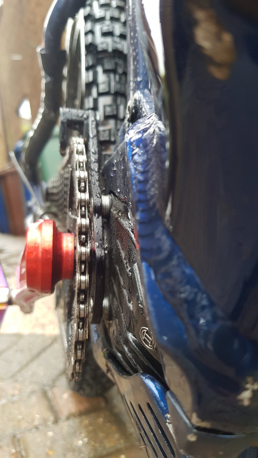

Just been informed that all bosch gen 4 motors have a bolt mounting to fit a chain device just situated behind chainring. Happy days..
Chain device fitted bolts straight into bolts on drive side of motor they are already threaded isg mounts bolts. i had to use 4 washers to get correct spacing. Not dropped a chain since install.

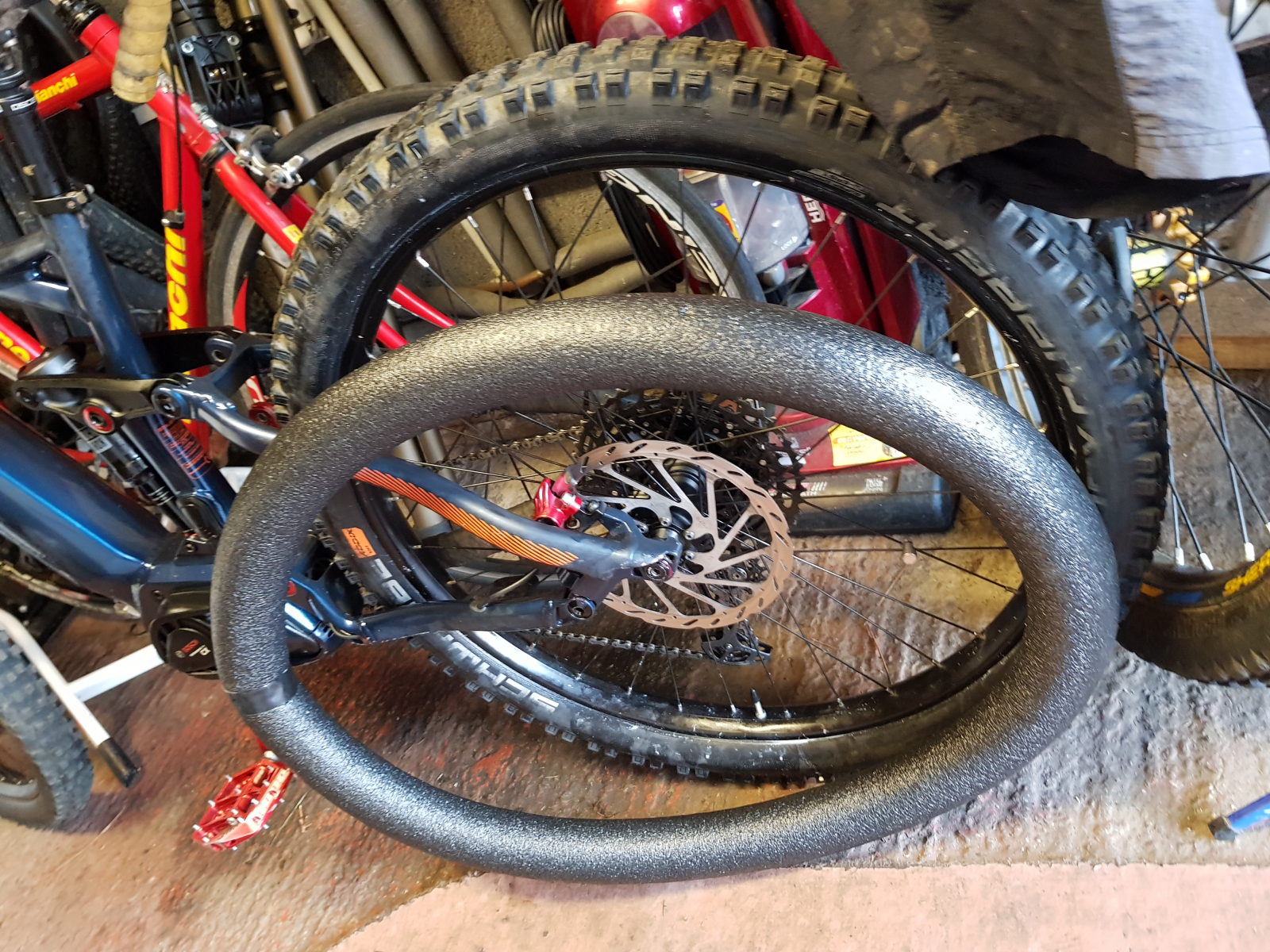

just fitted the below Tyre insert into back wheel , it was a tight fit but went on eventually.. got x 2 of the foam inserts and 2 tubeless valves from planet x for £9.99. Have not ridden it yet to give update on performance..
