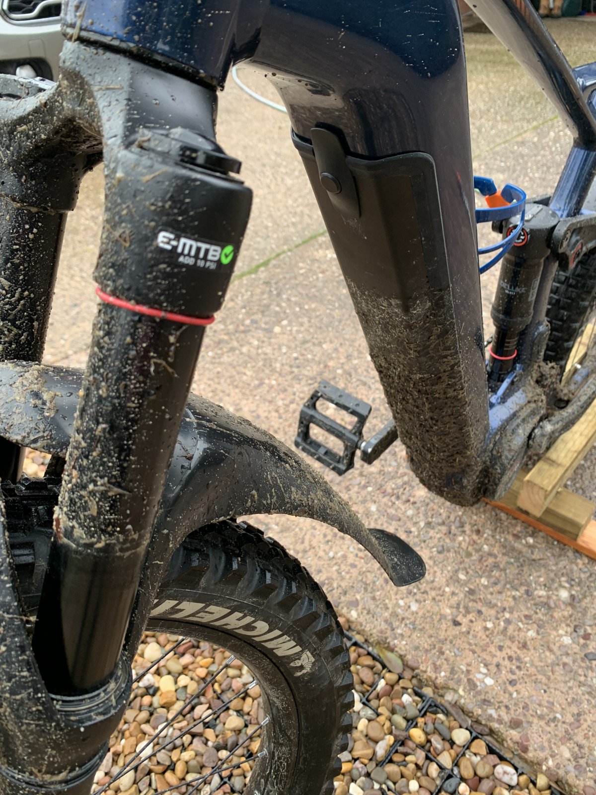

Done around 1200 miles on my Stilus all off road mud sweat and gears, upgrade list or broken parts list take your pick.
Hope e 4 brakes
Shimano deore derailleur
Ladies MTB seat of wife's old bike( it is well comfy)
Eddy currents Tubeless lasted 1000 miles still got loads of life left( a bit hard on the rocks)
Deity grips
Pedal upgrade
Forks fully serviced straight after purchase, as they were super stiff and sticking, ok now not the best forks in the world but stiff enough.
Head bearings fell to pieces(replaced at 700 miles)
Motor upgrade to 85 nm.
View attachment 47704View attachment 47705View attachment 47706 and shifter.

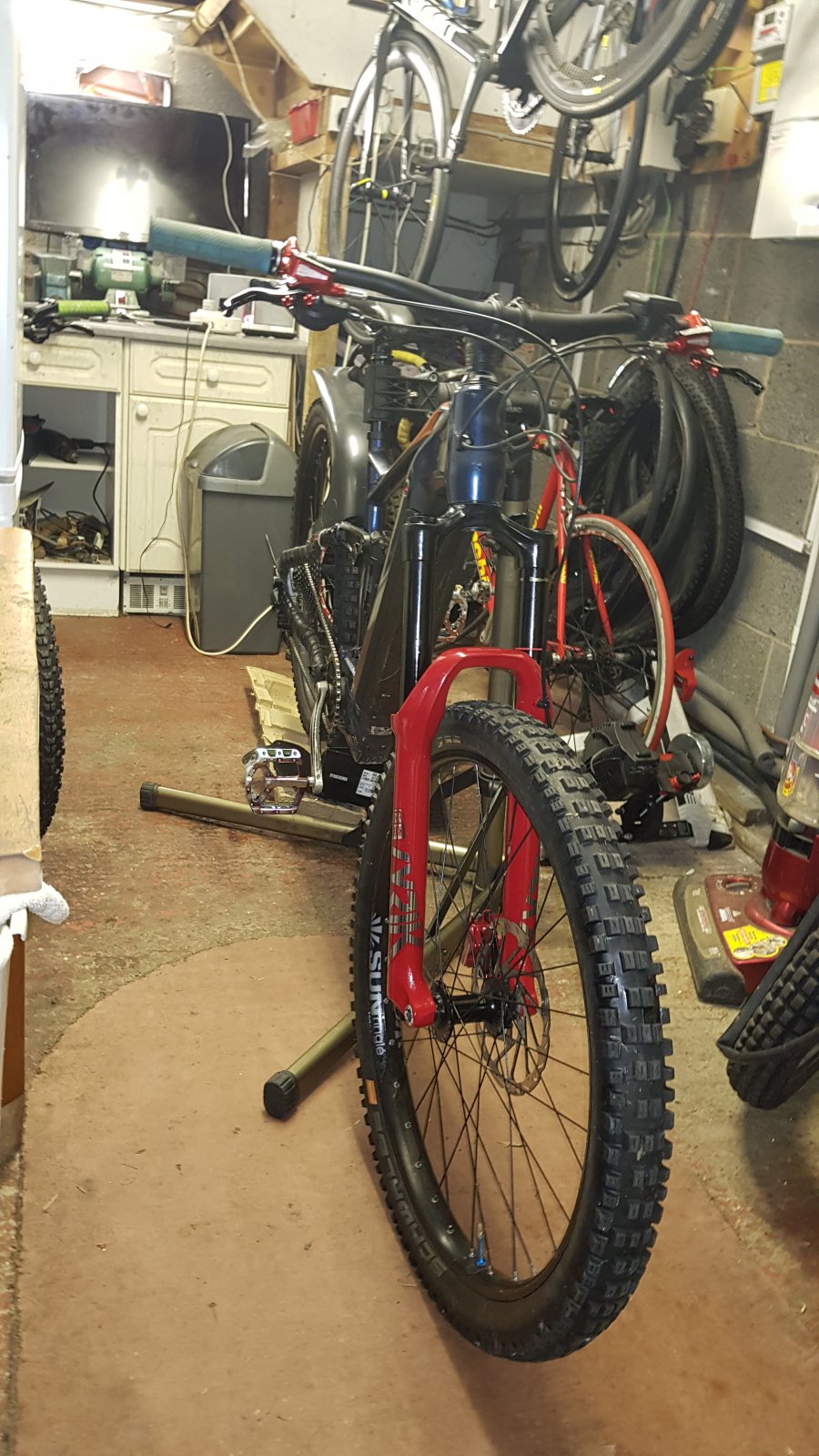

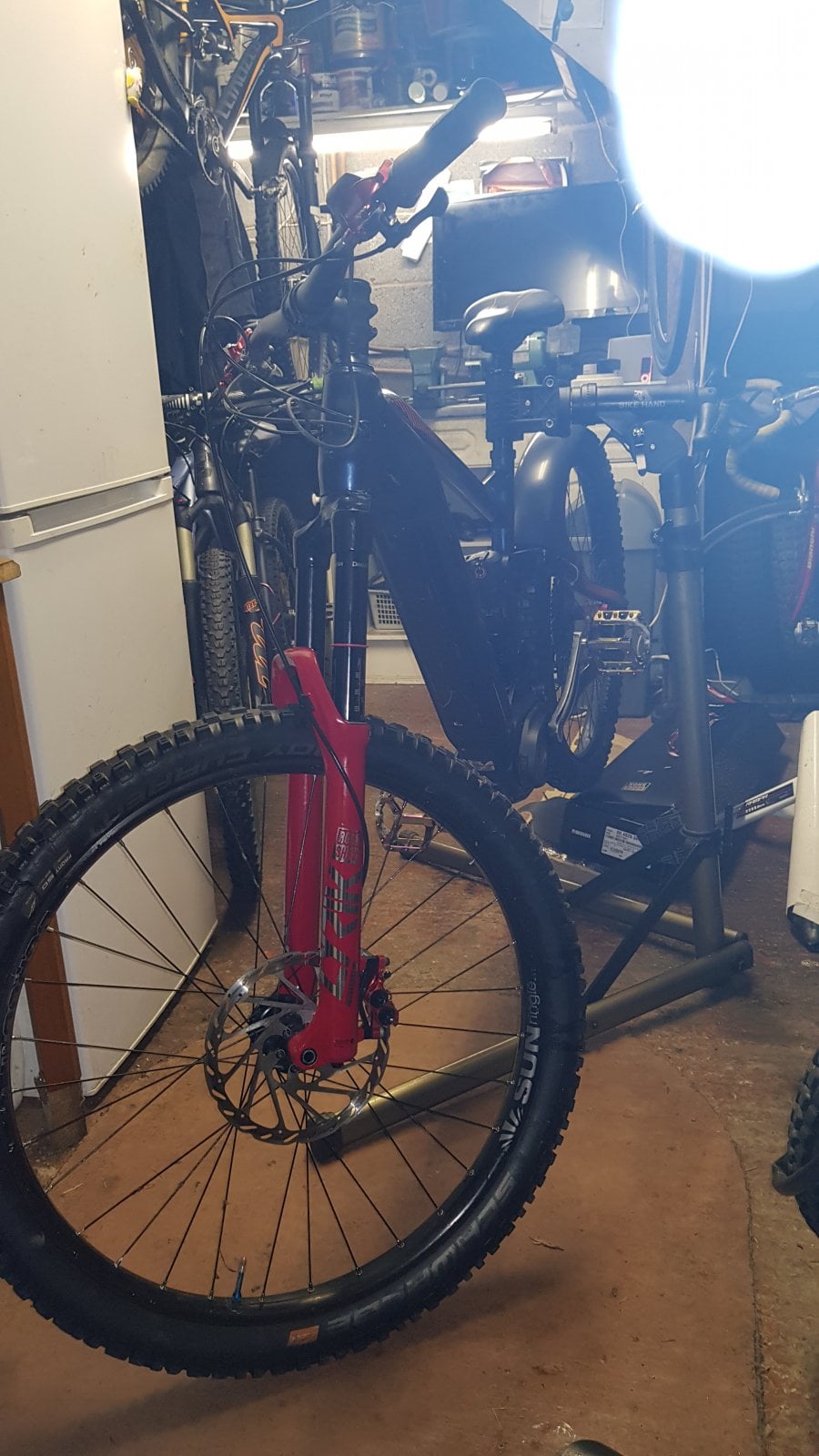

Latest upgrade finally bit the bullet and purchased some brand new Lyric ultimate in 170mm 29, look's a bit slack on head angle now, not ridden it yet or fitted the 29 wheel. That back mudguard looks a bit shitty though may have to come off.
Latest upgrade finally bit the bullet and purchased some brand new Lyric ultimate in 170mm 29, look's a bit slack on head angle now, not ridden it yet or fitted the 29 wheel. That back mudguard looks a bit shitty though may have to come off.View attachment 51220View attachment 51218View attachment 51219
Got the same back mudguard which in fact I have extended. Resonates with my Trail bikes which I suspect lurk in your garage judging from the trials tyre peeping out from the corner.
PS Just realized I have routed brake cable incorrectly DOH,.
Did the same when I swapped to the Yari. You'll have to tell us how it rides, I can only imagine it'll be a whole lot better than the 35.

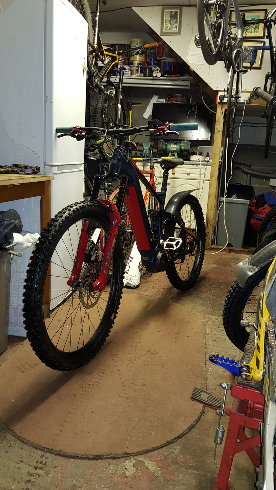

First ride on new forks last night in dark quagmie conditions
Sorry try again, first ride on new forks last night in dark in quagmire conditions, and yes the difference between lyrics and standard 35 is night and day. I forgot what it is like to have suspension this smooth and actually see the forks moving. My 35 were rock solid but I had got used to them, will the new forks make me faster or jump further and bigger the answer is no. But the ride is so much smoother now it feels like a different bike. do you need to make this upgrade no not really, it depends on how much you ride your bike i suppose, if you spend hours every week bashing around local trails, then yes you will benefit from fork upgrade just for the extra feel and smoothness of ride. I just need to keep my wife out of garage now before she realizes I have been spending on that E bike again. LOL
Cheers Lordy, sounds like it mirrors my experience. No amount of setting up the 35 really worked for me & most rides felt like I was having my fillings rattled out. The Yari I picked up cheap & gave a full service with new oil & seals all round & I'm finding it yards better. It's only 150mm travel & I a running it at higher psi than my trail bike fork to account for the weight of the Stylus but even then, the improvement over the 35 is obvious every time I clamber onboard.

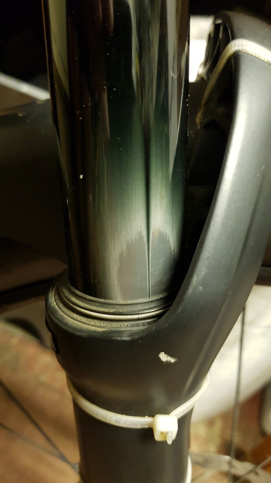

I had my forks fully serviced after 200 miles has they went stiff at LBS, they did get better, but see attached picture of right stanchion , this happened over a 2 week period and fork now has a flat spot. i have sent to decathlon regarding a warranty claim awaiting a response. Done 12:50 milesView attachment 50606View attachment 50606
Fork Update. Decathlon have paid me £400 to put towards a replacement fork, they did not want to replace the 35 original as they were not confident that the same thing would not happen again. I am happy with the outcome.. PS My seat post has broken now and is irreparable, I had it fixed first time with a new part at cable attachment at bottom post. This time the plastic components have completely worn away, i have replaced with 150 mm BRAND x post very good so far. Do I dare go for another warranty claim??
Fork Update. Decathlon have paid me £400 to put towards a replacement fork, they did not want to replace the 35 original as they were not confident that the same thing would happen again. I am happy with the outcome.. PS My seat post has broken now and is irreparable, I had it fixed first time with a new part at cable attachment at bottom post. This time the plastic components have completely worn away, i have replaced with 150 mm BRAND x post very good so far. Do I dare go for another warranty claim??

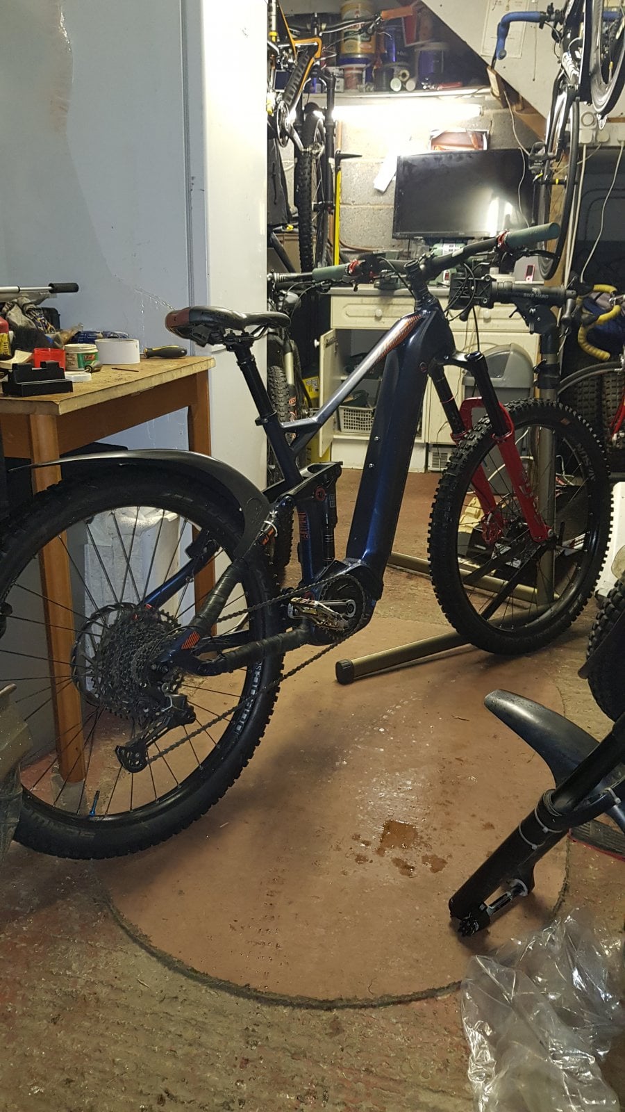

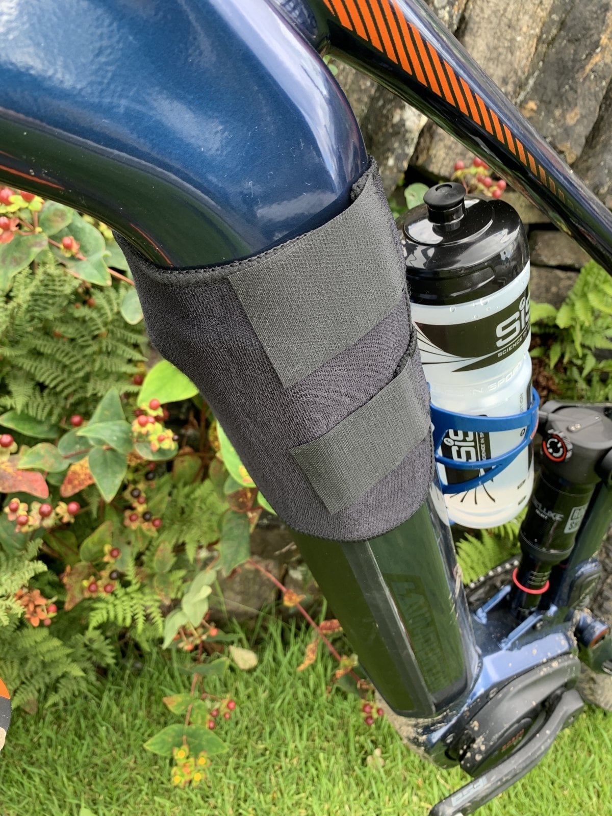

Mullet conversion completed. Wheel of Scott genius, tyre magic Mary 2.6, went straight in no caliper adjustments needed. I can pick wheel size to suit planned ride now.. Bit of red covering on battery guard to cover all scratches from dropping onto fences and gates. I will refrain posting pics for a while, I have been monopolizing the tread. any one tried a 220mm Rotor yet?
