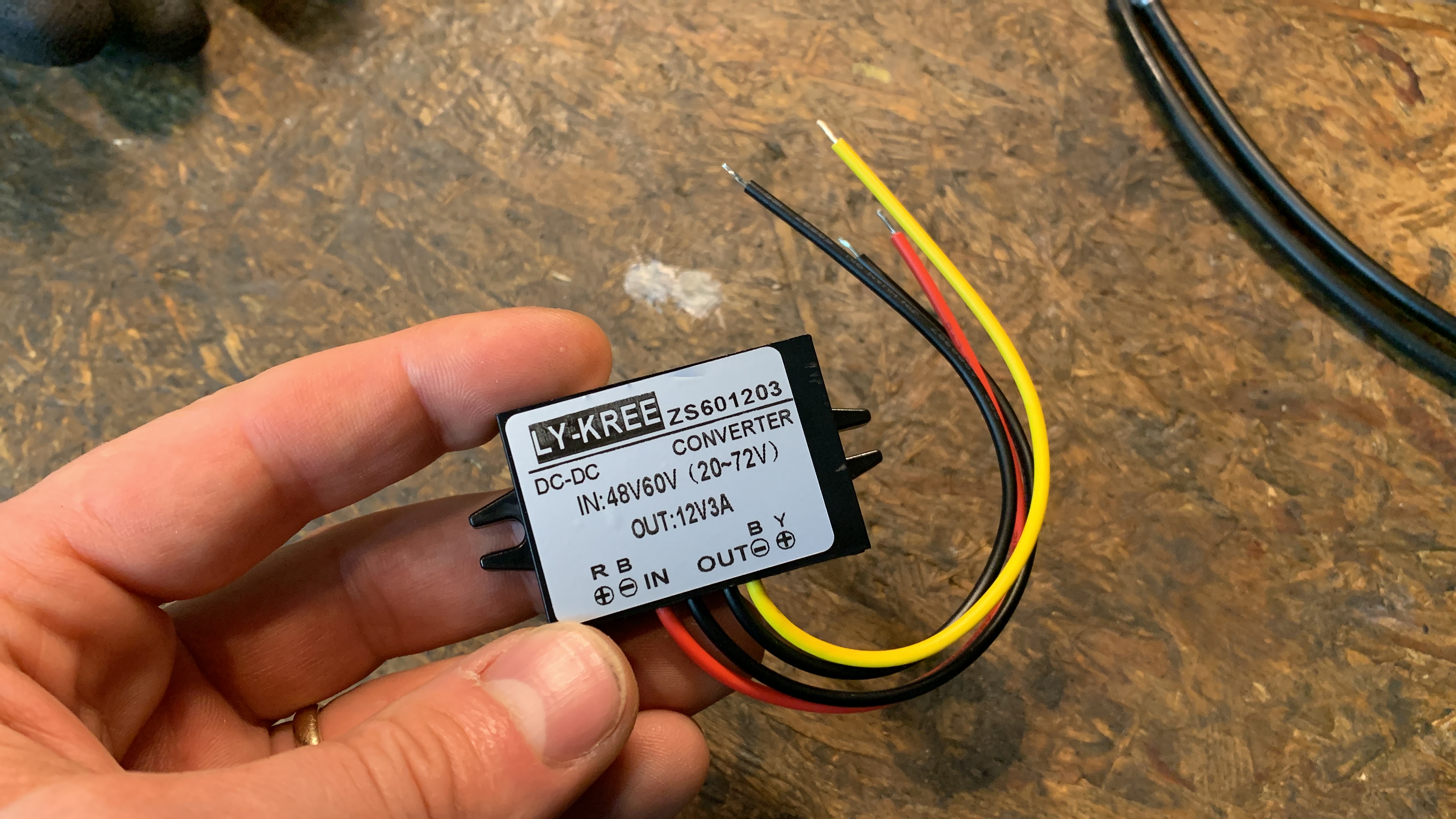

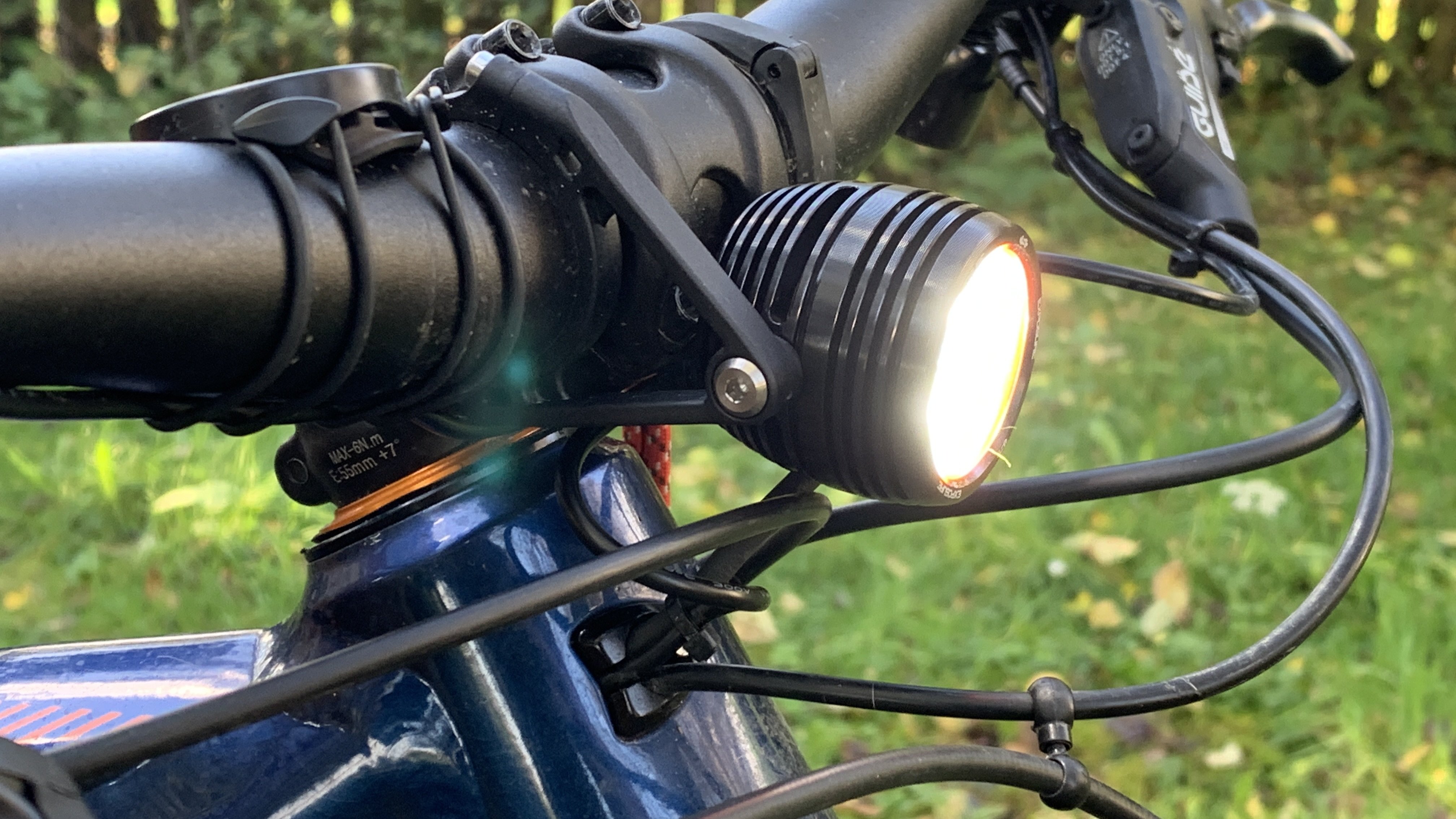

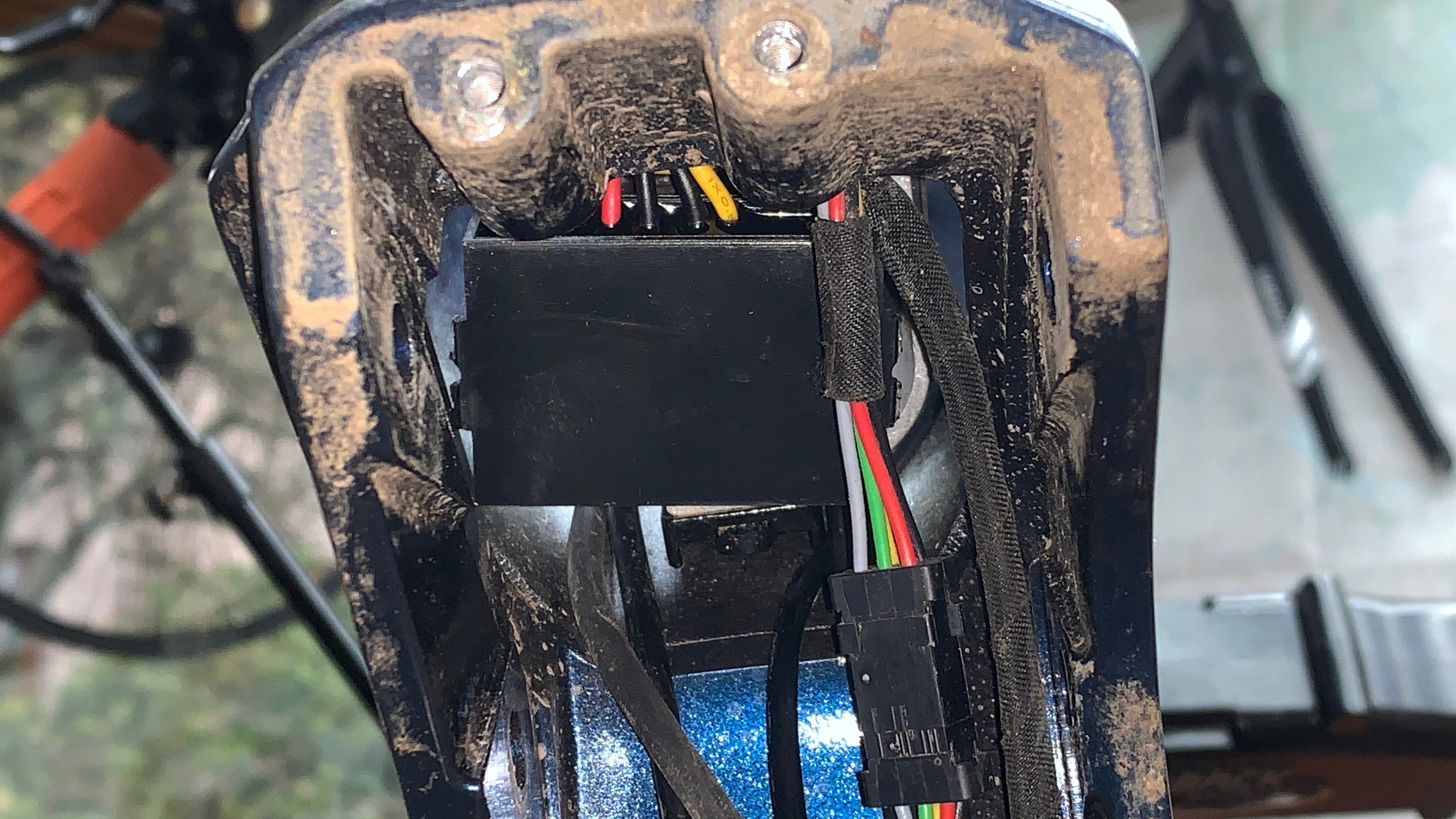

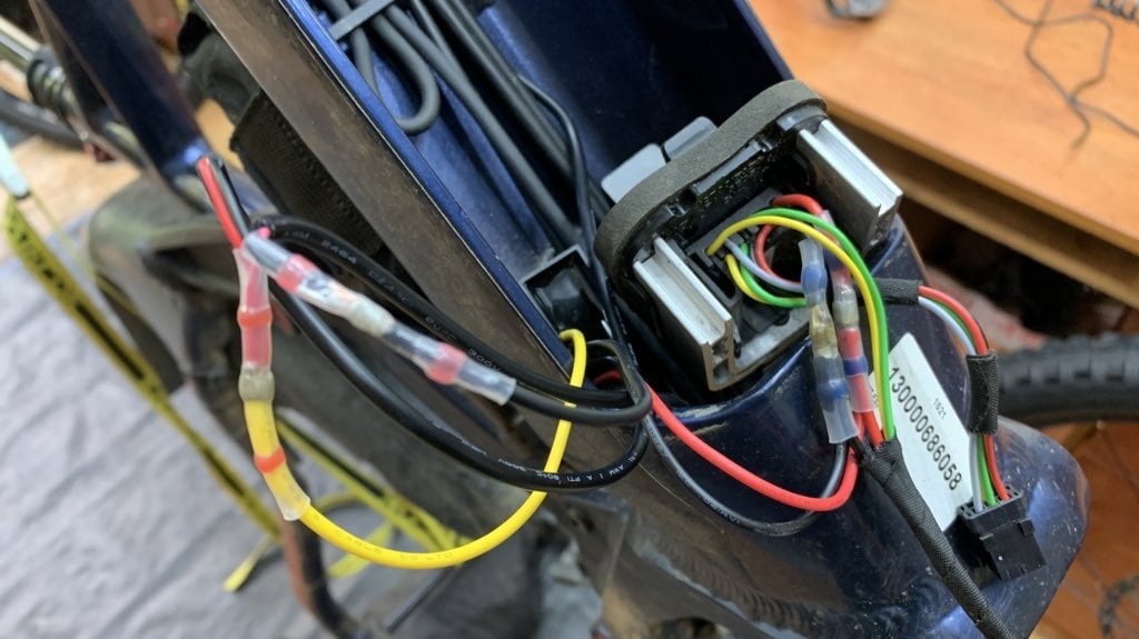

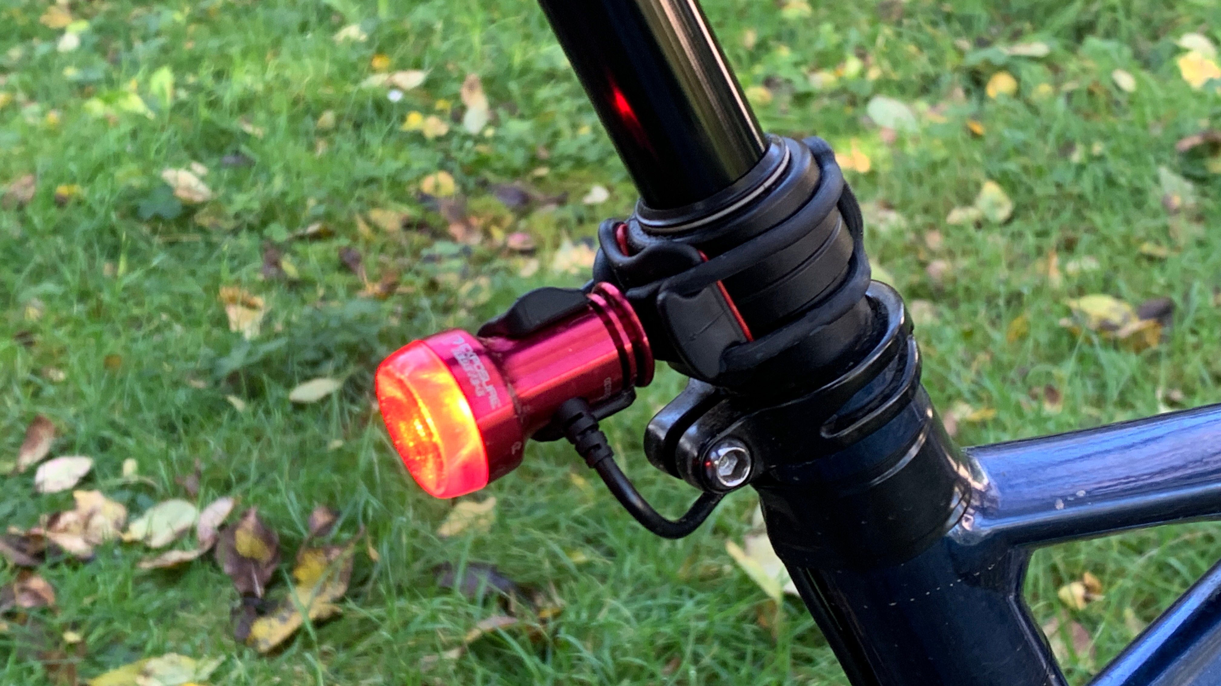

Fitted an Exposure Flex light and tail light, wired directly into the motor feed. Used a 36-12V 3A Buck Converter and some solder connectors. Buck Converter fits nicely under the battery connector. Confirmed that the light now draws the full 1.8A to give 3,300 Lumens. Turns on and off with the bike as the bty output gets enabled/disabled. The rear LED is always on, no biggie, the front can be turned off with the Exposure remote on the bars.
A bonus is that when you're charging, the red taillight comes on - but once charged, as the charger shuts down, so does the light - so it's like having the World's Largest Charging LED indicator :cool:
Used solder-waterproof connectors, they just need a heatgun (I used a gas soldering iron with a hotair tip) to flow the solder.
All in all an easy-ish job, with a bit of planning, measuring and careful cutting. There's actually plenty of room under the battery connector for wires and connectors. Will be 3M VHB-taping the converter to the underneath of the mount once the patches arrive.
By going direct to the 36V you get 3,300 Lumens instead of the 2,500-ish usually available with the 1.5A max out of the front light port. At full power measured light draw 0.6A at 36V, and 1.8 on the 12V side - near totally efficient downconversion.
And critically, no loss of 10% range, becuase the light ports aren't used :)

Top job mate. but not for the faint hearted or those bikes still under warranty.

Yeah it’s a pro job, pretty much.
Re affecting warranty, that’s a good question. If the motor bearing failed, or a remote or display stopped working, there’s no chance it could have been caused by this mod. If you were really panicked, you could swap out the wiring before sending it in.

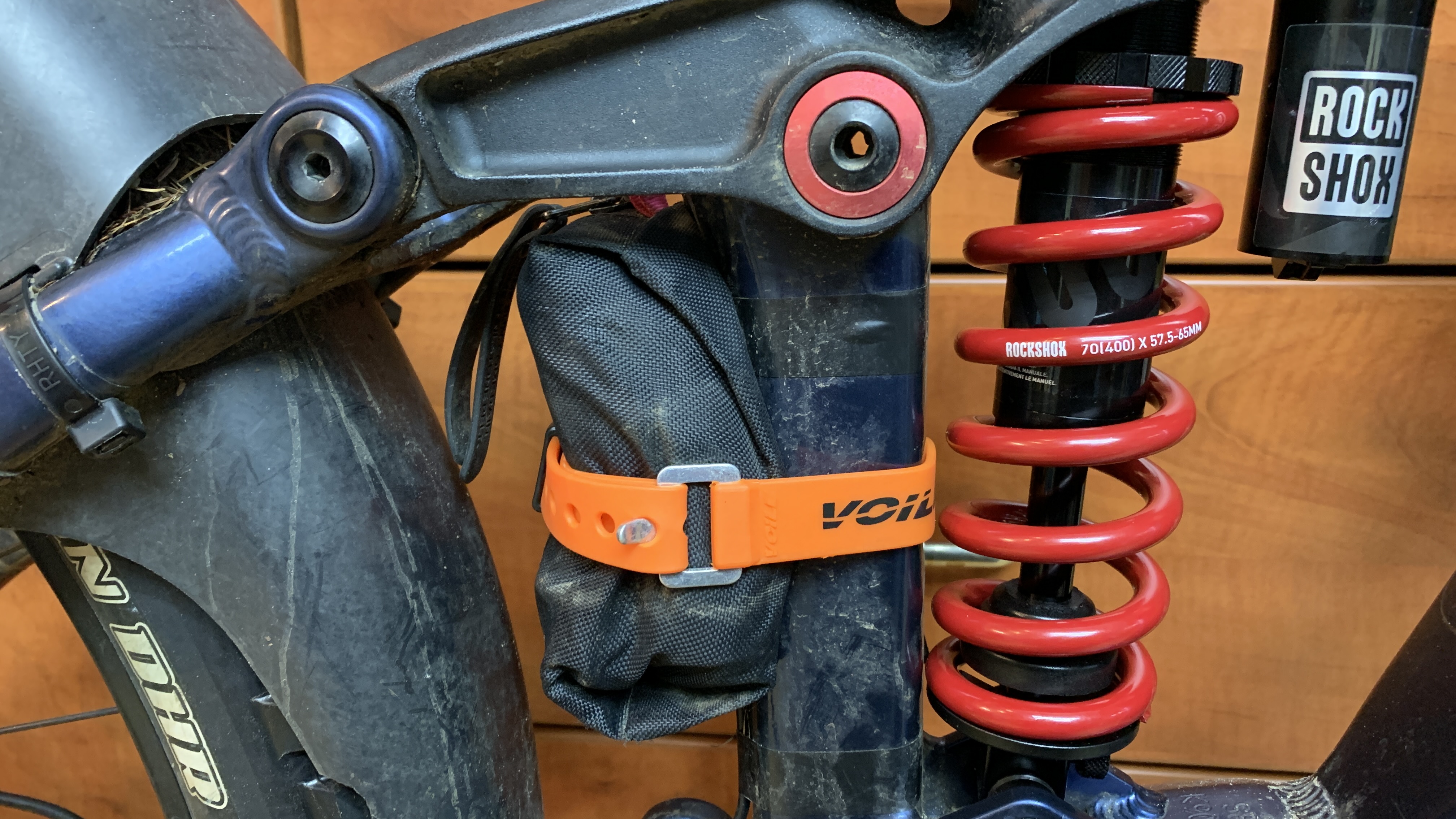

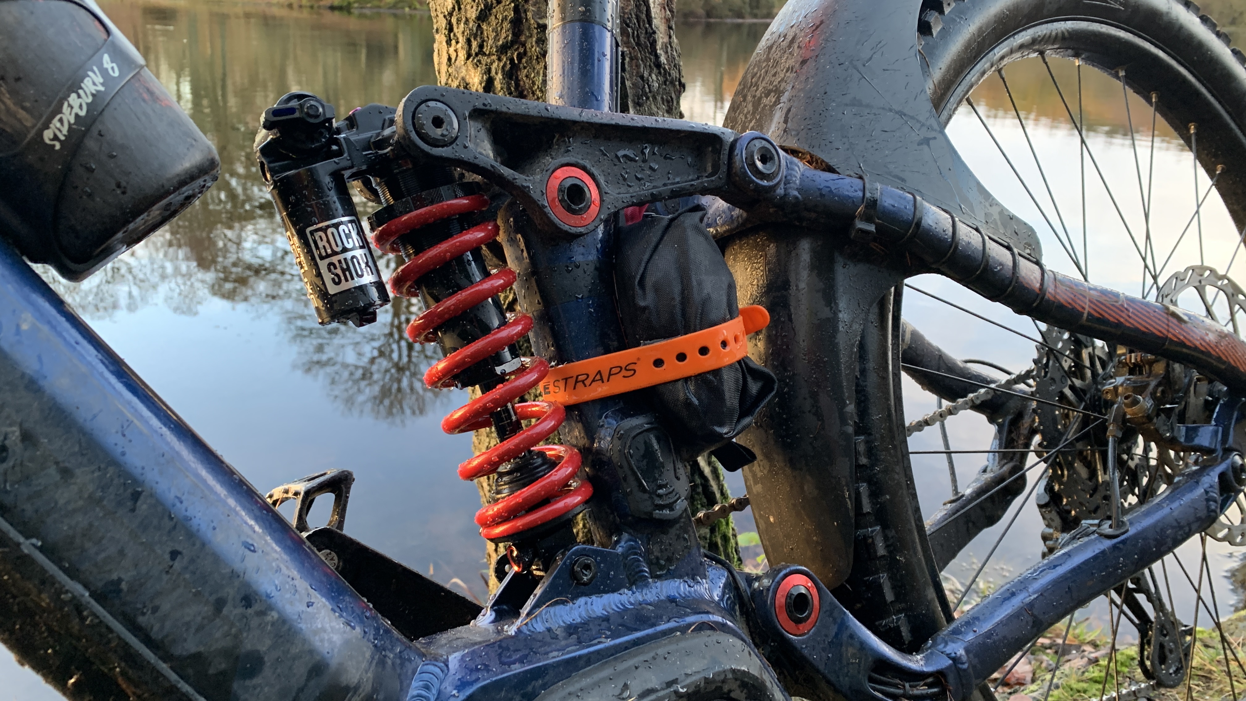

First ride on the 2023 Super Deluxe Ultimate coil - WOW. Over chattery gravel and small roots the bike feels like a hardtail on a newly-tarmac’d road!
Climbing over big rocks, felt utterly planted and grippy like never before.
And the first half of the descent was likewise unreal.
The fact I washed out the front and now have a separated clavicle and two months off the bike isn’t the shock’s fault 😬
So won’t get to play with all the settings for a while - but with everything set in the middle, it beat the pants off the Deluxe air, as you’d expect. It’s a Linear tune.
Fit-wise went on easily, but there’s zero clearance at the bottom between the coil and seat tube. I expect if the coil settles back it might rub the paint a tiny amount, but really don’t care. As the suspension progresses it moves out, so no bother.

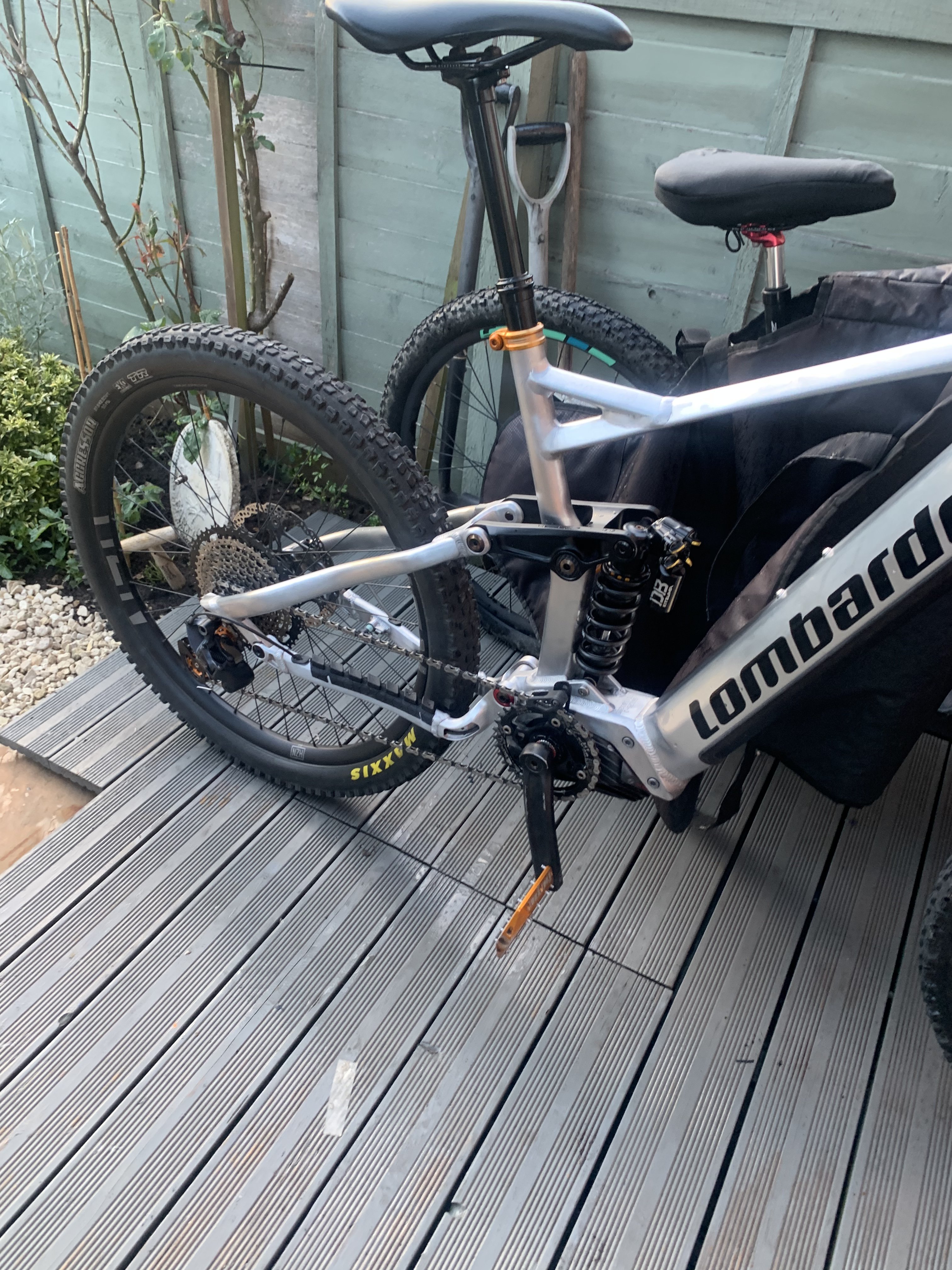

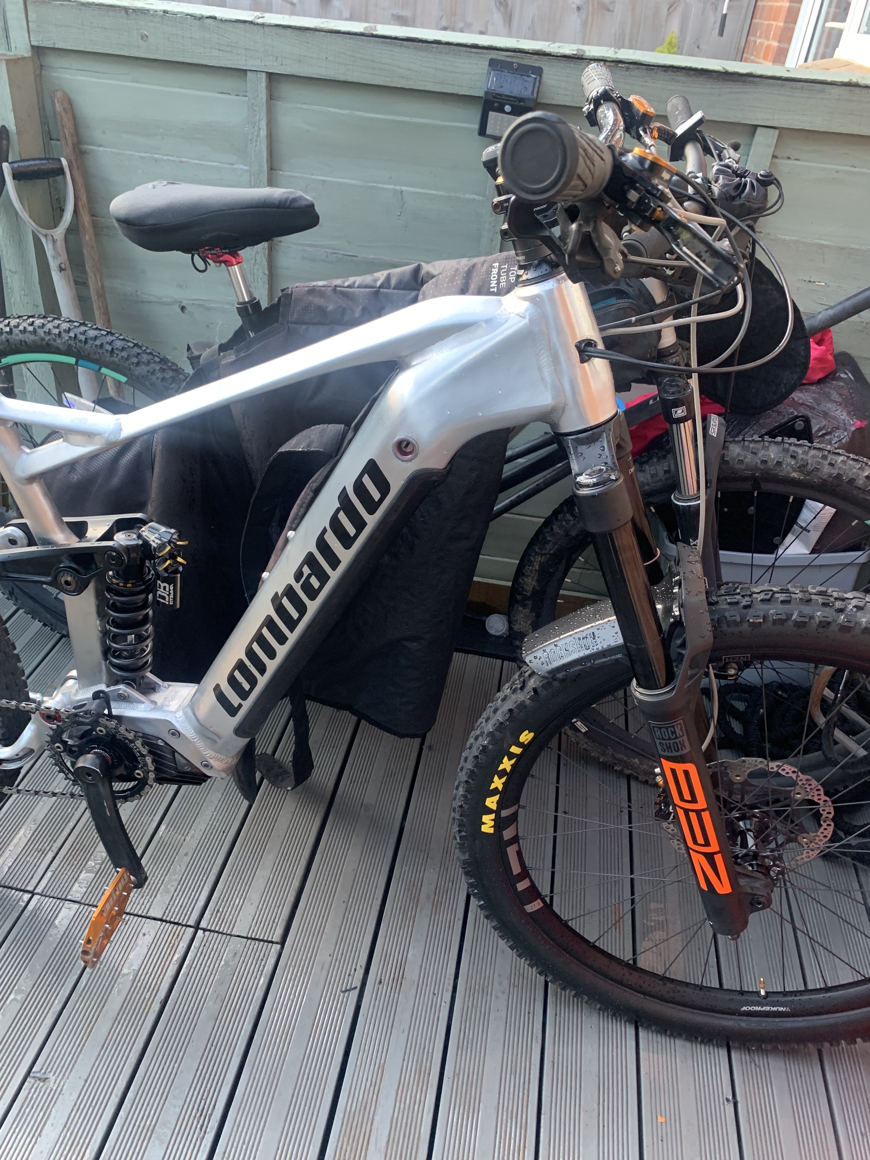

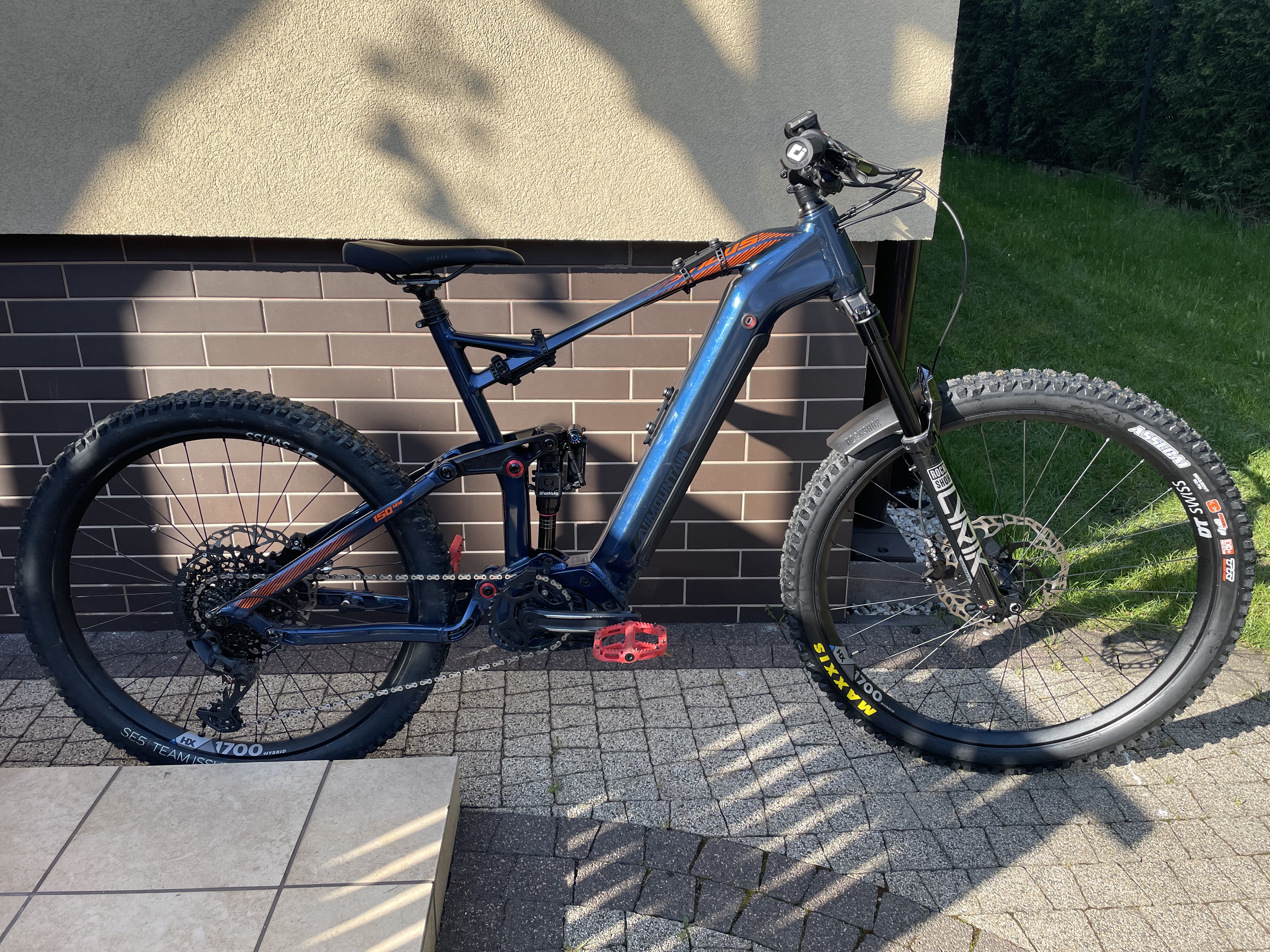

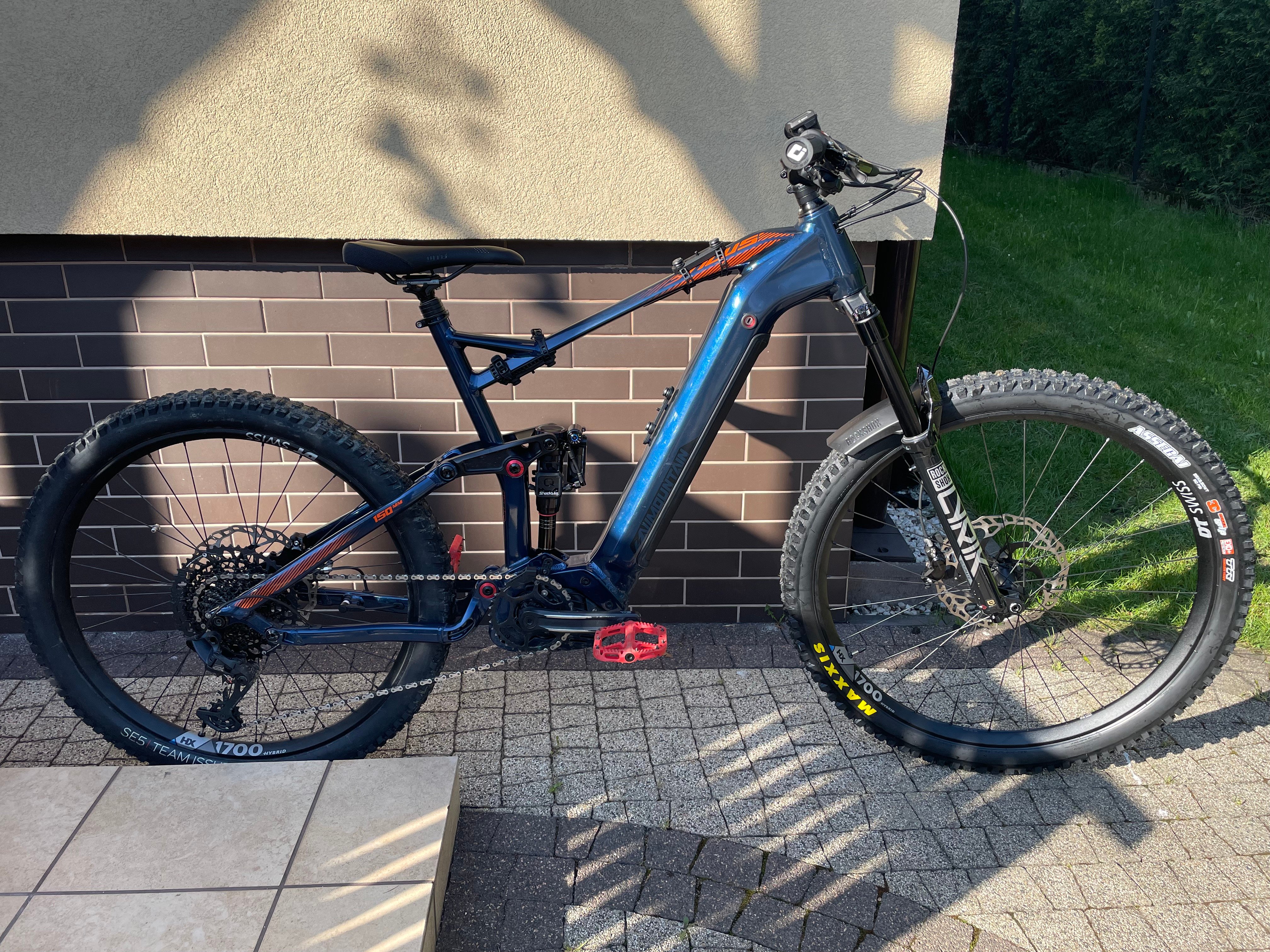

The time has come, I proudly present my Stilus, ready to shred through another season :D Everything is downright amazing now, the suspension is butter smooth (hah - buttercups!), mullet wheels with 29" front makes descending much easier and faster while the 27.5" rear keeps the bike's agility and nice cornering intact, and the stopping power of Code RSC brakes with 223 mm rotors is bonkers.
List of upgrades:
Fork RockShox Lyrik Ultimate 2023 29” 160mm Charger 3 RC2 DebonAir+ Buttercups
Rear shock RockShox Super Deluxe Ultimate 2023 RC2T 205x65 Linear
A ShockWiz to better understand all of the possible suspension settings and help find the best one for my style of riding :)
DT Swiss HX1700 35mm IS 29” front i 27.5” XD rear (build by DT Swiss on the iconic EX511 rims and 350 hubs, and additionally reinforced to be suitable for ebikes up to 150kg bike and rider weight)
29" 2.5" Maxxis Assegai MaxxGrip Exo+ front tyre (for the maximum grip)
27.5" 2.5" Bontrager SE5 rear tyre (got two real cheap, they're good enough for the rear, will swap to Minion DHRII once these are worn out)
SRAM Code RSC brakes
Galfer Brake Rotors 223x2mm (must have for heavy e-bikes... and riders)
SRAM GX Eagle CS-XG1275 12s 10-52T cassette (wider gearing), along with a GX chain (will swap to XX1 once worn out) and GX derailleur and shifter
RENTHAL Fatbar Lite 35mm 30x760mm bars
Bontrager BITS multitool in the head tube
Bontrager Line Elite Dropper lever (much smoother than the original, also metal = better feeling)
SRAM Matchmaker X 2 pc. (cleaner look due to a shared clamp for the brakes and shifter/lever)
ODI Elite Pro grips
OneUp flat pedals (insanely grippy when combined with five tens)
WTB Volt Cromoly 150mm saddle (finally a relief for my sit bones, I've been looking very long for the right saddle)
Three Fidlock magnetic bottle holders (hydration is key!)
Aaand since I've made this photo a few weeks ago I've already changed the front mudguard to a longer one, custom-made for Lyrik 2023, which also protects the stanchions and seals. The one supplied by RockShox with the Lyrik was quite mediocre as it caused mud to splat all over my face 😅.

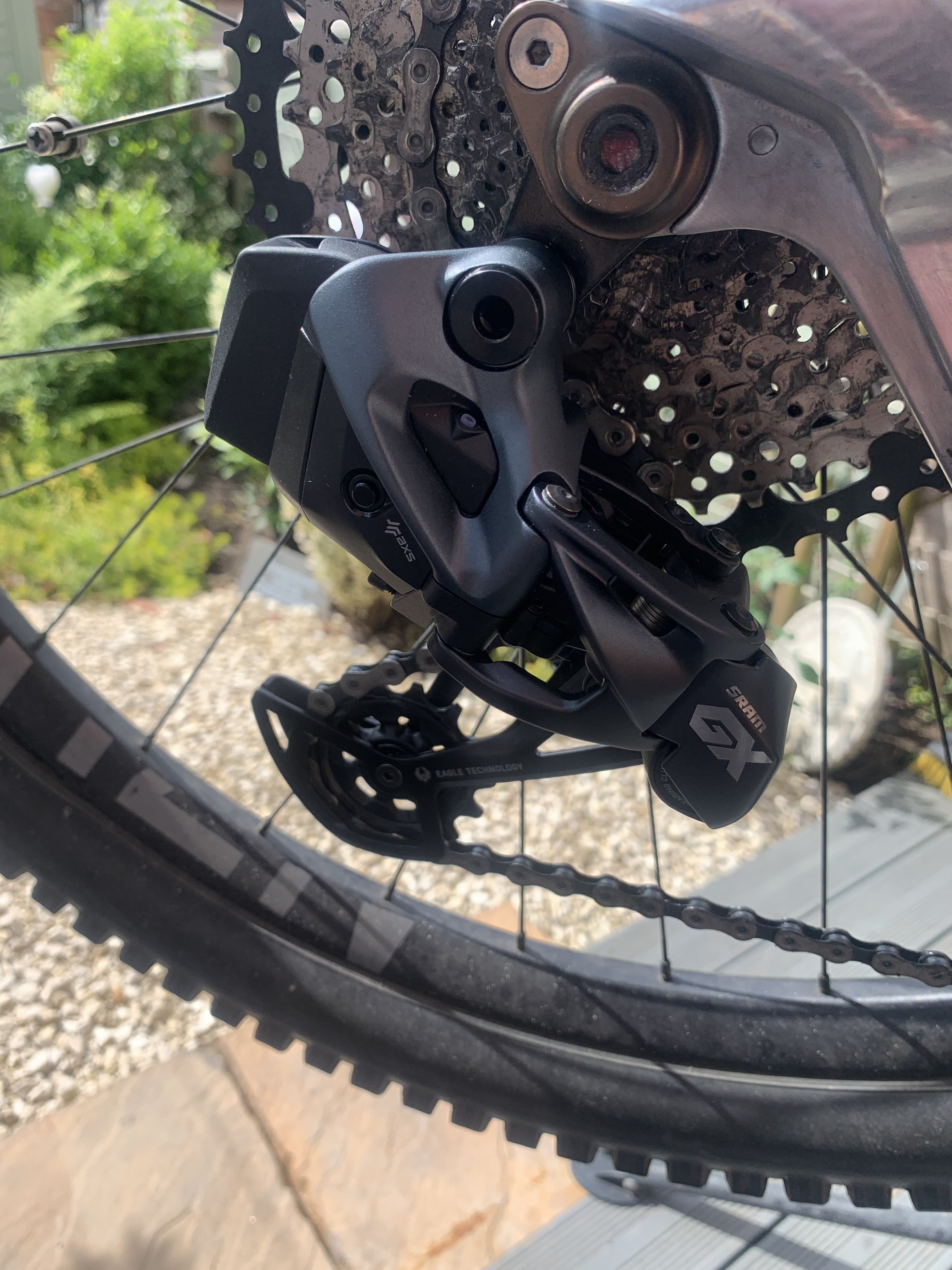

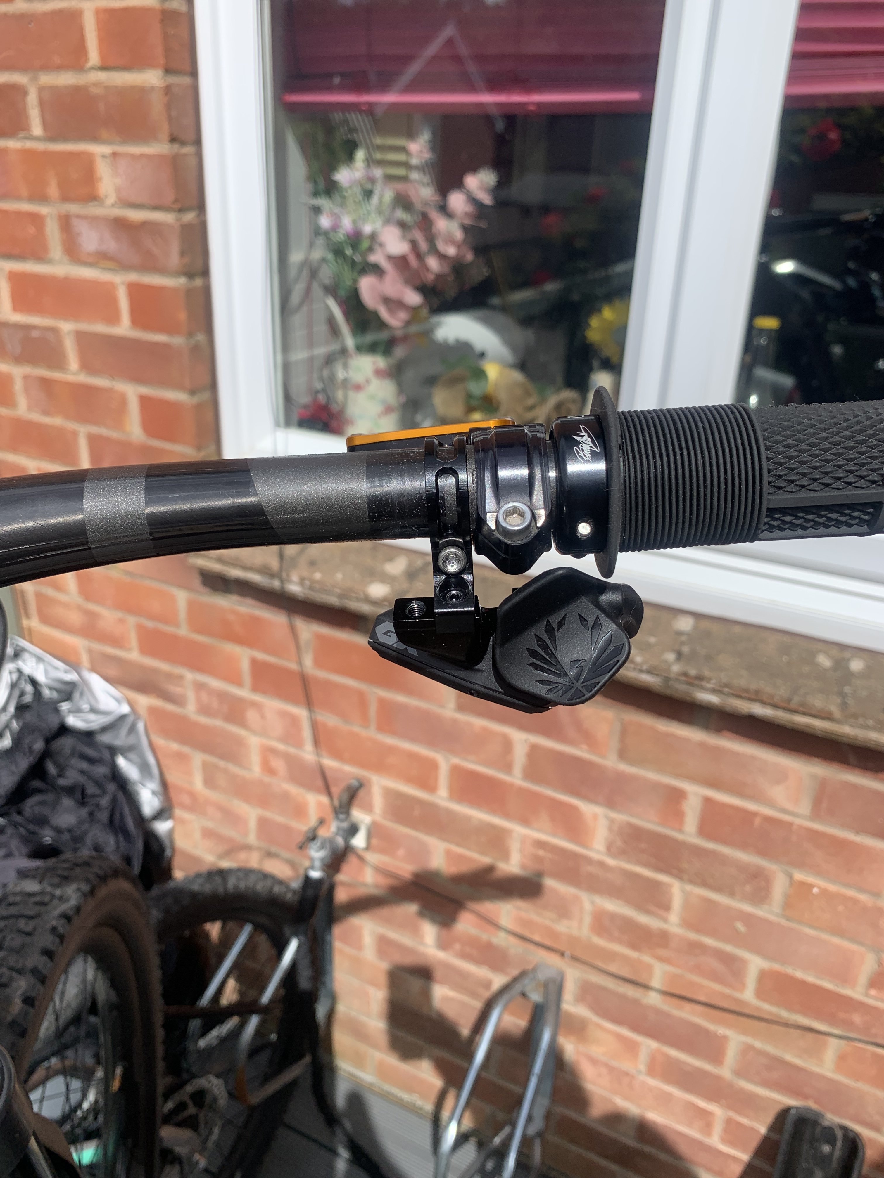

Wireless shifting fitted, couldn’t resist at the bargain price of £275 brand new off fleabay
