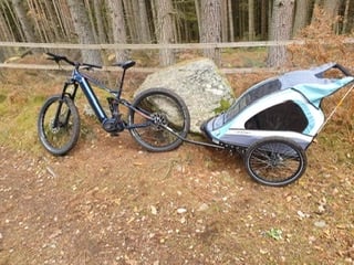

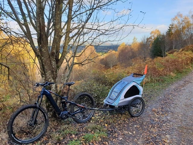

New axel fitted, trailer bracket works a treat. Young lad loved every minute ?

I got the 178mm but really the 182mm would have been perfect. Really depends on your trailer bracket type.
