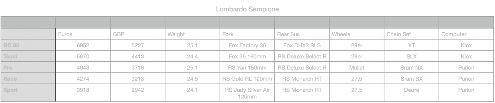

Having a bit of time on my hands I decided to have a look at what the next iteration of the magnificent Stylus might be.
We know that they are made by Lombardo and with a bit of tinterwebery I have come up with the following info. I used a conversion of £1:33 to the euro but who knows where we will be in a few weeks time and I have also used a average retail price. As we all know there can be a larger variance in just how much profit a shop wants / needs to make.
All the bikes run a Bosch Gen 4 in a frame that looks the same as the current model but some of the listed weights do vary. All bar the Sport use a 625 battery which weigh heavier that the current 500 so there has been some weight saving somewhere as they are still alloy construction. Here are just the headlines:

Interesting analysis Pigin! Love your style in regards to your future consipracy theorising of what it might be ;).
Seems strange how the bottom two Sempione's are 120mm travel up front given the current Decathlon budget bike had 150mm. I remember when I did a comparison of the Sempione before I brought my Stilus (as they had better geometry stats than Decathlon) and recall I thought it was most like the Pro...
