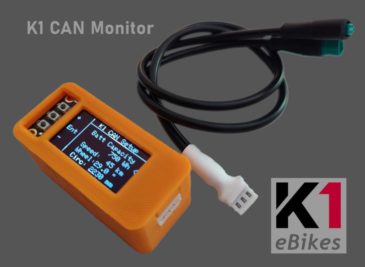

I'm asking for advice, I have a Besst tool, everything works fine for me, but I can't increase the speed but only decrease it. Is this caused by the Besst tool itself, or is it just a bug in the Python login?
Same with me with python script. Theres some region restriction and can set only 25kmh.
You can buy K1 CAN monitor:
You need to use old BEST program=1.2.18 works to change limit.
