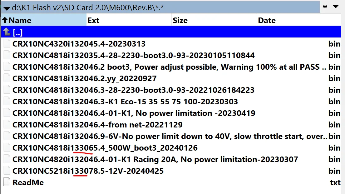

I've installed the firmware from kiwitourer from page 12 here in this thread. I drive my m600 for two years already and it is very good.
I'd like to know if there's a better firmware version available than this one.

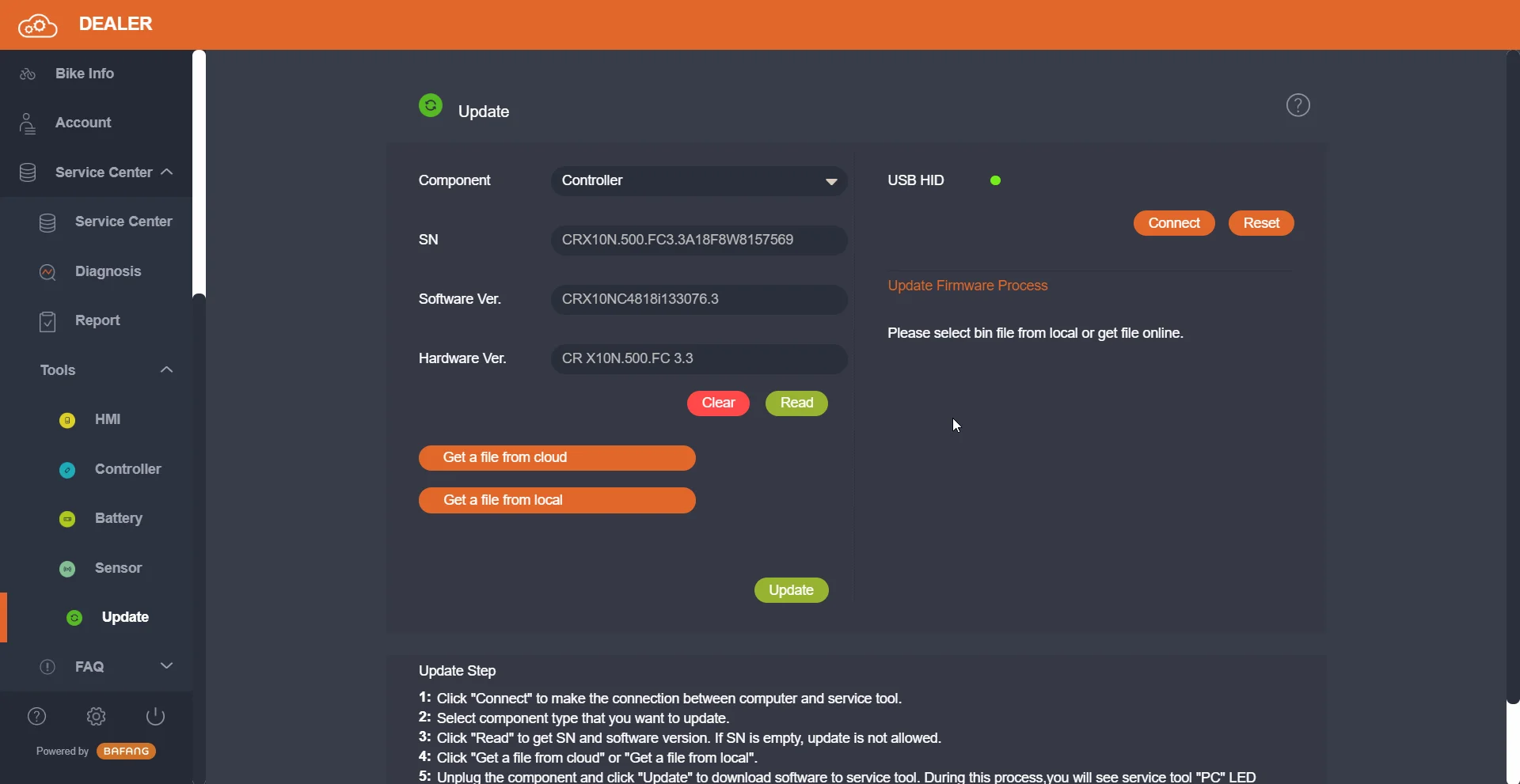

Hello It is 48V and 18A firmware. There is some firmware with 20A
And looks like you have some latest firmware, I dont have your v76.3 with FC3.3
Have just 2 firmwares FC3.3 , but I think also FC3.2 would be compatible with your motor (not 100% sure).
Last marked is FC3.3 and for 52V.

Can I use the firmware luna_x1_firmware__74963.bin?
You can try. ;)) But is very old. And I guess will be set for shunted controller.
Be carefull about roll back. You can loose your v76.3 if you dont have it as bin file.
